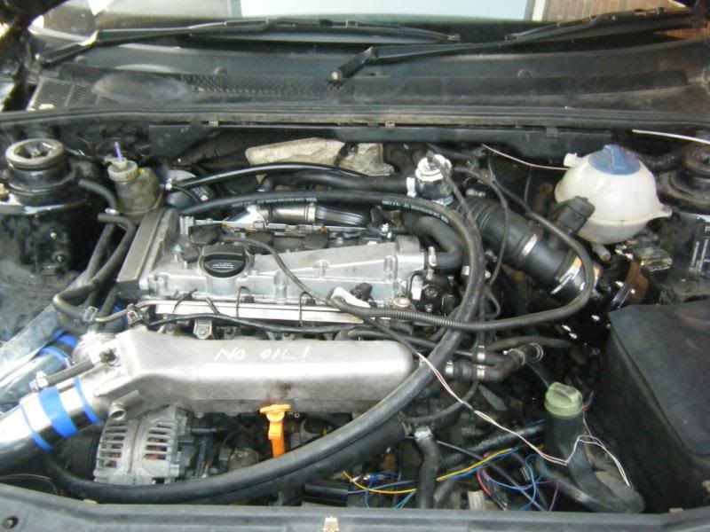

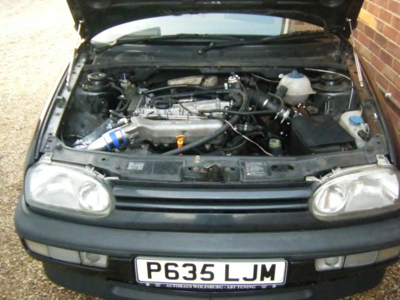

Just a quick update, going to Spain for a week tomorrow so heres how it stands atm. Pretty much ready to roll just need to move the coolant bottle over and work out the ducting for the air filter
Bad news is I found a pretty bad fuel leak when trial running and on further investigation founbd a big gash in the black fuel line. Managed to have about 5 litres leak out of it before I managed to stop it! luckily I caught most of it in a fuel can though, so first job on getting back is to get a new fuel line
Anyway, heres pics of how it stands now

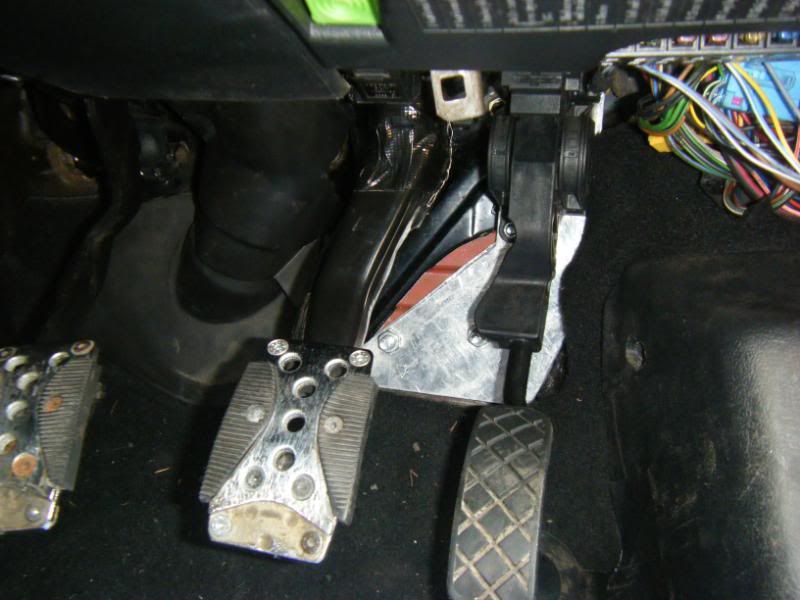

Need to sort out these pedals at some point, previous owner bolted some universal momo pedals that are falling off

managed to drive it home :) got about 5 minuites down the road gave it a blast and the silicone sealant I used to bodge up one of the boost pipes popped off :( also getting a bit of exhaust rattle and coolant light is flashing, but not bad I'm pleased with it :) First job in the morning is to measure the bore size and order a reducer silicon pipe for the broken boost pipe, and have a look at the exhaust to fix the rattle
ordered a cold side dv relocation from forge today so once that gets here I can plan on what I need to get the intercooler rigged up properly. Got a bit late for pics so I'll try and get some up tomorrow
