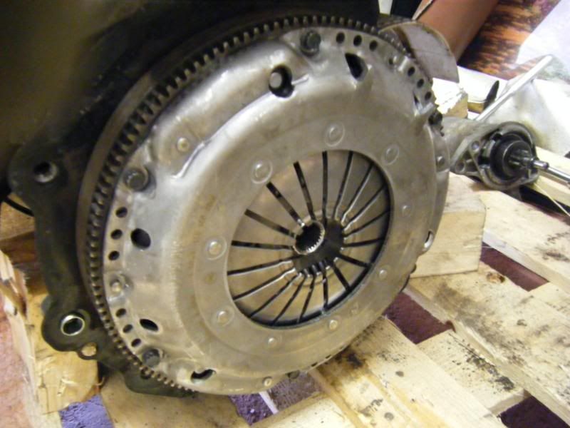

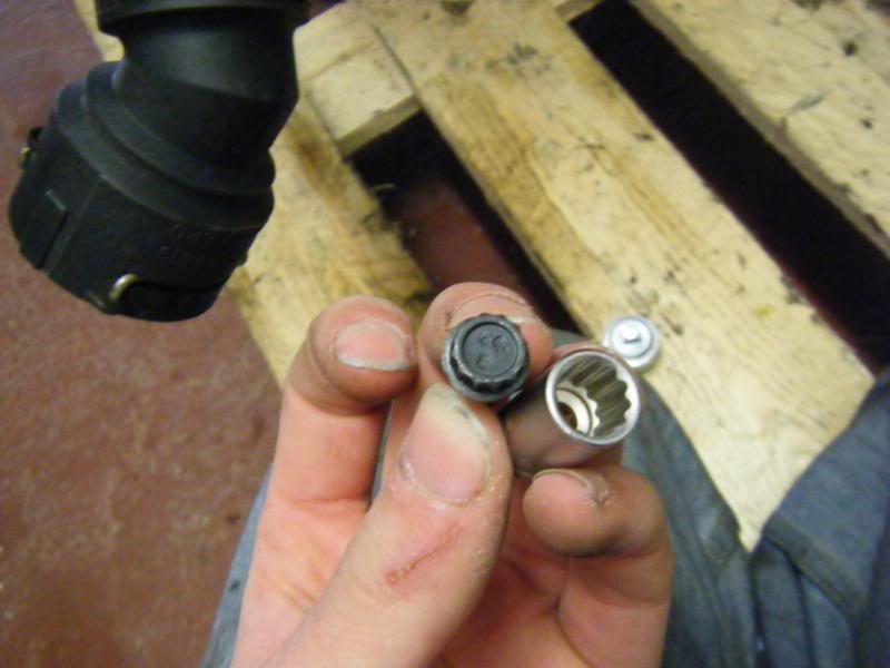

Day was started by going to a tool shop and getting the right tool for the clutch bolts
guy in the shop said it was a really weird size, m7 and the head is something like 11/32? cant see myself ever using that socket again  :grin:

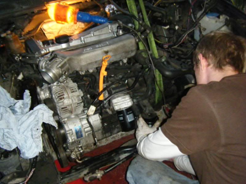

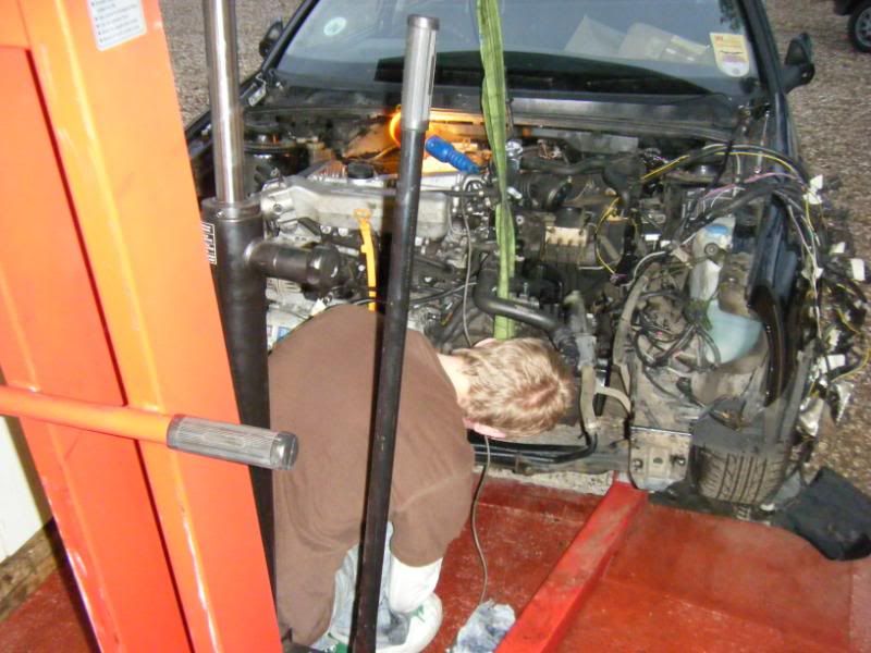

Action shots!

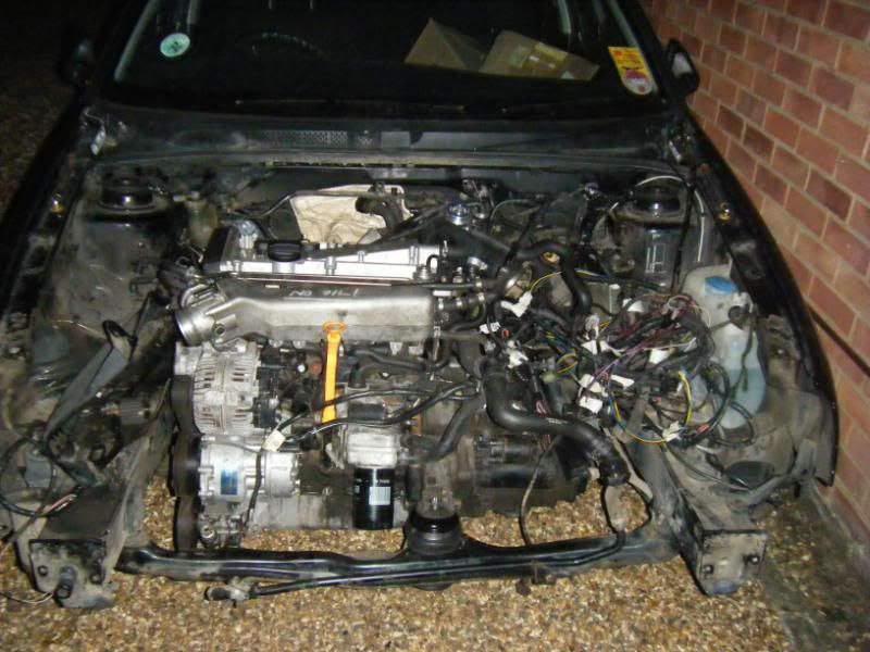

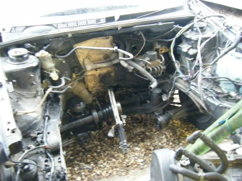

Heres how the bay looked b4 it was dropped in, wiring all nicely tucked away. Could do with a clean though, but no time for that!

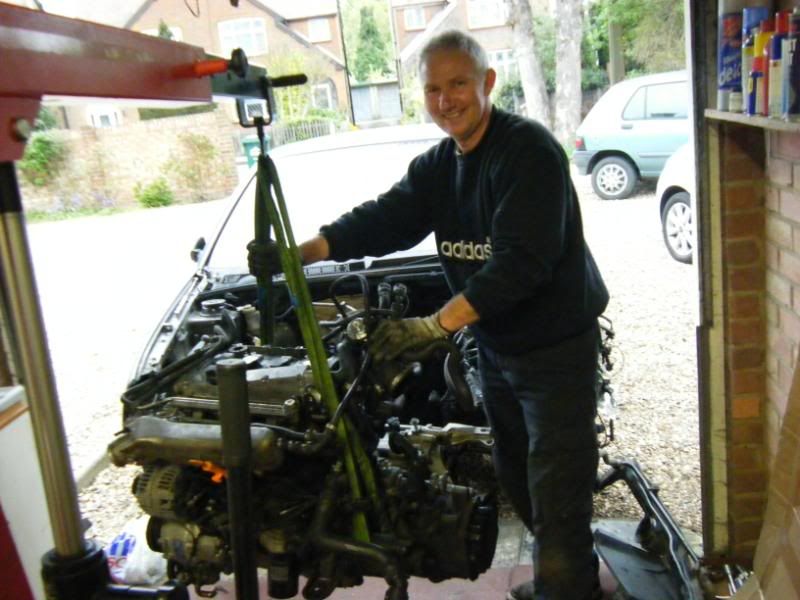

Dad posing

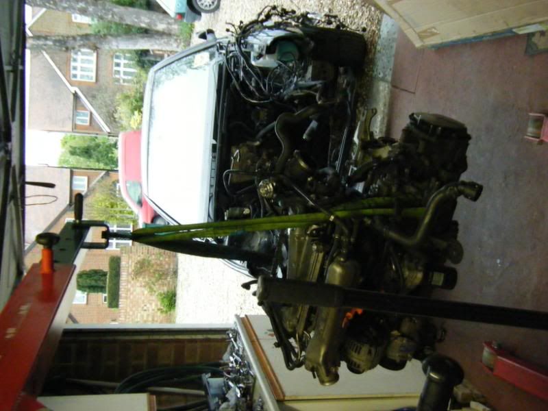

More action shots!

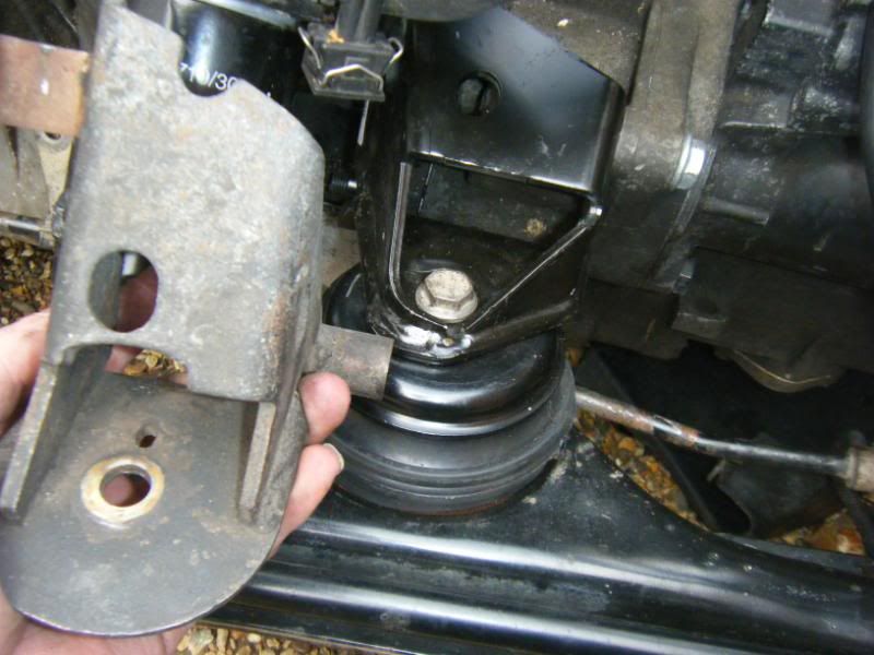

And now the bad news. Front engine bracket is wrong :( the engine sits too high at the front and looks like its tilting backwards, its also really tight with the bonnet
You can just see in this pic where the bracket doesn't sit fluch on the mount. The bolts just in to hold the engine in place while we moved it back round the side of the house.
I've had enough of pissing about with ebay and scrappies for one week so just ordered the bracket from VW. £50 or there abouts but at least I know the right part is on its way. Wont be there till monday so in that time I'm gonna get everythign else done and at least get it running so all we need to do on monday is change the bracket and its all finished :)

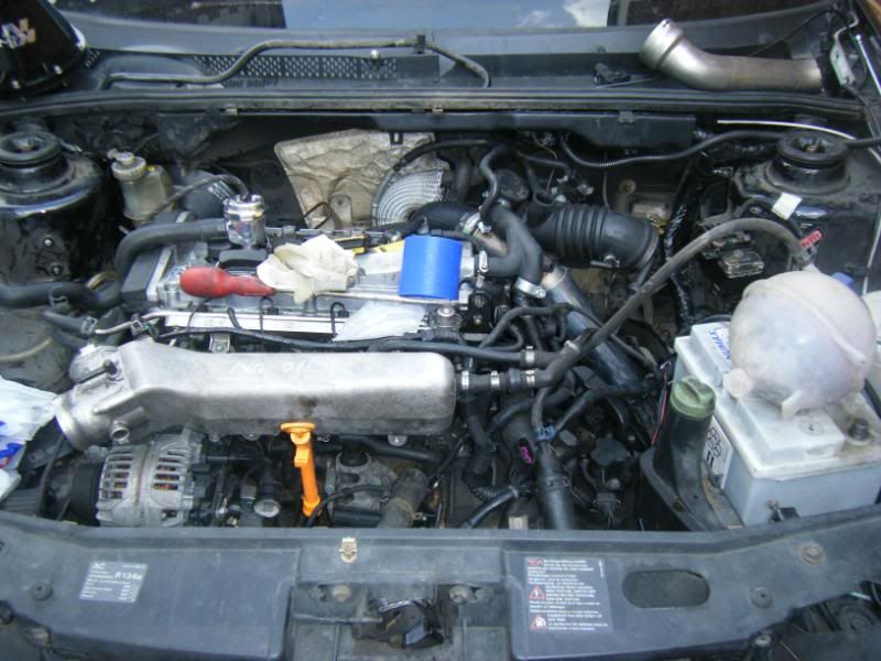

Time is becoming an issue now, need this finished by Thursday or I'm walking to work! Fairly confident I'll have it driveable sometime tomorrow, though I've decided to bypass the intercooler for now untill I order some proper pipe and hose instead of arsing around with this universal kit which is clearly inadequate!
Anyway on with the update
Forgot to get a before pic, but heres the new bracket fitted with the old one held up against it

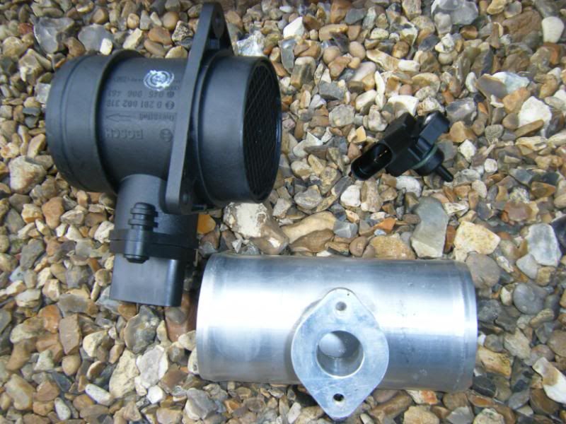

More new bits! MAF, MAP sensor and a pipe to mount it in from Forge. All together the sensors and bracket put me back £270 from VW, but as said before I dont care anymore just need it finished  :grin:

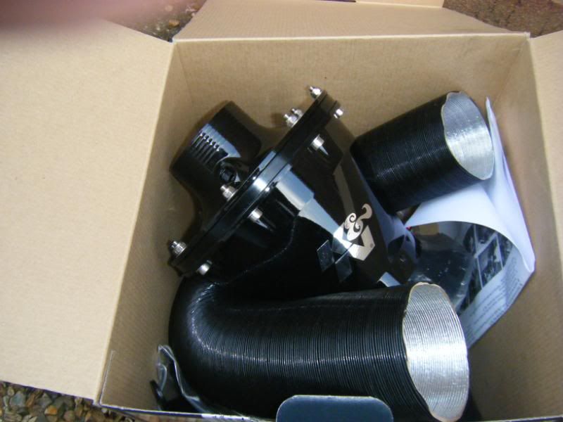

Apollo cold air intake kit from Venom, £140 delivered

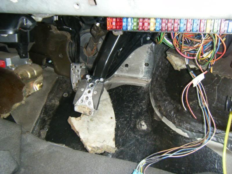

Heres how the pedals look atm

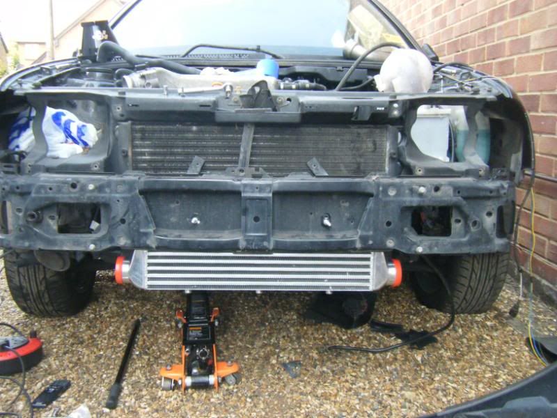

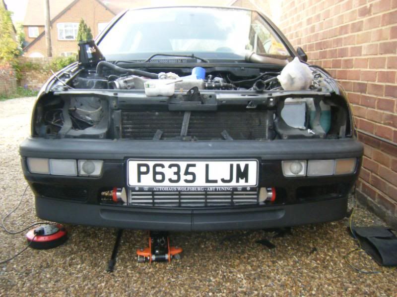

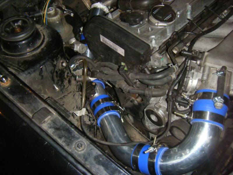

Intercooler fitted
May need to trim these a bit :P
And heres how the bay looks b4 I finished today
Need to tidy this lot up at some point but for now as I said just need it running, gonna route the tip the other way like it is standard and just hook it up to the throttle body

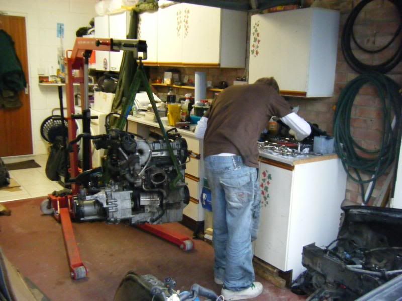

Top work mate, is that your mums kitchen the engine cranes sat in  :laugh:

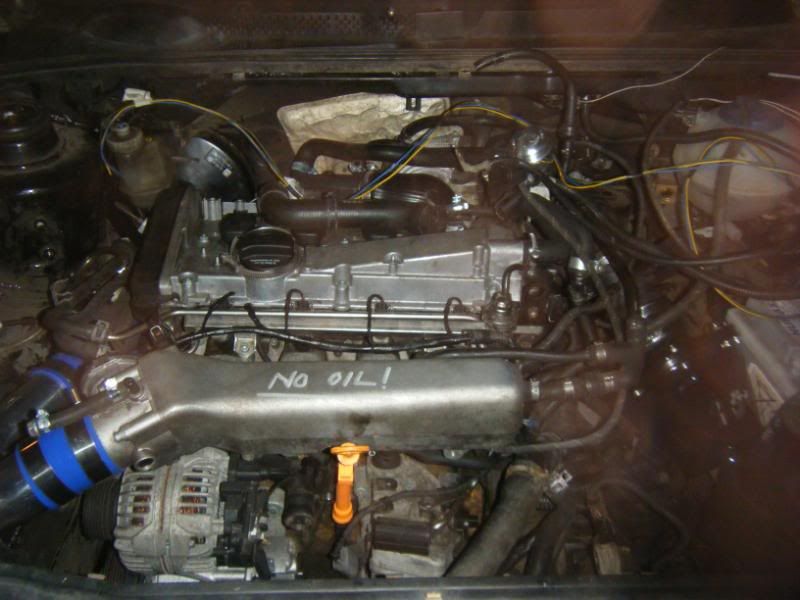

Loving the "no oil!" chalked on the inlet manifold!  :laugh: :grin:

what intercooler you using mate?

lol yeah we took over the kitchen for the week :P No its my Dads garage dunno what the idea is with the tiled floor and kitchen cupbords though  :grin:
that 'no oil' is actually painted on, dunno what the idea behind that is either but gonna be fun getting it off
Intercooler is just a £50 job from ebay, its a universal one from Toyosports

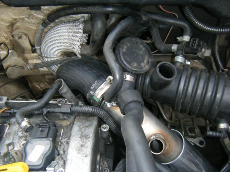

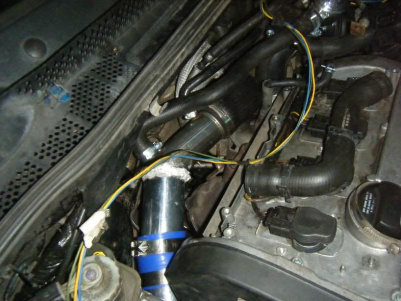

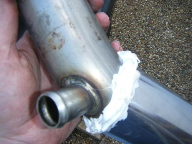

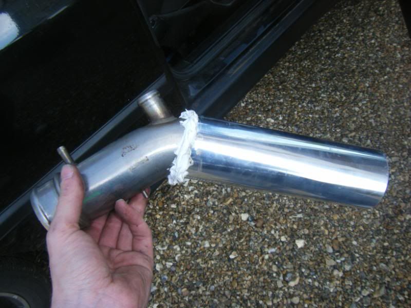

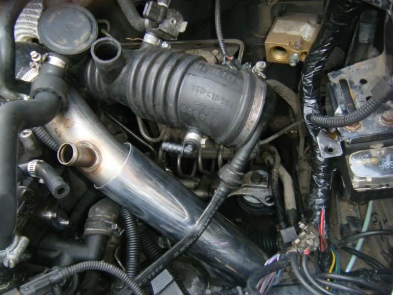

bodged up my turbo intake pipe with some silicon sealant just untill I do it properly, hope it holds :P

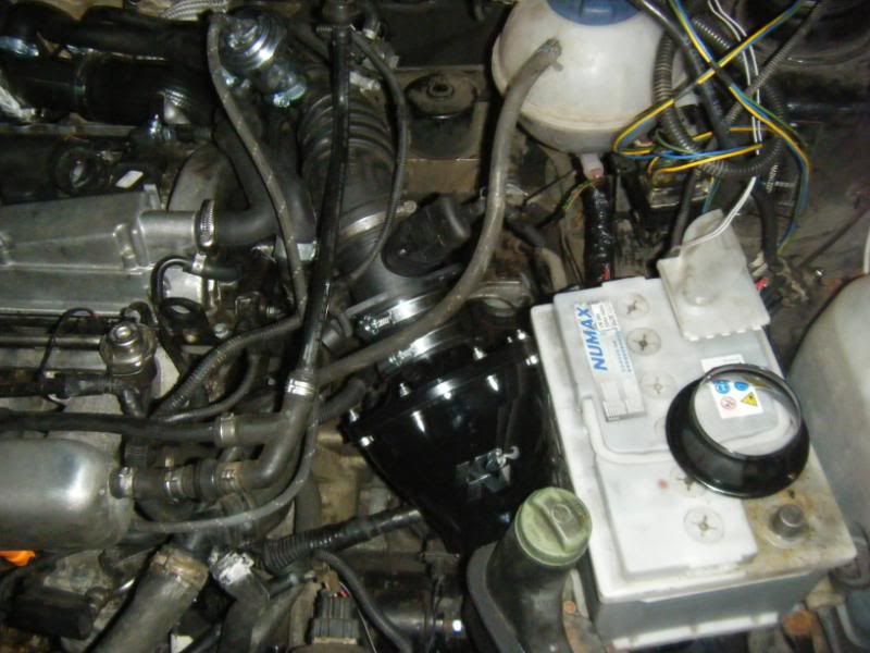

Managed to reoute the piping for throttle body to turbo intake, took ages! dont wanna think how long its gonna take to rig it all up properly to the intercooler!
Deffinatly need to do something with this lot as well, intake has crap all around it and will no doubt perform badly, and it also looks a total mess!
