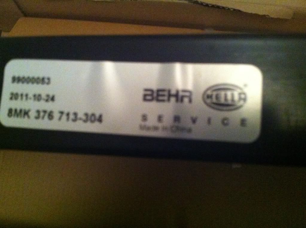

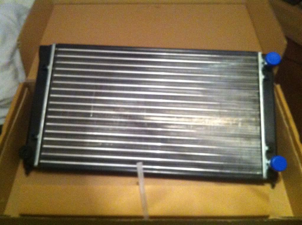

Just got in from a late shift to a little goodie.. Brand new genuine HELLA rad for the pricely sum of £29 cant beat that !
