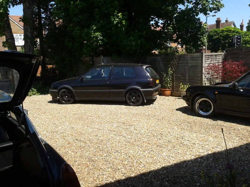

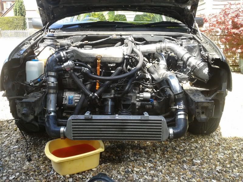

I've been ever so slightly slacking in the recent months with updates mainly because I forget to take pictures or simply cant be arsed, but I managed to get a few the other day in the sun. Nothing much but its looking a bit different to last update
engine bay while I was doing a bit of tinkering

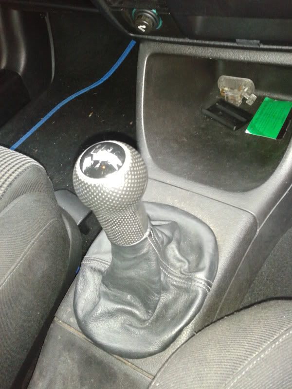

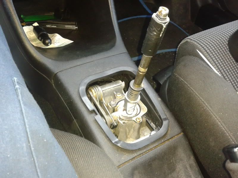

and how my gearstick looks with the 02j shifter before I out the knob on
next mission is removing the gti trim (again) and sorting out all the rust then refitting the cl trim, not sure what to do after that think im almost there

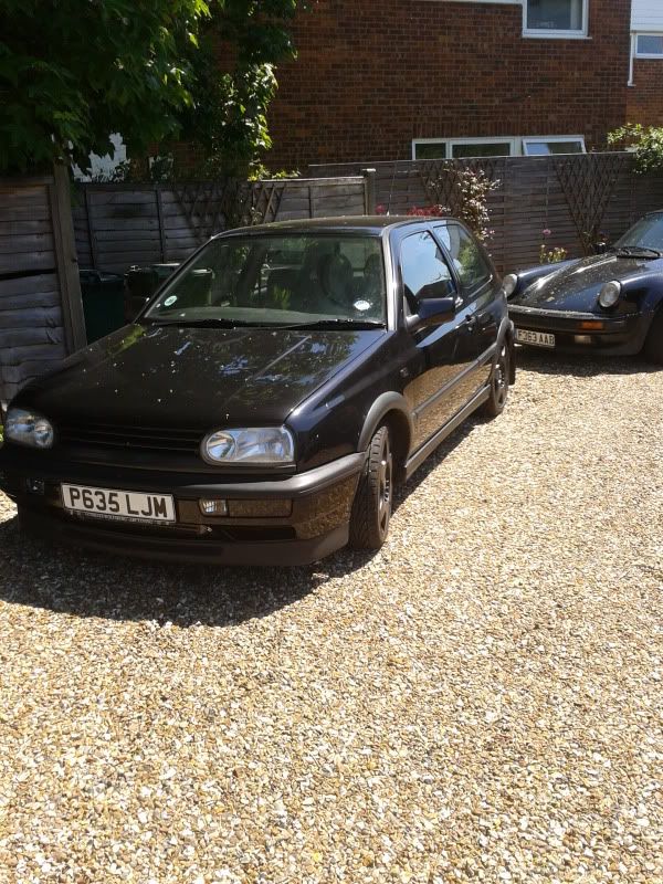

cheers, yeah thats my Dads current mid life crisis motor, so far hes been through a Porsche carrera softtop, forget which model it was, a 52 plate audi TT, and now he has this, Porsche 911 Turbo 930  :cool: In the coming months that's going to be getting a new exhaust and rebuilt engine should be a beast when finished

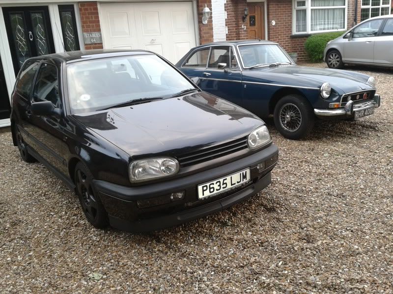

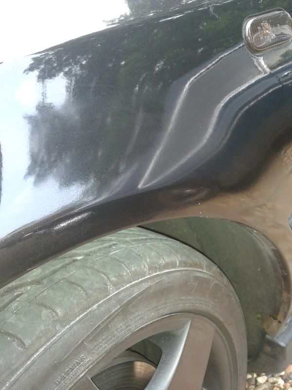

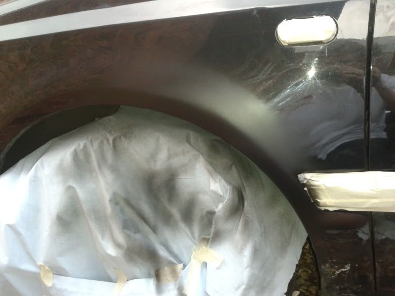

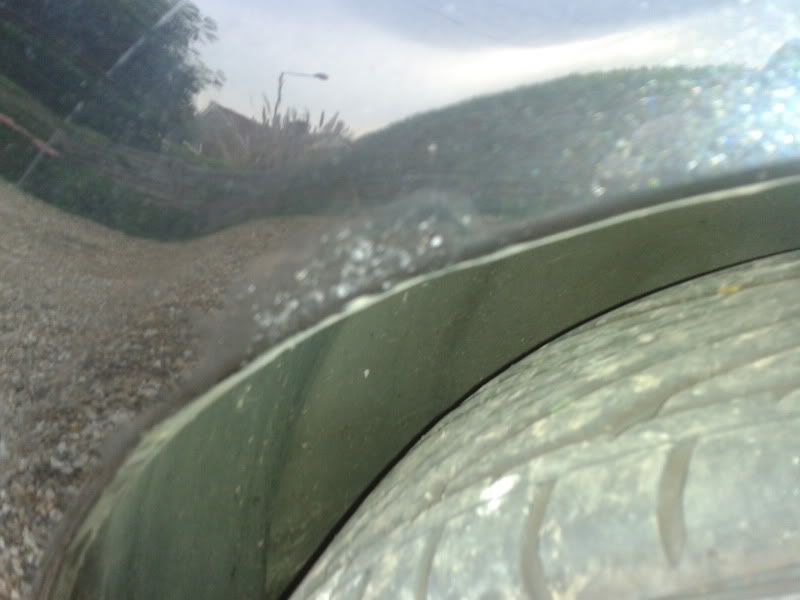

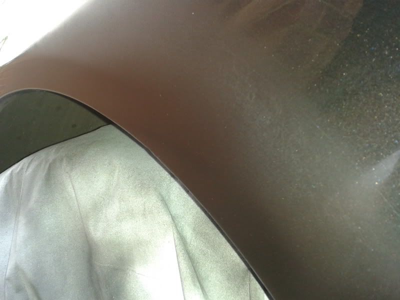

Taken the arches off and fitted the CL trim, now have some horrible lines from where the arches have scratched the paintwork and a few rust bubbles. started fixing the rust today, not happy with the finish though so it will be redone sometime next week. Was fine up to the lacquer but the 2nd coat bubbled and my attempts to sort it out were a failure :(
Here are the pics I got today
Didn't get a before pic so this is a similar but smaller bubble on the other side

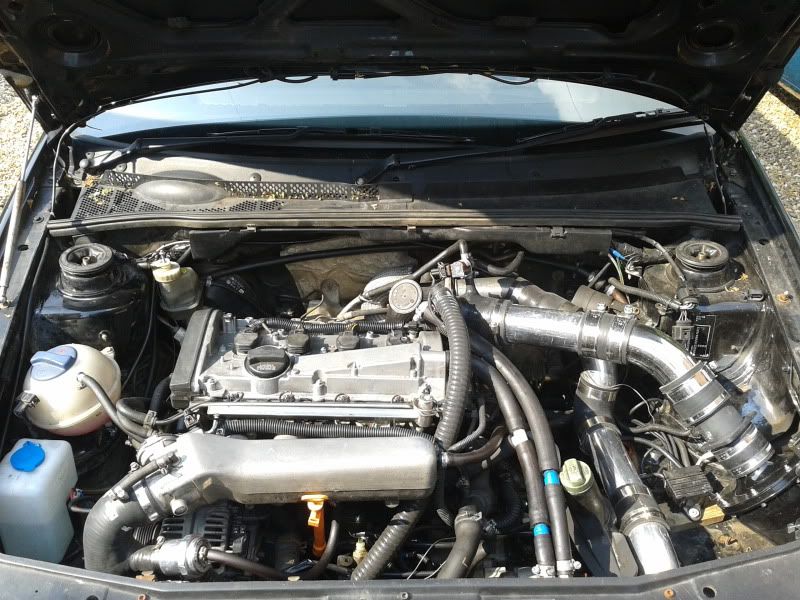

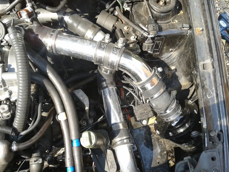

Engine bay, bit tidier and cleaner now :) still a work in progress though

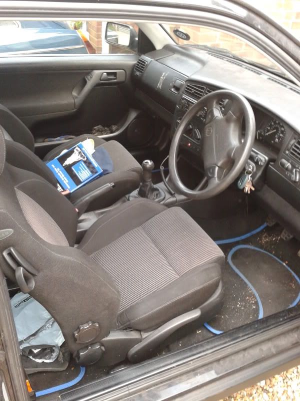

Interior progress

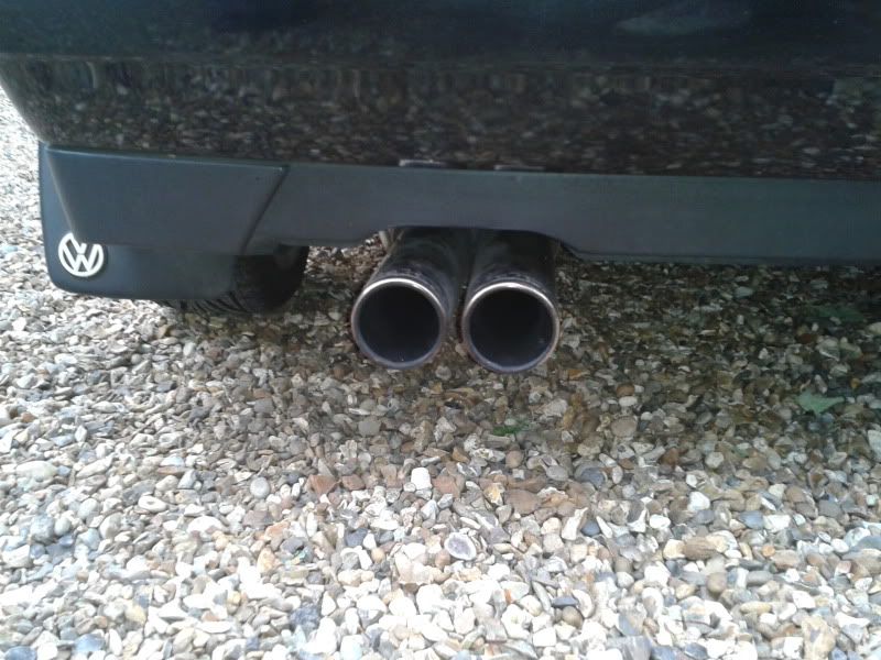

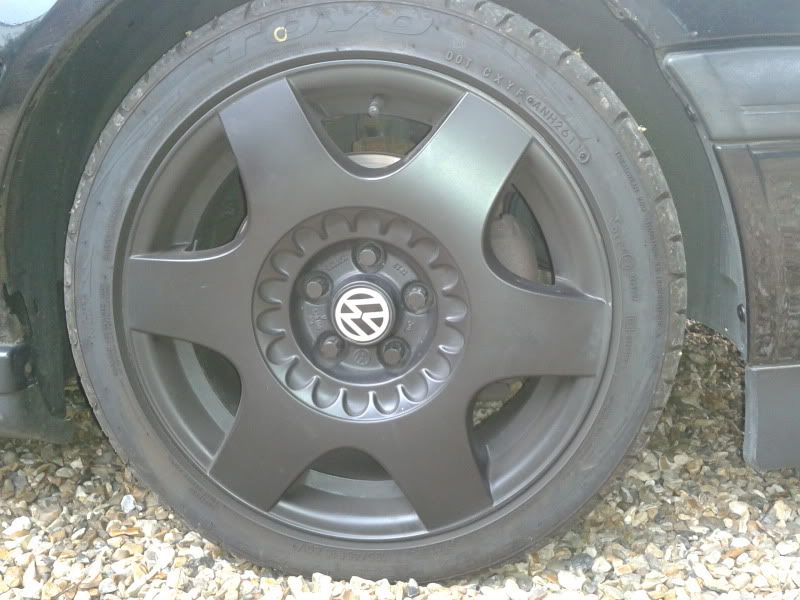

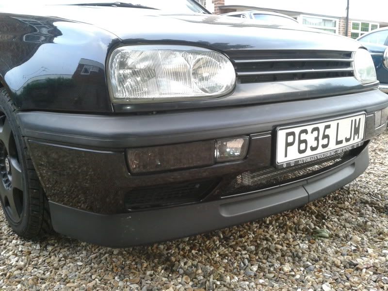

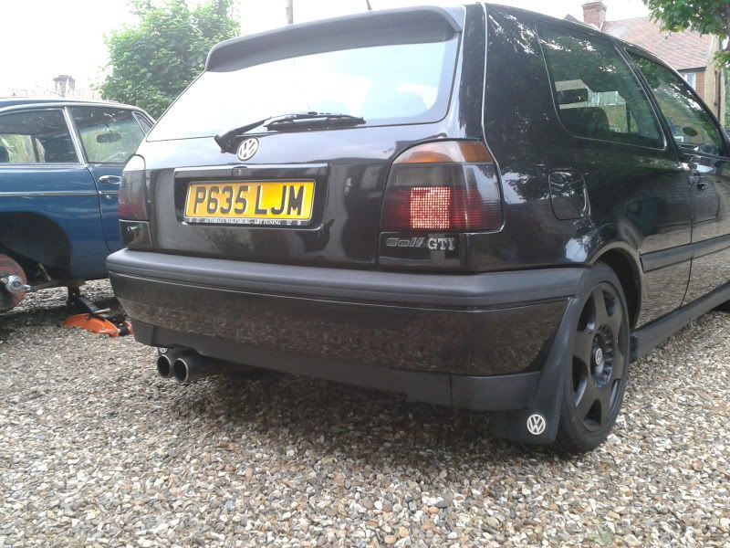

Exterior, new indicators/fogs, smoked repeaters, black powder coated new beetle 16s, and the cause of my recurring nightmares, the exhaust that no matter what I do wont stop knocking! At least its hanging straight now though
That's it for now almost there :)
