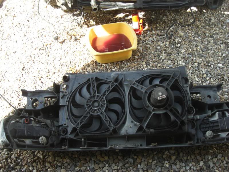

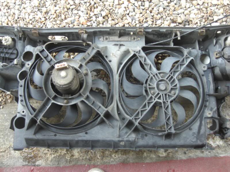

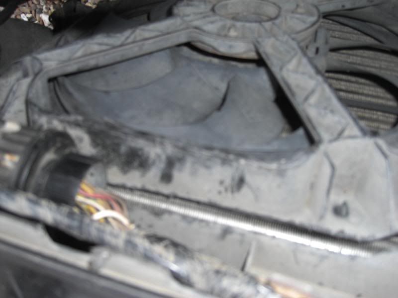

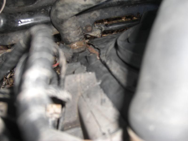

Moving the rad was a bigger job than I thought, ended up taking all day so I didnt manage to get any piping done, but did move the rad back and mount the intercooler properly
This is how it looked before I started work, not much room as you can see

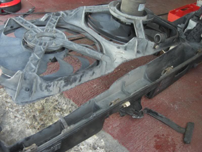

So started by taking it all apart again!

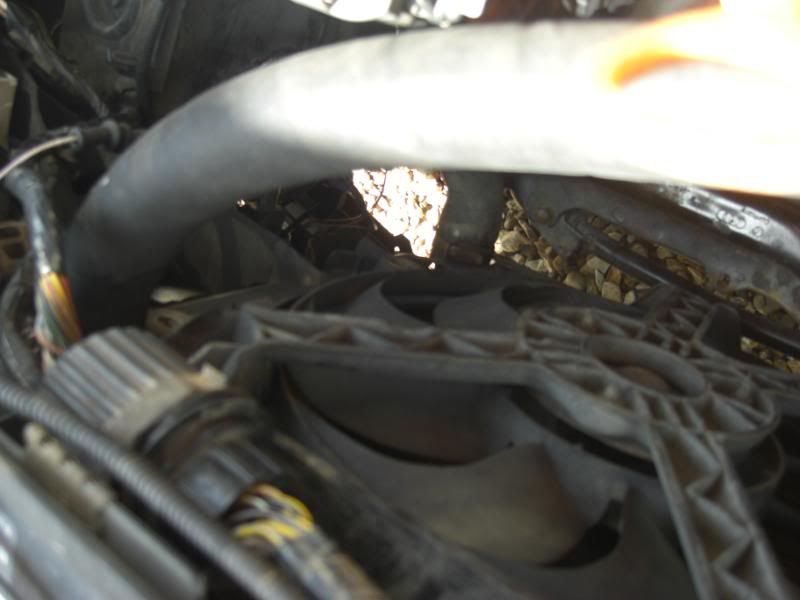

I tried just cutting the top and side so the fans pulled forwards kinda like a door, and fitting the rad on the passenger side using the original mounts but mounting it behind them instead of infront, but this moved the rad too far forward so I couldnt get the bottom hose connected as the crossmember was in the way :(

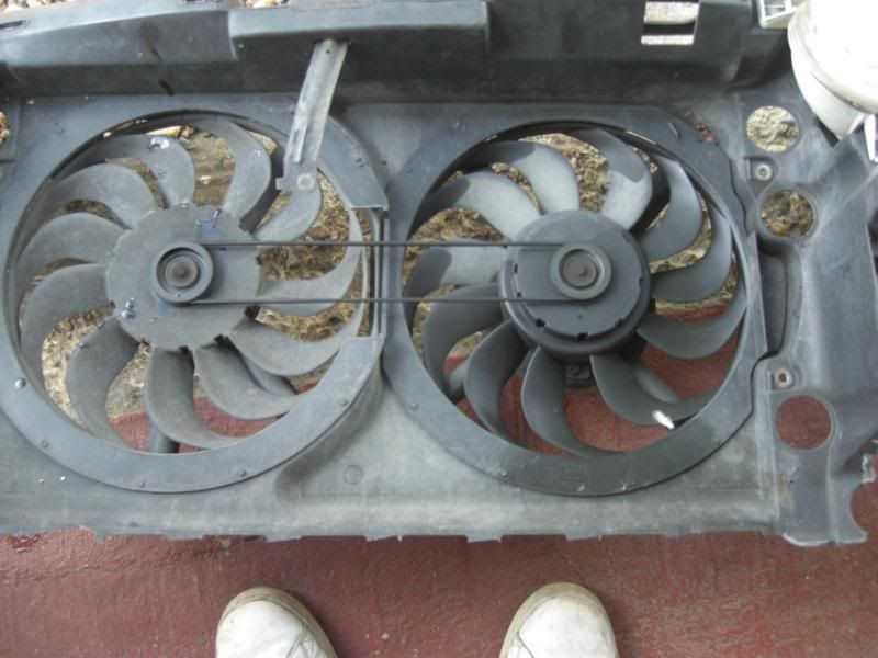

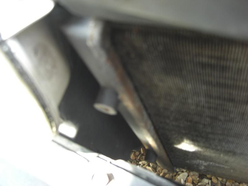

So I ended up cutting all the way down again cutting the original mounts off so there was around an inch gap so I could make up some new mounts. Pics are a bit hard to see whats going on, I was kinda rushing towards then end and also nearly knocked myself out standing up and cracking my head on an open cupboard door! Dad came home and thought someone had been murdered in the garage  :grin:

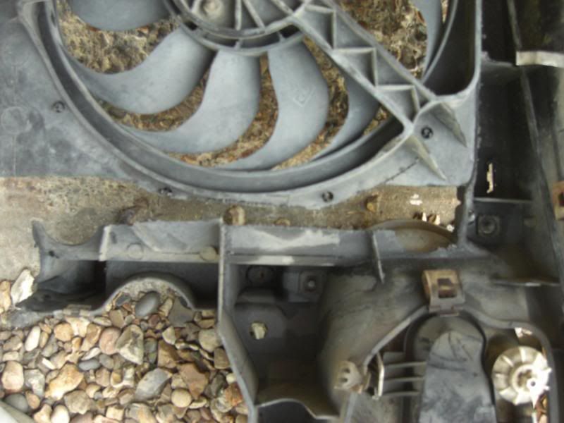

and here it is fitted

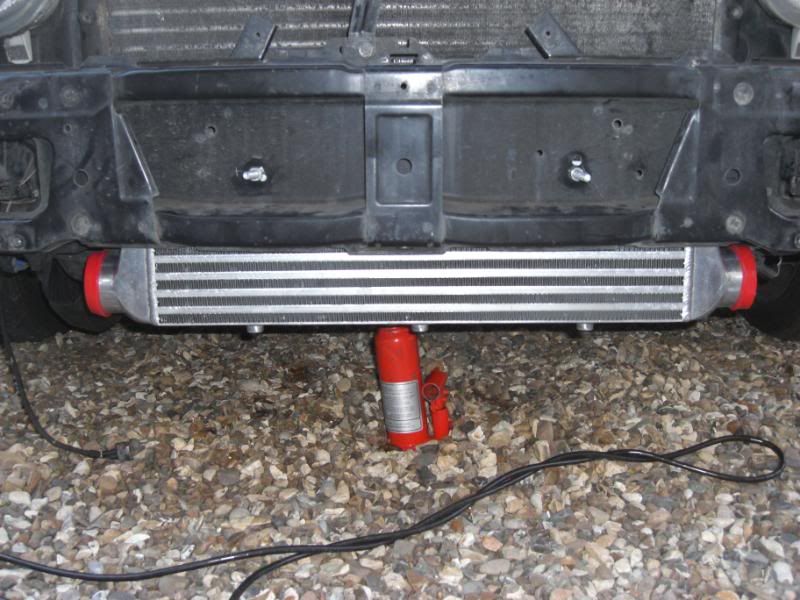

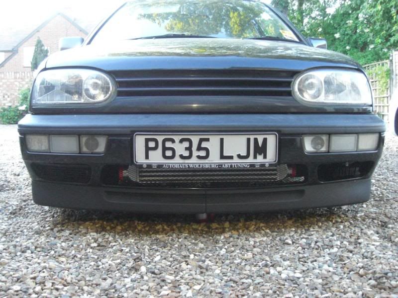

And heres how the cooler sits now, a bit higher and much better clearnce on the bumper. Unfortunatly on the previous attempt at making it fit before I learned about moving the rad I cut all the fins out, regret it now and have put some black mesh there for the time being

Yeah it worked great, cheers for the tips :) I'd probably have ordered a new cooler without your advice  :afro:
Still havn't made up mounts for the passenger side yet but its pretty secure pushed up against the cooler. probably wont be until Monday now that I get another chance to work on it. Everything seems to be going well atm though  :cool:
