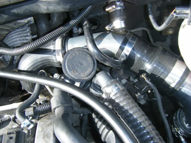

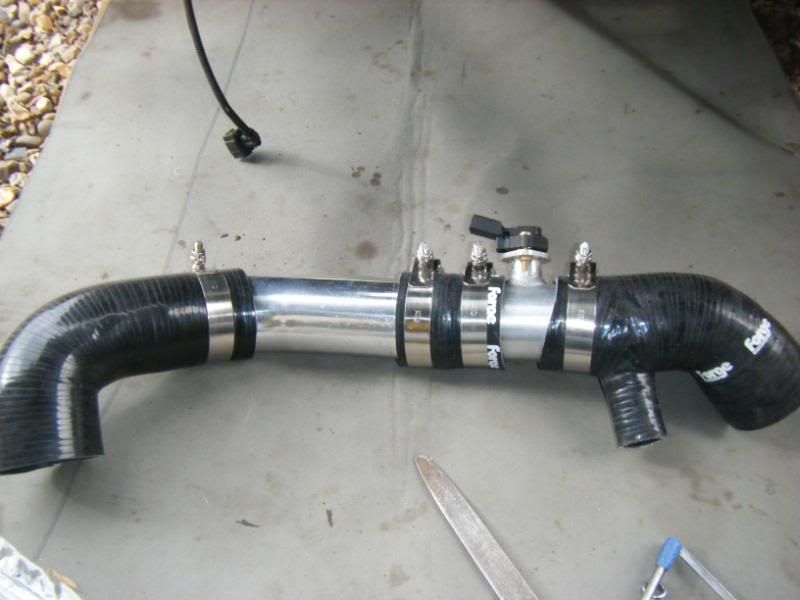

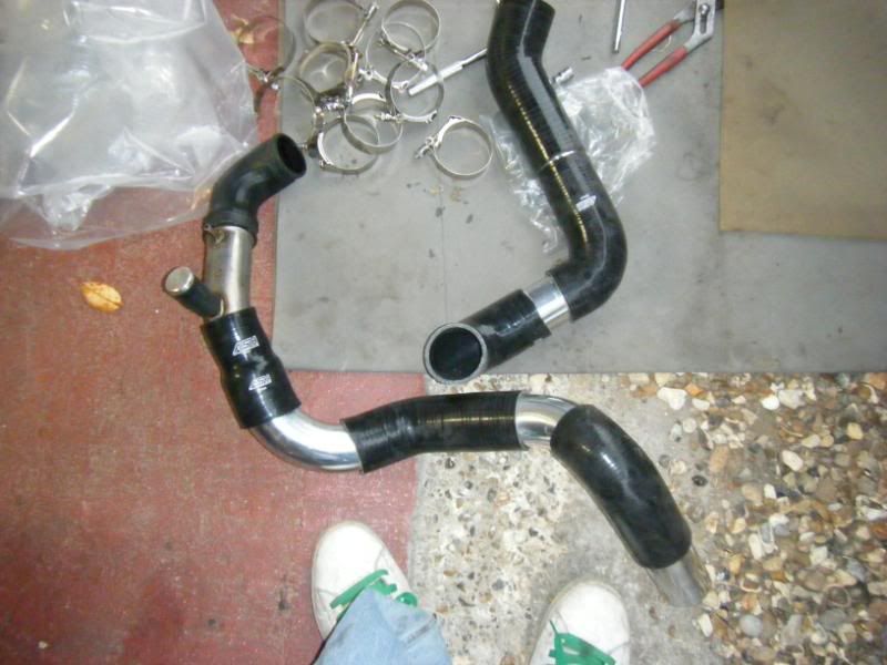

Heres the piping I made up which I made from trial fitting etc, ended up having to mod the passenger side one again after these but didnt get any pics
Cold side with Forge DV relocation fitted, not the best cutting skills I know  :grin:
Hot side piping before I clipped it all tgether

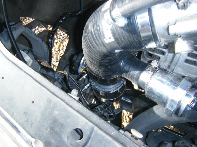

Cold side fitted

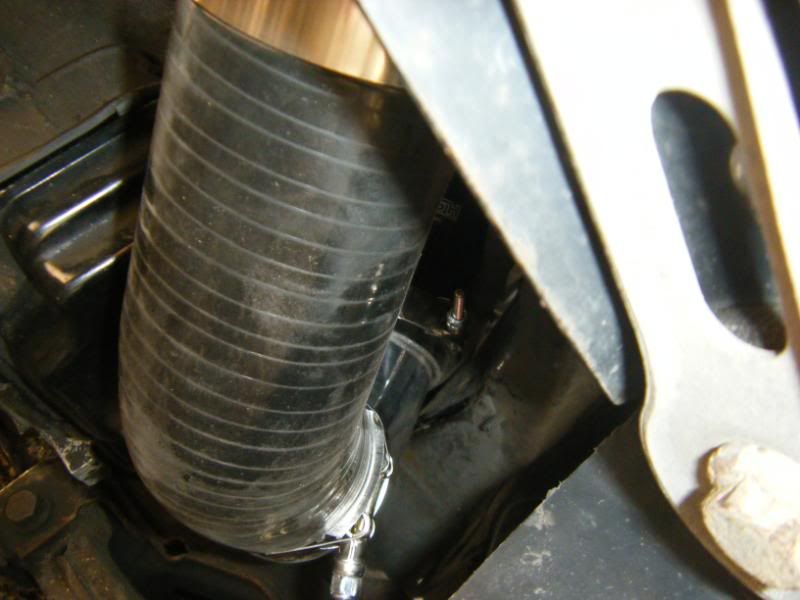

Hot side routing from the turbo over abs and down beside gearbox
Last pic s hard to make out I know but hard to get a good angle

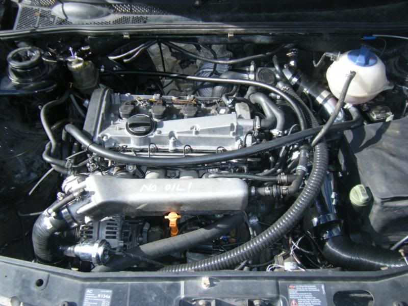

And heres the bay as it stands now, still needs a tidy up, I'm working on a way to get the cold air feed over to the other side and possible coolant bottle as well so I can leave the battery where it is

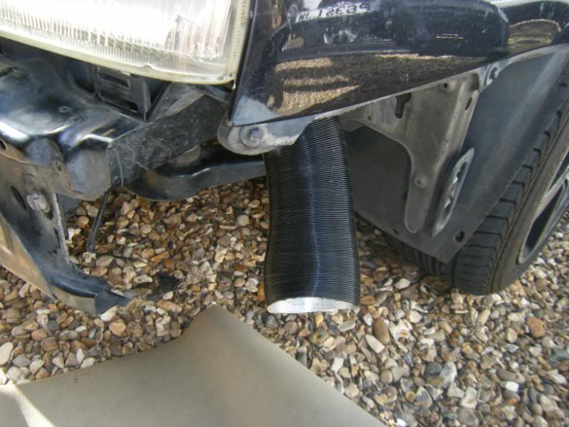

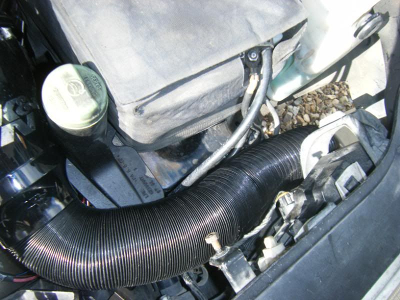

And finally heres the cold air feed I fitted up quickly for the time being, does the job but isn't great which is why I'm working on moving it over. The ducting comes out of the wing and goes down into the bumper vent scoop thing
All looks a bit of a bodge job I know  :grin: Its being hard work trying to get things done with the limted time I have and also having to keep it on the road for work etc, but its deffinatly coming along :) Next mission moving the cold air induction and getting the cat ordered and fitted
Edit: Some of the joins look a bit dodgey on the bends I know but I've done my best to only put the clamps on the straights just after the bends, I think they are all ok for the most part but once everything else is done I'll work on getting a boost leak kit thing or whatever it is you use :P

You have alot of pipes in there. See what you mean about the battery.  I that IOU would have deleted SAI system?
Mk3 ABF 16VT Megasquirt V3
Re: Dan_GTi8v, 20vt project [On the road at last!]
« Reply #122 on: 26 May 2011, 09:56 »
Would it not be better to move the battery and coolant bottle to the drivers side.

Wouldnt be difficult to move the battery no, its what I originally had planned to do, but I would still have just as many pipes and everything all over the passenger side so decided it would be neater to route the air feed pipes over to the drivers side instead.
Looking at the way the Forge tip replaces the oe part it looks like I can just clamp a silicon bend in place of the metal section and run an ally pipe up/across with another 90 degree bend taking it around the block and somehow incorporating the oe rubber piece with the cone onto the end of it so it positions it somewhere around the wing. That would also give more room to route the ducting as well and I'd imagine it would be a bit colder over there maybe too?
tshirt2k yeah thats why I deleted SAI n249 and n112, 1 to make more room and make things look a bit neater (lol) and 2 my generic map has the post cat mapped out
Every bit of work I get done my list of things to do seems to get longer!
