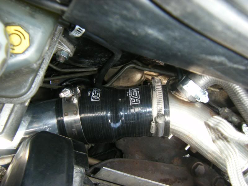

Do you not have that IC piped up yet? once its all done, i'd definitely make a boost leak tester to make sure all your joints are tight. One of your pics shows a jubilee type clamp and its on a bend. Very suspect! I had lots of issues with leaks and had to find solutions for that.

 The whole of the piping is gonna be redone when I finally do connect it all up. The bend you mean is the one on the reducer? its straight inside I've just pushed it right up as close to the bend as I could get it, Its mostly metal on the inside :)
That piece will be gone when it's finished properly as well as I'll be using a Forge dv coldside relocation so wont need that oe piece anymore, was just making the best of a bad situation when I joined it all up :P

No the cooler still isnt connected up, its been top priority since getting it on the road, but times been short lately :(
This one.
This would almost definitly be leaking on that jublilee clip. Those reducers can be cut down, but they dont like to seal on bends. I've just had to add diy beads to my pipes because i was having regular leaks.

yeah I dont like this either, as usual I was rushed to get to work while doing this and never got round to doing it properly. I think I have everything I need ready to get it done tomorrow, if not next day delivery will sort it on Tuesday :)
