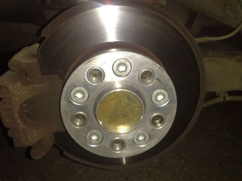

right I've had a half productive day...
rear spacers made it on then back off as the standard bolts are too long for the threads so some modification is needed...

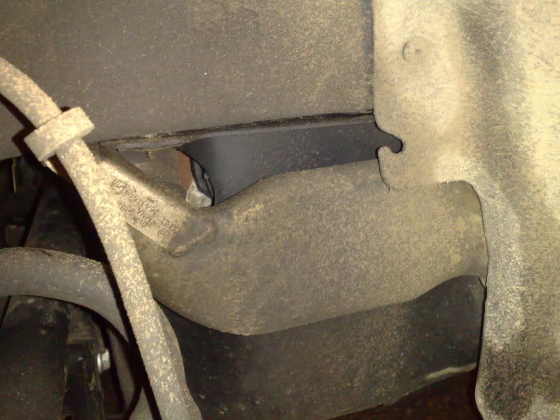

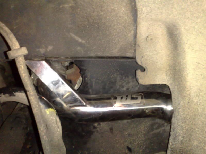

So I turned my attention to the front and fitted the 5mm spacers and the THS PCR pipe
from this
to this  :wink:
no pics of the spacers but they aren't that brilliant to look at  :grin:

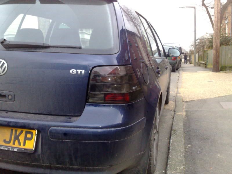

Had a bit of a better day today, fitted the black Hella Magic Colour rear light I have bought recently
and also just fitted my rear spacers now I have the correct size bolts
I'll give it a wash 2moro and get some proper pictures  :wink:

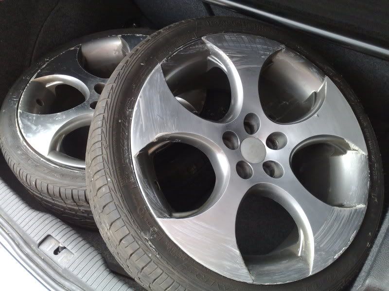

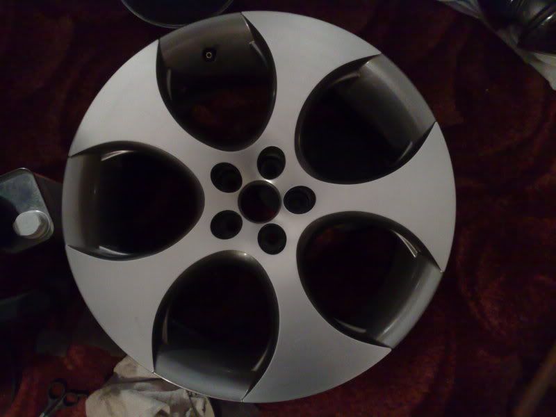

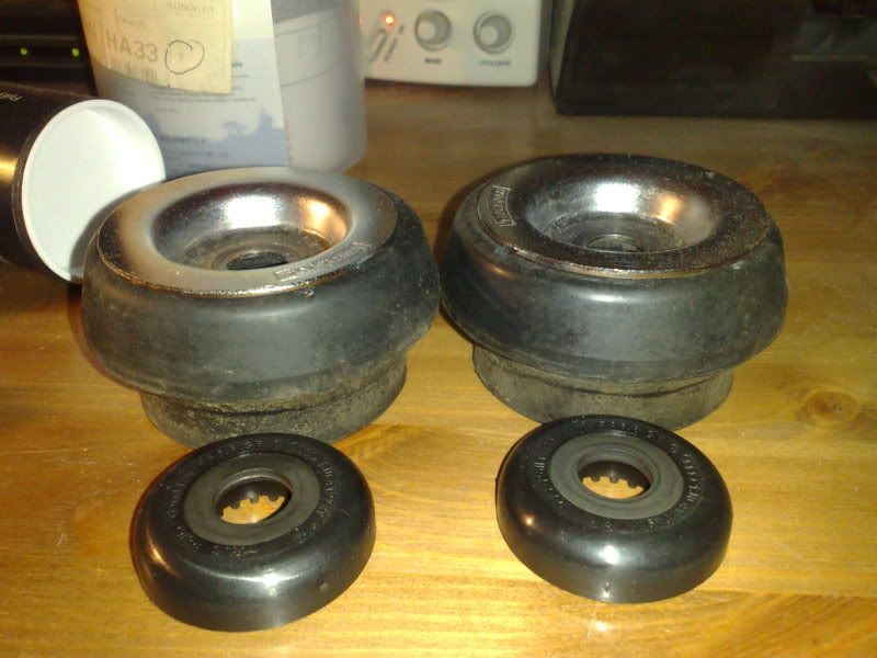

I've finished one of my wheels, sanded all the old machining marks and any damage out, and taken them up to 500. This one is my test wheel so assuming the lacquering comes out ok the others will be done the same as this one, albeit quicker.
I bought a set of Bilstein Sports shocks as I'm fed up with keep replacing the rear shocks on my JOM kit, just cos they can't get them to survive more than a couple of months. I'll be keeping my lowered springs so that's something.
I've also got myself a set of poly top mount bushes for the suspension. These should last a bit longer than standard rubber as I've noticed mine have started to crack already and they are only about a year old. They also lower the front end by another 10mm which is good as I've never been happy with the drop on the Golf, I think it's an optical illusion as the arches are different heights.
The shocks and top mounts will be fitted on Weds as I'm driving down to Weymouth on Sat. I think the constant squeaking from the current rear shocks would destroy me...

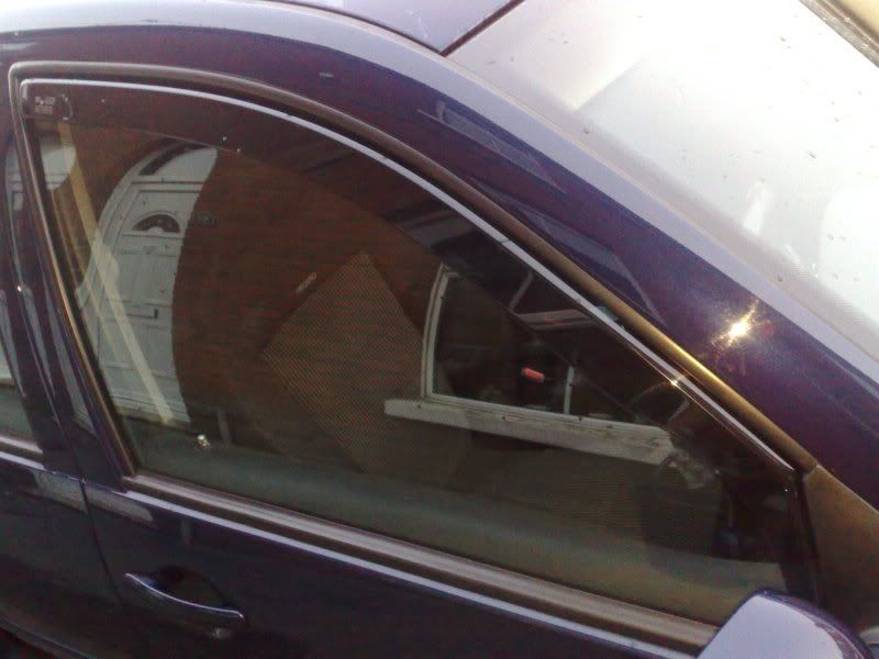

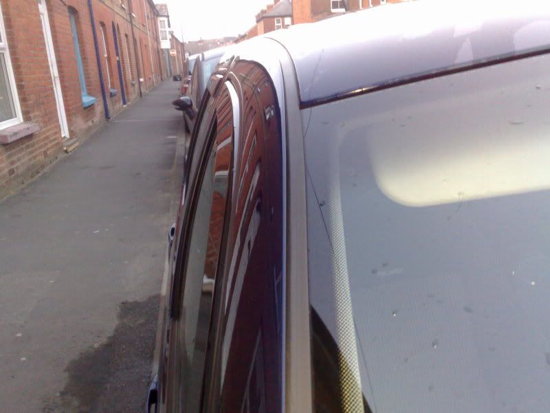

My Heko wind deflectors are on the car, not to everyone's tastes but I like them and they do the job
A proper pic of the back end with the Hella Black Magic's fitted

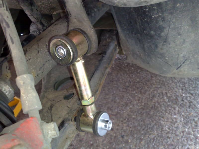

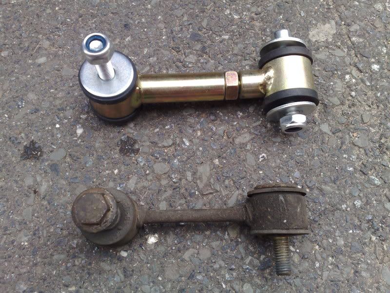

My adjustable drop links...
will fit them this week if it stays dry

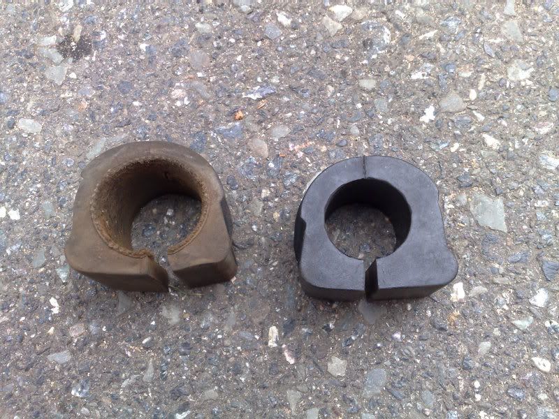

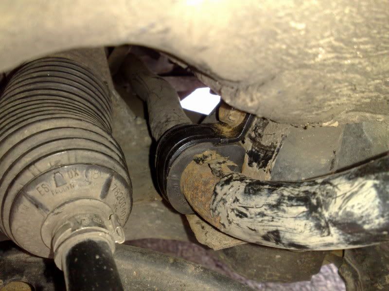

been busy today and got the drop links and new ARB bushes and clamps fitted...
ARB bushes were a little bit fooked

I've gone in a different direction with the finish now, the insides will be black and the spokes in roughly the same colour as my wheels now but with a black base coat to make them look a bit darker. I've ordered the paint and should be picking it up 2moro
I want the wheels ready for Inters so I have 4 weeks to get myself in gear!

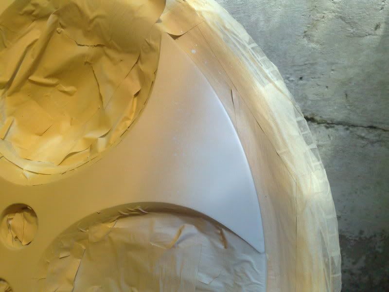

a quick update on the progress of the wheels
sanded them down with 180 grit on a palm sander
then masked up and a coat of etch prime
then a quick rub down with 500 and a coat of high build
got the other wheel to the etch prime stage, will be rubbing the high build down on Friday and giving it a final prime and maybe a first coat of colour
will update with any more progress in the evening

I found a small dent in the edge of one of the wheels so I sorted it with some chemical metal this morning
you can just about see it under the etch prime (told you it was small)
both front wheels are up to the same stage now and will have the first top coat going on Monday :smiley:
