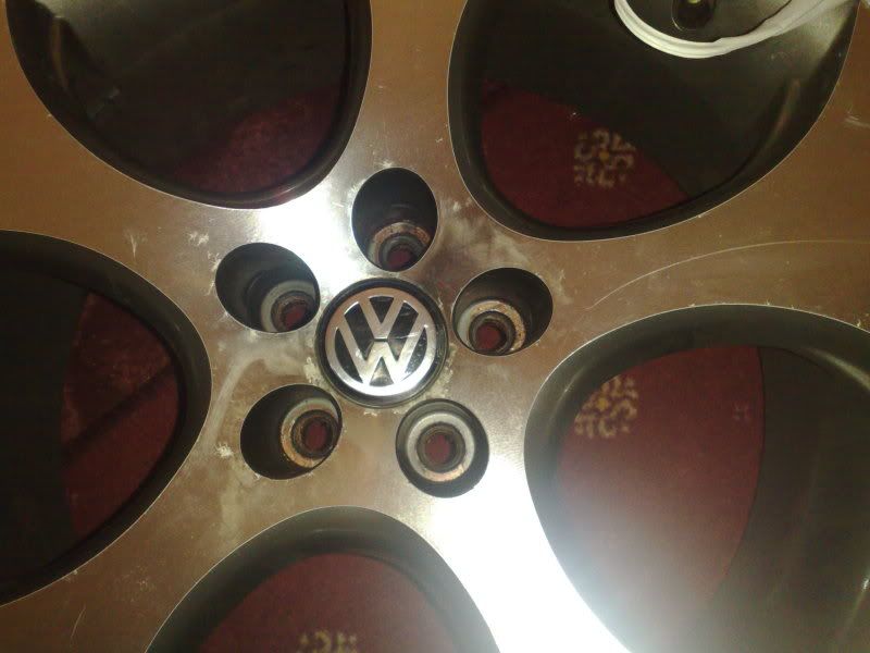

the wheel project has begun...

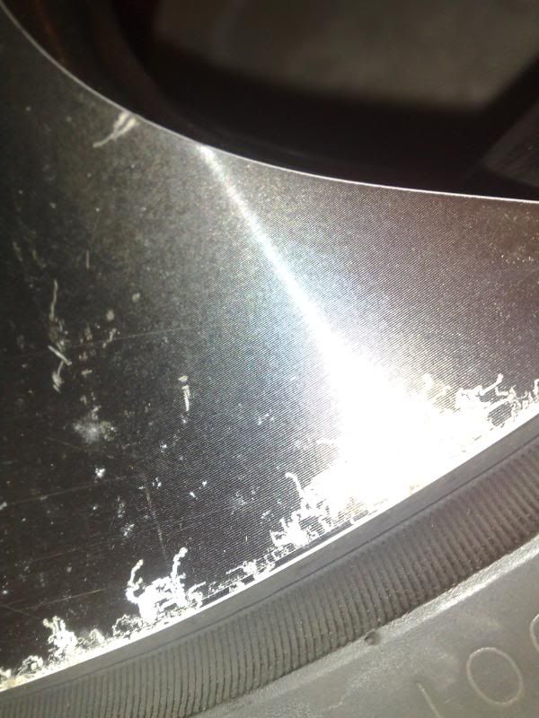

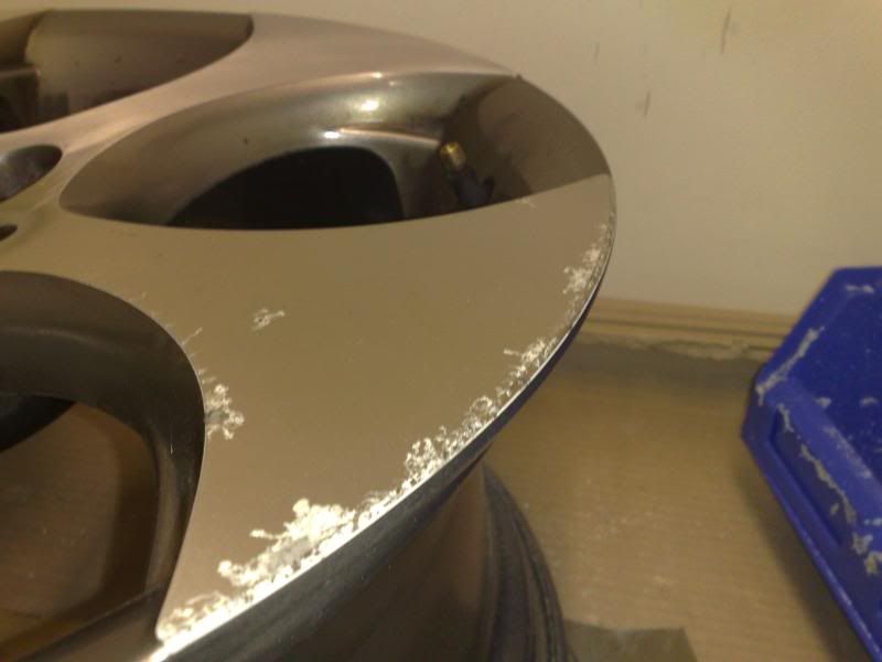

here's a few pics to give you an idea of the water damage that was under the lacquer
the 2 front tyres have been removed and thrown up the tip as they were a little bit worn

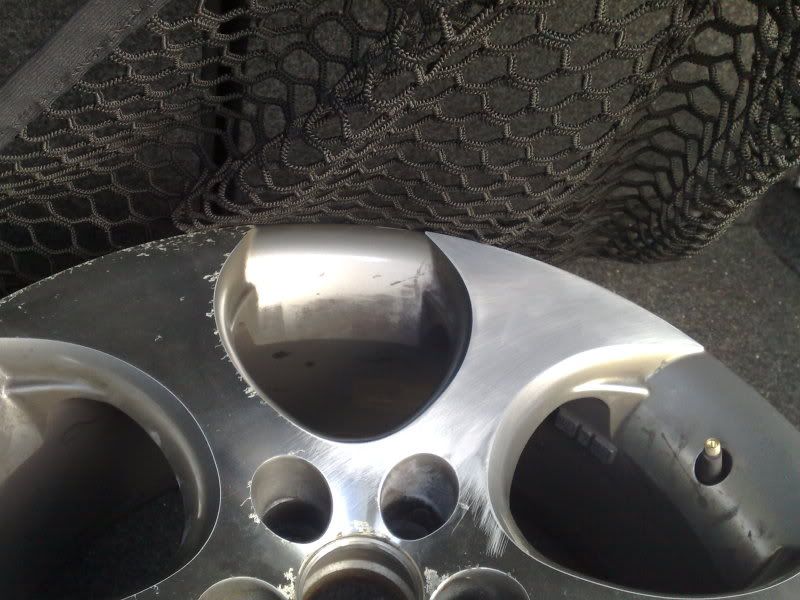

I took one into work to see what I could do with some 180 grit Abranet and I've got to say I'm very happy with the result
It started like this
and after 10 mins of rubbing
the spoke on the right has been sanded with 320 grit
I'll take it to 600 next and see how it looks, then maybe 800. When I'm happy I'll chuck a few coats of lacquer on with a light sand between each coat to seal them in and bring out a nice deep shine

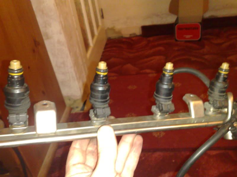

been out in the cold today taking the inlet manifold off to change my injector O rings and the injector seats which are worse than I thought...
I then had a bit of a panic on as I realised I had no tool to get the seats out (they wind in/out), so it was off to the shed to try and find something I could use and I came up with this
17mm bolt with 2x17mm nuts wound on, works perfectly  :smiley:

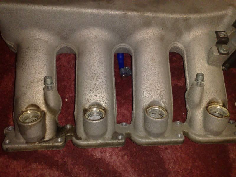

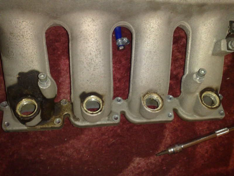

after winding the seats out I cleaned up the inlet so I can tell if there is a leak again
before
after

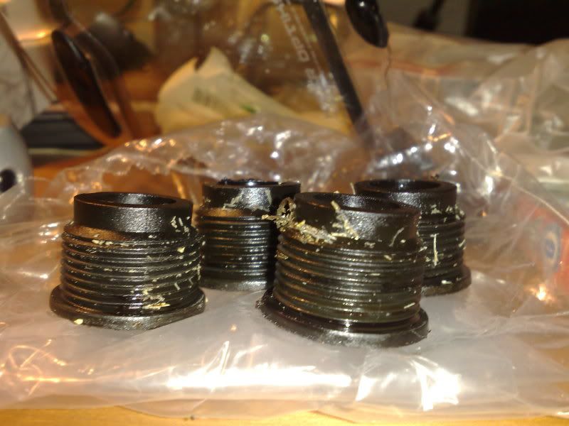

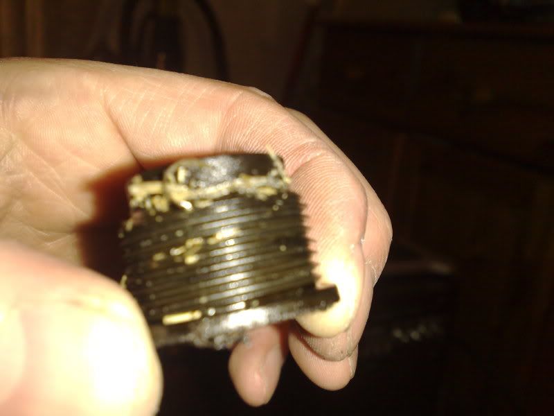

this is the state of the old seats, you can see how wet they are on the threads and how the sealant has detoriated so it looks like it's been leaking under boost...
I had to postpone fitting them back in as I don't have any sealant, gonna pop to Halfords 2moro and get some instant stuff so they are well sealed. So I started on the injectors themselves and fitted the new O rings to each one
All ready to be fitted back on the inlet
and as it stands now, just waiting for some daylight and I'll put it all back together
I'll update when it runs again, it goes into the body shop on Tuesday for the bumper to be repaired so I need it sorted by then

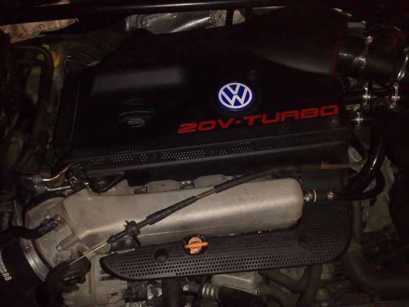

and we're up and running again, doesn't look like I ever touched it  :wink:

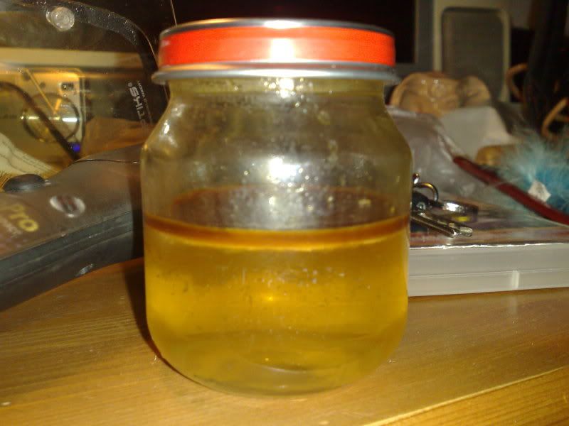

I also took the chance to empty out my catch tank and got this lovely lot out, yummy

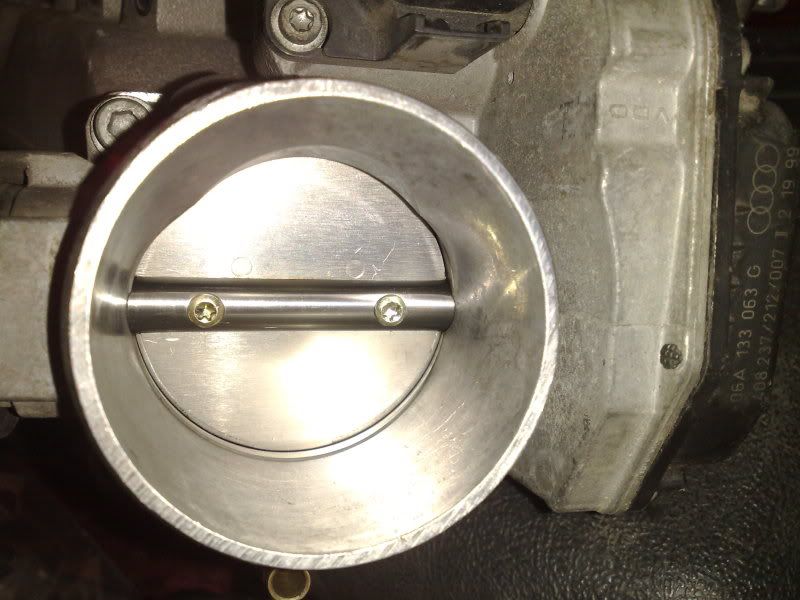

also got a pic to see how well the catch tank is doing with keeping the oil vapours out of the mixture and the results are very good
As you can see the throttle housing is very clean, last time I cleaned it was July

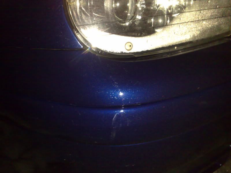

Picked the Golf up today and I've got to say I'm very happy with the repair. They've even sprayed the valance, it was looking a bit tired so that's a bonus
A quick pic of the area that was damaged, not great as it was dark when I got home.
