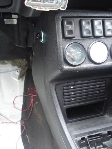

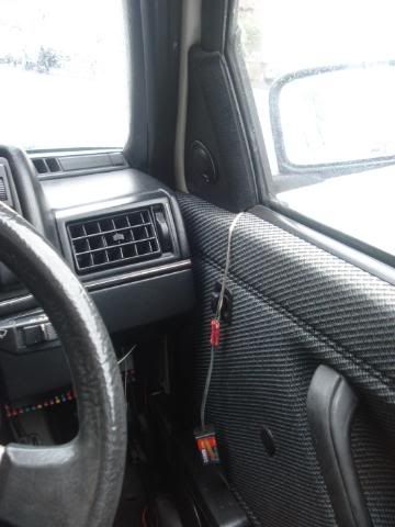

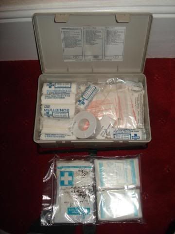

Couple of details inbetween.. These crossovers now reside behind the doors, and the cig lighter is finally fitted!

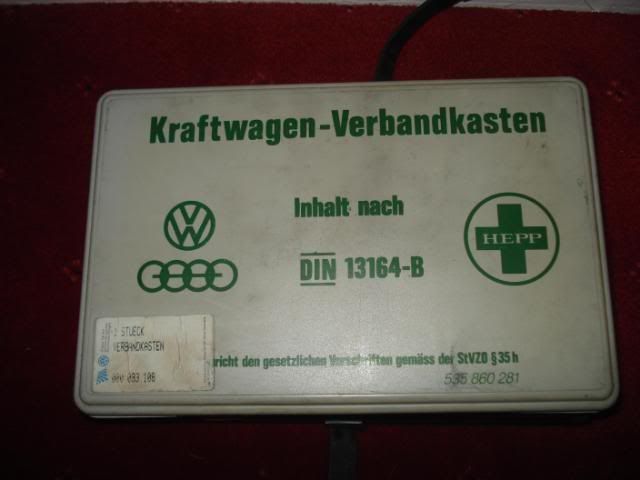

Genuine first aid kit, original! added to the collection..

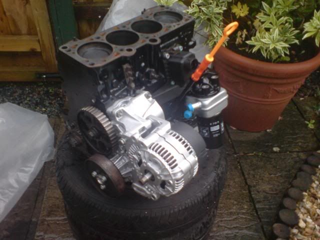

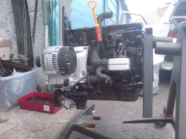

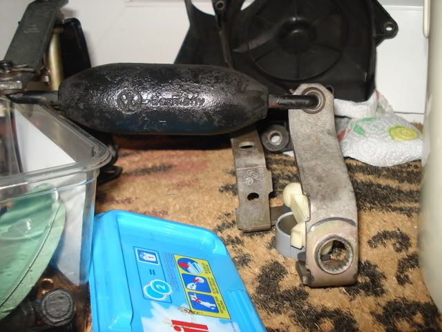

Engine stand has been borrowed from mr diamond Hell.. A lot of help from both DH and Danny P has been takne on whislt harring around the 2 track syncros  -which comes wholly appreciated it has to be said  :smiley:
More painting ensued..
Then duly fitted up!

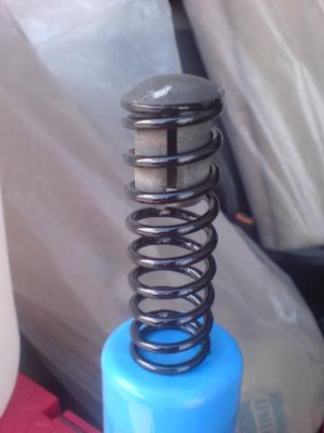

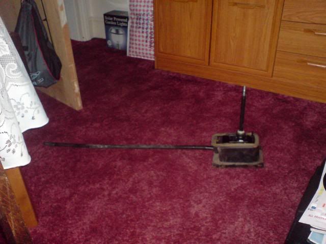

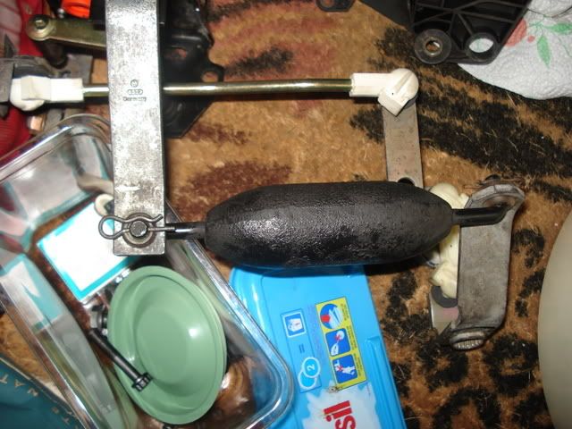

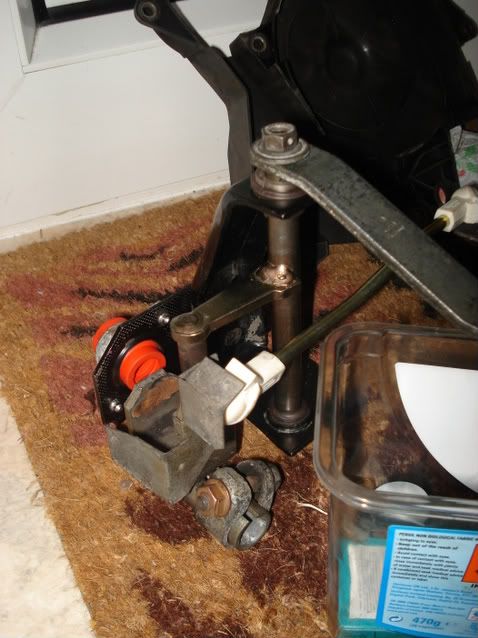

And then my gearlinkage kit arrived!
 :smiley:

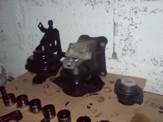

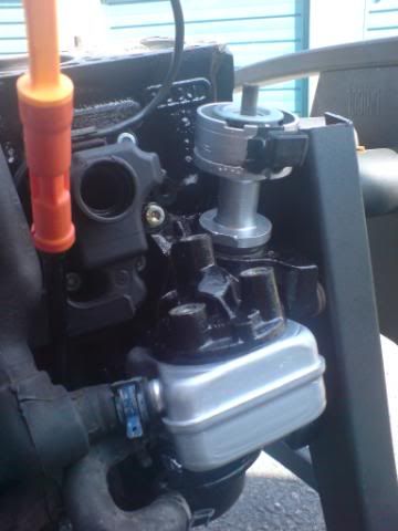

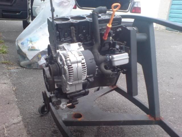

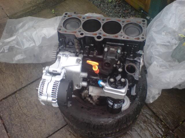

Then an investement in the most solid OEM mounting possible appeared.
G60 rear engine.
1.3 gearbox.
1.3 front engine.
These have been fitted to Danny P's motor and now the ABF in there is standing very very firm  :smiley:

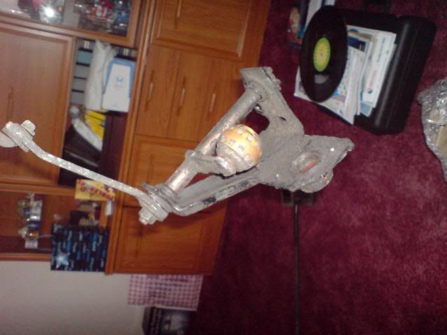

with these mounts ill be building up a fresh subframe. powdercoated with poly wishbone and ARB bushes. fully rebuilt 256 or even 280 braking assemblys to the sides and a PAS setup between  :smiley:

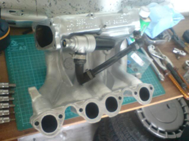

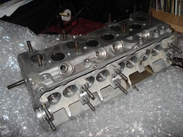

rear axle will also be compelted and then all the solid lines throughout the car from MC which will be 9" servo 22mm mc combination swapped whislt everything is out and open, before the 2.0 is dropped in with the clutch kit ive picked up cheap, and the 2Y box i will be fitting to it. This will be compelte with a 0.80 instead of 0.91 ratio 5th gear from a CHE mk3 8v gti box for 3k at 70 in 50th rather than 3.5k RPM  :smiley:

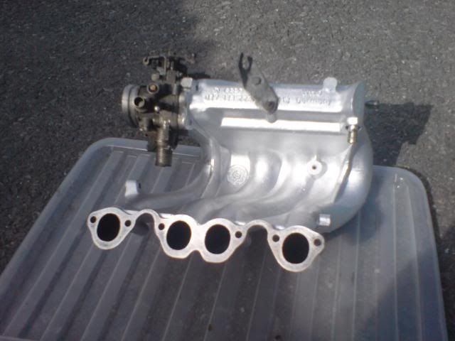

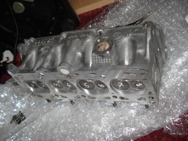

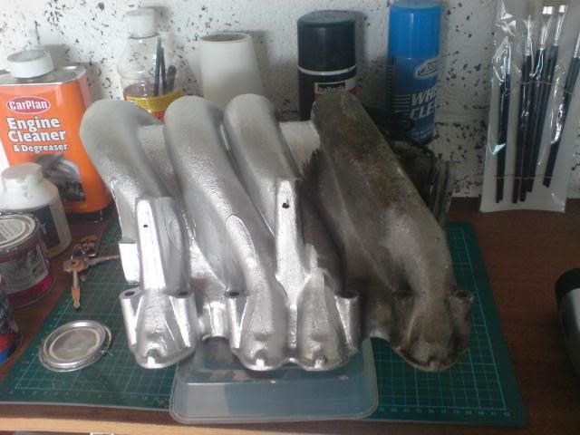

Head will be fitted with a kent GS1H cam. sump has a 1.9diesel windage tray fitted, throttle body has been shoved through ultrasonic cleaning along with the head, ECU has a Digifast chip from the states fitted and ready to roll.. gearbox has all new seals on the outboard of it.. cant think of much more off the top of my head currently!  :laugh:
I'm hoping by fiddlign with everything in such a way ill know roughly enough to be able to look after the car in any situation, and also know enoguh to fiddle with any others that come my way to a degre.. and finalyl be able to enjoy the car without fear of reliability issues.. though theory doesnt always become practice!  :grin:

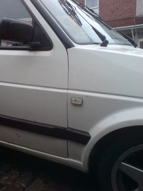

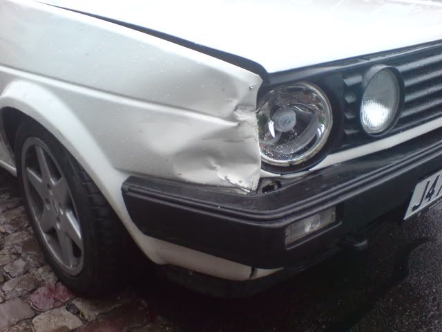

Wet and greasy roads.
Large vat of sitting water as you cross this large junction.
Civic stops in front of me half way around the junction, unsure why.
I brake, doing 20, fair way behind him.
Railings? No. Civic? That'll hurt proportionally less!
*swerveatlastmomentandcatchhimunfortunate*
Unfortunately I hit the sitting water cut straight through it and continued to slide..  :cry:

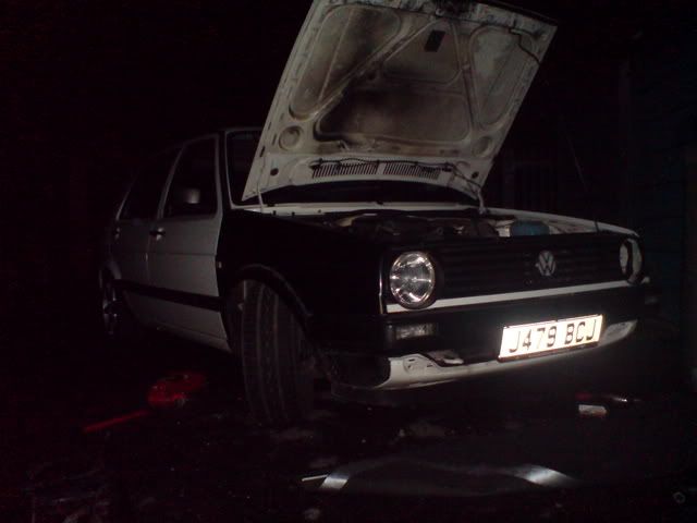

It's the wrong colour but it was all fxied within 5 hours of it happening.. so do I really care right now  :rolleyes:
Just an excuse to get the wing repainted now. Sunroof panel painted jsut incase the original goes back in.. and the wheels done finally..
Cars.  :rolleyes:

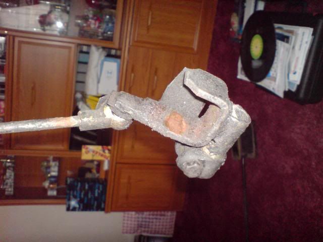

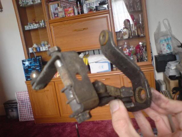

New addition.. The missing link!  :cool:
