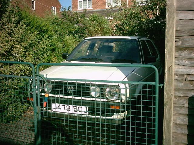

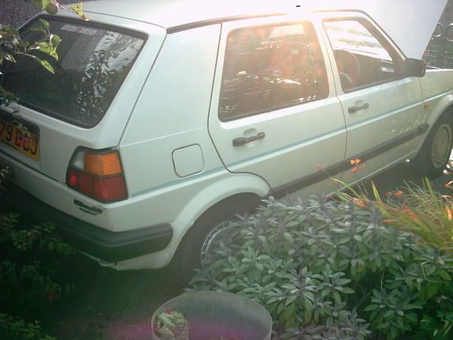

so there she is, first things notice, side repeater to change, jsut a broken clip, the door handle off side rear was destroyed, as was the aerial, both now replaced so all in working order, speaker pod in passenger door looks like its been icked to bits, so have to buy a new one of them to install, and neds a dman good vacuum, these pictures are jsut from my cheap digi.. for now

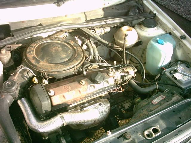

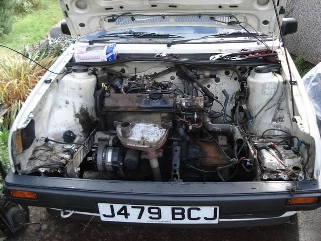

Engine bay currently:

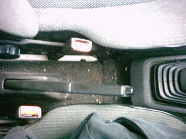

The dirt clogging the entire car:

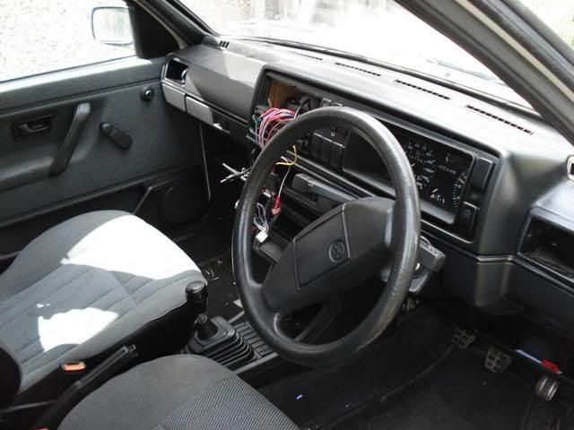

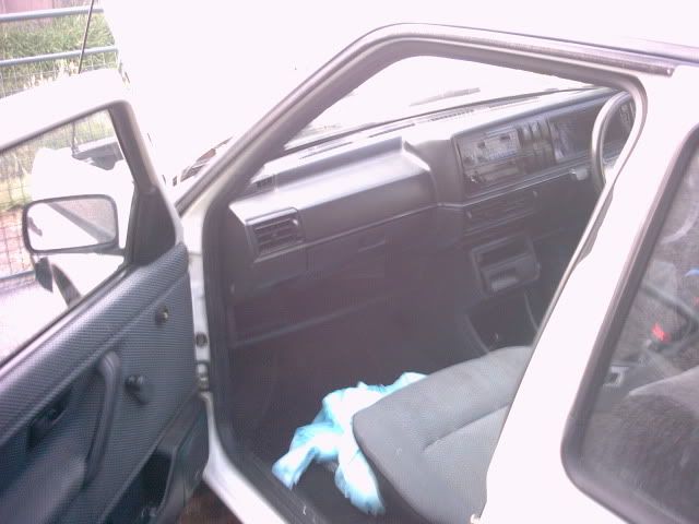

View of dash:
Side view from rear
Through passenger door:

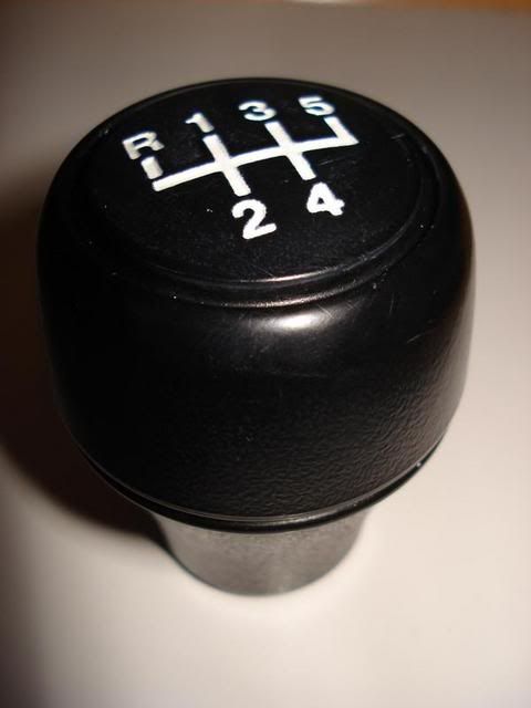

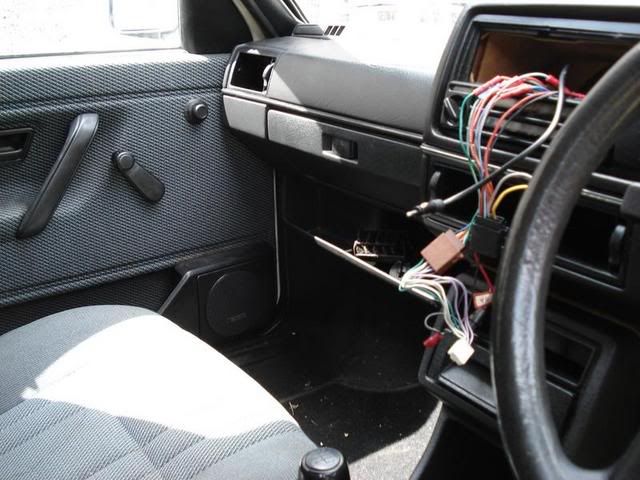

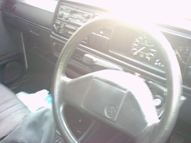

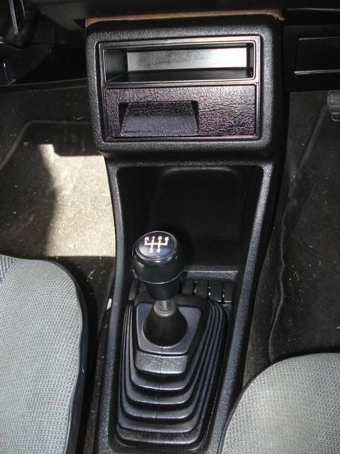

current cosmetic stae, dirty and faded, c*ckpit shine galore to come! remvoed the vents and cleaned them out, they look a lot better now, note the gear knobs current blacked out faded look.. took to it witha  fine brush and my old airfix paints sunday night to come out with one very nice result, im quite proud of it i must say! remvoed the centre console for a clean and buff, and then temporarily replaced it to see what the gear stick looked liked aafter a bit of brasso..
artsy gearknob photo
inserted console and knob
wahey!

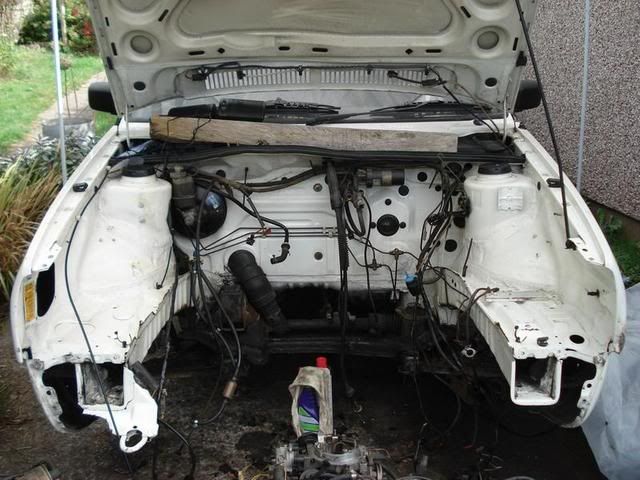

« Reply #7 on: 05 September 2006, 22:32 »

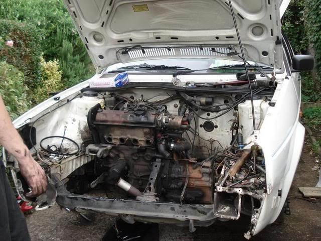

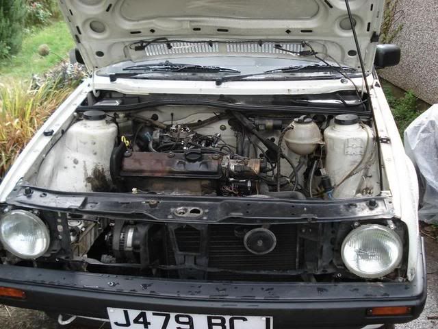

grille and air filter gone:
battery next, look at the grime!
crossmember out
bumper off and more disgusting grease and dirt appears

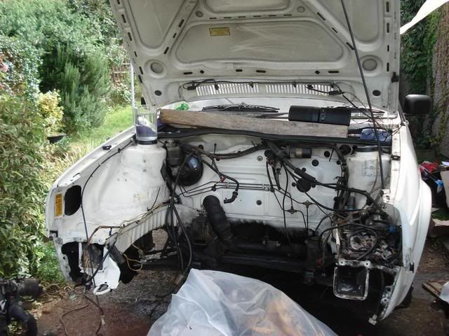

manifold removed, attempting to remove exhaust but its stuck, fast.

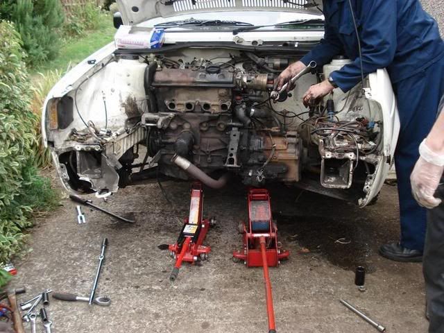

subframe and moutn gone, engine on jacks..

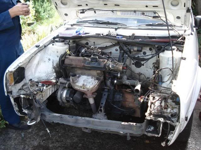

after this we attempted to remove it but the sheer weight was unbearable, return on monday with an engine hoist is on the cards!
i wrote this prior to this post so it seems a little out!
this was written when the old engine was still there and we had bought the new and began the replacement
originally we changed the head gasket, the ehad was skimmed down at this point to its limit, so it may still have been warped unfortunately, i can see oil currently seeping form the head gasket, after hardly running, but it was burning fuel extremely bad, mile per gallon maybe haha. well, conlcuion, carb gone, valve stems, oil seal, head dead.. i wasnt letting it go, so a new engine it was. weve been working on this this week, managed to get a hoist in the end for it as well.
This engine came from a Polo Mk2, its a 1.3 again, so the exact same block, just going to transplant it all together now, the new cambelt, fan belt, and sparks were added to the current block, so theyll be reused, and also going to move across the starter, exhaust manifold and the new gaskets and the alternator as its all in better shape. Should then be running by the weekend!

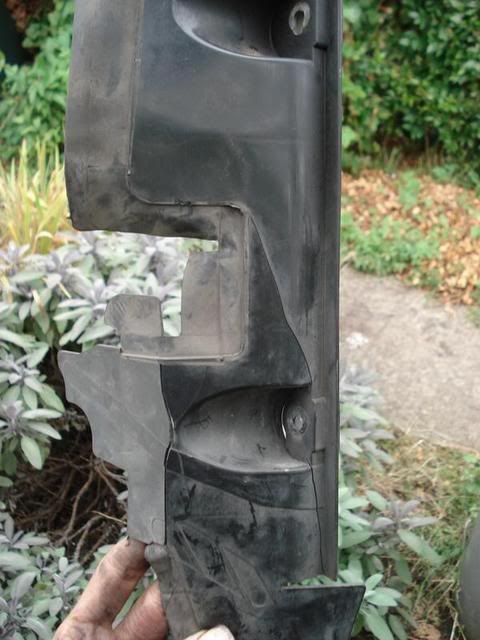

wind deflector destroyed, to be replaced, should help with the overheating problem!

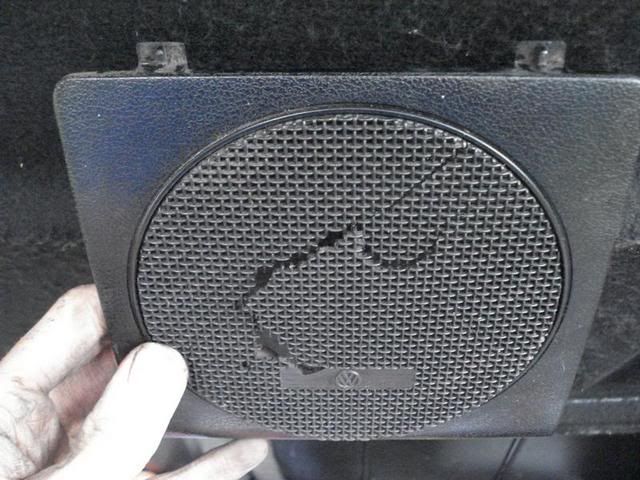

speaker pod damage

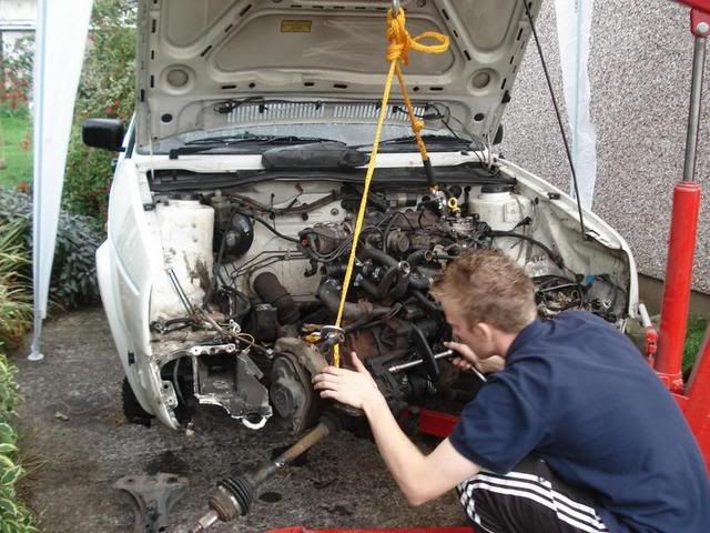

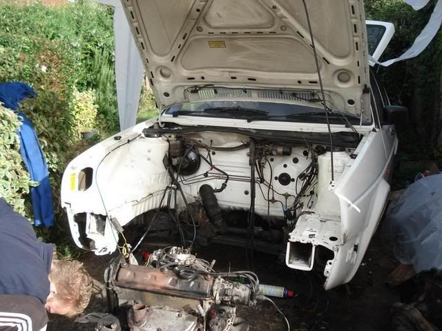

ok so the engine is finally up and on its way out on the hoist..  :cry:

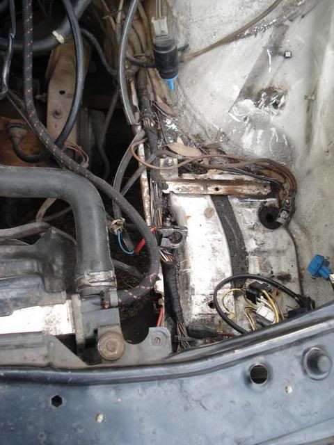

and then it was gone, and the cleaning began inside the left wing and rear of the bay..
this soon followed all the way around
and got a good polish up  :grin:
the enw block sat there while being worked on.. we now have a new clutch in palce on it, the old one was bare, needs to be hoisted up tomorrow, gearbox slipped in and then remounted, couldnt be doen today due to needing to tap and die the mounts on the rear of engine on the driver side, so it should be in tomorrow, also as visible in the picture, restrapped and laid all the cables, will get a proper tidy and tieing up when the block is back in and the bodywork together. going to get some wirewool to sprakle up that head and block and gearbox once its back in to, should look nice and new!
