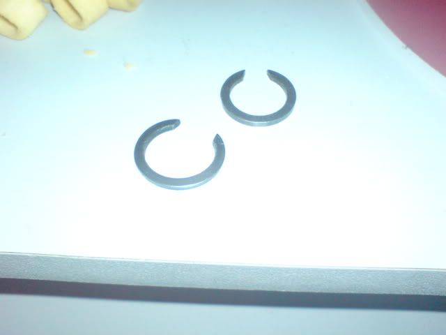

So, circlip was off and needed replacing..
As you can see the width it reached stretched, jsut through removal was significantly losoer and larger than it's new counterpart. A nice pair of circlip pleirs side on soon opened the enw one enough to slip it on and drift it down with a suitable socket. Job done  :smiley:

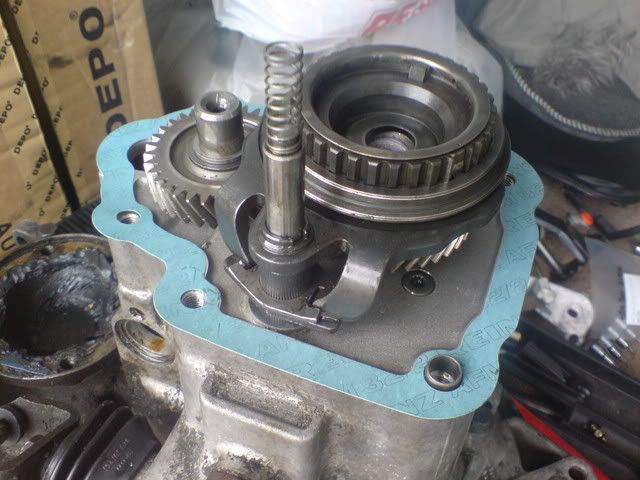

Thus gear was refitted fully, 5th bolt still to fit (box needs to be locked in both 5th and reverse to be able to torque the bolt up to the req'd 150Nm!) but the selector fork was fitted with tis 5mm of protrusion and the lockpalte had to be reused - oddly these are now obsolete from VW  :huh:

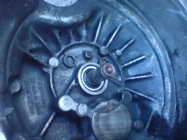

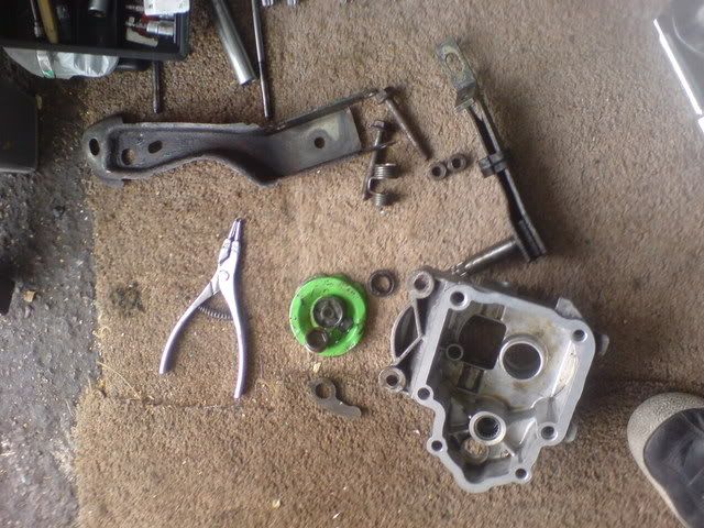

Next was to refurb and check over the 5th housing. So, remvoed was; green cap, release bearing, clip, pushrod finger, spring, clutch arm and finally the seal. Everything was cleaned up and check, the figner was found to be perfectly fine to reuse so was then refitted, along with a new clutch arm seal  :smiley:
Bits & pieces..
Housing sat in place..
I have also released the clutch arm retainer clip so as can be seen ehre the release bearing finger can be lifted, the 5th bolt torqued and the release bearing fitted, along with pushrod and green end cap. Pushrod bush, seal and input shaft seal require attention and the selector shaft seal will also be replace, then box bolted up to block!  :smiley:

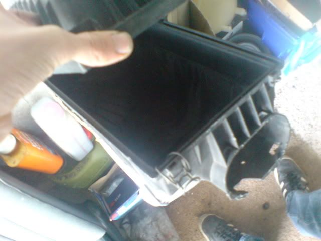

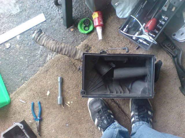

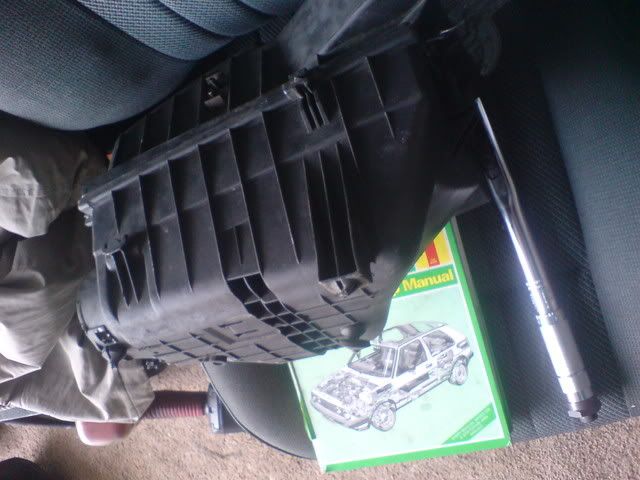

Also picked up a second airbox bottom as mine came with no hot air feed and vacuum flap - later to find the one I had was a diesel one and the vacuum hot/cold one was a proper digifant model. The diesel one seems less restrictive, not only with the removal of the cold air trumpet but the missing vaccum system and sealed over rear meaning all air coming in has only one route to follow.. Wether this will be an advantage or not I'm unsure! Maybe fitting the digibox with no trumpet could be the way.. at elast it'll help it warm up nicer!  :grin:
Inside digi box..
In and out on the diesel..

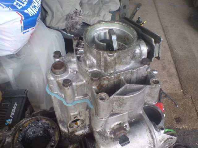

Driveshafts stripped and cleaned, gear stick housing and rods and that, stripped and cleaned, parts from germany arrived.. Things ar elooking ready to be put togetherish once again  :smiley:

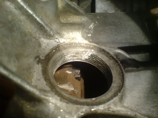

Did have an issue finding TDC the other night. the green plug had been loctited into the box, it required hammer screwdriver and some brutish behavious to get it out but it came free..  :grin:
but the other one refitted fine even with the thread chaffed.

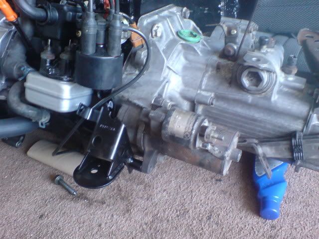

Starter and front mount bracket fitted up nicely and confirmed box was aligned perfect and bolted up no trouble. jsut requries lower clutch cover palte and rear little one by the flange to be fitted now  :smiley:

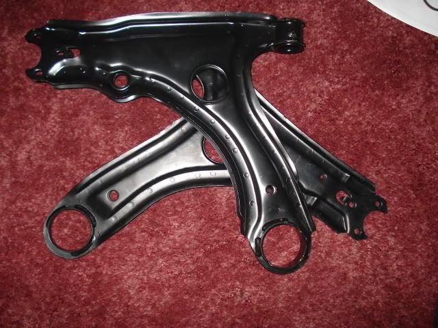

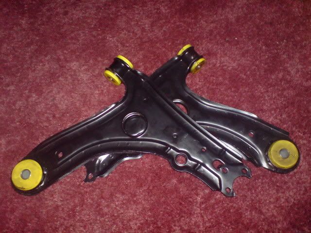

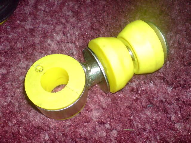

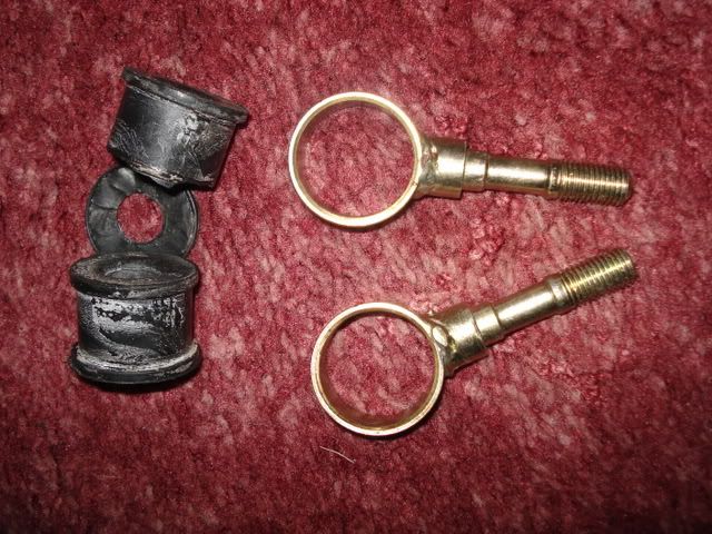

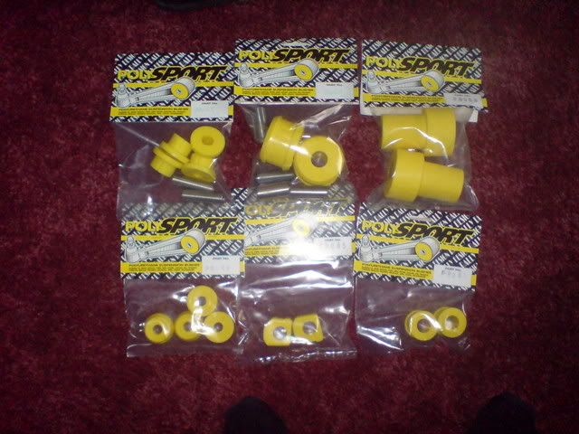

Well, powerflex thought amounted in me buying rally design polysport all round instead.. read up many reviews pointing to these and saying no increase in noise, or reduction in comfort, just optimal steering and handling :grin:
So here they all are:
ARB Eylet, ARB Bolt, ARB Inner, Wishbone Rear, Wishbone Front, Rear Beam  :cool:
And of course these got fitted up into the new bits ready to assemble the subframe..
So as stated, should see more positive and truer steering, and a more predictable solid ride and handling. Still in 2 minds regarding the rear beam bushes but have heard so much positive for them, it would almost now be rude not to try them at least!

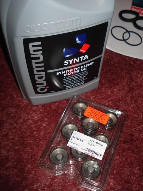

The engine will finally be sealed up soon also.. new tappets are here!

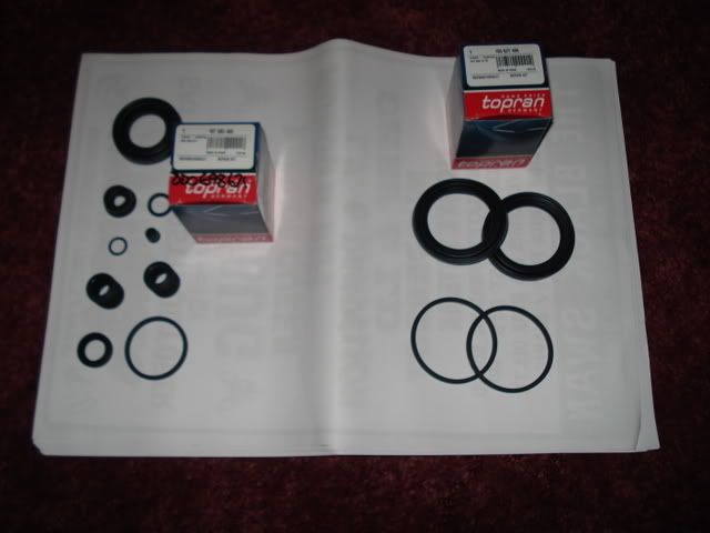

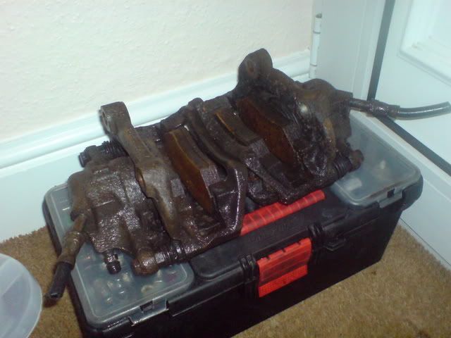

And the brake calipers will get a rebuild also, including the sliders etc upfront and the entire rear assembly's..
