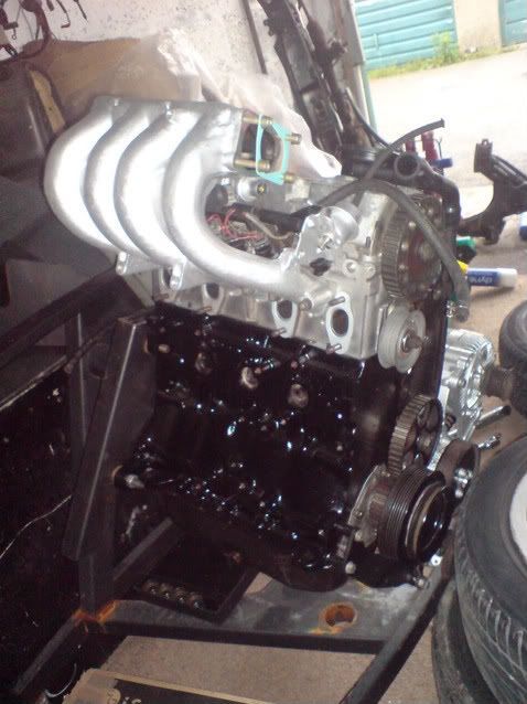

Not been well since friday so no real pics or progress..
This is sort of how i left it friday arvo..

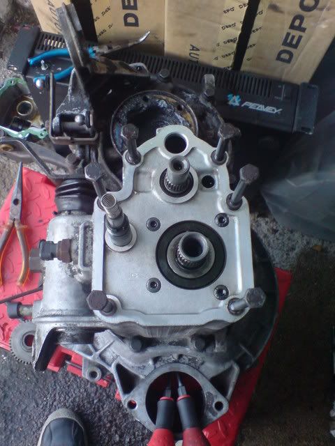

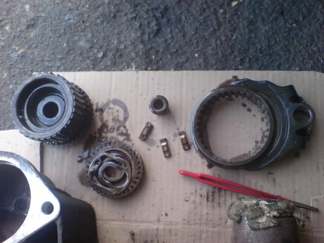

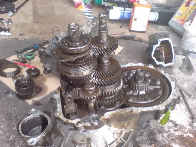

Oh and 5th gear was liberated today..

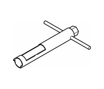

VW Tool 3059 - £29+VAT
Circlip pliers which fit down in the two notches? - £00 (Dad's toolbox)

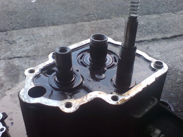

Guess which I used in the end :grin: This is basically the tool which turns the selector rod, so that the selector fork gradually moves up and lifts off the shaft.  :smiley: (visible on the right hand side of the last pic below)
Had to lock the flanges as I hadn't opened the selector shaft to lock it in to 2 gears. Using a VERY strong high torque impact gun still resulted in it taking a lot of force and eventual chkchkchkchkchking for the bolt to release its locked thread. It's fair to say it was boiling hot when it go pinched out with me fingertips. Oh and a screwdriver sorted the locking the box problem..  :grin:
This is what i was left with, 5th liberated..
That's my 0.80 set ready to be refitted to a new home now  :smiley:

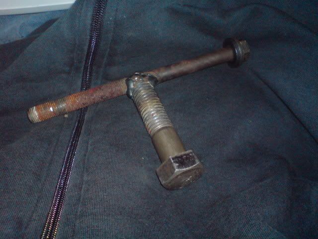

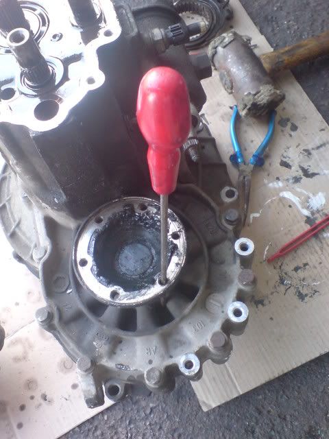

So the TDC window and selector shaft cover have a 27MM recess on.. not a socket job.. no allen key that large.. Bodgery time..
Looks a bit like the VW tool in the previous post at the right angle  :grin:

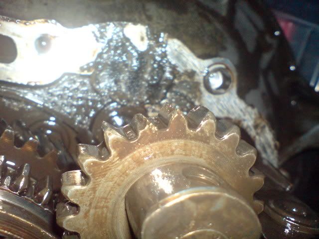

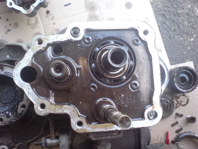

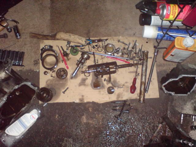

This meant the box was split and many bits removed from it..
Revealing a very ddogy reverse idler.. no wonder this box was a whiner!

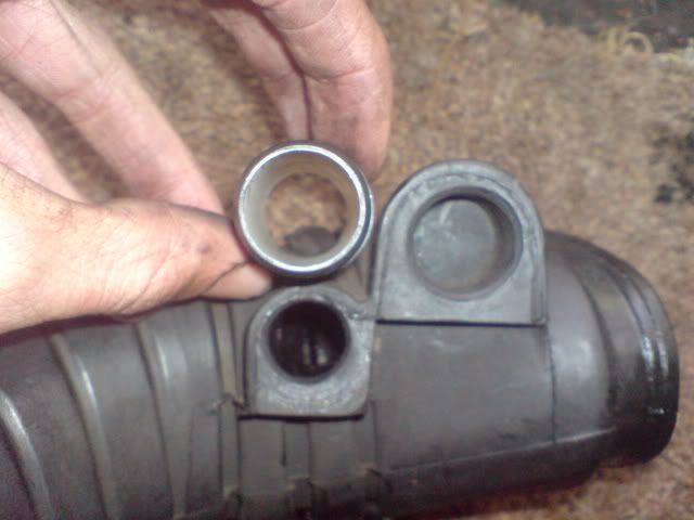

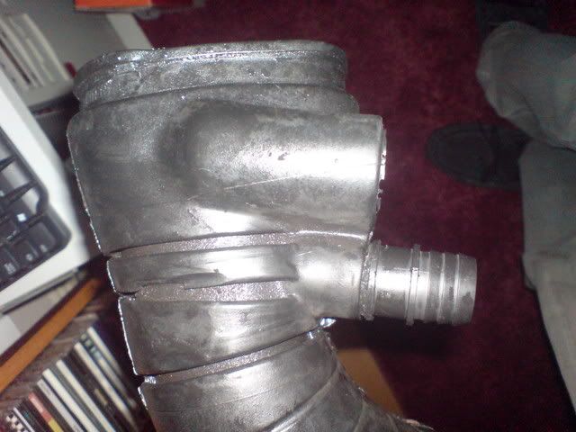

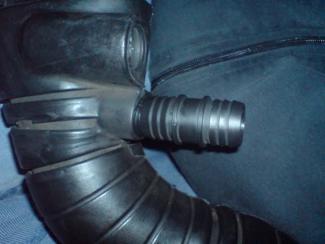

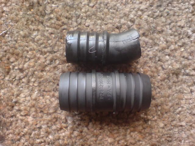

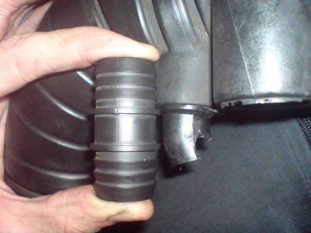

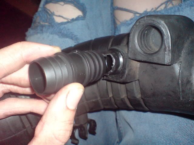

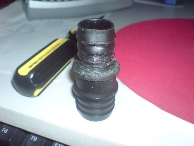

Next was to attempt to put together the mk2 ISV elbow bit and the Mk3 breather.. size here became an issue.. but some jiggerypokery seemed possible..
So the plan was cut off the Mk3 one, plastiweld/glue it to the smaller Mk2 item and have a big to small adapter.. Dremel time..
Biggie smalls is ressurected!  :grin:
Now it fits the boot perfectly. This will now sit no troubles on the throttlebody and couple up to the Mk3 rocker breather  :smiley:

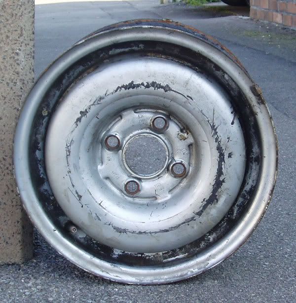

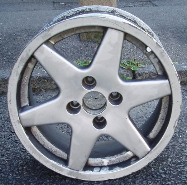

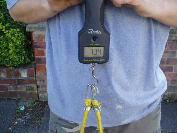

Wheel weight time.. Just to check I'm not outweighing the odds with the other rims  :wink:
All seems well enough to me  :cool:

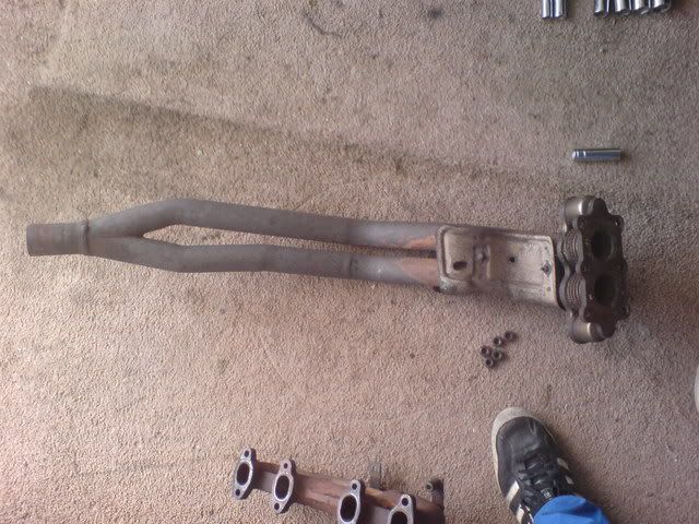

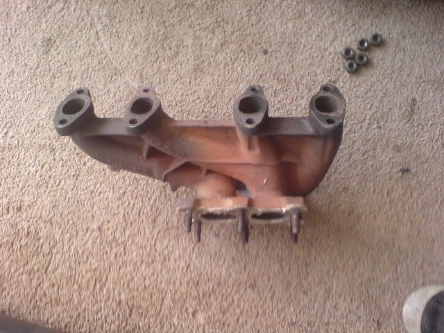

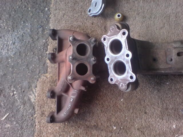

So a few bits today! The misus was round to paint canvas' and that so I sat and fiddle with the new downpipe and manifold whilst we were round there..
Split the 2 rather easily, suprisingly everything just undid in no time! Gasket faces were covered with crap so have been scraped down with a screwdriver and then emeryed, awaiting new gasket! Can't decide if it's worth upping to a 16v DP or not atm, will the extra .25" actually be worth the extra cost, when the possibility of it being mated to a 2.25, or even 2.5" system is there.. hmm? Anyone care to suggest?  :wink:
Manifold and downpipe pre and post cleanliness..

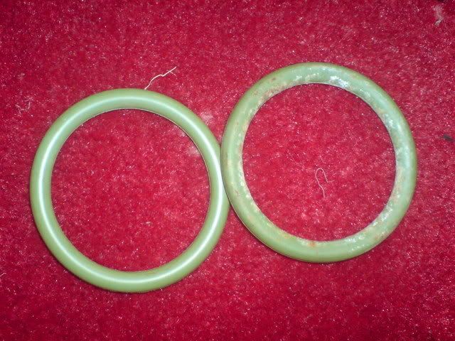

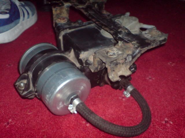

Fuel pump seal, old and new. The old one was seeping slightly so was replaced, it had gone quite soft and was covered in dirt as was the inside of the housing aroudn the mating faces. After a good clean up and scrub out, the new seals in and a new filter bolted onto the side..
Old vs New
Reassembled..

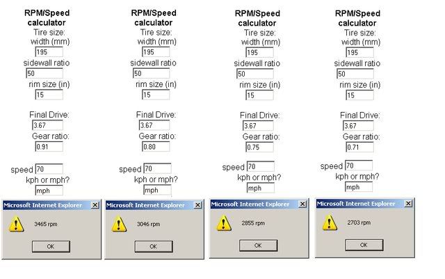

Using this box still means I can use the CHE 0.80 gear I had waiting to fit but will not be using the locking clip to fit the grooved face of the gear, but will need to use an 8V shaft circlip instead.. BrokeVW.com details the swap and has this bit of information regarding such swaps:
Quote
16V codes and MK3 codes up to June 1st, 1997 will only accept the 0.80 and 0.91 5th gear sets. Those gears are the ones that use a deep groove in the top face of the gear for the output shaft, which secures the special locking clip. The locking clip has a tab that fits into the groove to stop it from sliding off. If you get a gear and machine a groove into the face for the special clip to lock in, it'll work just fine.
For 8V shafts, they use the circlip, because the groove is 16.5mm OD. The 16V gears fit the 8V shafts no problem, as the circlip can secure the 16V gear just fine. So, why not use a circlip with the 8V gear in your 16V? Because the circlip is too big to fit the 15.5mm OD groove in the 16V shafts. If you find a suitable circlip for the 15.5mm groove, the correct thickness, and hardness, then you'll be able to rig something up. Until then, you're forced to use the 15.5mm locking clip on the 16V shaft, and that forces the use of a deep groove gear set.
So now I require a new circlip as wlel as the 5th bolt I've already purchased which luckily isn't too much of a hassle! Have also tried revving around 3.5k, 3.0k and 2.8k on the current 1.3/085box combo in 5th. The difference in noise and revving from 3.5k to 3k is very significant to my ears so should make things more comfortable. Wether the 0.80->0.75 rev drop (200 or so more rpm) makes any more difference is not really noticable if at all though.
So next will to be to get the 5th housing off, clean up, swap gears, reassemble with the new gasket, seals, circlip and bolt on top of the 0.80 pair. Then bolt up to engine with clutch and fly! As I previously had a 16V clutch kit to take advantage of the pressure plate, the friction disc then became irrelevant due tot he fact I needed an 8V one, 24 down to 22mm input shaft size being the changing factor. So a quick call picks me up a fresh friction disc for £13, swapped into the kit for the 16V one means everything is ready to go on with new pressure plate bolts et flywheel bolts  :smiley:

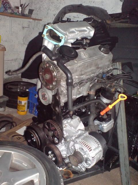

So the 2Y route wasn't followed.. Ended up with an AUG box instead from a Mk2 8v, no crunches, no leaks though it's getting seals anyway.. and now.. no 5th!  :grin:
From this:
To this!:
So the 0.80 gear off the CHE box is going in. Just need to put 150Nm through the bolt and get the spring clip on somehow.. Joy of joys that will be attempting to fit..

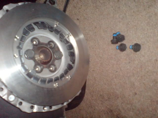

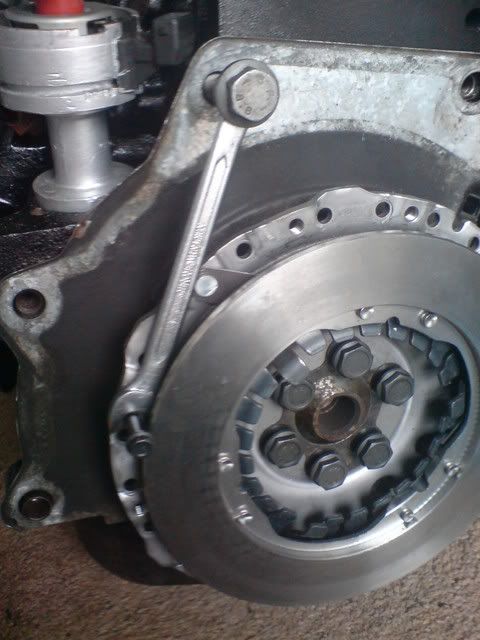

Bunged the clutch on, with new bolts.. note the factory threadlocking
And the bodge locking to torque them up! :grin:
New metal cambelt cover:

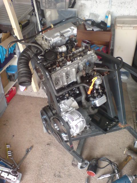

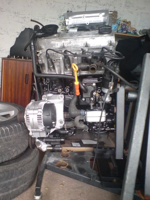

And this is kind of where it got left..

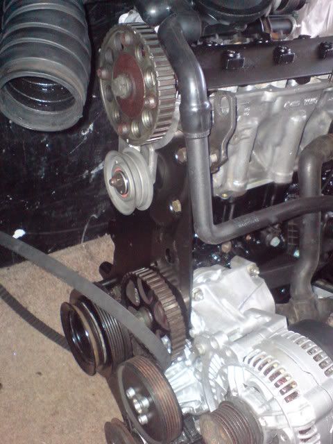

I've since taken the cambelt end pulleys ETC off. checked the vernier and the cam for wether or not tis TDC markings were true which luckily they were, checked everything on the bottom lines up for TDC correctly including crank int. shaft and rotor arm - check. need the tappets to go in to bolt the cam down and get the cambelt on properly now though  :smiley:
Couple of other bolts need finding and fitting such as those holding alternator and whatnot. Exhaust has had a new manifold->downpipe gasket and I've sourced a pair of driveshafts and a starter for it!  :smiley:
Also being over-preparing inclined the shafts will all be recieving a good clean, new grease, and new boots.. Before being bolted up  :wink:
So this should see box mated to block soon! Then only a couple of tiny bits on the main engine and box setup need completing before it can be filed under 'complete'!
Next thing will be to get it in and improve on my currently quite odd 25MPG from the weber on the 1300.. It's never been like this..  :shocked:
More pics to follow in the next couple of days  :smiley:
