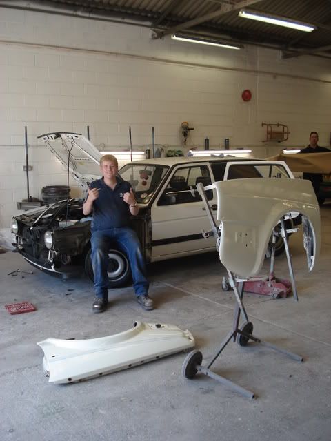

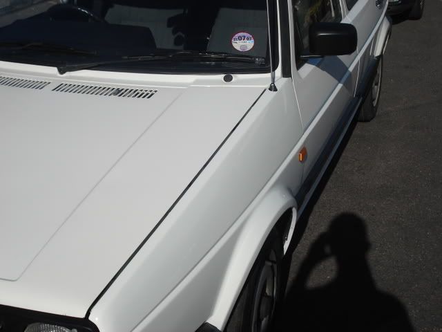

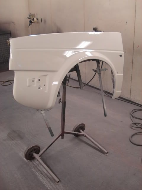

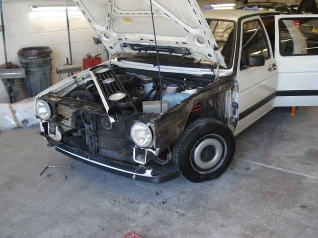

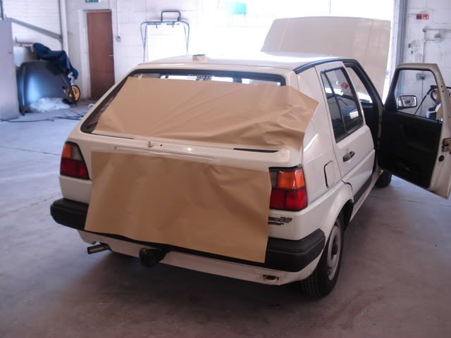

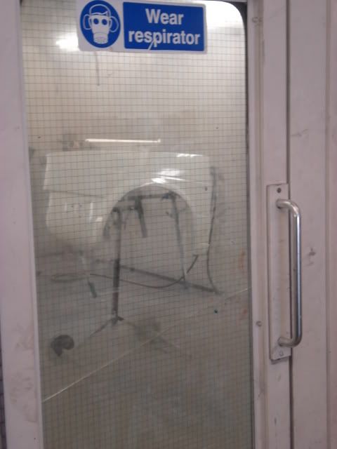

And the boyo went in the body shop last saturday, my mate's boss elt em come in to help, which was cool, mean't i could learn some and watch how it's done, and keep toasty early morning in the oven with my wing  :grin:
Wing after first coat..
Mixed up paint
Wing after final coat

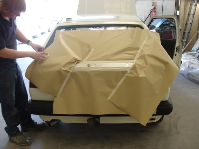

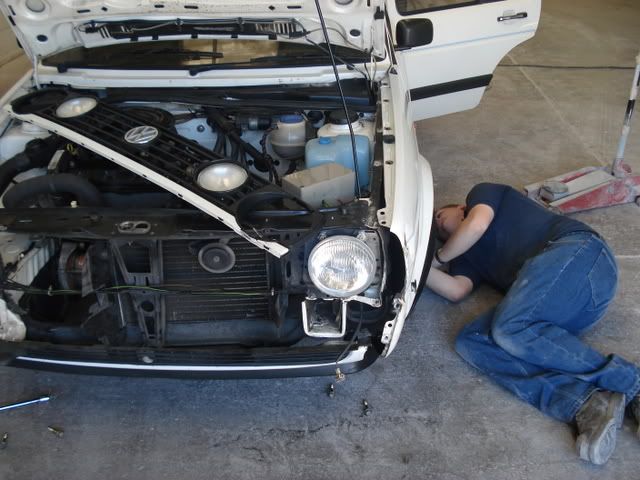

Neil, masking up the rear end where he had a dodgy blend gonig on, the blend now reduced but is hidden behind the rear wiper where it's still not come up too well  :grin:
Neil removing the old wing
Stripped off and looking sorry..
old, new, ready to go
and back on, needs the blue pinstripe and original bumper refitting now  :smiley:
Glad o have it back to it's former glory, only to find a deep scratch across teh roof  :angry:
Dents need doing now, waiting for a call back on that, the rear apssenger door being the worst.. Bonnet a close second..
Roll on volksfest, it'll be sat in the car park, but who cares, it'll look good there in my opinion  :laugh:

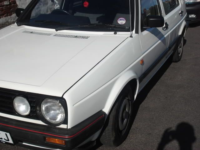

So, a few little bit's recently..

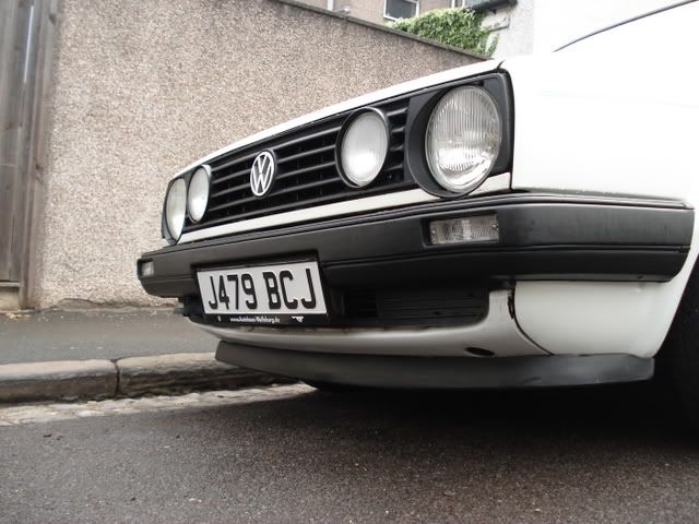

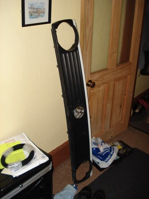

Found a single light CL grille, really wanted the white trim below.. but the whole grille with all intact clips was £10.. so i'll stash that  :smiley:
Got the new front end together, compelte with the bumper it should have, clear indicators with silvertecs.. pinstripe on the new wing, although you cannae actually see it due to it bleaching out in this photo  :laugh:
Tried on the valver rears, and then becky did me some photo chops for comparisons of new lighting to the rear and sides..
Fitted the new foams behind these as well, although back to standard buisness for now, till I find some white top red bottom ones  :smiley:

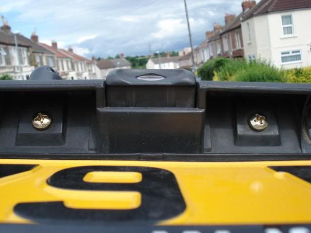

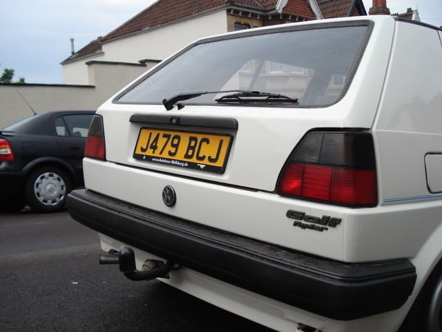

Also fitted the new trim screws up the back to replace those that had rusted.. and my tailgate lock gasket, of which only the left hand lower quarter remained. easy job, plinth of, pop the lock out from behind on the 2 lugs, slap it over, clip it back in and clip the rod in, easy pickings  :smiley:
Only a short one for now, but a fair few bits to come, got the slot seals and that on there to, gonna give the bay a good clean soon and get all my hoses looking tidy, get the oil water off the manifold from the leaky breather soon to, and refit the new hoses, bottle and sump at the same time, an excuse to clean the full oil system  :cool:

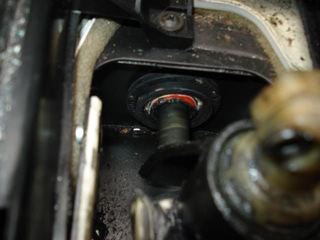

Just a small update for now.. Took the boyo in for a tune up the other week, came back needing a new rotor arm and vacuum pull down unit. The old pull down had no vac at all, when you suck or blew through the pipe a constant flow was, well, constantly present. The rotor arm could be turned on the shaft with a finger also.. very loose like. Tried stripping the dizzy myself but couldnt get one of the centre parts out, the actual rotor plate inside wouldnt shift from the spline, altohugh all circlips etc had been removed.. Ended up rebuilding it, driving to the garage and getting it done, they didnt need to take it apart, fitted it from the side instead. if only i knew prior i wouldn't have made this mess..
Next job is to do the gearshift as well as theres a lot of play, both around the knob and in the ball. Here its visual betwene the 2 pictures that the entire mech can be turnt, looks only slight by picture but feels a lot more, same as when it is in gear it flops a lot. Have been told where the shift finger is in the bay with the metal loop around it, to clamp it as his stretches over time, due to the primitive design it gradually pushes it out with gear changes.

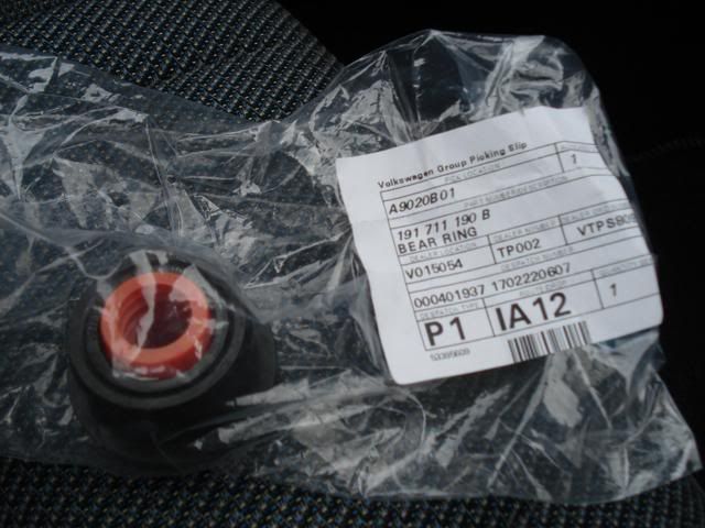

Also got a new bearing ring to replace the old in the shiftbox, to try and help the side to side play.
Got my new cup and ball repair kit and everything, still the sump and breather need doing to, just waiting on workshop availability, and the new gearstick to come, hopefully thi will reduce the play between the eccentric adjuster and the shift rod, and generally renewing everything should in theory repair the rest of the play :smiley:

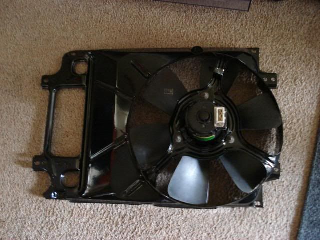

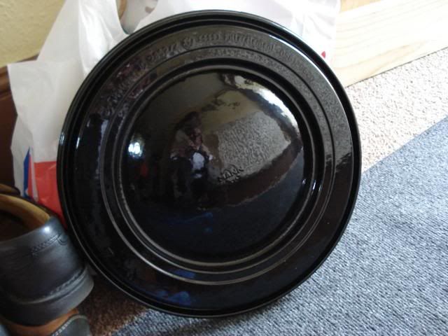

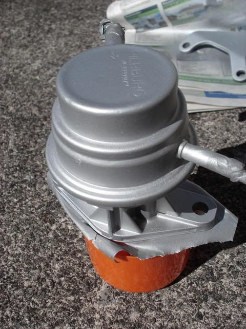

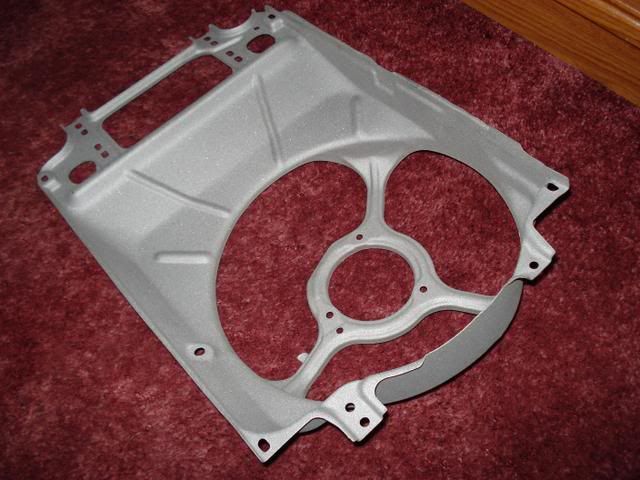

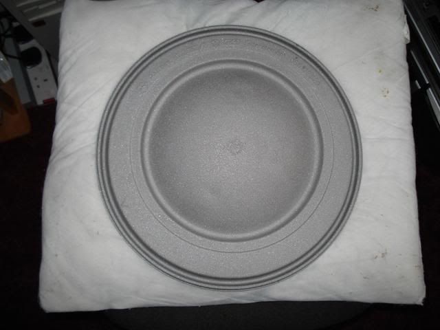

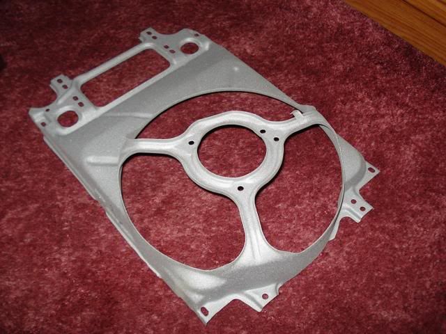

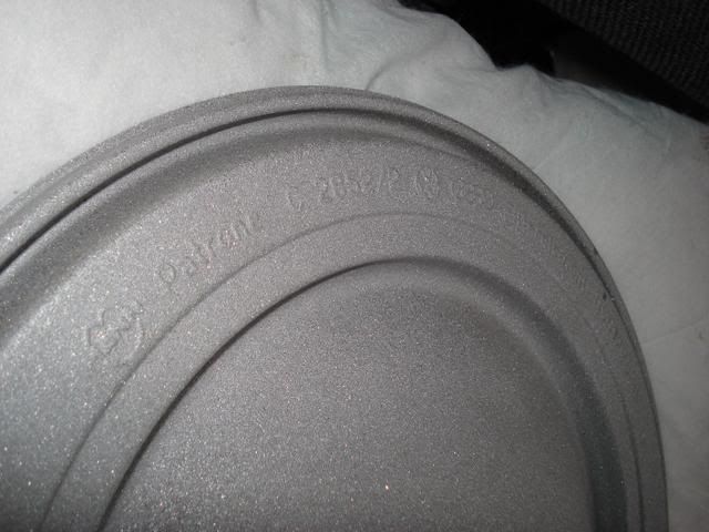

Took on a bit of a powder coating addiction since getting out the hospital...

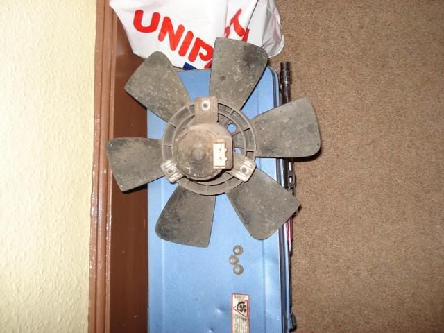

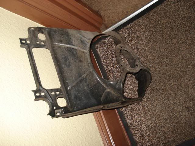

Causing me to start with removing my fan cowling and air filter lid and taking them for blasting and coating, the pictures of the finished articles aren’t the best indoors, but one of the bay will show that they have come up extremely well. Also got the warm air deflector shot blasted to clean it up a bit... rocker cover and slam panel need doing next to match  :laugh:
Fan:

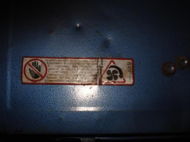

Cowling previous state - and the sticker which I need to replace, this original one went obsolete in '92, so, the new one it'll have to be after all...

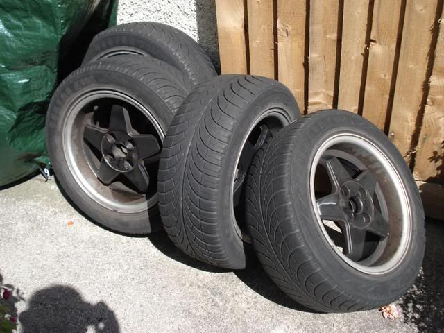

Finally got a shot of the set of wheels I bought to, unfortunately now I don’t think I'm going to be able to put them to any use, due to the heavy steering I think that they'll cause in comparison to 13x5's with a manual rack :grin:

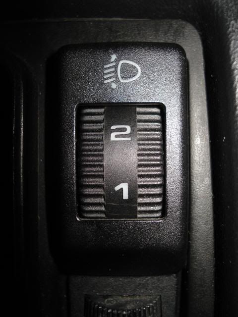

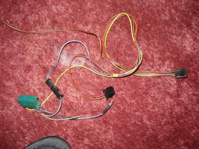

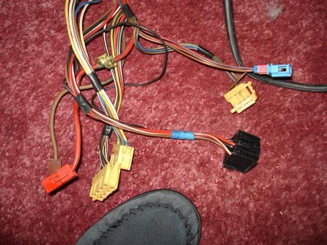

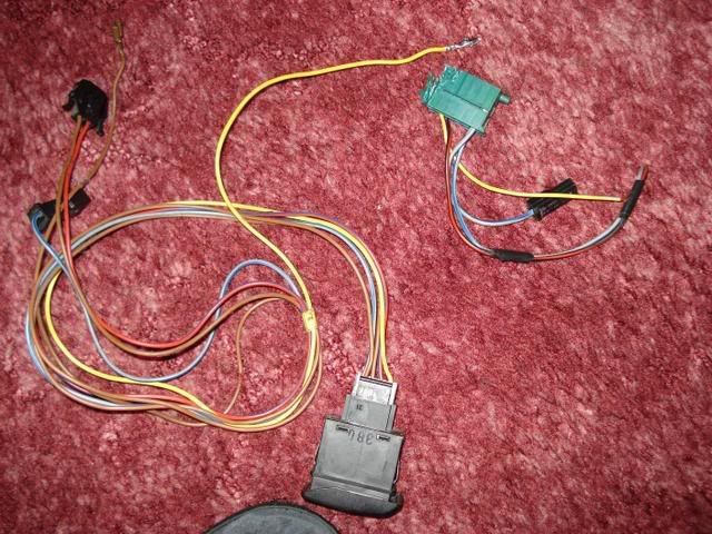

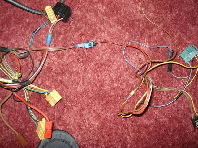

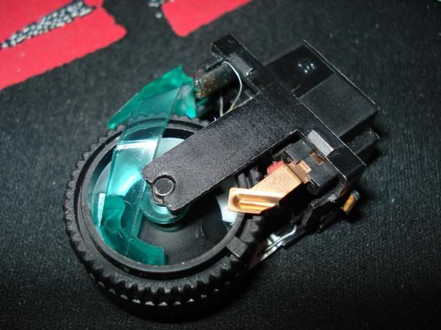

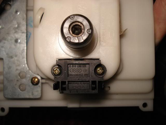

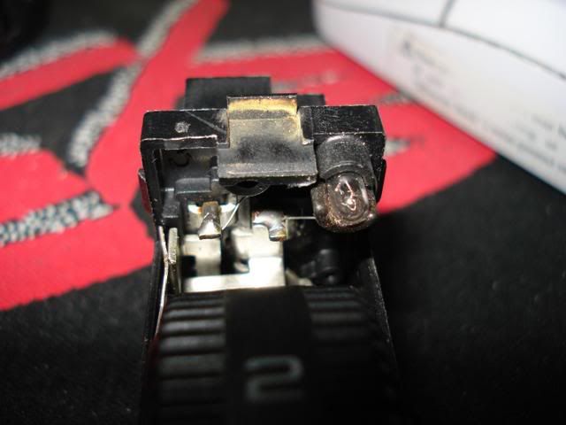

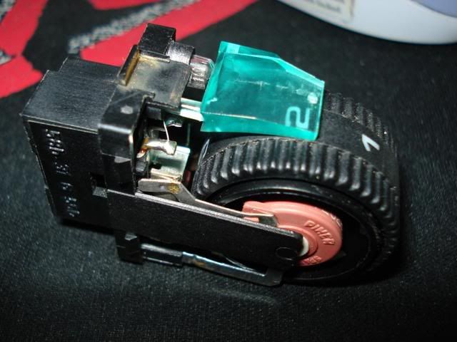

And also finally - a switch loom for the adjustable load leveller headlights. It took a long time but patience paid off, getting this setup for £40 from Germany, a complete kit of loom, from fuse box to front of car (LHD loom now for sale cheap if anyone is interested) including a pair of LHD lights, motors, switch and this small section.
The current loom has a 2 pin plug leading out to the motors... on this loom and mine it was a blue plug... which the switch loom fitted directly to. Using the spare dash illumination behind the fuse box to light it up after replacing the bulb, all was well, and the motors spin!
Switch loom:
Fuse box End:
Connected up:
Switch in situ:
Inside of the switch is just a variable dial which drives the motors to the desired spot, although the internal filter could make things tricky for converting to anything other than green illumination... witha  bit of ffiddling due to the bulb location, the previously blown one was replaced, and refitted to the dash, stock location above the headlight switch..
After this, the sand blasters came back with my stuff, which came up trumps... fan cowling and air filter lid ready for powder...

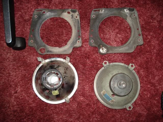

Next is to prep the lights for fitting motors, transplanting a RHD set onto motor control. I took apart the LHD only to realise the adjuster setup differs from the RHD although the backing plates are the same:
By unscrewing from, and removing the lattice adjuster in the bottom corner, the motor can be refitted to the original screw and mounted, the 2 top screws left alone.
Lattice piece to remove:
I'm currently waiting on some new adjuster screws due to the brittleness of the ones here. Once they arrive - then I'll be swapping to the motor controlled lights all being well. Also looking at getting the headlight backing plate’s powder coated combined with the slam panel for that extra fresh gloss approach to match the air/rocker/cowling combination. Relocation of my uprated headlight loom using 4mm2 wiring will put it in place on the other side of the bay so it's no longer sat atop my battery, this shouldn't see any loss in volts, if anything only minimal 0.1's.
The stuff also came back from the coaters..
An insitu photo is needed to really show these off, they look a lot better in the flesh than these photos...

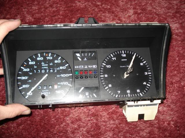

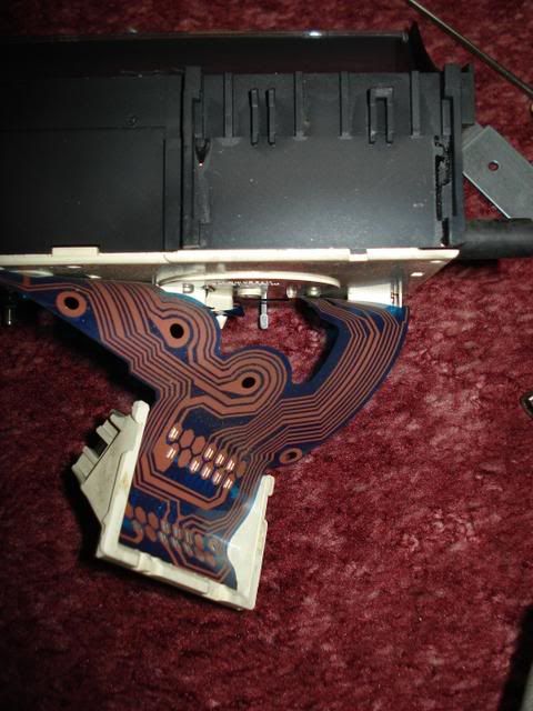

Also have picked up a set of VDO gauges from an Audi 80 coupe, complete with oil pressure sender, have built a full loom for it including illumination, but am currently waiting on both my new centre console for chopping, my mounting plate for the ashtray area and my oil temperature sender for the sump before I mount them  :smiley:

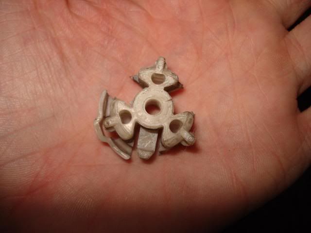

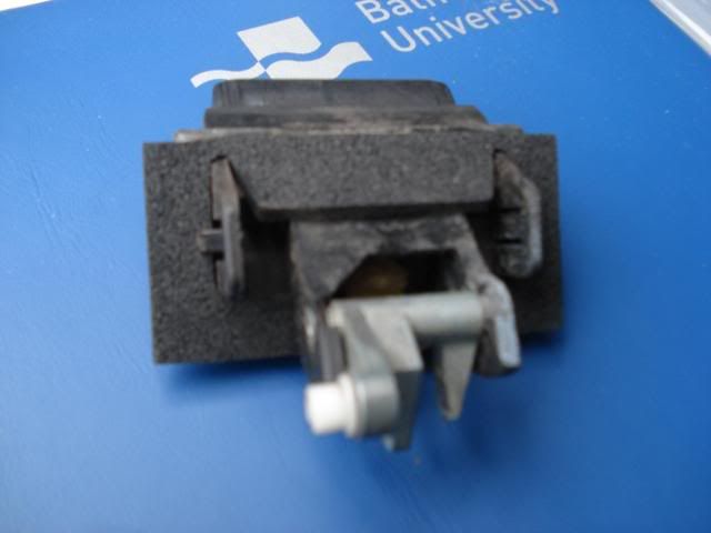

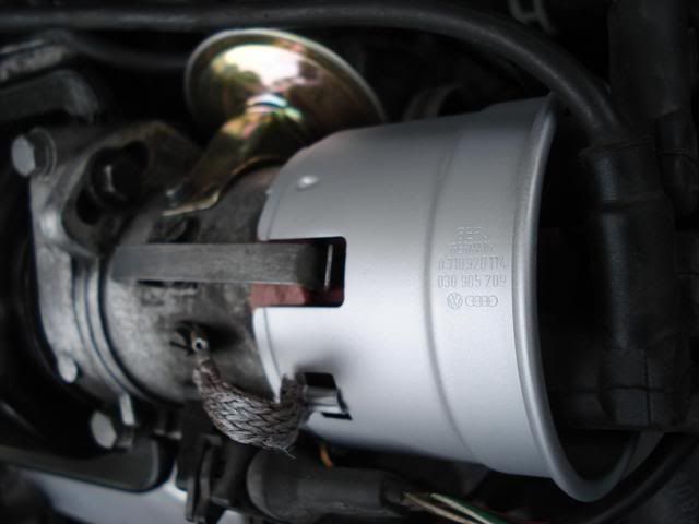

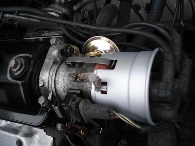

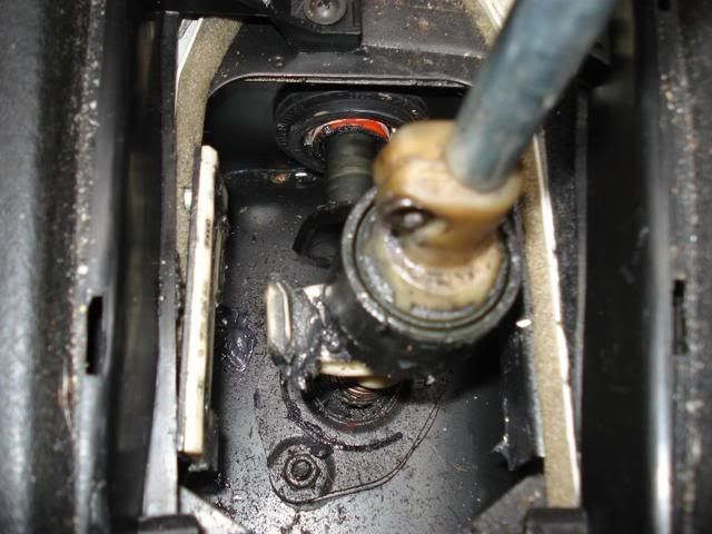

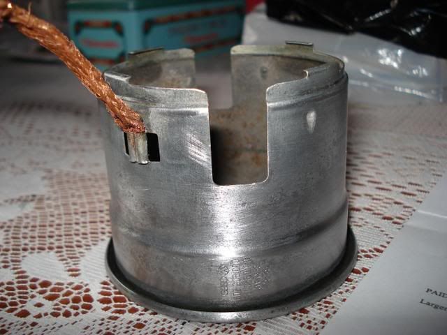

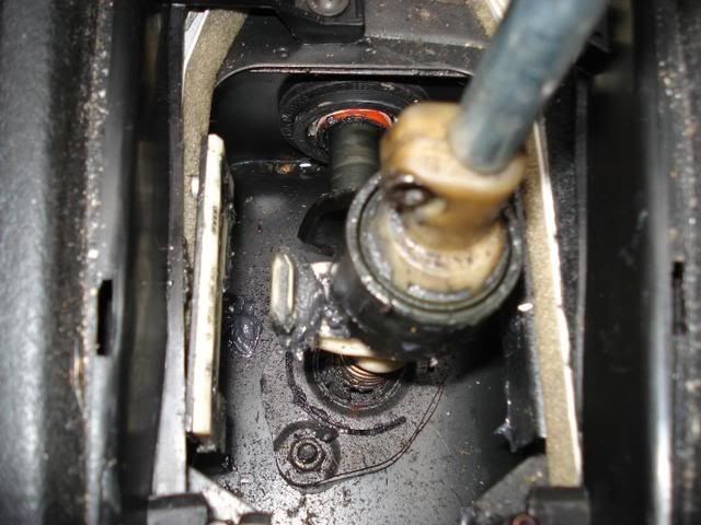

Just a short one today, did the cup and ball repair, it feels a bit tighter but i've got play in the box for one..
The looping frame which goes around the shift finger and bush on the 084/085 boxes also looks as though it suffers wear where the rubber bush rubs against it (this bushing had also gone flat down the sides and was loose, could be turnt freely where it was meant to be secure..) a replacement one of these is on the cards now, as everything else has been replaced anyrate, the bearing ring wasnt possible without dropping the exhaust (which ill need to do for my sump job anyway) to get the shift box out, so that will have to wait, hoping that will reduce a bit more of the play though, holding it tighter hopefully.
also managed to do my alternator brushes the other night, became important when i was getting 11.5amps under load out of the alternator, and the brushes were worn to about 3mm.. but then due to the rubbish design of the bosch alternator having the terminal insulation block not attatched to the alternator but flying loose, the thing broke causing the battery light to earth and recieve constant 12v, cue the alternator doing no charging at all, and the alternator having to be swapped for the old one from my original engine. the blue wire terminal also snapped, the rod snapping about half way down making it pretty useless.
heres the worn brushes..
and the busted alternator..

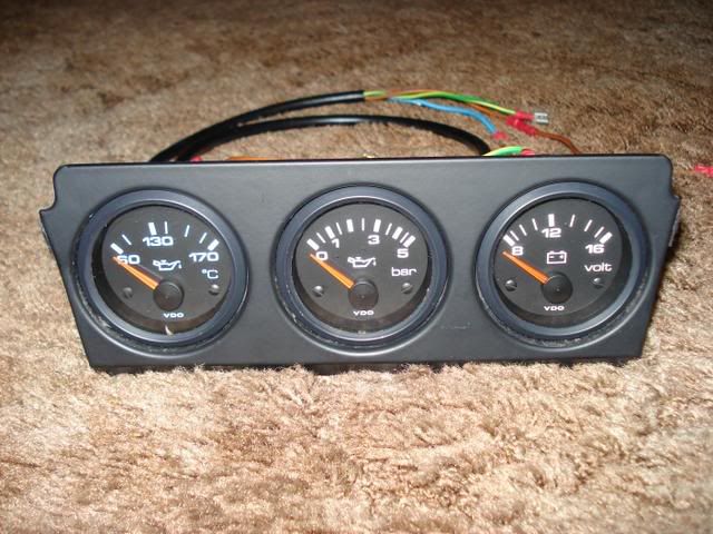

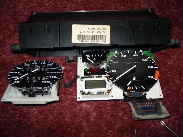

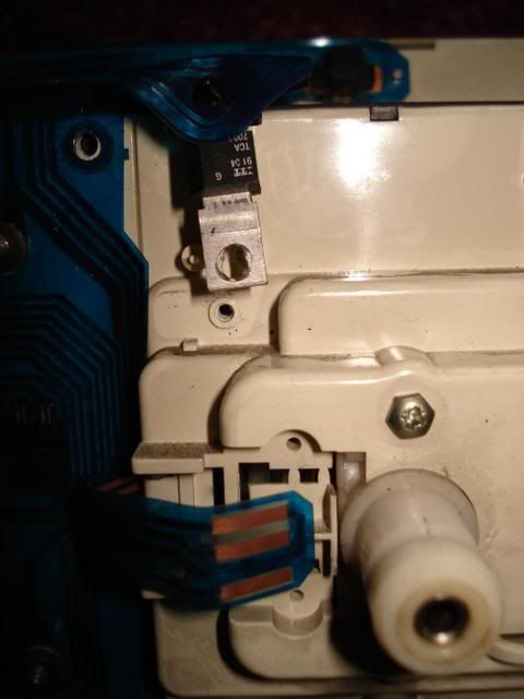

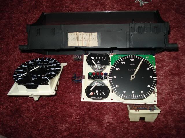

Right, finally time to catch up with all my updates.. this post, VDO gauges!

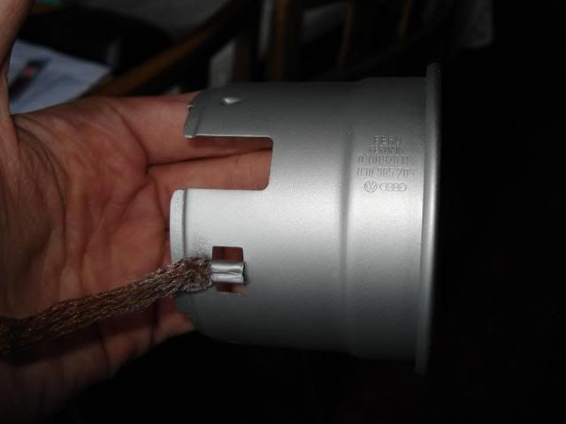

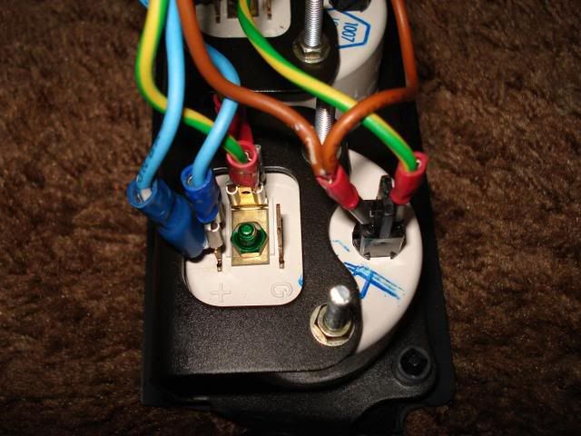

So I bough these complete with the oil pressure sender from my local audi specialist.. came complete straight out of a Coupe that had just come in for breaking!

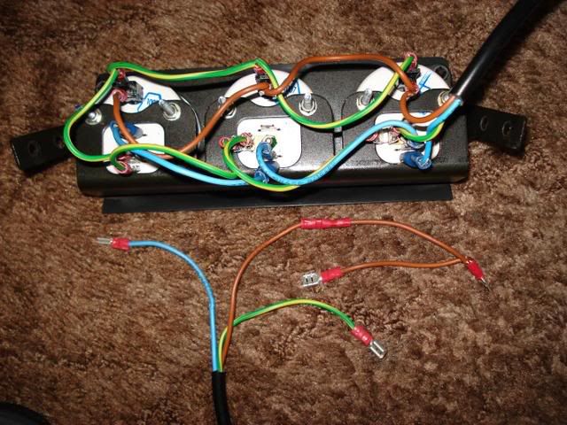

On the back of these came a small piece of loom which would have fitted to the original audi loom, i removed this and remade my own loom semi based on it..
i coupled the earthing on the gauges and bulbs inot one loo, the live across the gauges were piggybacked across and same again for the illumination. using 3 core power cable gave the the possiblity to keep it tidy across from console to fusebox.
also a close up of the forming of the looms..
these are then hooked up with some small 2 to 1 looms i made so i could use the ign live and illumination for both the gauges and the motorised headlamps switch.

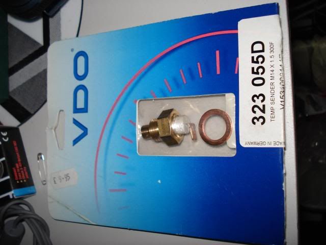

and then the oil temperature is taken from a genuine VDO sump sender  :smiley:

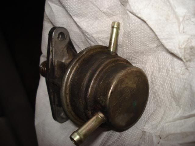

So.. the cold galvanise.. something I've been having a bit of fun with recently. fully sanded back and polished the cap cover by hand. one coat fo the cold galv went on amazingly well. it just seems to disperse and settle well at its own accord.
pics..

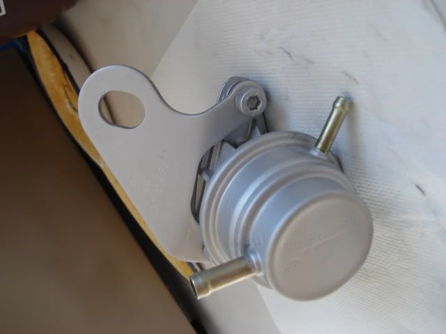

also had a pop at the petrol pump and engine lift bracket..

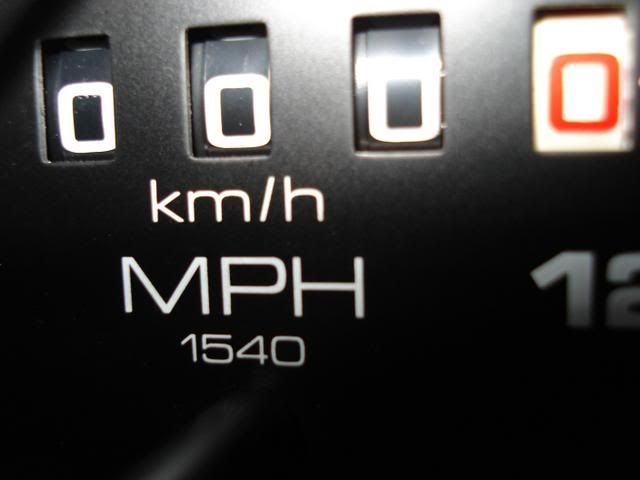

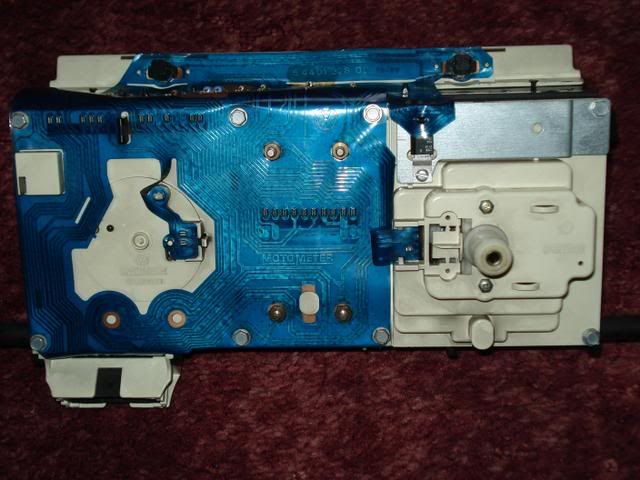

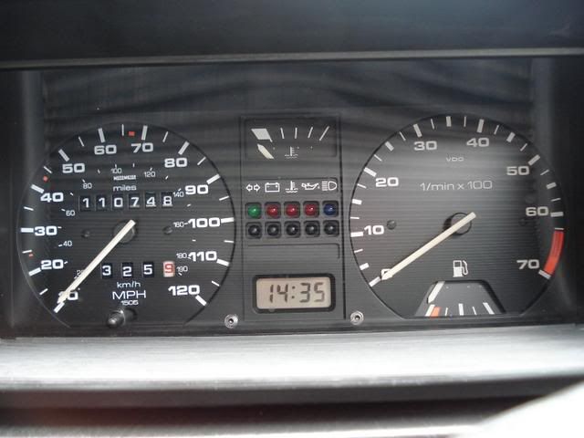

So these are the original clocks that I removed from my 1.3, note the analogue clock and the petrol gauge in the center..

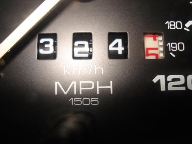

I ahd wished to combine my original milometer to retain the original milage. On checking the speedometer the gearigns also proved to be different, 1505 vs 1540. Proving the new speedo was no use as the reading will be wrong.
Next to open and seperate the clocks the 8 bolt head screws around the back border of the clocks must be removed.
Next the oil pressure circuit ribbon had to be pulled and the transistor lifted to release the clocks internals.
Then the one plug connection to the clocks must be slid back to unclip and lifted off.
From here the clocks can be dropped out of the back of the cluster and seperated into electronics and speedometer.
The different clocks (one set VDO, one set Motometer) meant the oil pressure connection differed. The ribbon still fitted and connected.
The speedo is then swapped into place of the revcounters original speedometer, bolted back together in a reversal of removal then fitted to the car as seen in the next picture below.
Thus you have a rev counter and retained your original milage and speedometer with correct gearing  :smiley:
