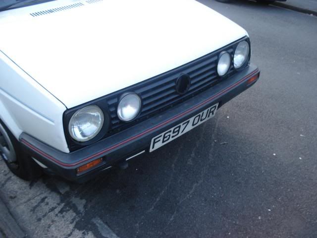

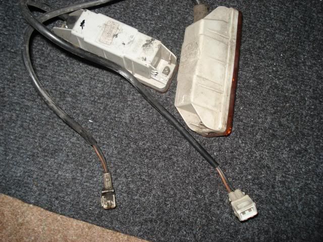

I don;t really know if these bear any relevance to being gone or not whe you look at them but, these are the old hubs and bearings that got pushed out my carriers.. they came in at around 25 and sounded like the car was gonig to take orf  :laugh:
Also found these a little while ago, was dead chuffed, still cannae decide if to fit them or not, admittedly..
And my UK Pressed plates appeared finally, the right ones this time with no GB  :cool:

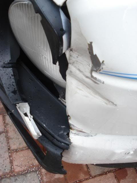

Stolen from my oher post admittedly but it was the only way to sum it up, and it needs to be recorded
to quote the guy a tthe insurance today 'yeh it's fine to put them up, something along the lines of half way through the restoration and oops!' I quote  :grin:
I was coming down a one way hill, when he pulled out in front of me, I had about a car lengths distance to react and stop as he started pulling out when i was literally a car and half away, AND that was clear view, the ony car was about 3 lengths away so i was in full view, and he was in an MPV so had the height advntage and only having to look one way..
had to chuck on my brakes at about 25mph on the bottom of hill skidded in wet and where he stuck it right out (furthest wheel back on his was on the junction lines, he came right out) and the newly repaired wign thats been damaged since i got the car took a beating.
he jumpwed out saying i wasdoing 90mph etc etc. until a woman told him he pulled out in front of me and she'd be a witness, at that point he wet extremely quiet and realised what eh ahd done, trying to pin it on me cause im young i expect  :rolleyes:
he took full liablity and its in for repair.. should hear back by middle of next week  :undecided:

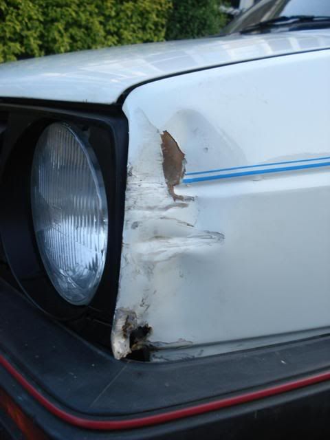

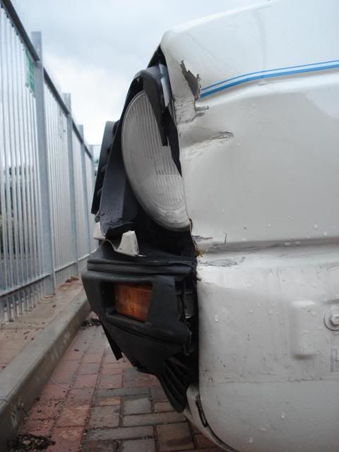

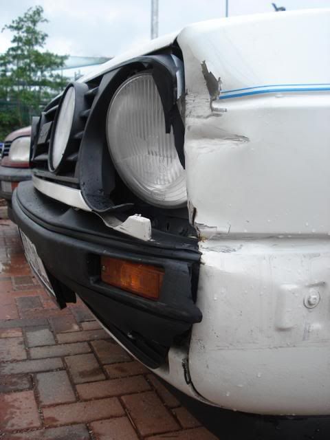

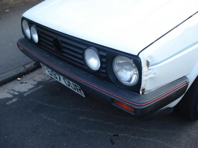

Well car returns to me with a £508.25 cheque aswell  :shocked: was valued at £535 first offer so didnt even bother messing around with a figure like that  :cool:

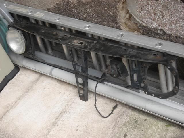

Managed to pick up a new slam panel c/w headlights but, once took the car apart realised all i need to do was put my hand behind and push it forward, and the ehadlight wasnt broke at all nor the frame.. jsut the adjusting screws need replacing! also thanks to my mate dave for the all black grille with the spots on, perfect condition with all clips and that  :cool:
luckily my indicators didnt break in the bumper either  :shocked: im really quite shocked by the non breaking of so much stuff.. lucky they didnt eiether as the new bumper was pre 90  :wink:
replacement bumper is on atm, red stripe though, need to trace an all black hopefully in trade, and finally got a drivers side manual adjust mirror to swap or put on while i repair mine.. i tihnk one of my cables is broken, i know i can jsut use my hand but wheres the luxury in that, i aint opening no windows  :grin:
so now its back ive beaten out the wing, although thats gonna be swapped as its got a tear in it.. from the bumper iron. once its off though itll give me the required access for the battery tray/chassis leg edge bend, at the moment the curve of the wing has limited the space and the inner wing needs flatting back out to anyway, but for the first time ive ever beaten a panel i feel i did alright..

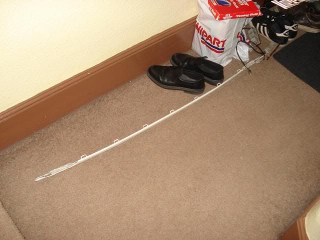

managed to straighten up my grille trim as well.. needs rubbing right back and painting again..

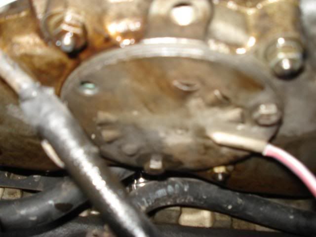

Well, looks like might have to add a couple of seals to that Job list now.. Think the cam oil seal is leaking and maybe crank at the timing belt end.. sump gaskets pretty definate now to  :angry:

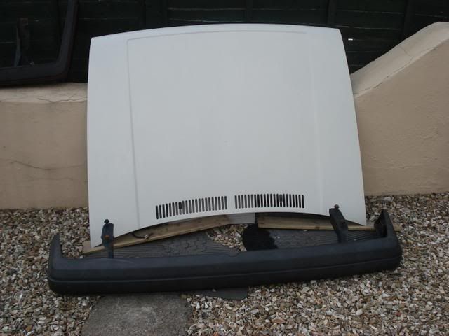

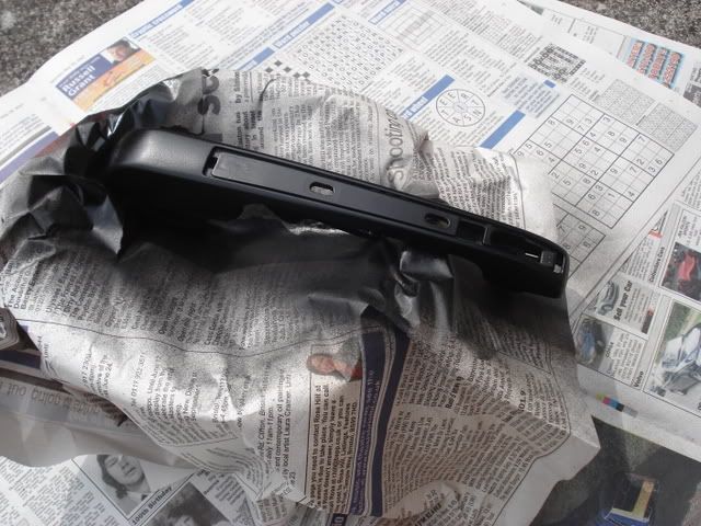

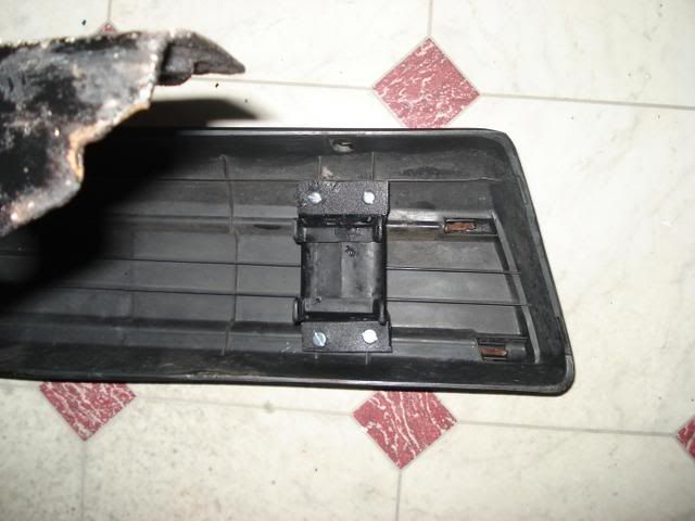

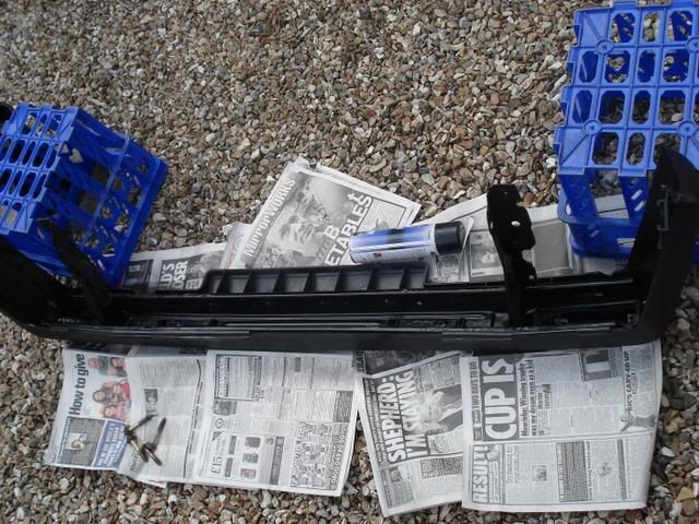

Spent today sorting out getitng a new bumper and that that was plain black, found noe that was mossy and mouldy as hell, forgot any photos along the way, but gave it a good clean, the iron is very rusty but i cant remove it, which is a shame.. Sprayed engine enamel over it all just to protect it a little.. It'll have to do for now..
Saw fit to include my bumper and bonnet I picked up a while back, £5 bonent, £10 bumper.. would get rid of the tow bar weight on the back at least  :rolleyes:
The old bumper up front, note the major bendage.

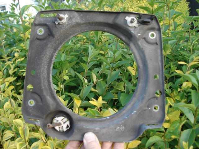

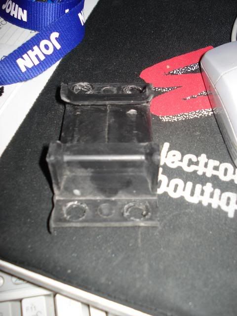

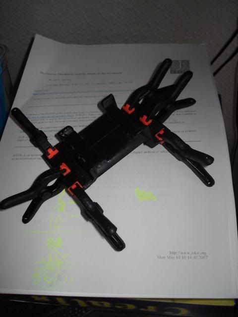

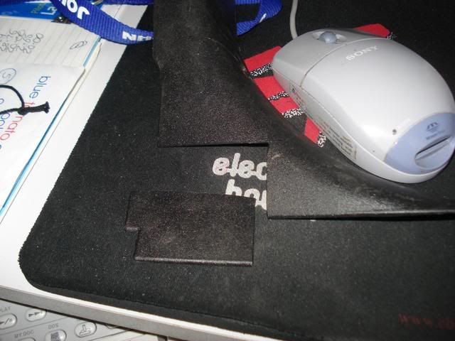

The new bumper side clip had broke, as these are only plstic welded on.. decided to go for a little mission on these, by drilling one off, and drilling off the broken noe, taking an old broken seat leg liner and cutting a pair of rectangles from it..
these could be sued to cover the size of the holes, which can then have small holes drilled, and then screwed through with self tappers into palce, creating one nicely mounting bumper at the side..
currently forming with epoxy..
That's aobut it for now, until I get that fitted to the new bumper and get the blooming thing on, expect i'll leave it till after next weekend now once i got the new wing as well.. Finish uni on friday majority of the way then only one more hand in wednesday the 30th, then time to crack in and compelte all the put off jobs ready for a hopefully mostly trouble free summer  :smug: I wont speak too soon though

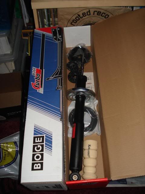

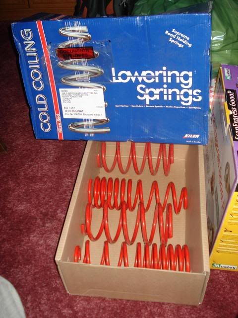

Lowered it 40mm, feels an immense amount safer to drive, its only a 1300 so the speed isn't the key.. Although now, it doesn't roll like it did throwing you everywhere at slow speeds round corners, any of that.. BUT... Direct Line then tell me I have to be 25 to even have a different set of wheels on the car.. So back to standard it is.
The old shocks I removed, I thought had knackered top mounts. They probably are now tohugh as at 70 the wheel used to shake car would rumble.. The slotted ntus werent even tightened right up, they were finger tightened and then when you couldt get your figners in any more they had stopped doing anymore. Same with the top nuts, nipped up, came fof easy with a spark socket and a spanner..
Going to have to get 2 fresh oil struts for up front now and revert to standard until August comes around when I can move insurers to gain soem freedom for one, and hopefully a better rate!
Shouldn't be too bad, one strut up front is leaking a fair bit, ones got bad corrosion to the casing.. And so the reason for swapping them. At least this time I can get the slotted nuts done up properly, and make sure its all secure, ill jsut set the camber to the same as it was prior, and then pay to get it setup properly once back on the Boge and springs.
Shame, because it wasn't too much of a job, and its made me feel safer driving it around, but I'm not sure they would take it that way, as I'm "unde 25, male, and have a Golf" Cause I'm bpound to race it around the streets aren't I.

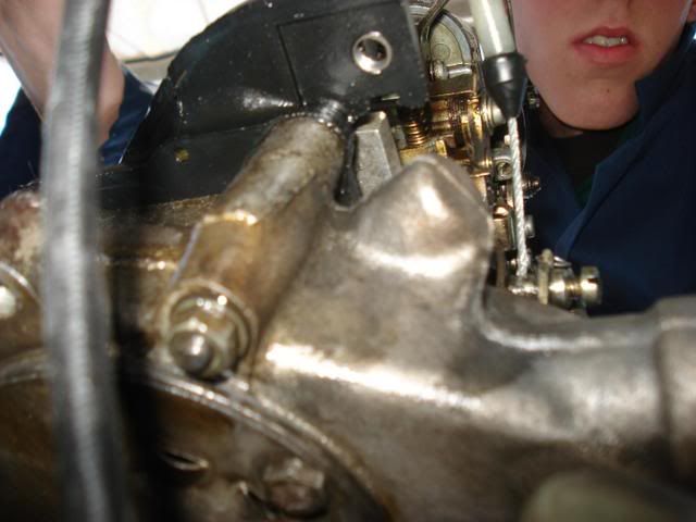

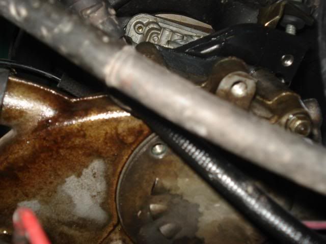

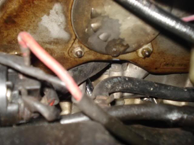

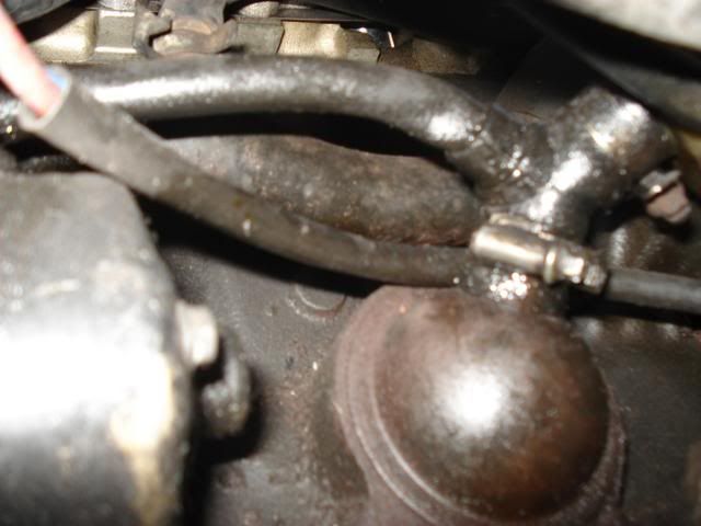

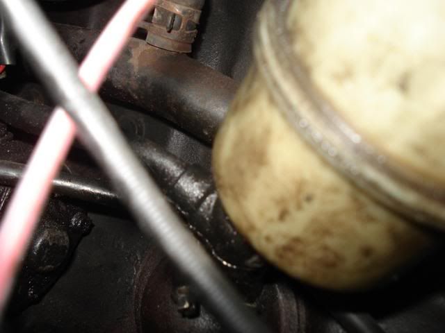

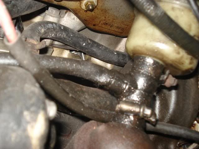

Well.. Oil breather system has given up the ghost it may seem.. I'm expecting to find the gauze down below in the breather assembly (spaceship thing) clogged right up. The pipes have sene better days to but they are only pence anyway. Theyre cracked and weatehred on the outside, and the bottle looks a bit knackered to. Not hard to replace, sump and gasket are being done anyway so a steamer through the breather assemblys is gonna be the step to clean it, hope sticking my fingers in fins the gauze intact!!
It's all voer the top of the manifold and up the carby block to, so, pics of that to come (will edit this post with them)

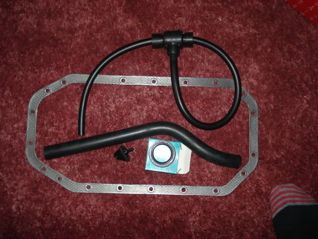

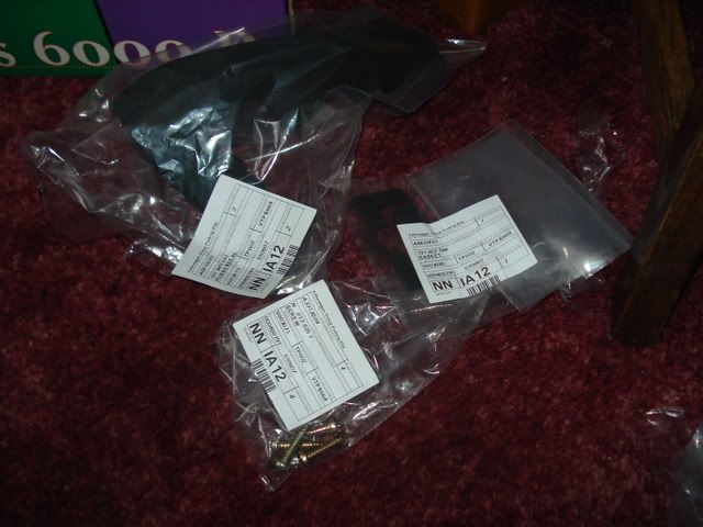

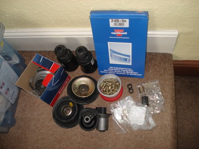

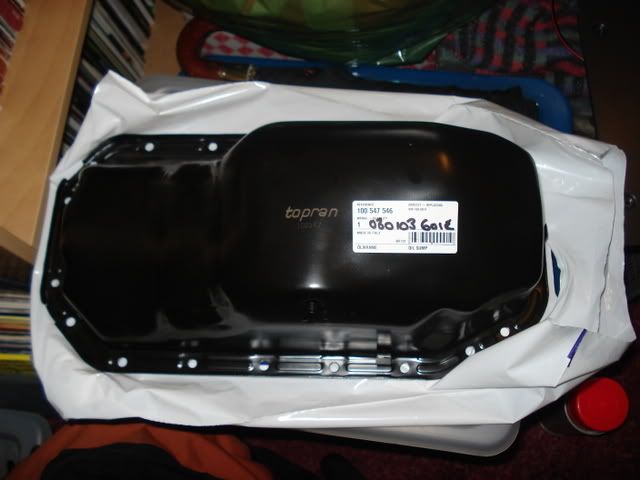

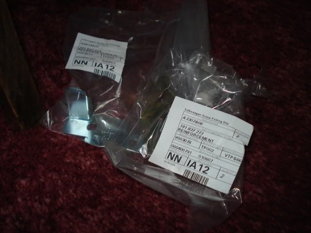

Did a bit of shopping in relation to the oil leak and the insurance payout, decided to clear out all the loose ends and that on the car i thought might as well be done after I’ve uhmmed and ahh'ed so long.  :smiley:
So... New sump, sump gasket, cam oil seal, rear washer jet, and air hoses for oil breather were picked up today...
Ordered the oil separator bottle and right hand rear slot seal from GSF...

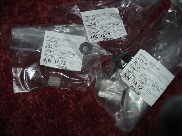

And from Volkswagen...

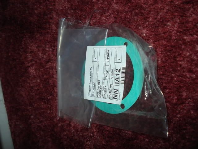

-gasket for preheater hedgehog thing.
-new gear shift finger (with bush atop), bearing bush and washer, to try and remove some slack from the gear knob I hope.
-to repair my wobbly drivers window the seal that holds bracket to the glass, the felt channel at the front and the guide channel it sits in (one of these is a backorder though, cant think which so have to wait and see, hope its the metal so I can find a good one in the scrap..
-window slot seals all round except the right hand rear which is deleted...
-tailgate lock gasket, rear light gaskets and the screws that hold the grab handle on as they’re probably destroyed on mine
-and last but not least rip plates, for anti slim jim protection :smiley:
picked up so far..  :smiley:

been meaning to add.. fixed the bumper, the bodge works  :smiley:
new slam panel may not be needed after all but, its looking tidy  :smiley:

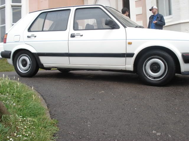

this was mikey, our micra for 10 days  :laugh:
standard stance
lowered 40, but has to be reverted back till august now, doh.

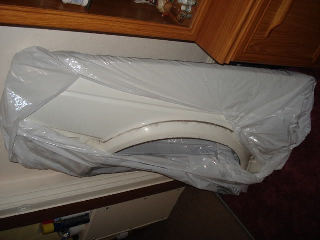

my new wing wrapped up, only got a tiny bit of bubbling upfront, gonna get it remvoed even tho itll be hidden by the bumper  :smiley:
should be getitng that fitted and the proper bumper and all that jazz on tomorrow.. cannae wait to be honest, want it looking nice for volksfest!  :grin:

Bit alte in the update but alas!
Ordered a big bag of bits last friday finally..
New sump, gasket, air hsoes for breather, cam oil seal and rear jet..
New rear light cluster and boot lock gaskets, and new screws for the grab handle..
New preheater hedgehog gasket

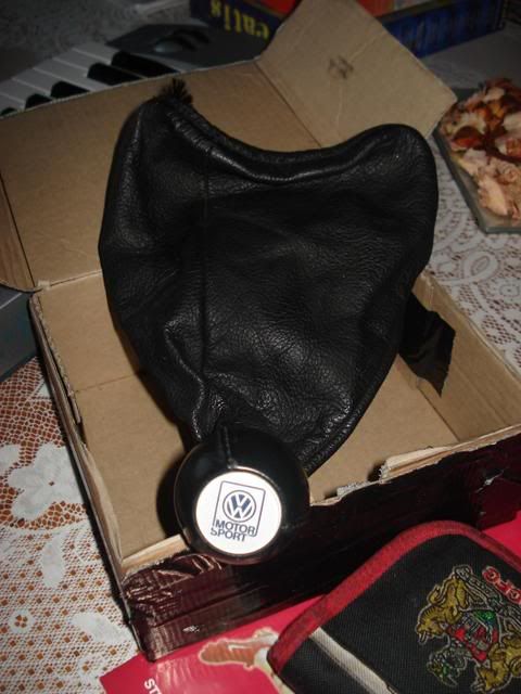

New gear shift finger, bush and washer
New rip plates/anti slim jim plates
and new slot seals for the front doors, and enw window guide for the rocking divers window.. also got a slot seal for drivers rear window, need to go and get passenger soon, to  :smiley:

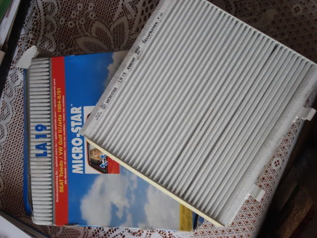

Also picked up a pollen filter, a long time back, the filter which fits the seat toledo is the same that will fit a mk2  :smiley:
And gave my handles a flash over with some trim paint just to sharpen them up a bit, ill do them properly another time though  :smiley:
