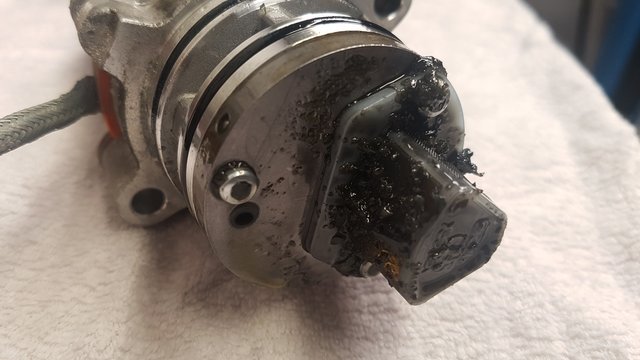

I wonder if the gauze filter has been cleaned out and the pump relearn carried out??
What happens with the R rear diff is that the filter gets that clogged up with debris the pump fails due to it having to work that much harder to pump fluid.
I must admit my front diff filter was clean compared to the R rear diff I serviced a few weeks earlier.
R rear diff haldex pump Before
R rear diff haldex pump After
Offline Adam T7
  • Posts: 1,318
Re: VAQ Diff not working, Possible?
« Reply #8 on: 26 February 2023, 10:31 »
Indy I use told me that dealers rarely clean the filters and just change fluid - clearly his opinion and experience but it’s a possible?
