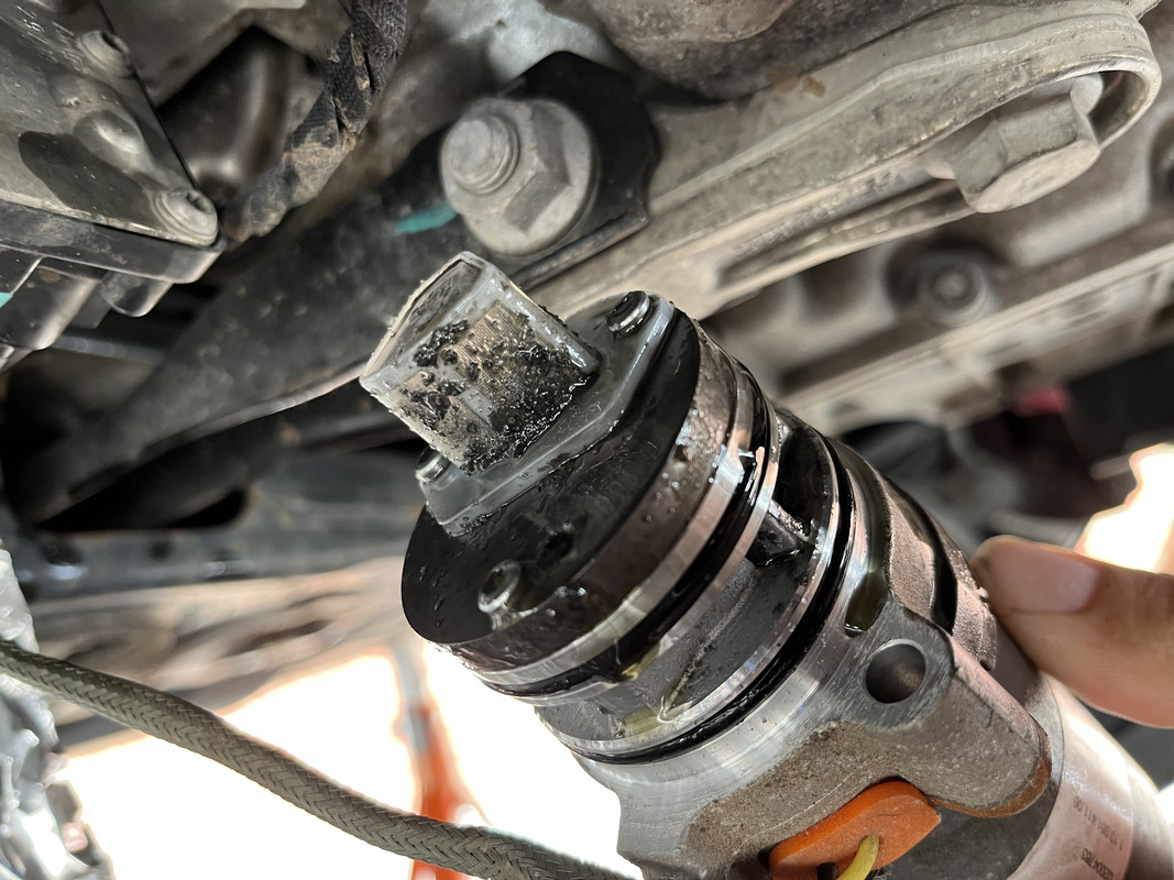

« Reply #52 on: 02 September 2022, 15:42 »
Thanks guys, Service all done today, changing the Diff fluid wouldn’t have been too bad apart from it seemed like a right b*tch to get access into the plugs - not so much getting them out but putting them back in was awkward as!!
Below are the pics of the filter when I pulled the pump out, the car will just tick over onto 24k miles in the next 3 or 4 days.

« Reply #53 on: 02 September 2022, 18:28 »
Thanks for taking the time to take the image.
