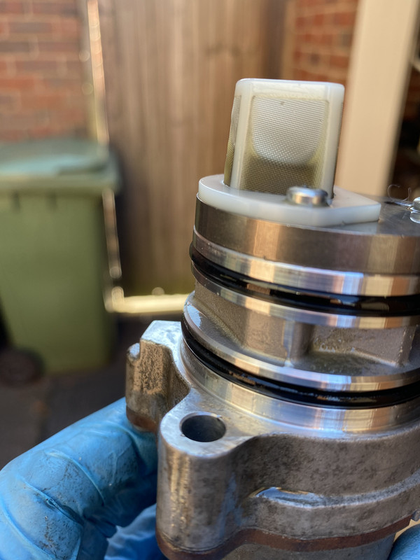

Changed my diff oil and inspected the filter. Filter was clean once I removed the residual oil, so either I don’t drive my car hard enough or the examples on the intranet are from haldex units off an R which must get more use the the PP front diff. Any thoughts? Overall the job was not too hard. It would be super easy on a proper ramp but still OK on 4 axle stands (to make sure the car is level). Hardest part was knowing when to stop filling but all done for another 30K!
If you want to do this at home buy the kit from Awesome GTI, their part kit is cheaper than a dealer! They state the plugs and pump seal kit are one time use but the torque setting is so low I will just buy the oil and replace the bolt on the second service.
Just make you have the necessary tools - quarter inch drive with 10mm socket and a half inch drive with long extension and an 8mm hex bit.
2026 Golf GTI ED50

The filter on my VAQ diff pump was clean, I've changed the fluid in an R and the pump filter was absolutely filthy, so yes Paul I think a VAQ diff perhaps doesn't work as hard as an R rear haldex pump.
Did you do a pump relearn??
Have you re-checked the fluid level since the car has been running??

I ran the car briefly when it was on the stands and then topped up another 100ml ish. I didn’t relearn as I only have OBDELEVEN but there is an option to reset in basic settings, which may be the same but I didn’t bother as the filter was clean. It would make sense if the filter was clogged.

I would agree Paul, if the pump filter was really made up and you'd cleaned it a pump relearn would be necessary.
Mine was clean but as I had VCDS, which I bought specifically to do my diff service, I did it anyway.
