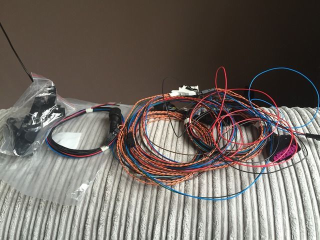

Look what's arrived :D
Can't wait to get cracking now!!

Good luck...that looks like the wiring harness off the Lunar landing craft circa 1969!
Keep us updated mate, I am following this thread with interest as this is something I'd like to do but I don't have the heart to pull my car apart just yet. :grin:
