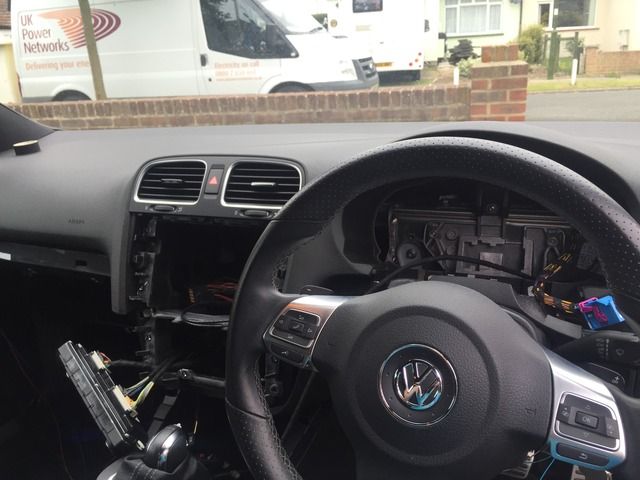

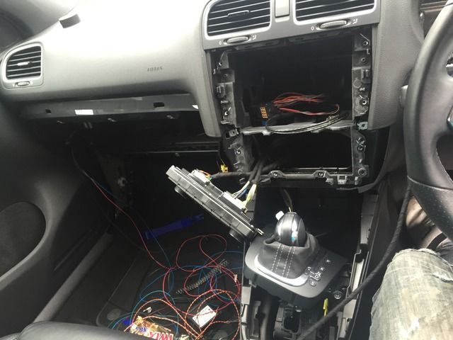

Best look away now then......
I knew I shouldn't have taken a look at this thread! :cry:
I'm not sure I'd have the confidence / skill to pull my car apart like that, fair play to you.
