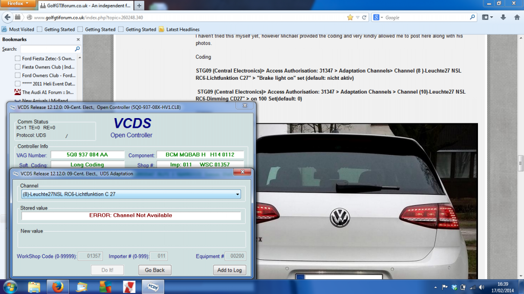

Hi all. I've been conversing with a new member mihaelo1 (Michael) via PM, and he's just sent me some details and photos of a VCDS mod that he and his friends have just done to the LED tail lights on their GTI.
Basically, using this coding allows the high intensity brake light function to operate not just on the outside clusters, but also on the inboard (boot mounted) clusters.
I haven't tried this myself yet, however Michael provided the coding and very kindly allowed me to post here along with his photos.
Coding
STG09 (Central Electronics)> Access Authorisation: 31347 > Adaptation Channels> Channel (8 )-Leuchte27 NSL RC6-Lichtfunktion C27" > "Brake light on" set (default: nicht aktiv)
 STG09 (Central Electronics)> Access Authorisation: 31347 > Adaptation Channels > Channel (10)-Leuchte27 NSL RC6-Dimming CD27" > on 100 Set(default: 0)

Hi there
Im trying to code this mod and my VAGCOM is telling me the channel isnt available....has anyone managed to carry out this mod...??
Thanks
Ian

« Reply #435 on: 17 February 2014, 17:33 »
yeah i tried this and the drl brightness to 100 at shark the other day, it wouldnt let me do either, i believe the message i got was format error or something when i tried to put a value in, at least that was for the drls, i cant remember what it said for the brake lights but i know they both didnt work!
Anyone fancies remedying this one for me would be grateful!

« Reply #436 on: 17 February 2014, 18:15 »
OK thanks....at least it isnt just me

« Reply #437 on: 17 February 2014, 19:46 »
I've had channel unavailable errors before. Needed to reboot my laptop as it was happening on all modules.

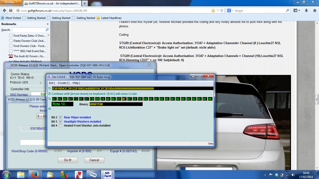

On another subject....ive bought the parts to fit heated washer jets and had a look around in VCDS and found this......
Can I assume this is the adaption I need to activate the jets after I install the wiring and new washer jets.
Thanks
Ian
