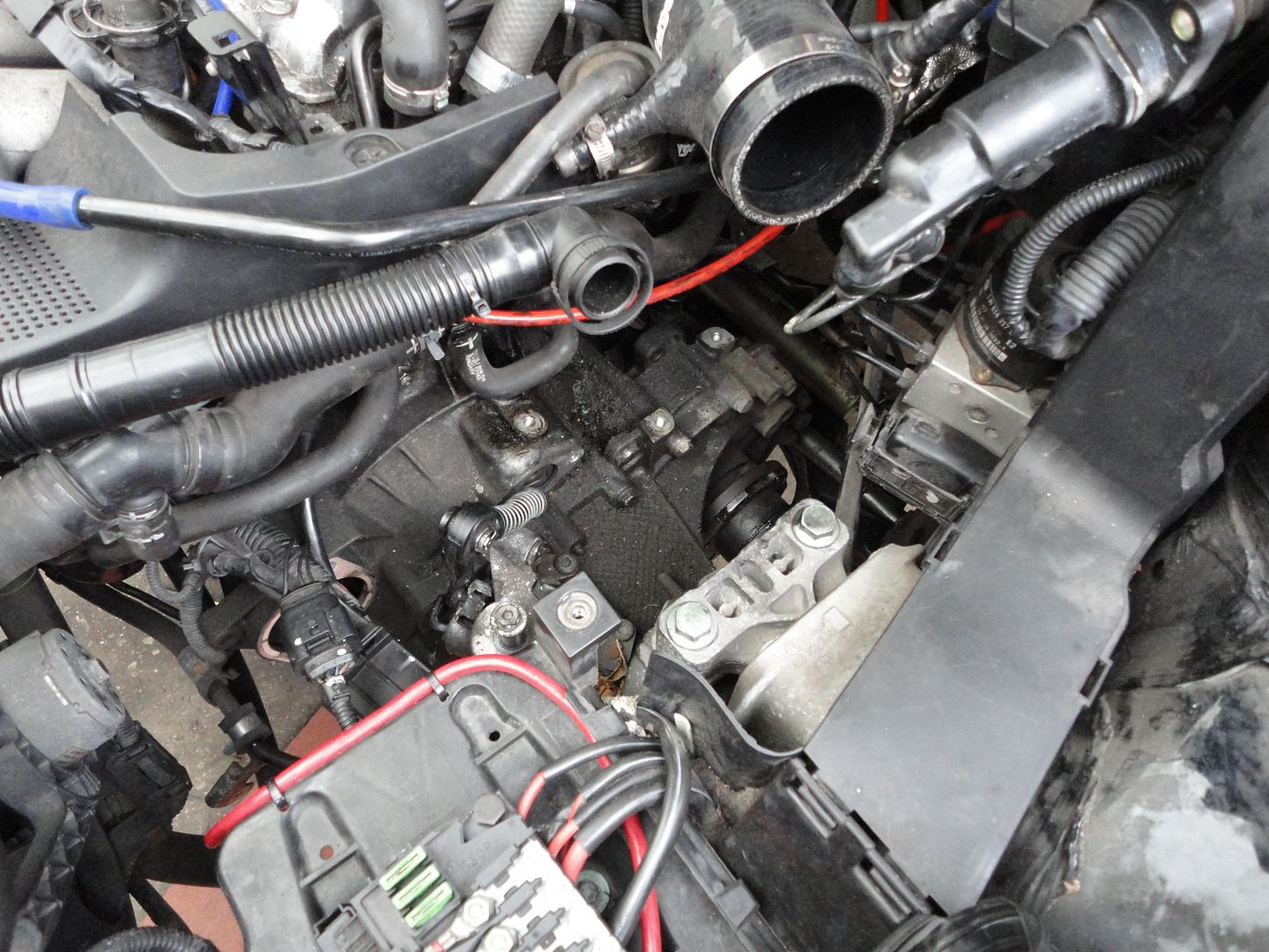

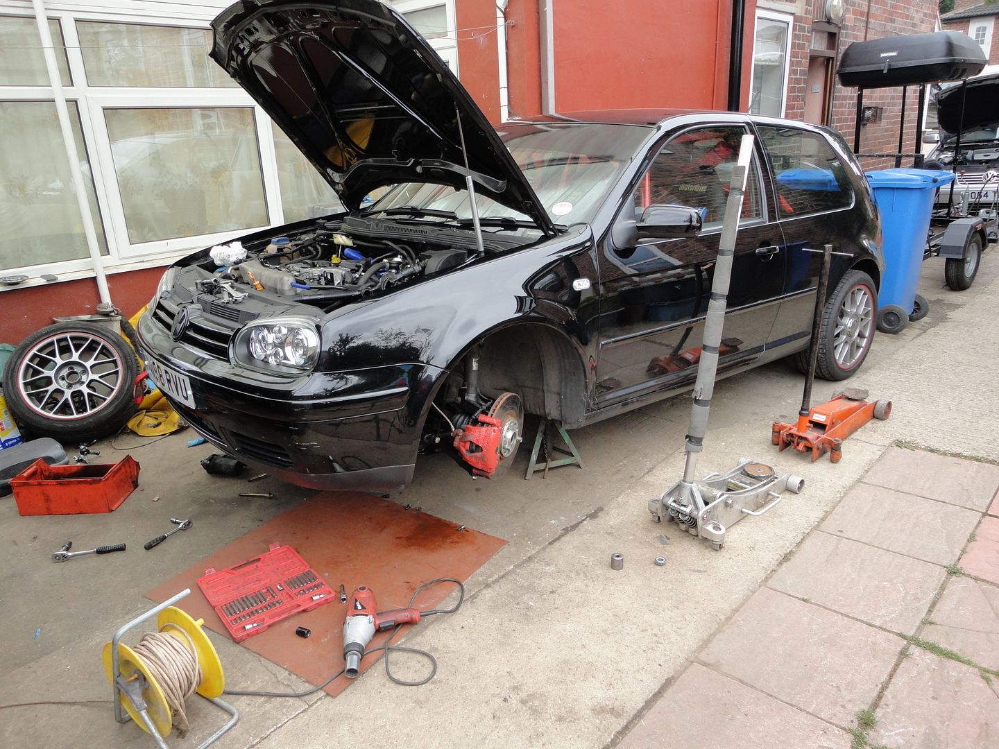

Ok quick dinner time update!
Decided to set about changing the standard clutch for the vr6 unit i have!
few pics of where i am upto!
Just starting.....(you can also see my sunstrip which i may think be too big but havent driven it much yet so will see)

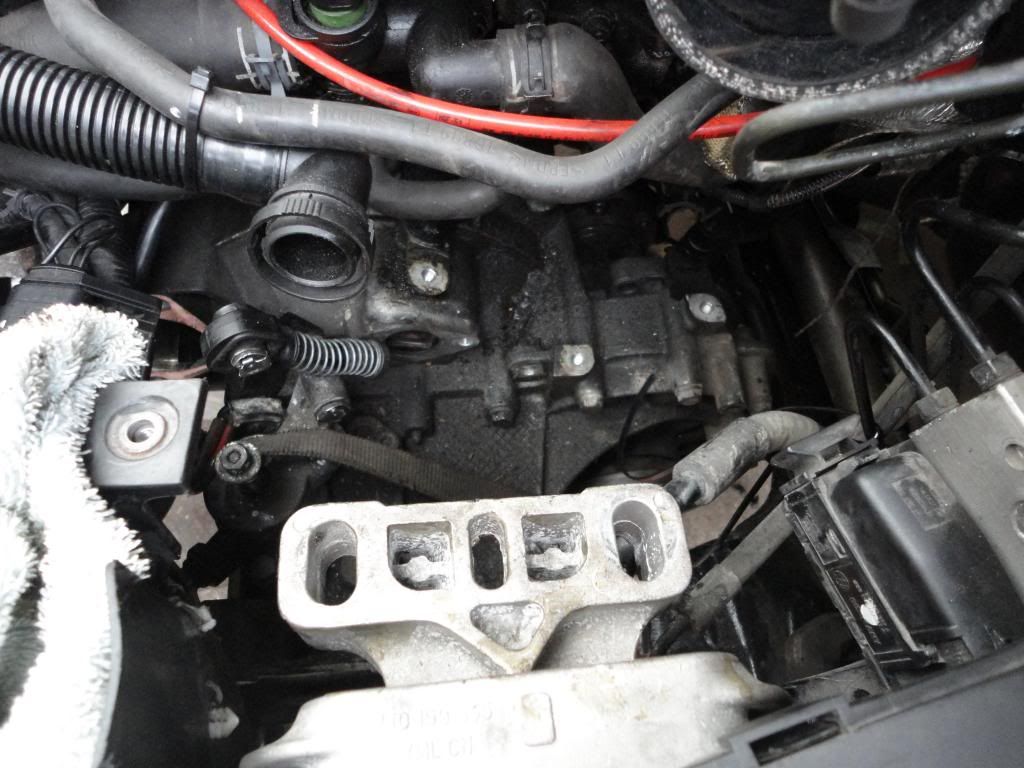

Stripping it down

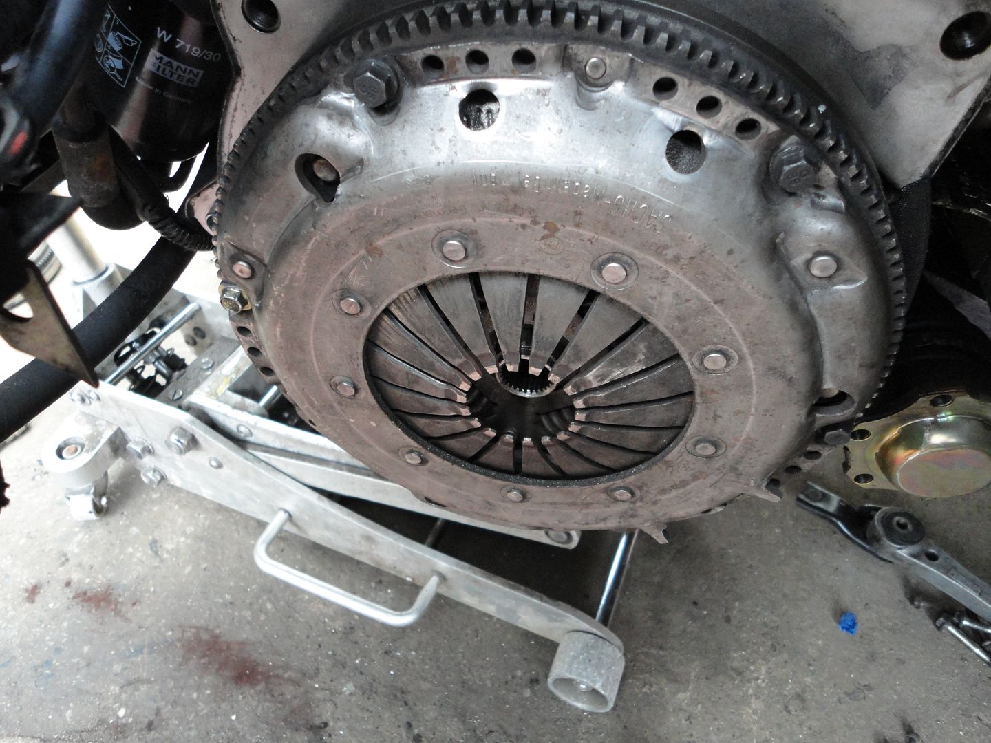

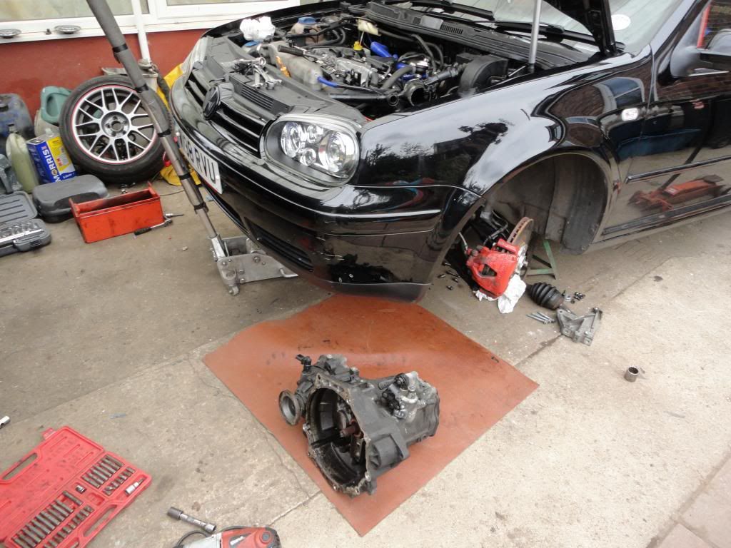

And the box out!
And the old clutch covered in dust!

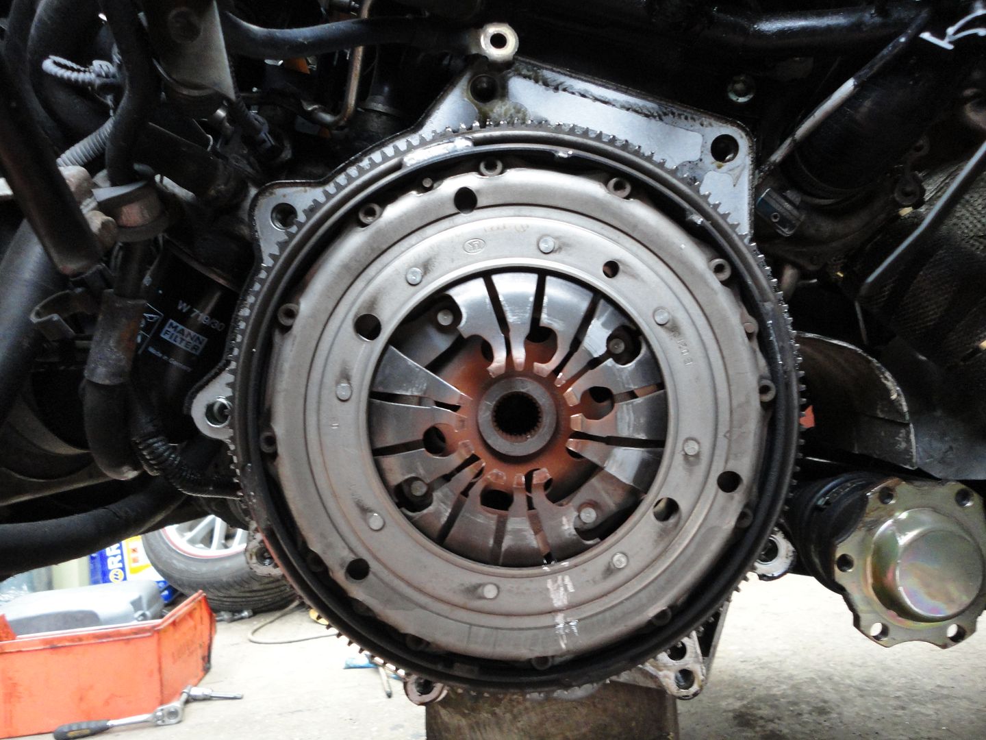

Vr6 unit fitted!
just need to get it all back together also with the polybushed engine mounts  :cool:
will update later!  :grin:

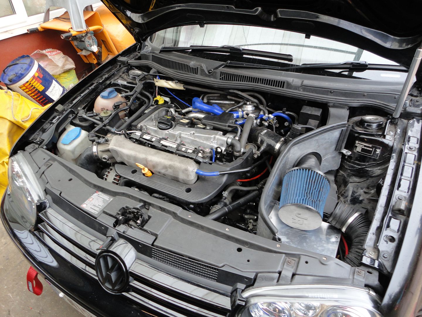

Ok update from yesterday!
Got the box back on and also fitted the poly filled engine mounts!
http://youtu.be/IVpITVC9YKc
And got it all back together!
engine is solid with both poly'd mounts!

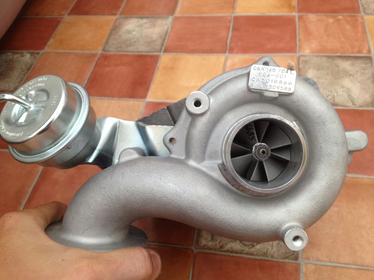

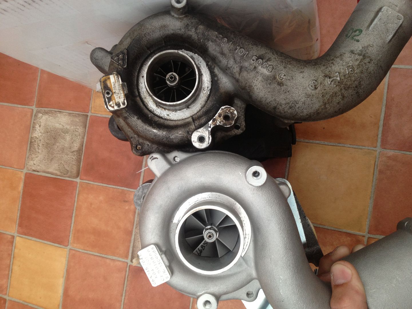

Ok so it's seems like I haven't done anything in ages!
BUT my holidays are over and I arrived home to this!
It's the k04-001 I ordered from Xs- power
It's pretty much the same as the Chinese turbos but I hve been told the compressor is bigger then the usual 001! I have asked them to email me the full spec sheet but I have taken a quick (rough ruler) measurement of the inlet I.d which measured 43.5mm
I will be fitting it tomorrow as well as maybe a few other small jobs and then I will be checking it over with vcds (afr etc) to make sure it's safe to run and then hopefully pop down to the r-tech charity day on Sunday!!  :grin:

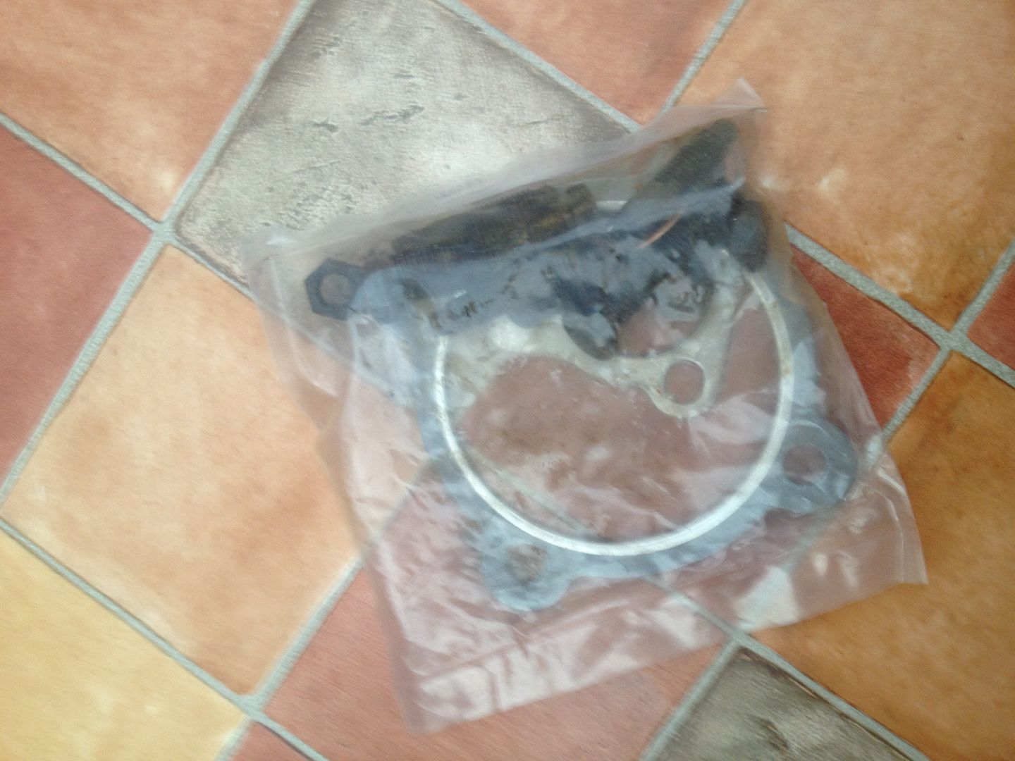

A few more pictures...
Vs a k03s
And gasket set
