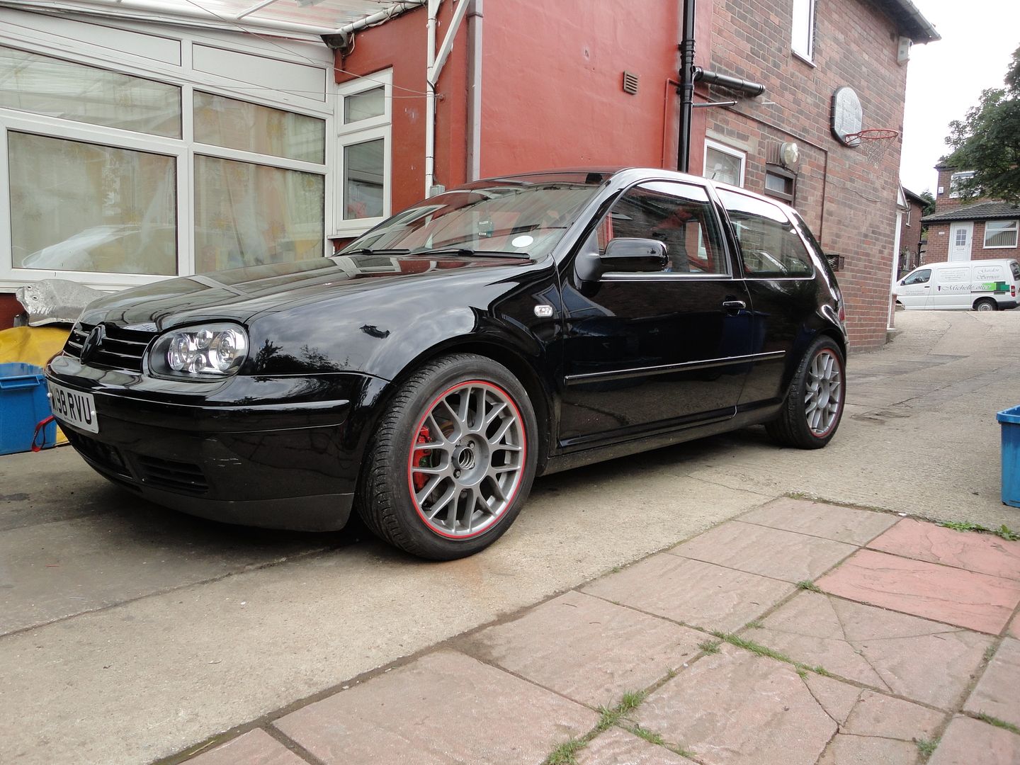

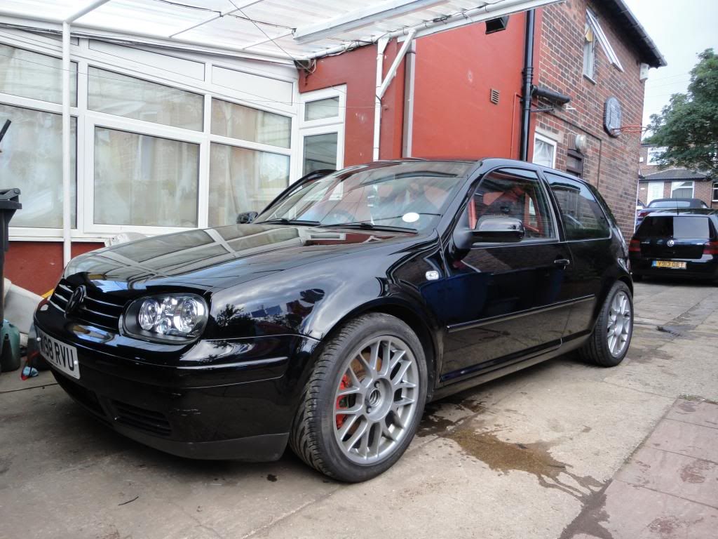

Anyway a little update from yesterday!
Seen as soon I will have the car on the road I thought I best get it ready!
I started by dropping the car on its wheels for the first time in about 6 months!
Once it was down I tightened the hub nuts and top mounts.
I then Set about setting the suspension height up, i got the wishbones about level but its not perfect as my drive is t completely level but will do ti I can get it set up on a ramp.

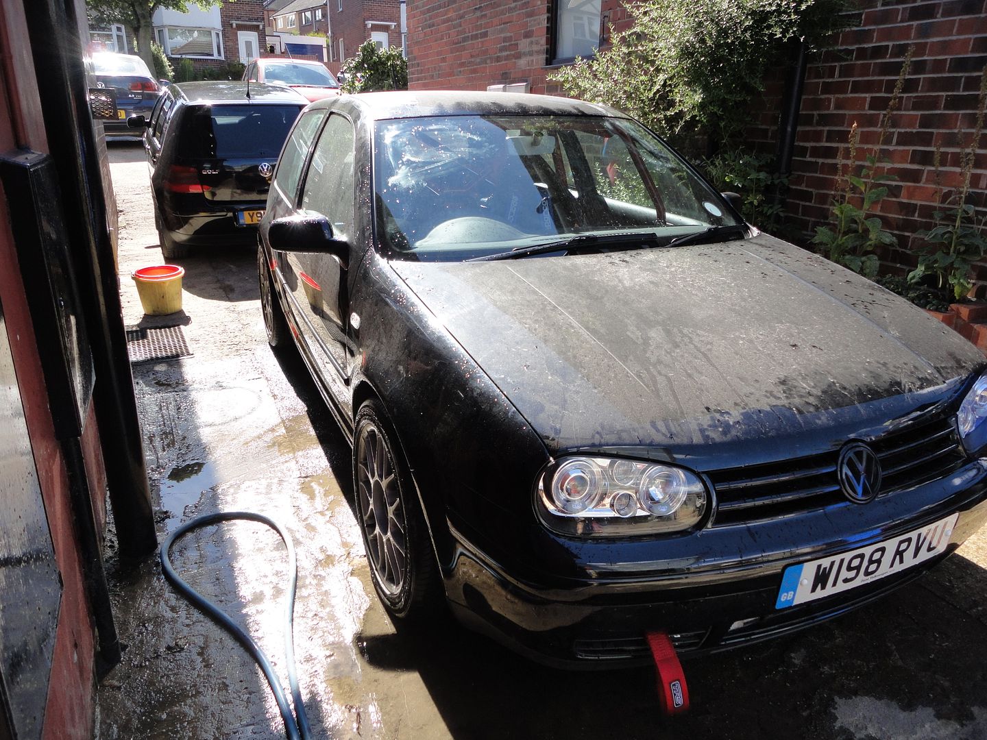

I then set about trying to clean 8 months of dirt and grime off of the car!
A before shot...
After washing but before polish...

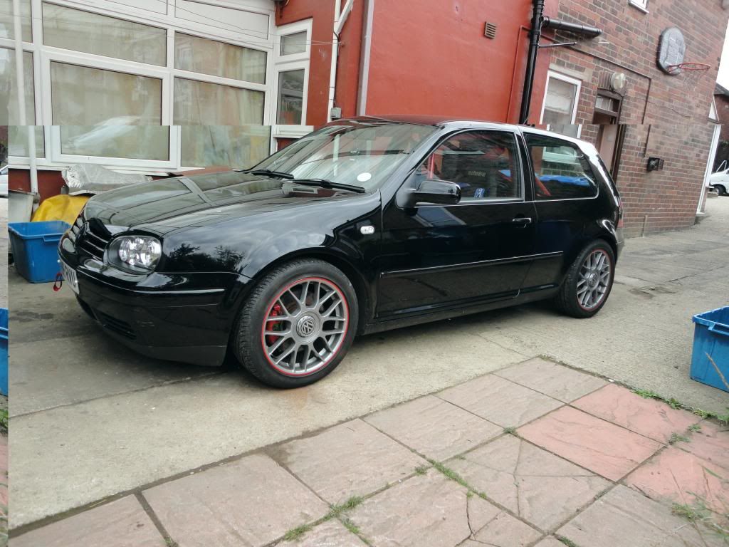

Me and Ryan then proceeded to clay bar, polish and wax her!
And this was the end result! Which is pretty good considering it was all done by hand!

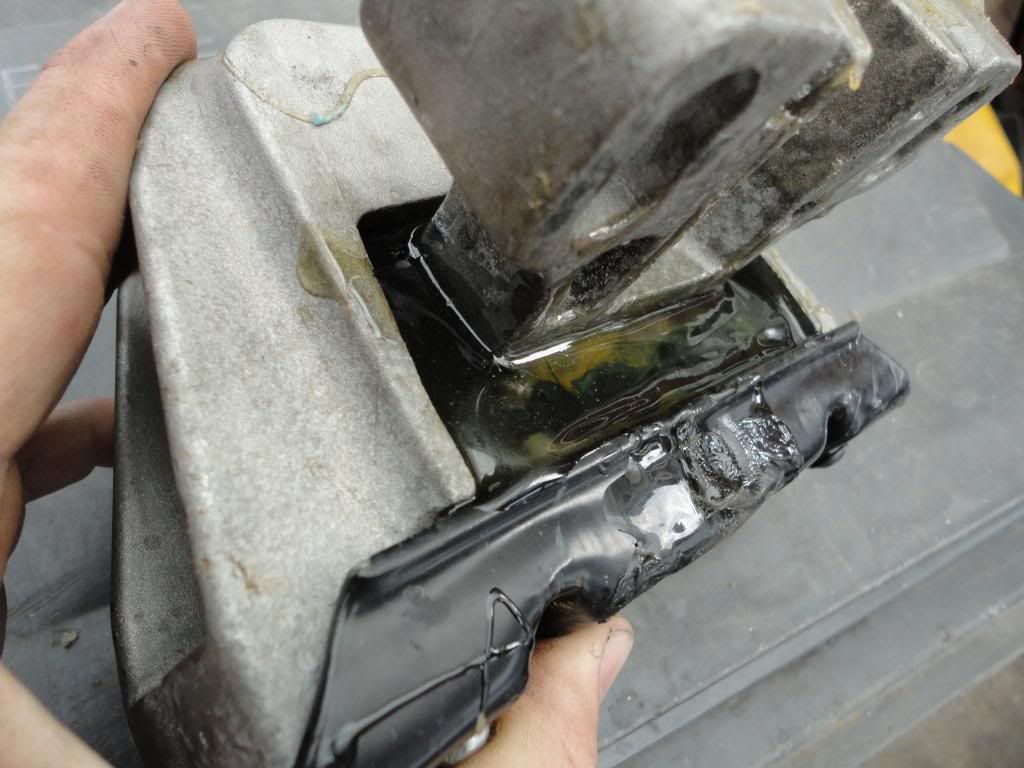

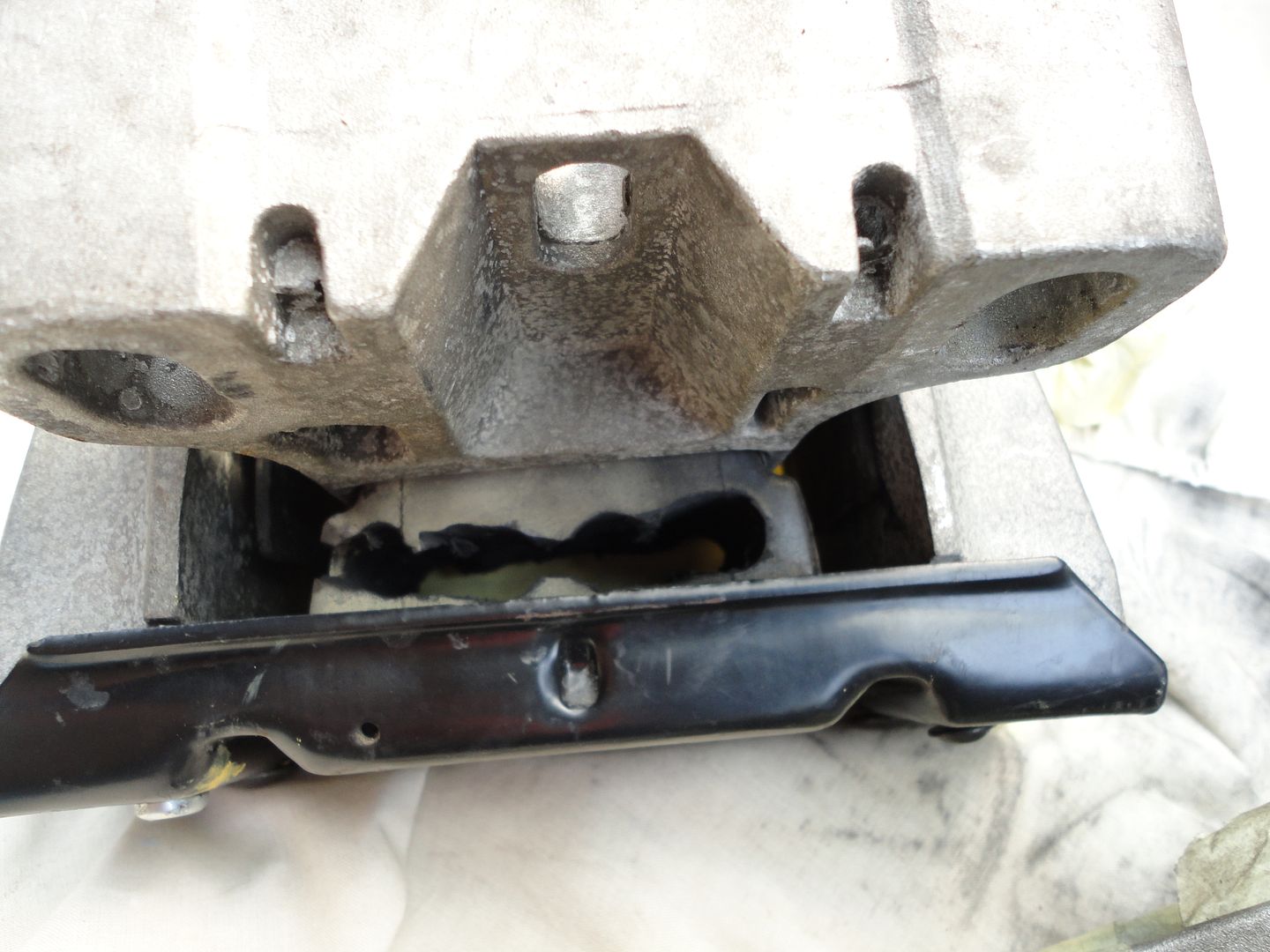

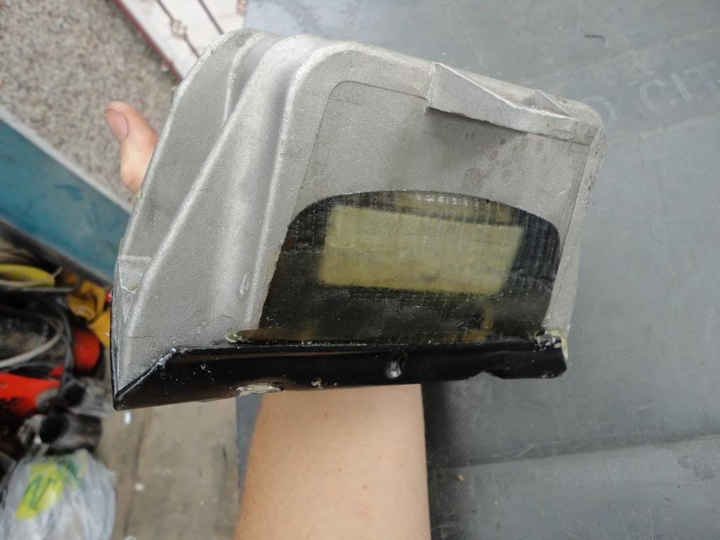

Also got around to polybushing my ths engine mounts which involed cutting away as much of the old softer poly to replace with the harder poly i purchased
And finished
