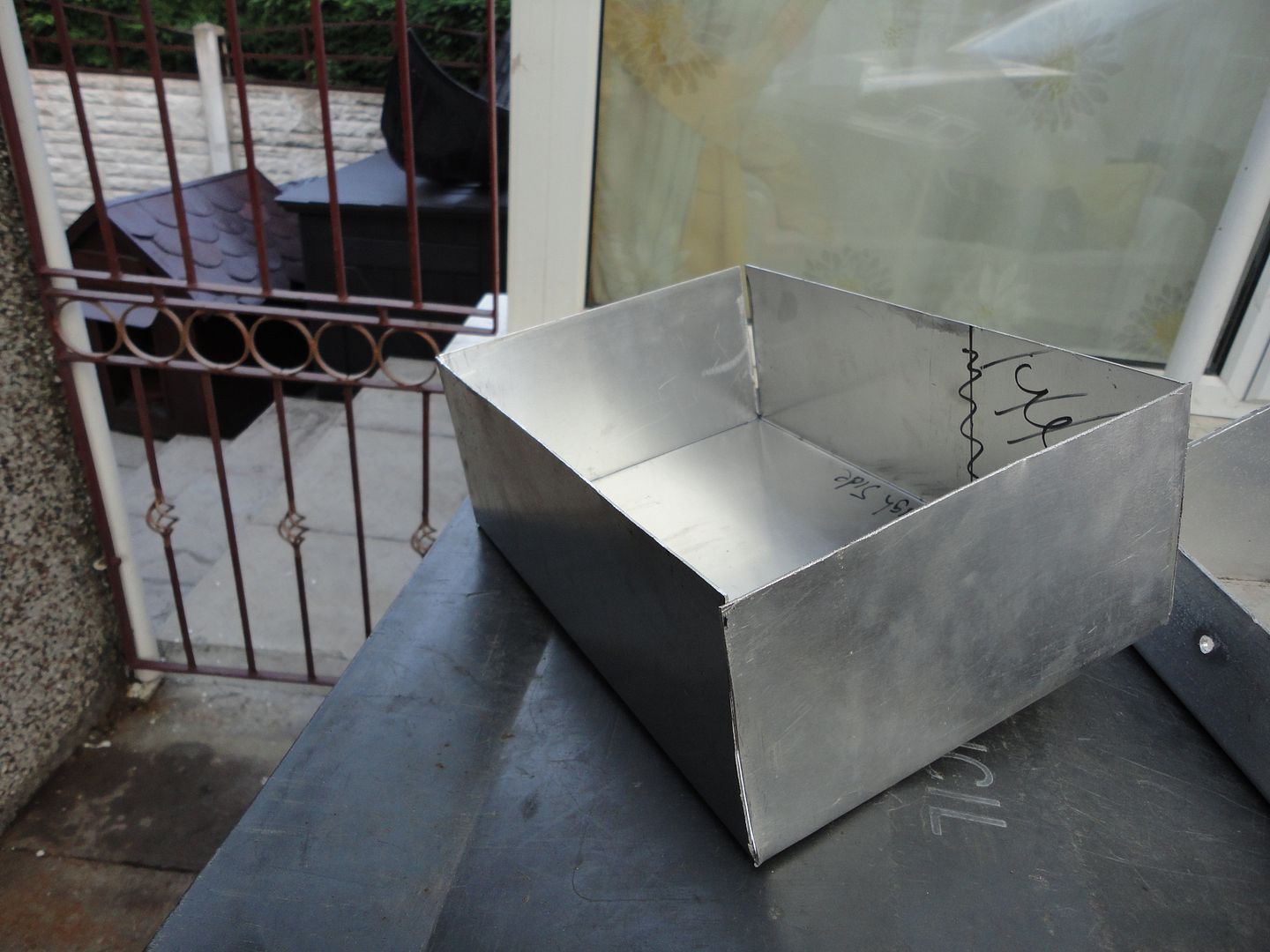

The battery box!
Just needs the edges of the lid welding together and then a few hols drilling to bolt it all up and to vent it to atmosphere

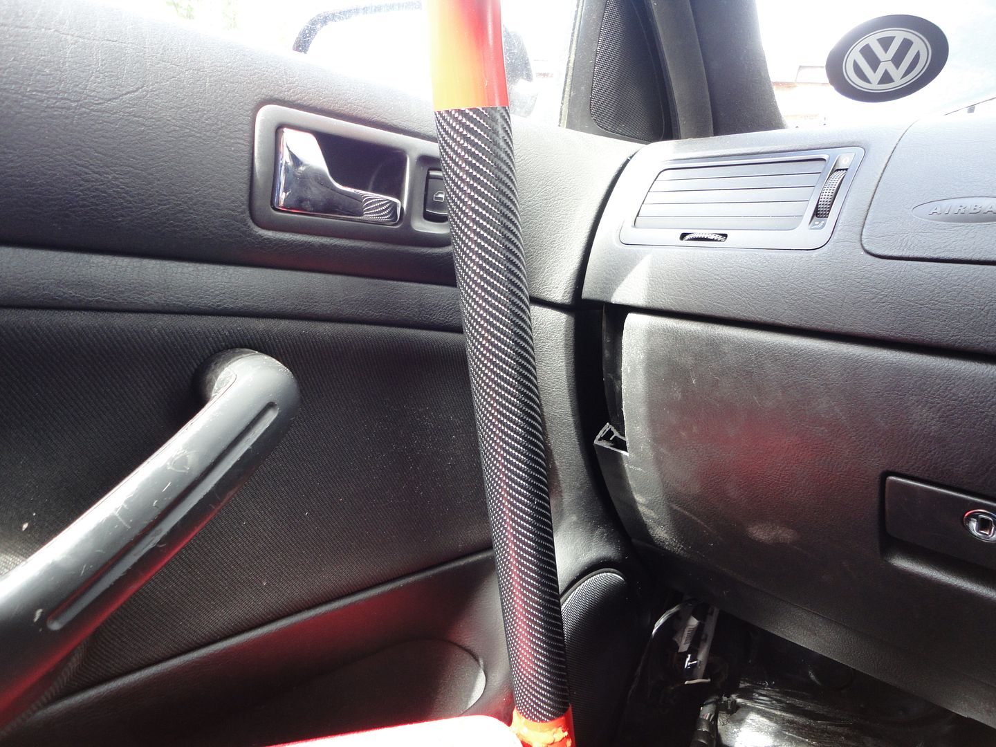

Also decided to get rid of the protective film i had and the cage bars to stop me scuffing the paint with my feet and replace it with carbon wrap as it looked rubbish  :cool:

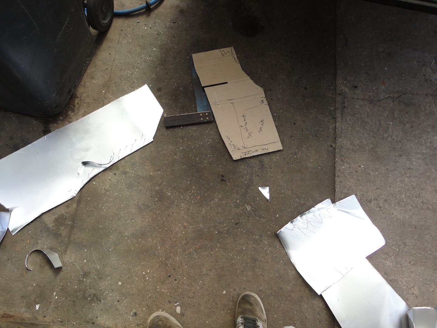

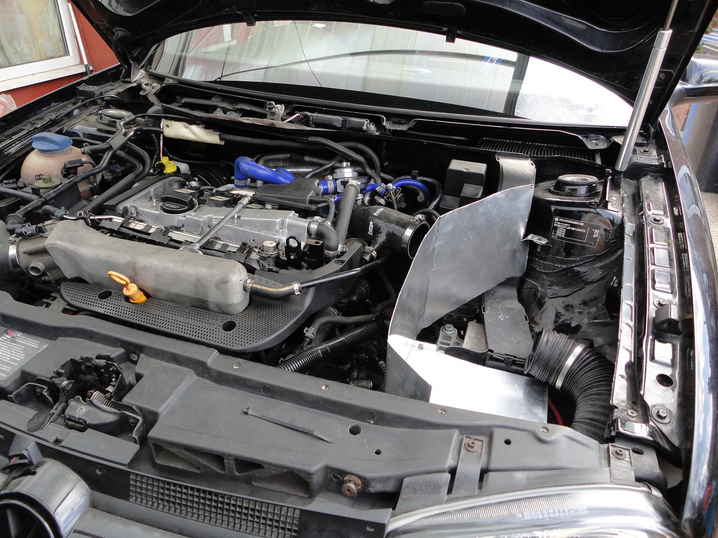

I then got around to making the heat shield i have been planning
Cutouts and the template
In position!
Just need a nice big holesaw now  :grin:

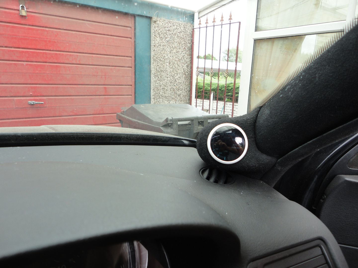

Removed my boost gauge from the old daily, painted the pod black and fitted it to the track car  :cool:

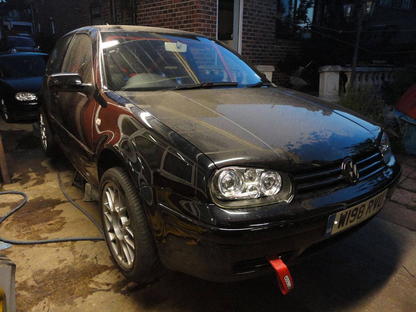

Did some cutting of the bumper so it now fits with the intercooler.
How it looks  :cool:

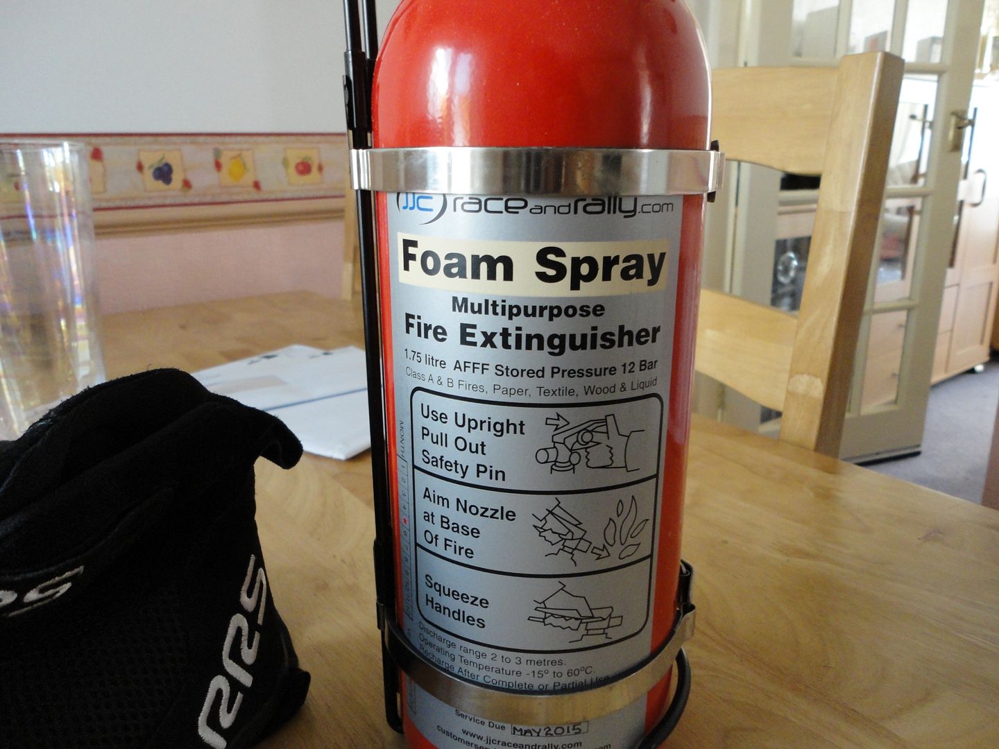

Ordered a afff foam extinguisher and some driving shoes from jjc rally  :cool:

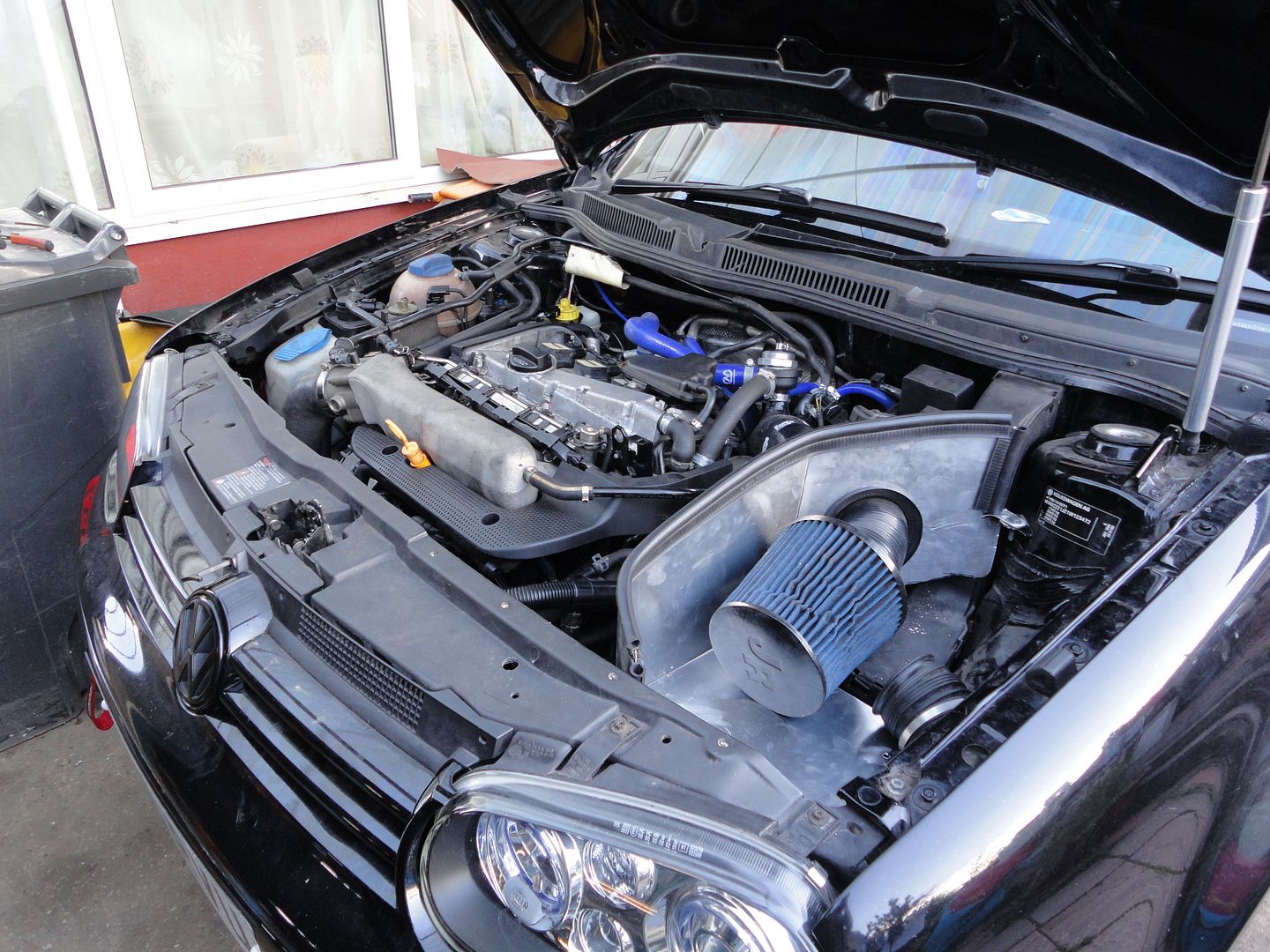

Also i ordered a set of holesaws and some rubber seal....with a bit off playing with the heatshield this is what i came out with!  :grin:
I will be getting a new *Bigger* air filter but this one is ok for now  :laugh:
And installed  :cool:
I also got around to fitting the fire extinguisher ....
