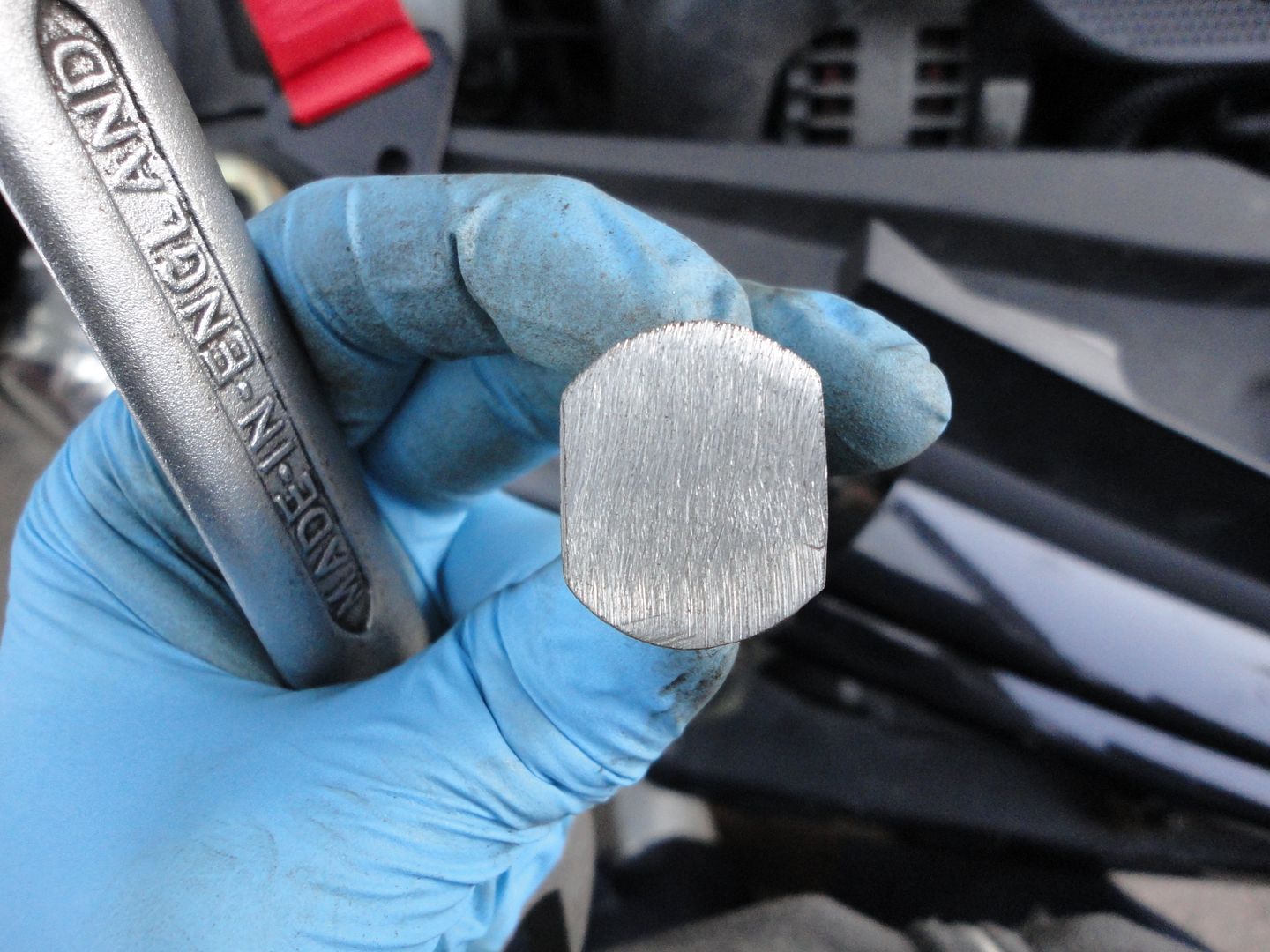

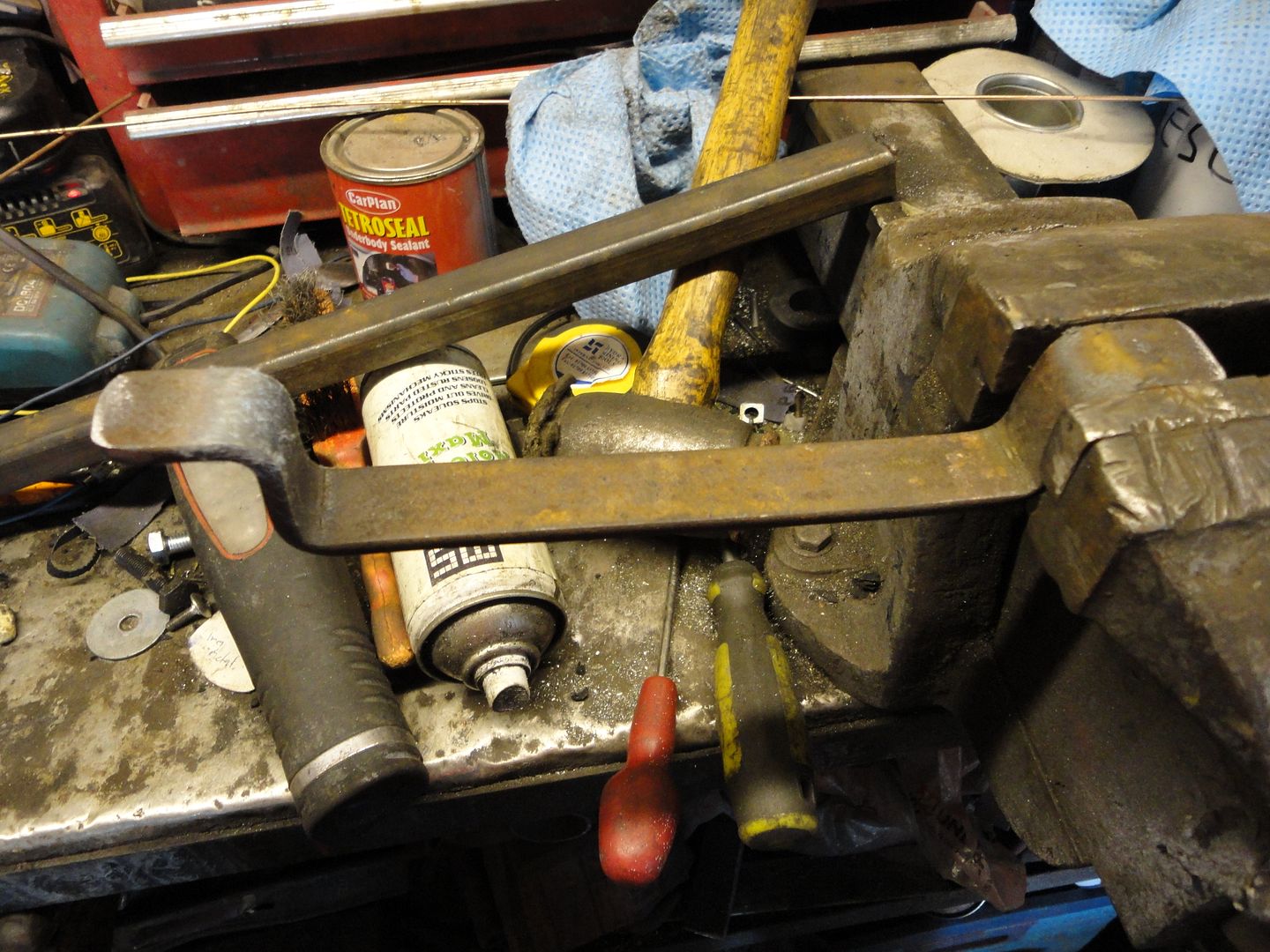

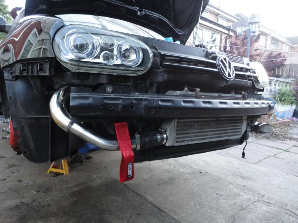

Don't get much time after work but managed to sort the tow strap
used the original toeing eye as a bolt as its a left hand thread and dont have many LH bolts lying around ha
Installed

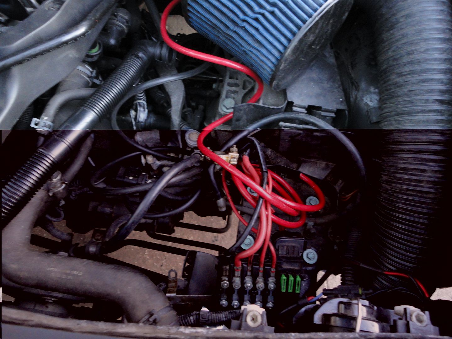

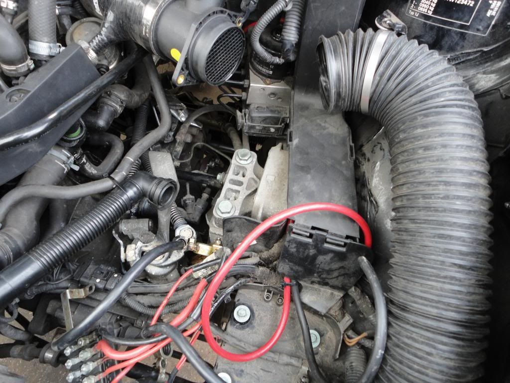

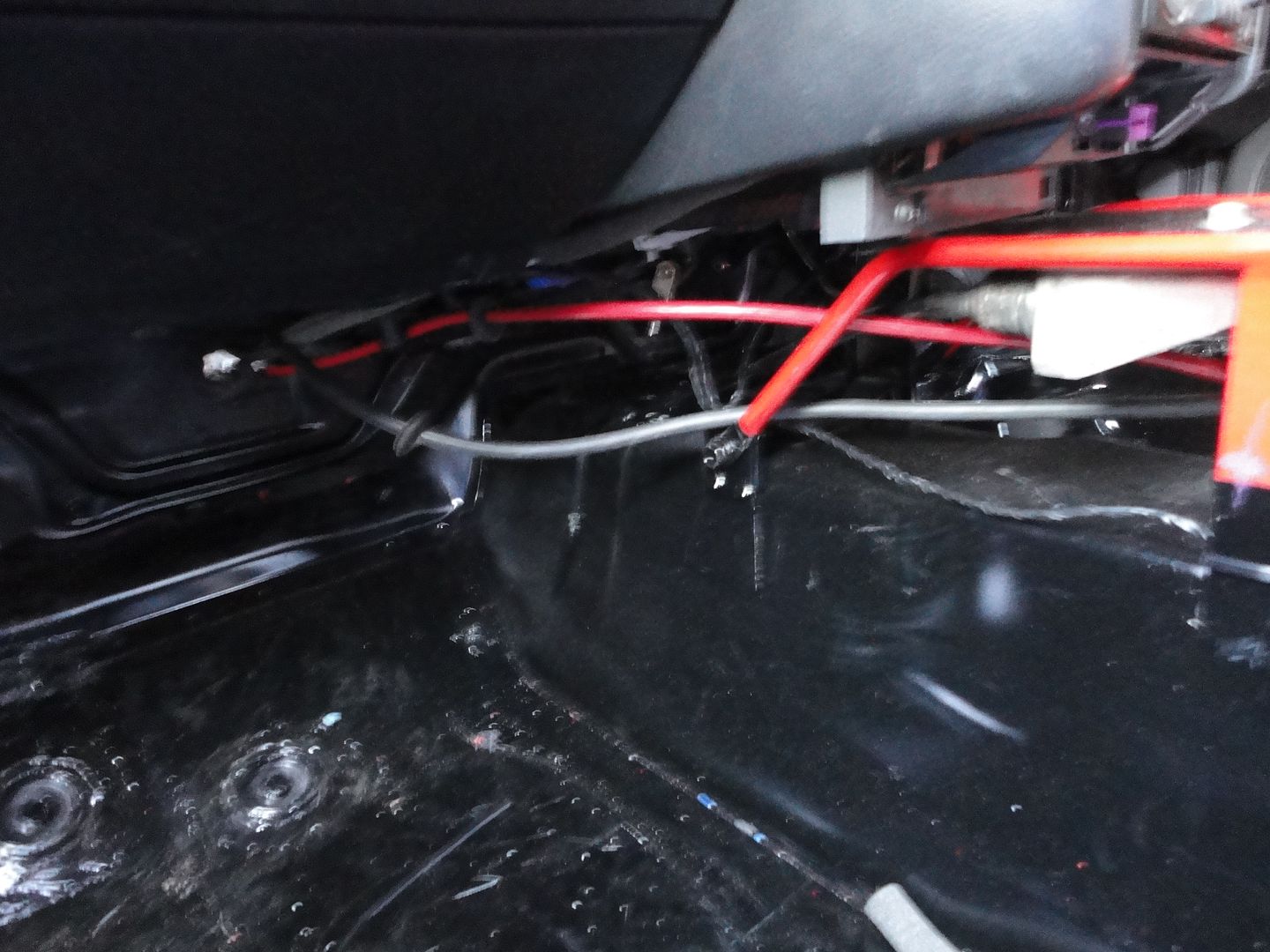

Also decided i would start relocating the battery

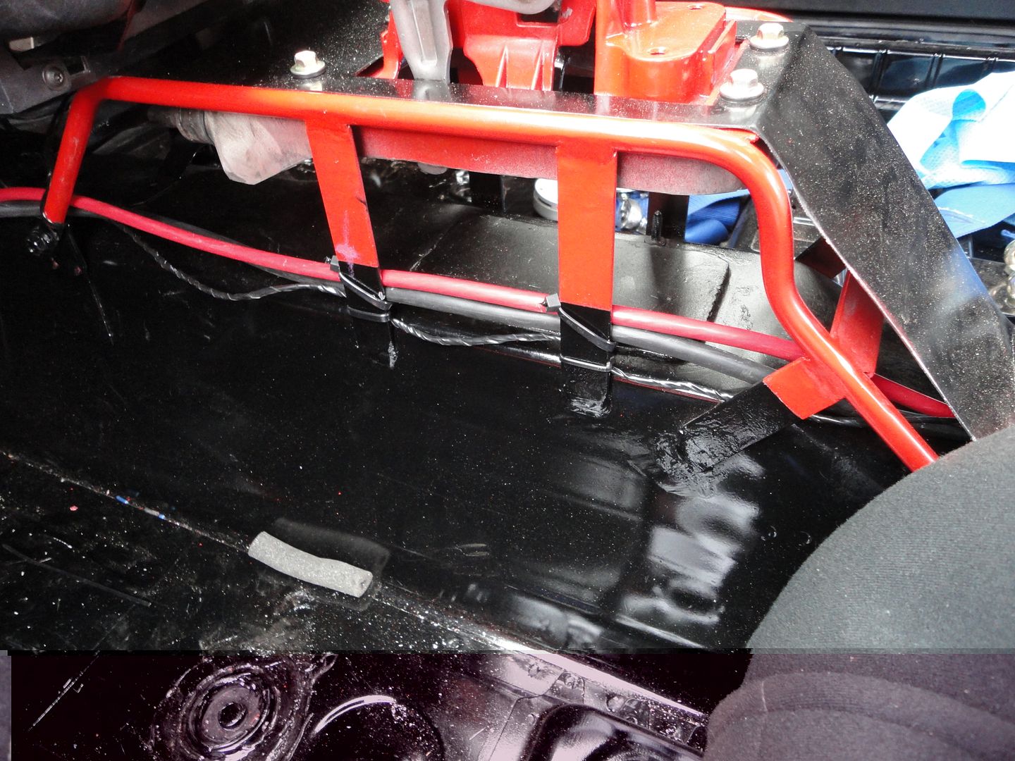

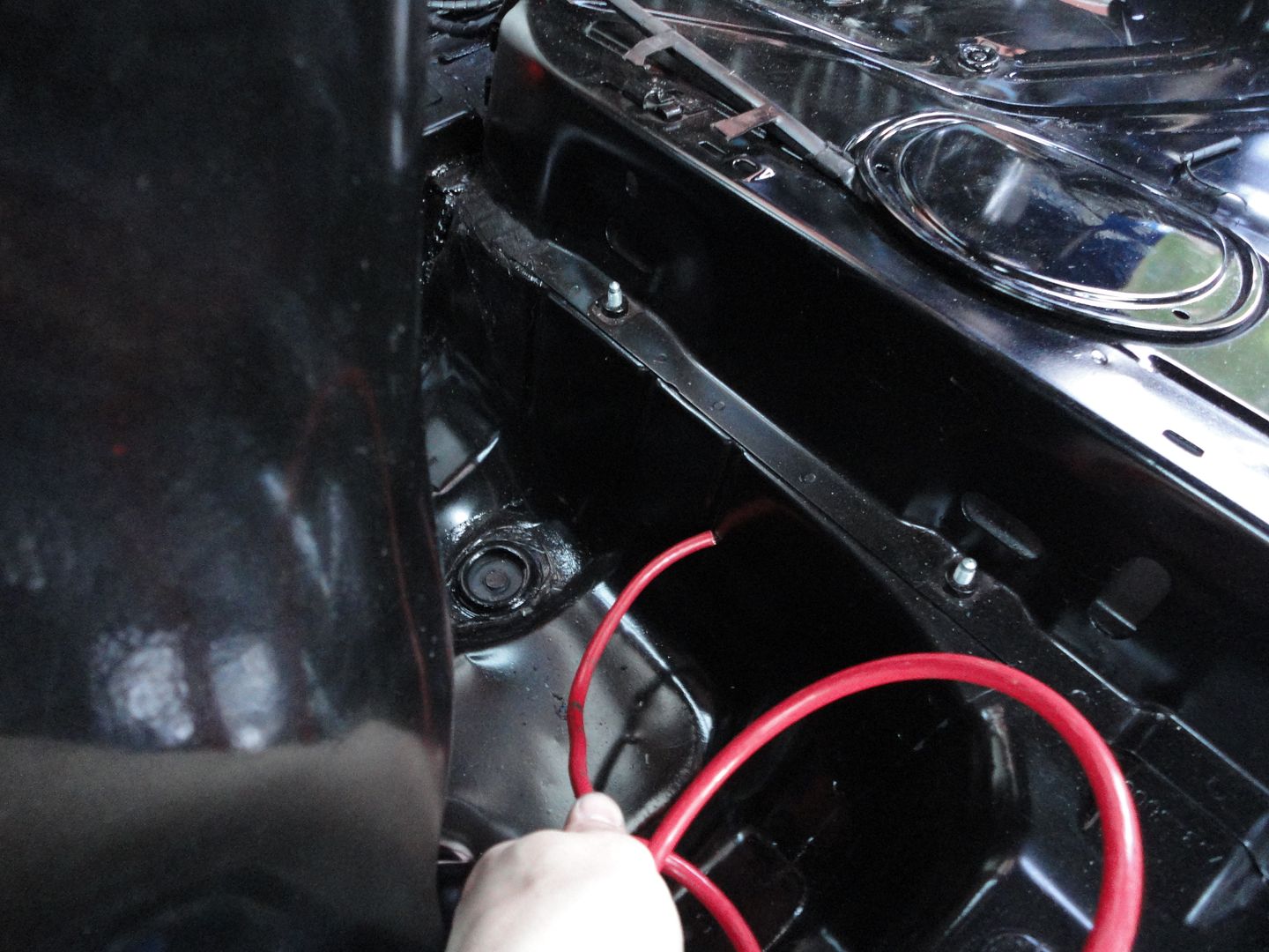

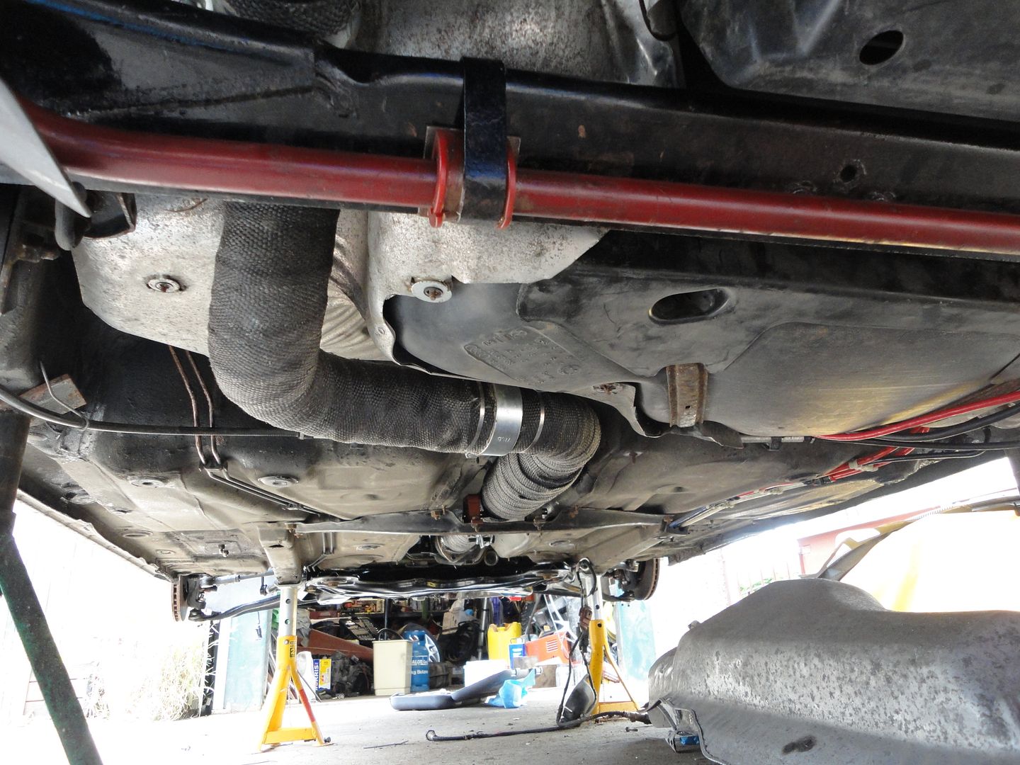

A bit of a mess but you can see im running the cables through the firewall and beneath the shifter platform so i can install a isolator when i acquire one. and then back outside behind the drivers seat and along the tank, over the axle on the inside of the plastic tray and into the wheel well.

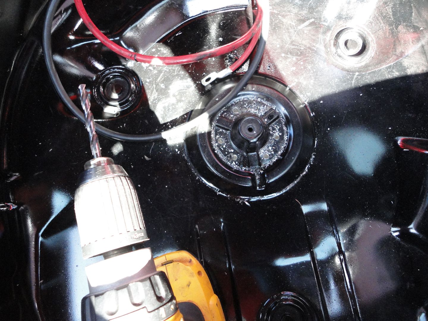

had today off work so managed to knuckle down a bit and get a few decent hours on it.
managed to finish routing the battery cables...the holes have been drilled then fitted with grommets and tiger sealed  :cool:
Had a brainstorm with the old man about what else we need and instead of buying a battery box as i was going to i have have bought a lighter battery and am going to clamp it down in the wheel well with a homemade bracket  :cool:
Also getting all the connections i need tomorrow so may be able to get it to the point when i just need to bolt the battery in

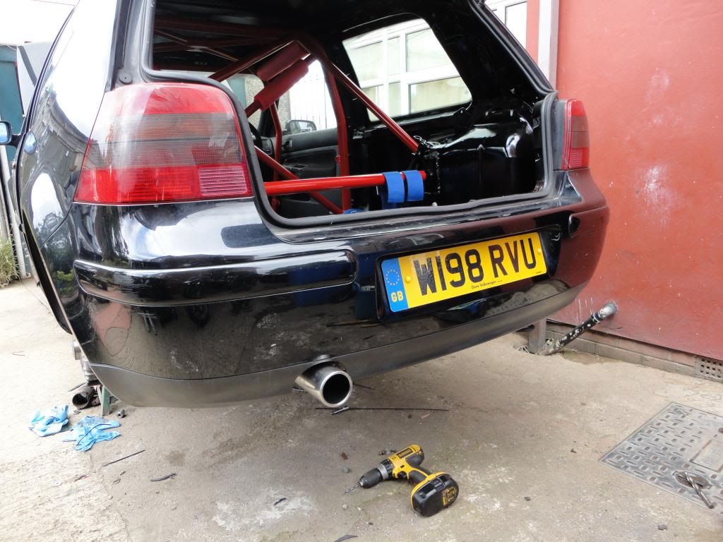

I then got around to fitting the exhaust  :cool:

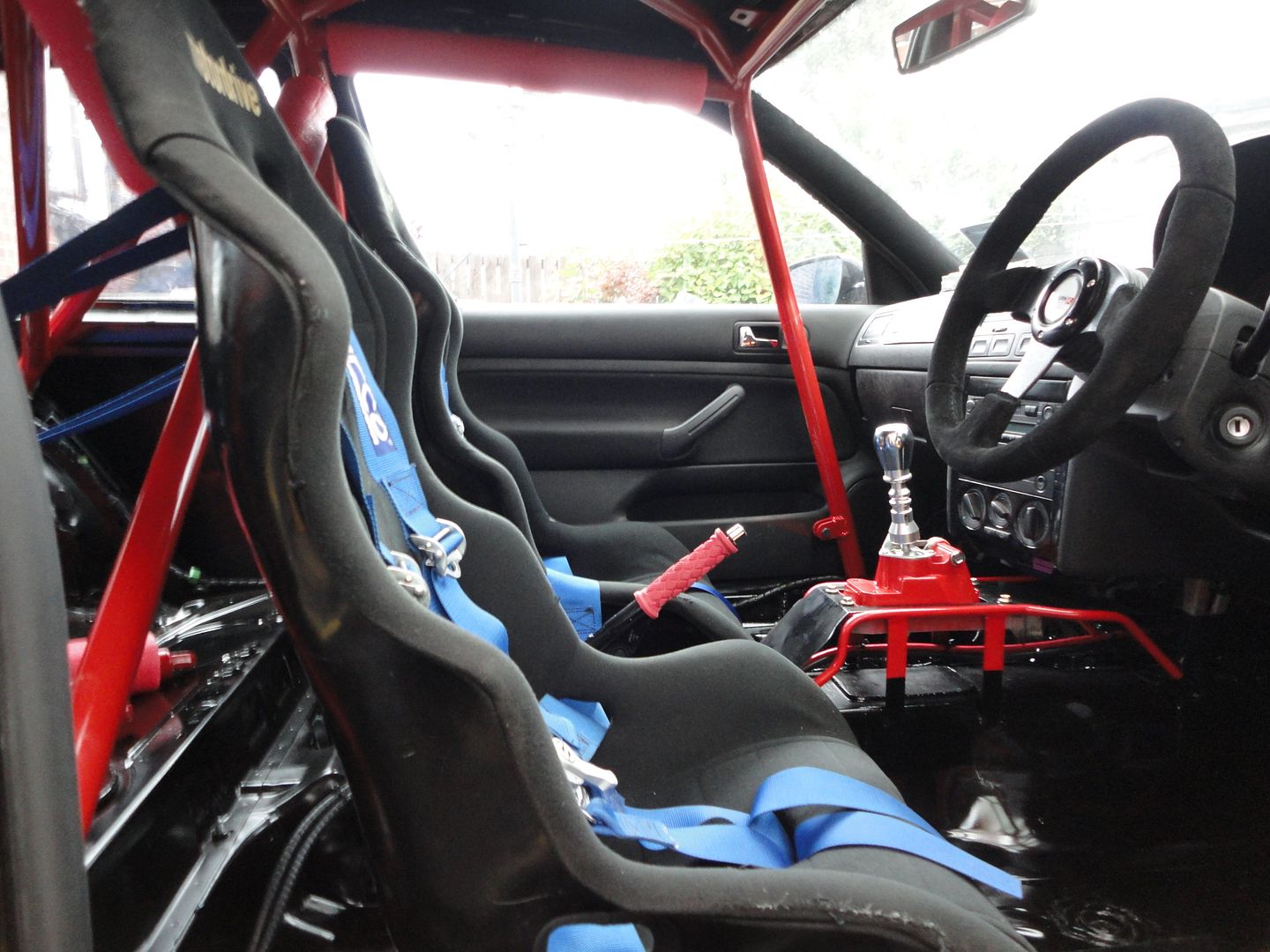

While the seat was out i decided to adjust it forward one and lean it back one as they were very upright and didnt feel right.
You can see the drivers seat is just ever so slightly more leant back but it makes quite a difference to the feel

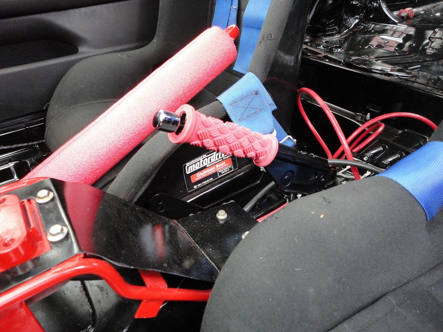

......o yeah i couple of other things arrived  :grin:
My bmx grips

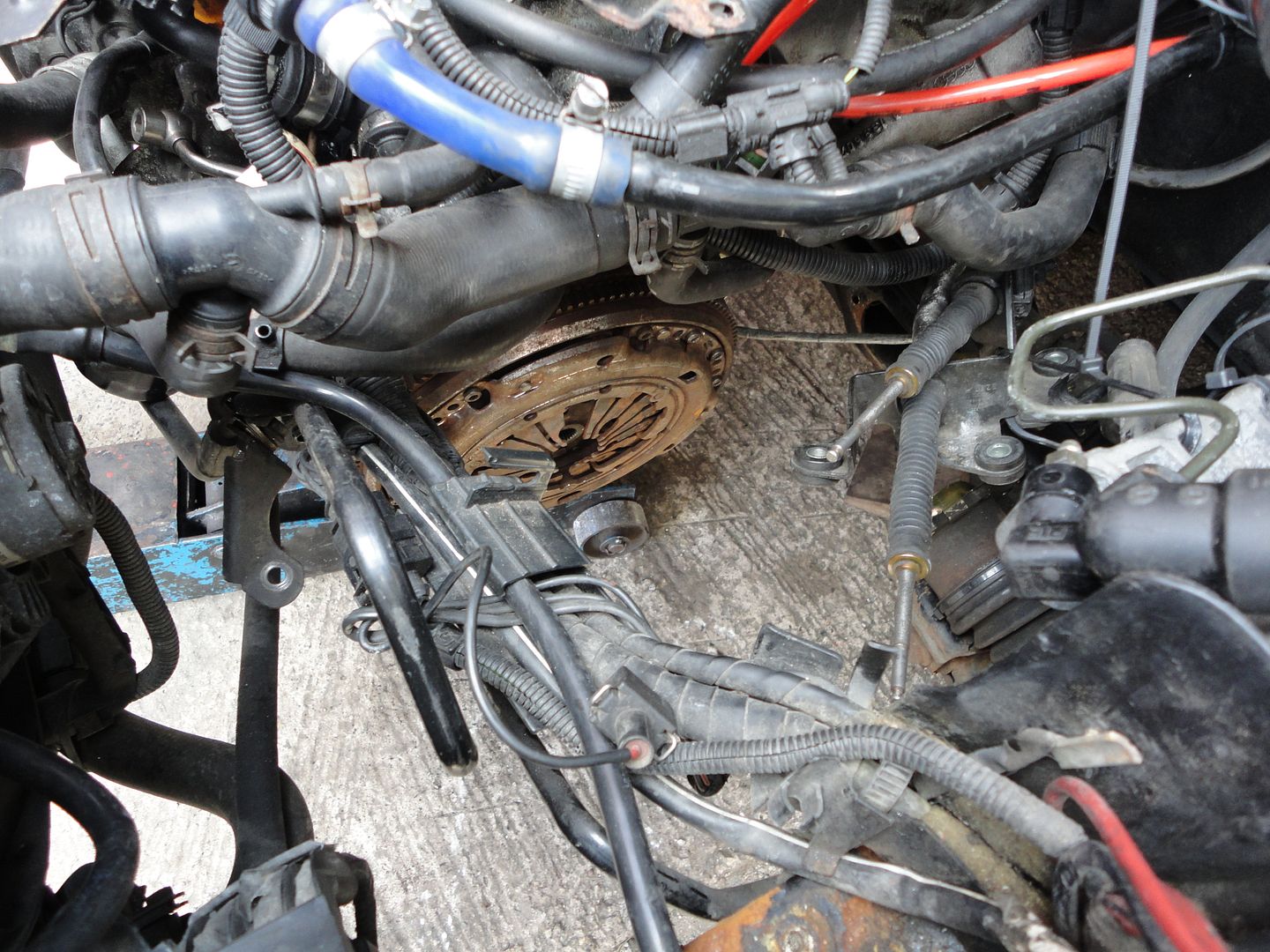

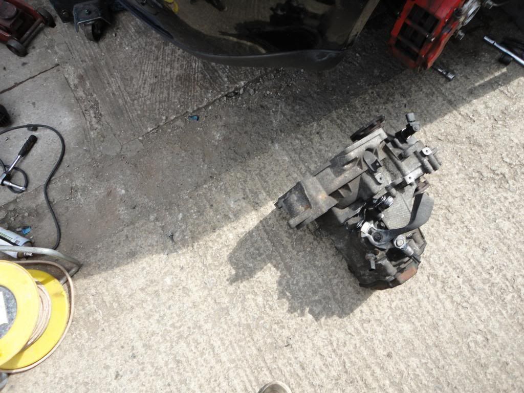

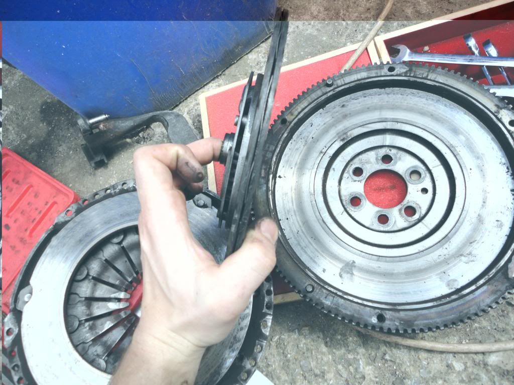

OK so today i got on with removing the vr6 clutch and g60 flywheel setup off of the daily and return it backl to standard with one of the many clutches i have lying around  :laugh:
Managed to wrestle the gearbox out and get the standard clutch and dmf installed
Also the vr6 friction plate looks pretty good. so should hopefully last me untill the turbo upgrade next year.
putting it all back together was a bit of a pain as it just didnt seem to want to go but it eventually went.

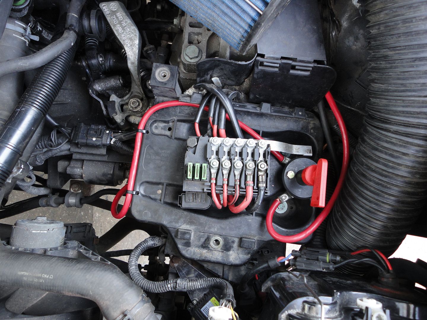

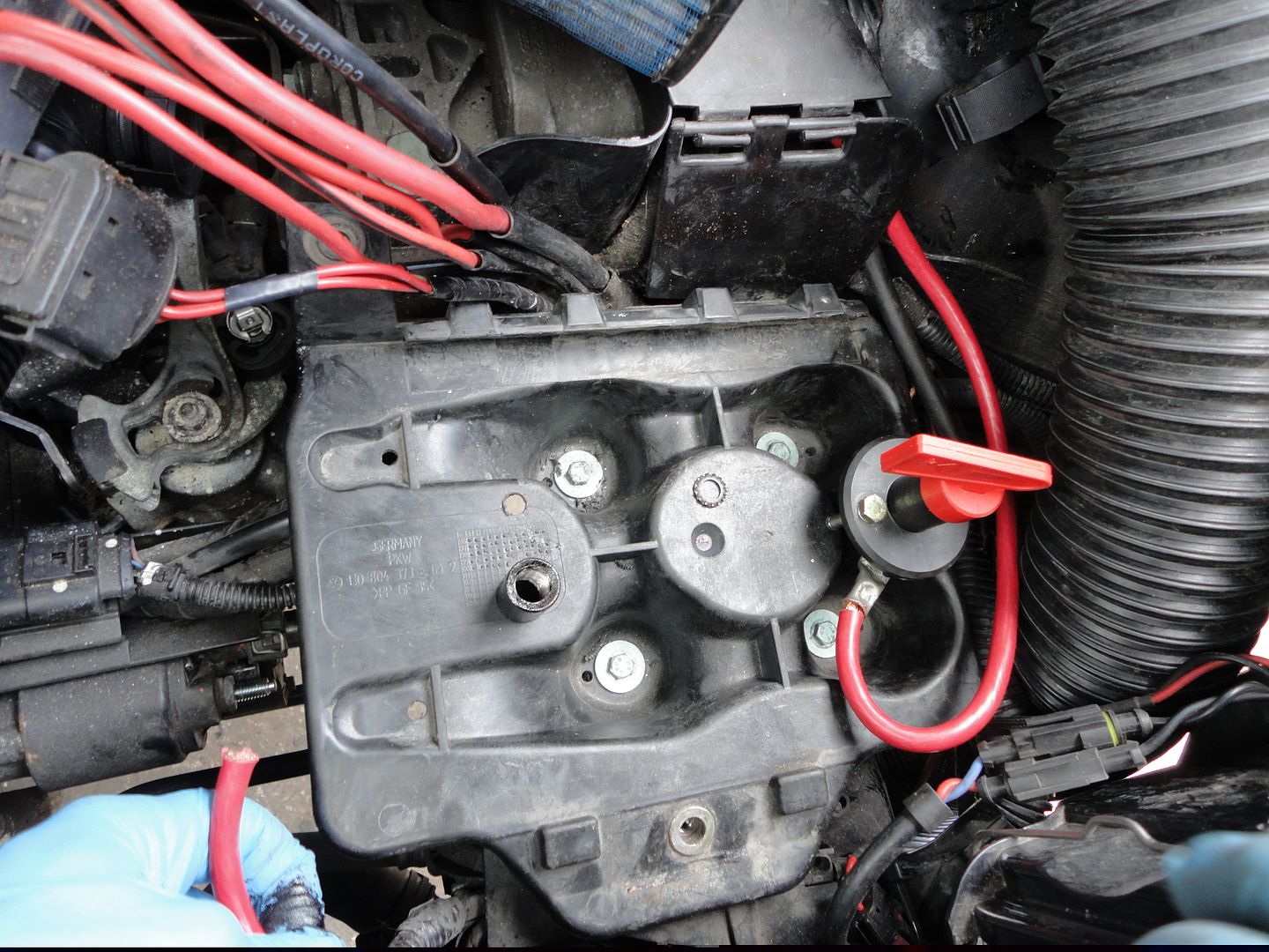

got on with finishing the batter relocation at the front end.
I didnt have any connector blocks but i had a isolator lying around so used that to join the live coming from the battery and the starter and fuse board lives.
And finished

Have you put the third wire and resistor on the kill switch?
Offline golfyste
  • Posts: 1,767
  • Project track car
Yeah it is quite a bit smaller Dave will post some pics up tomorrow
I will sort a box don't worry  :cool:
DH the kill switch is literally just being used as a connector block as i could be bothered to buy one and is t fia approved with the extra point on the back for resistors etc but I will be installing a proper kill switch later on.

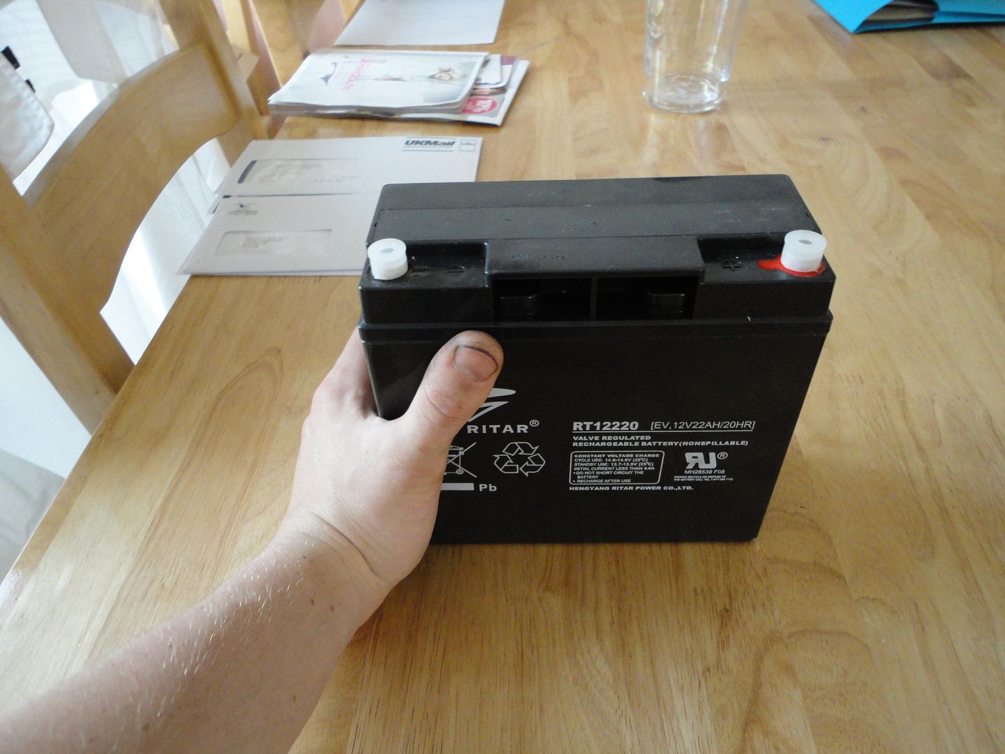

The battery arrived  :cool:

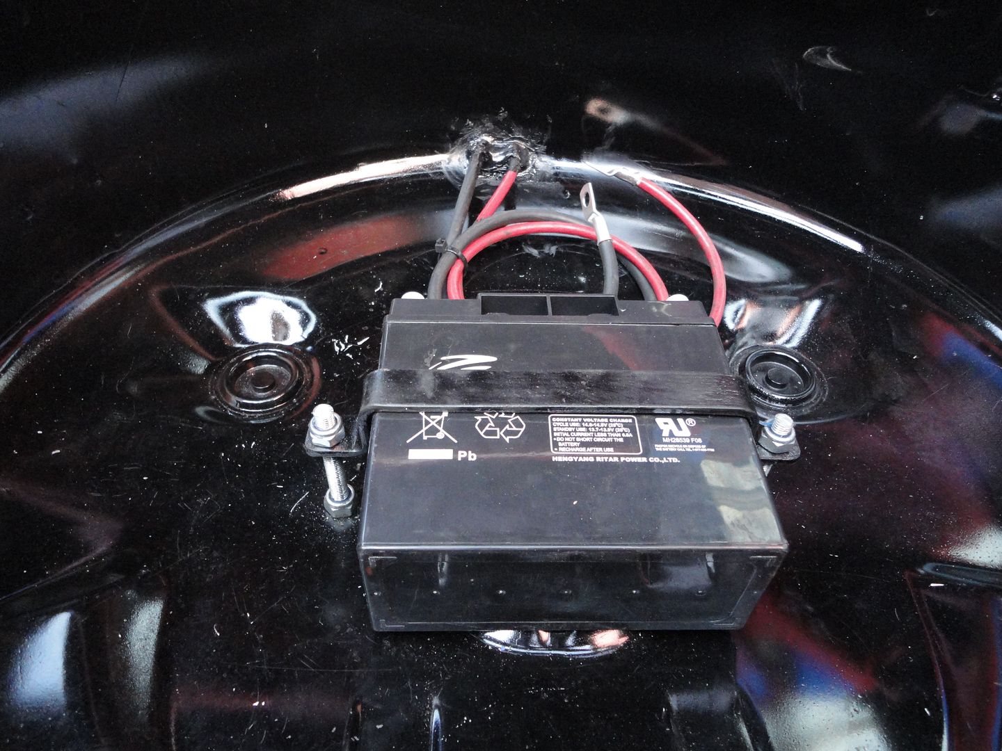

I wanted to get the car road worthy so i made a clamp to fit the battery for the time being but will definitely be looking at making a box or it when I get back off of holiday but this just means I will be able to get it started and insured, mot'd etc while I make a box.
Drilled the spot welds on the old spare wheel locator
Made the clamp
Painted the clamp, laid some stick on foam where the battery was going and bolted it all up with some threaded bar.
