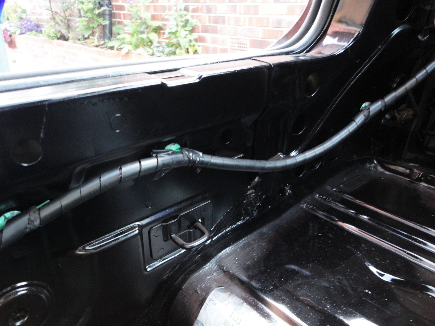

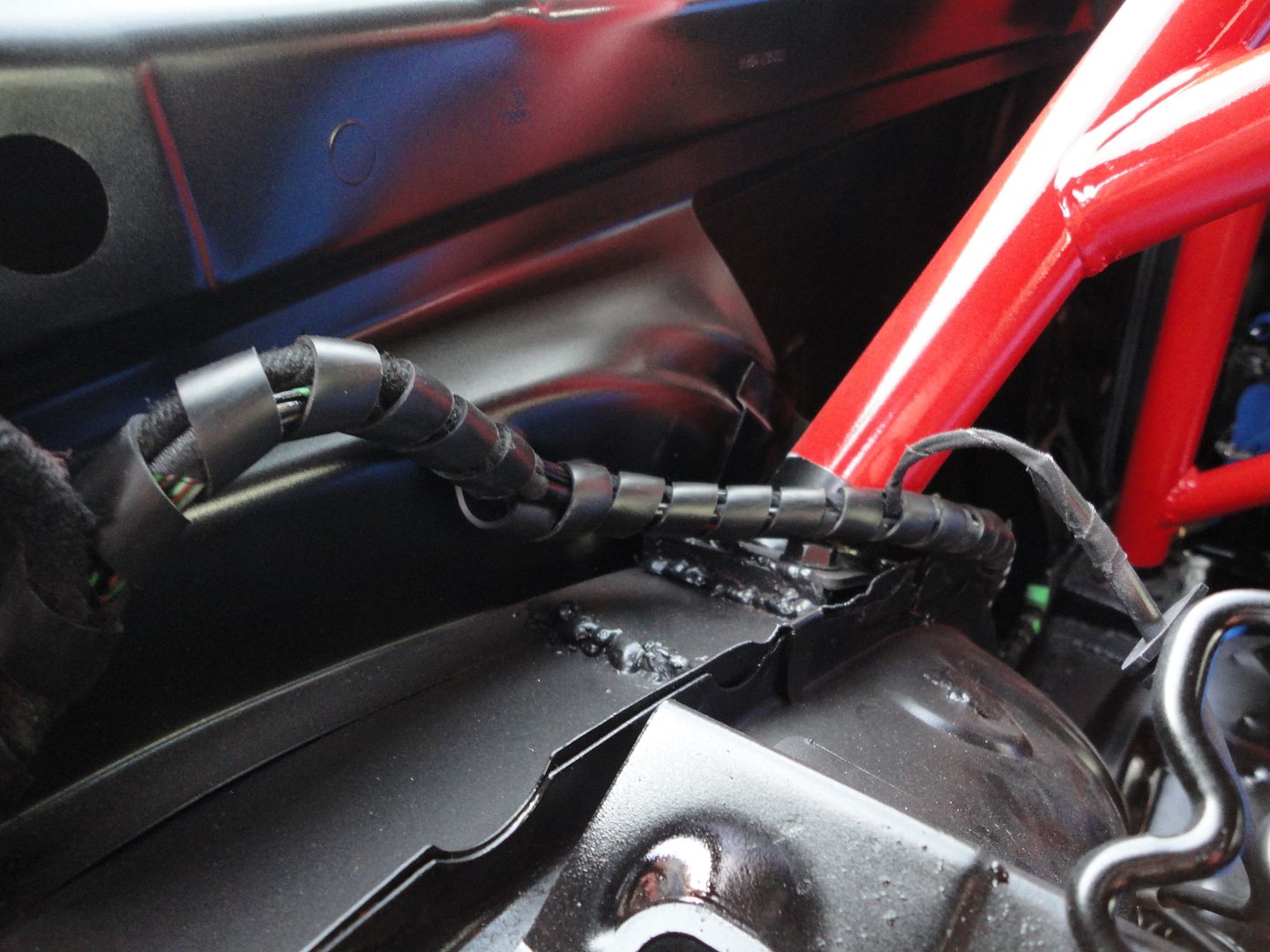

i went around the car and fitted cable protections to all the wires in the car
Im going to say now i have done quite a bit but ave been so caught up in the work i haven't really taken that many pictures as i always forget  :laugh:

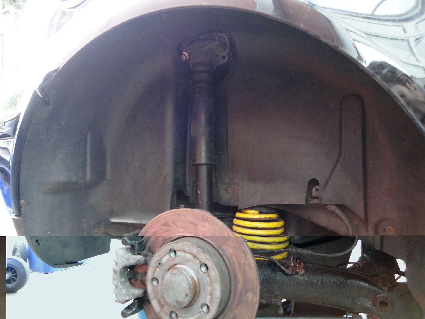

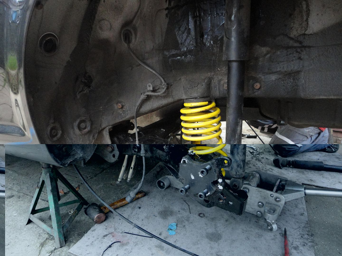

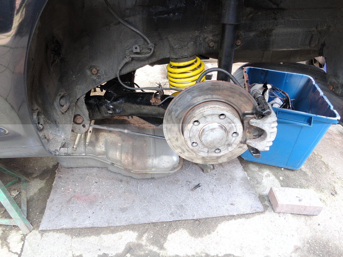

i refitted the tank and then fitted the rear axle
I then fitted the suspension, wheel bearings and the standard rear brakes (these will be getting upgraded shortly to 255mm discs when i get hold of some carriers but these will do for now)

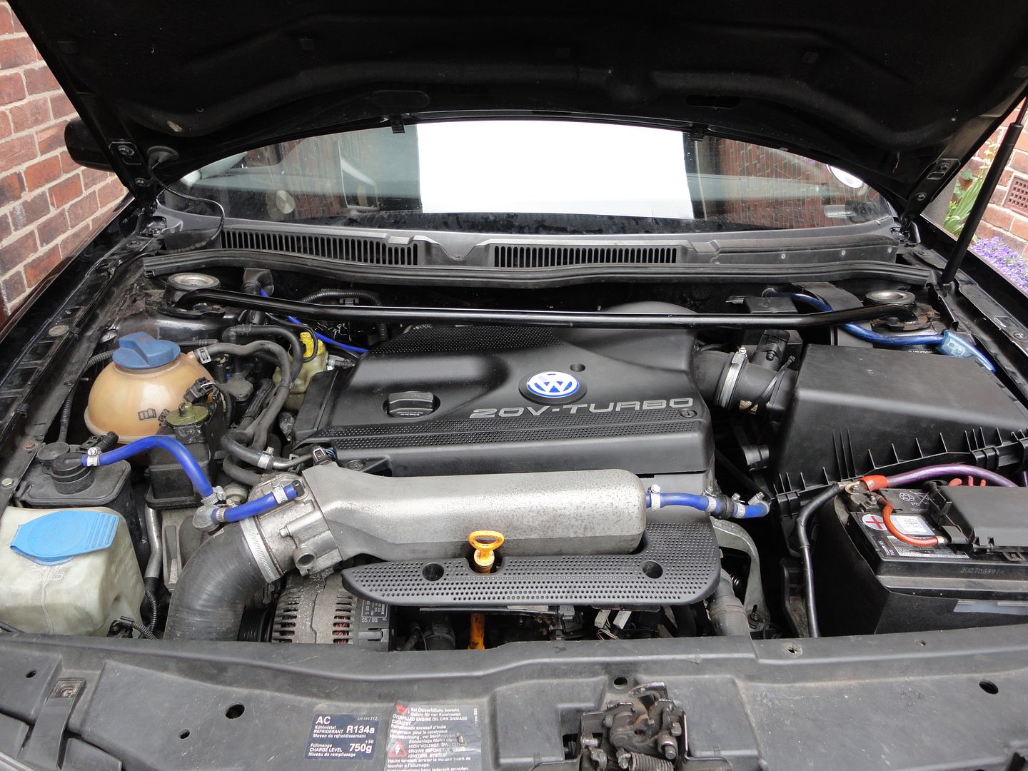

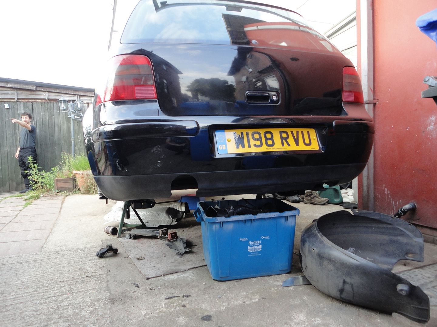

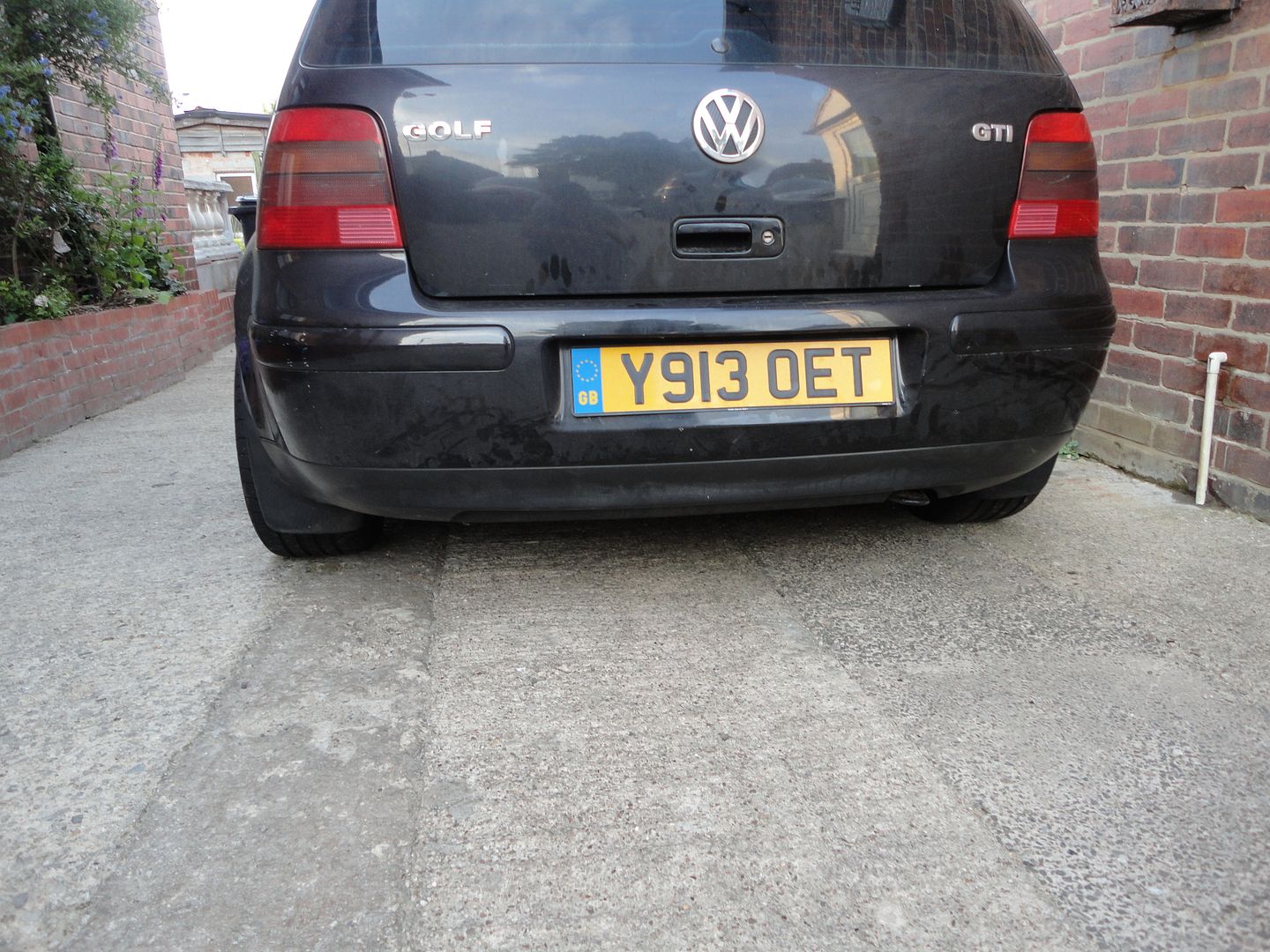

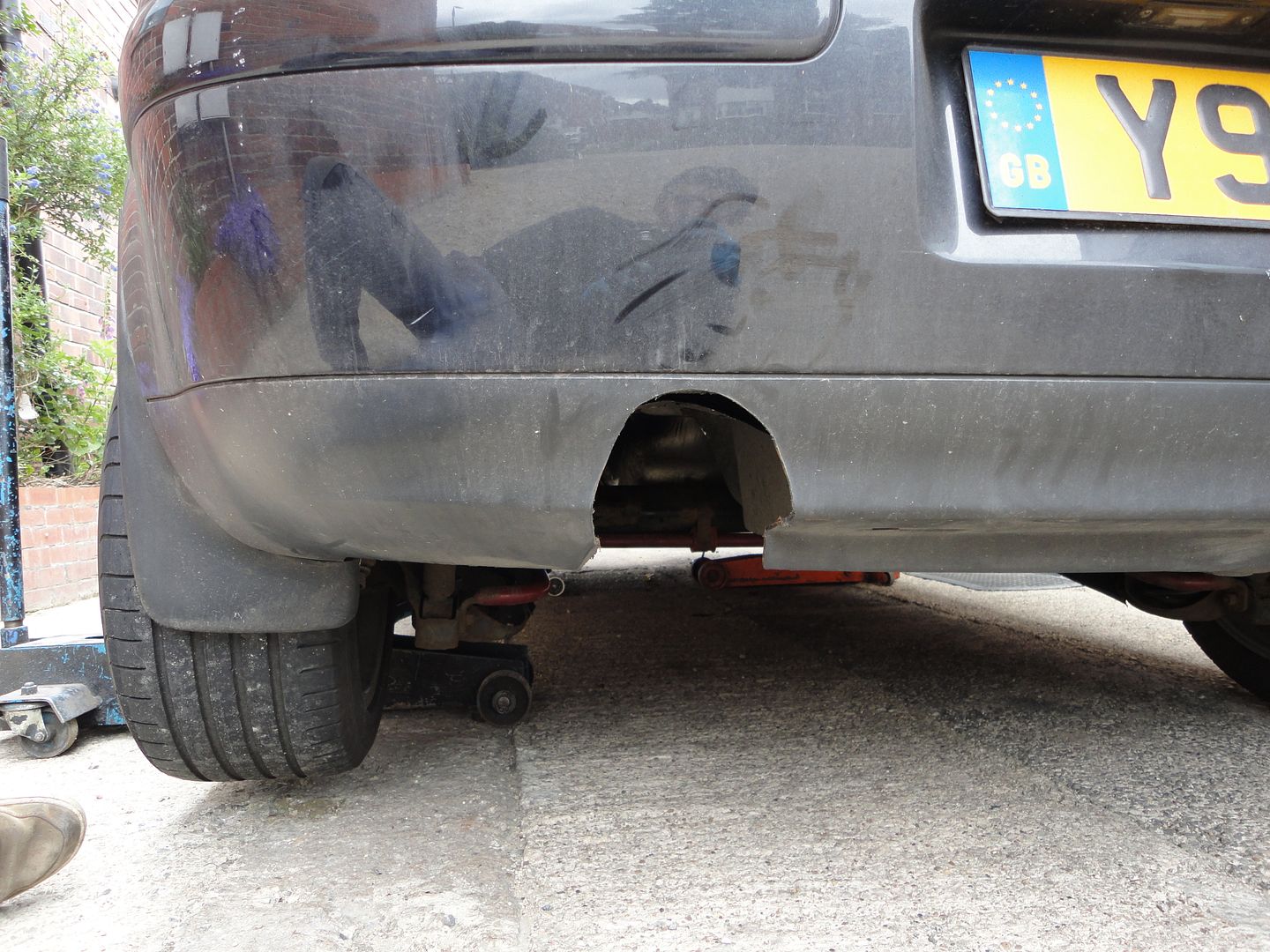

i removed the 3" system off the daily leaving a nice space and a crappy looking rear valance

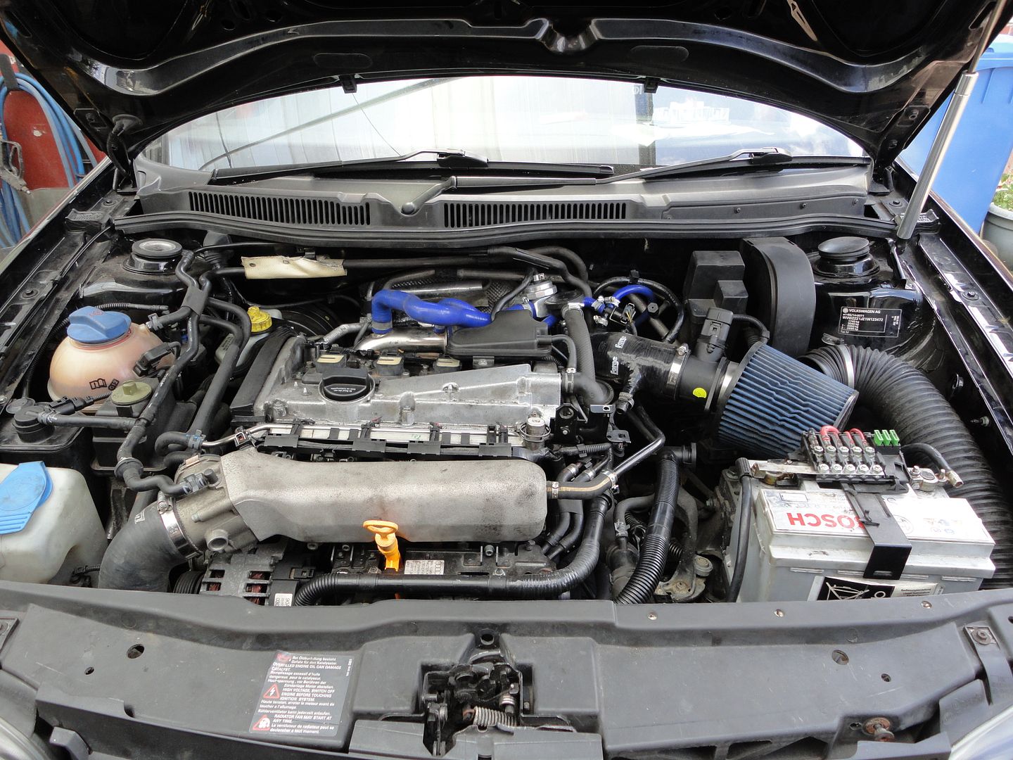

I then Spent quite a while (with very few pictures  :embarrassed:) switching the turbos from one car to the other aswell as loads of other bits
this was the end result - a nearly standard looking engine bay!

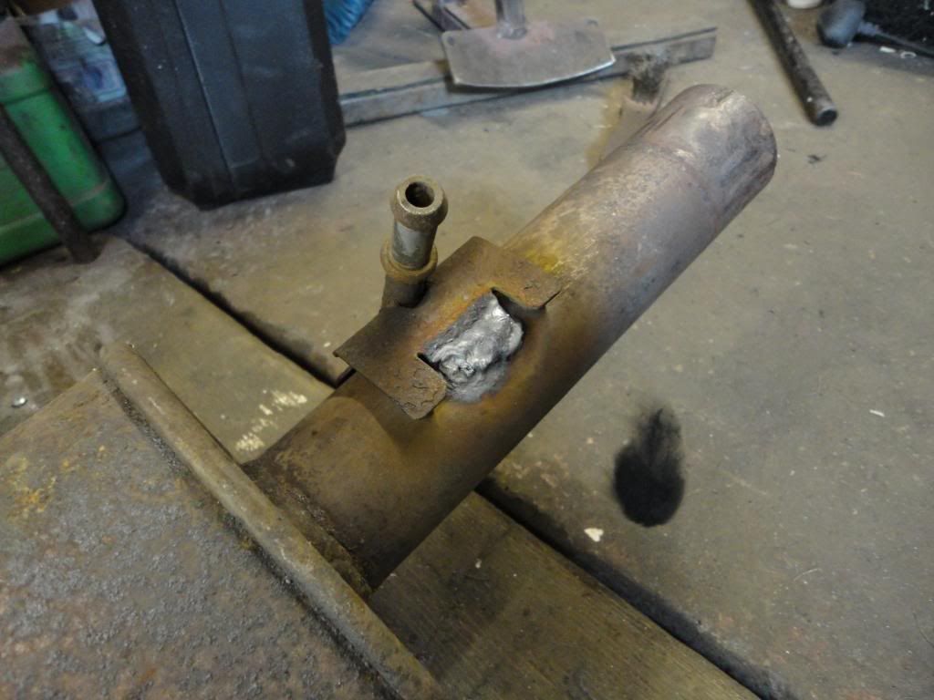

I then fitted the standard zaust to the daily, the centre bracket had broken off so had to weld it...
first ever attempt at gas welding! Pretty messy but its stuck ok   :laugh:
I also switched the valances so the dailys is standard and recut the modified one to neaten it up a bit!

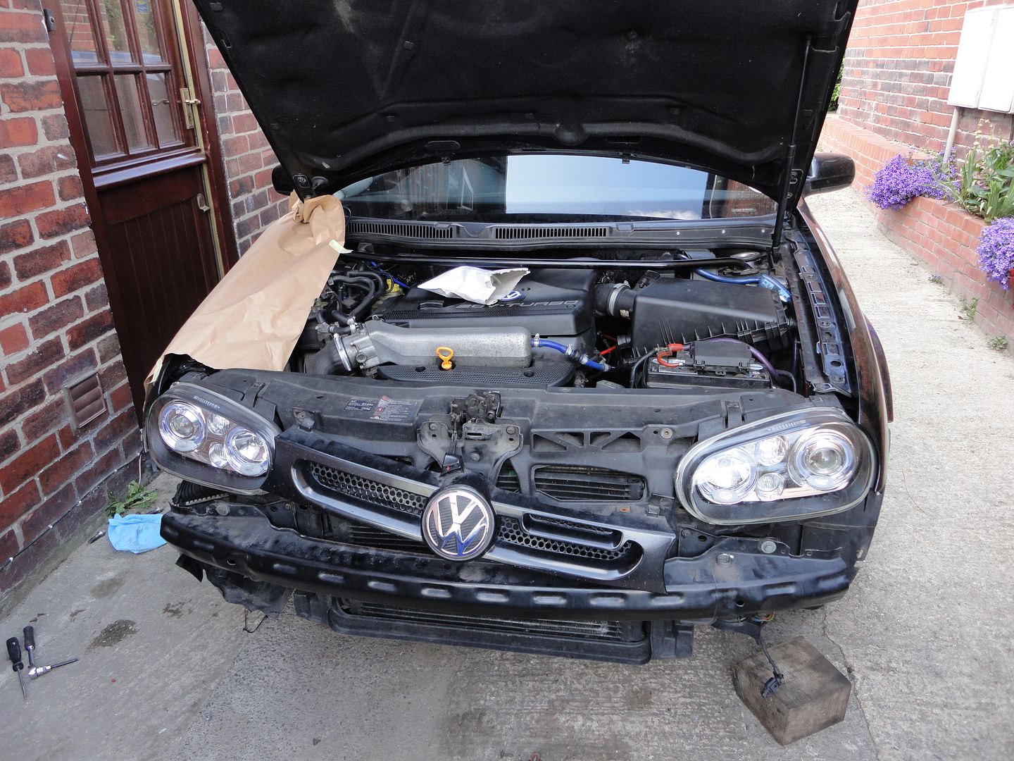

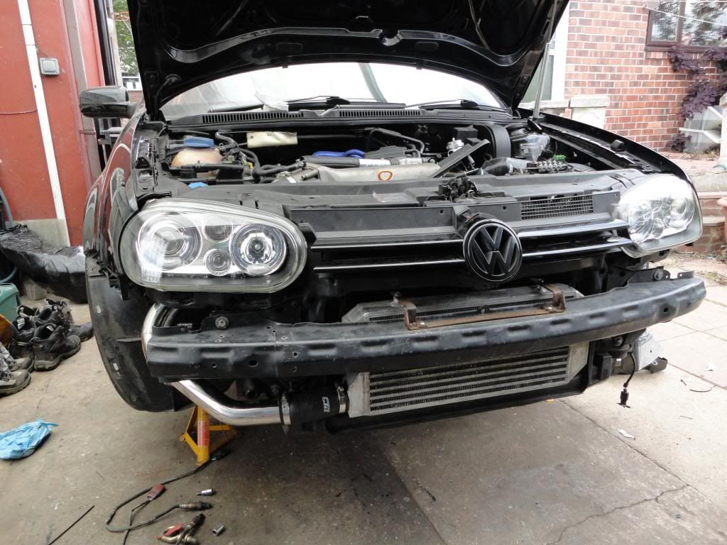

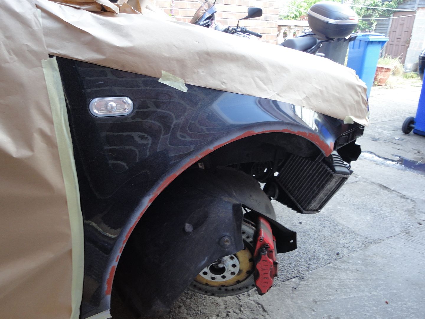

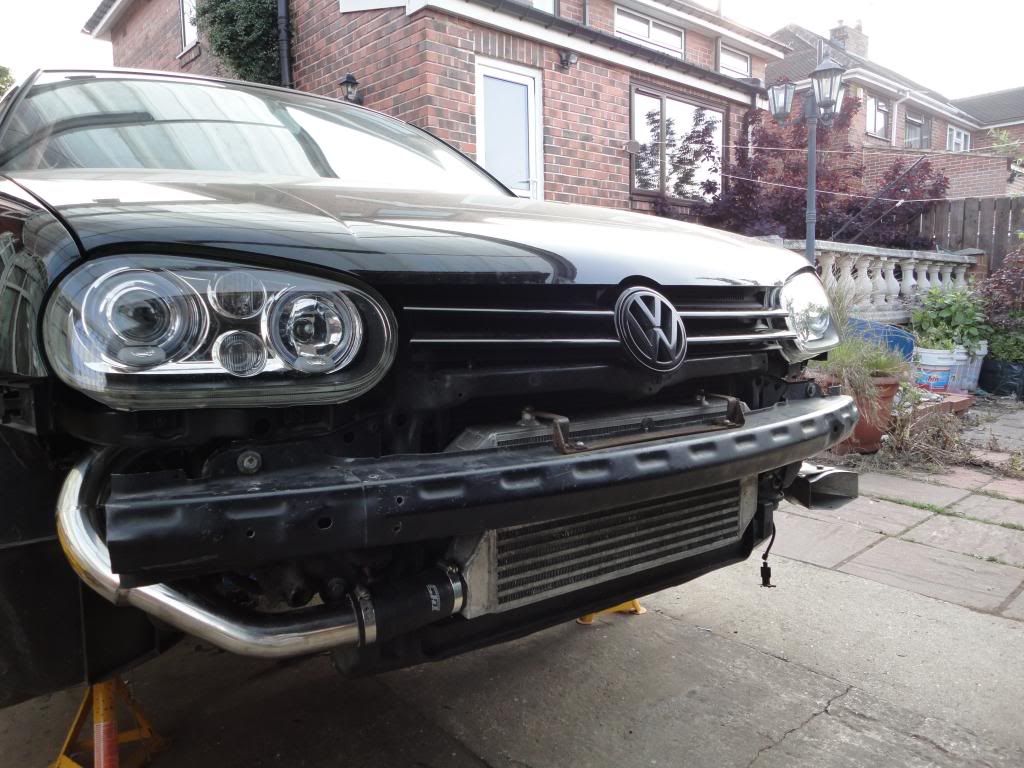

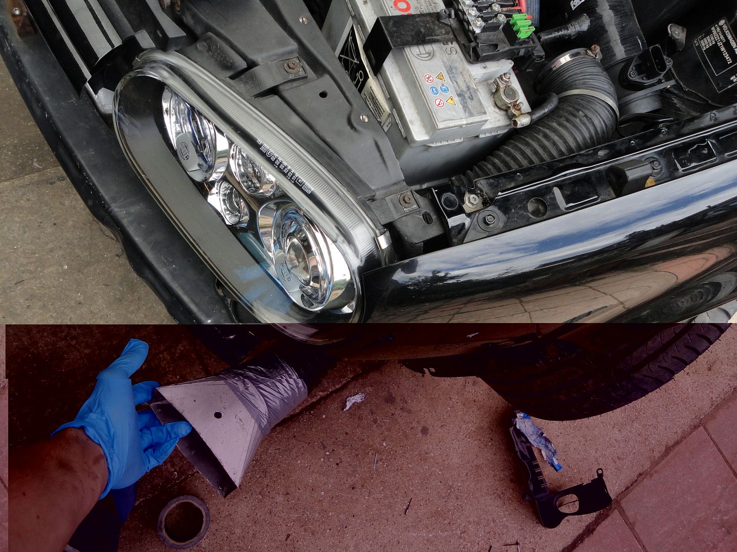

I then moved onto switchingover the intercoolers, switching the injectors and also painting the inner part of the drivers wing as it had a slight bit of rust
I then switched over the headlights....track car starting to look mean  :cool:
the ths intercooler will be getting swapped for a wellycooler setup when i do the engine switch once the spare engine is rebuilt

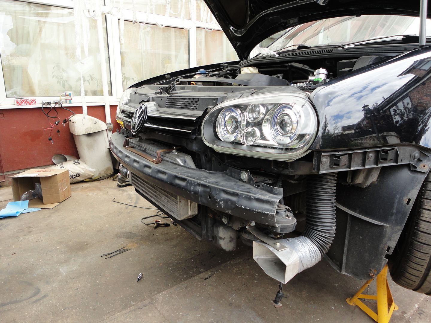

A cheeky pic of the cold air feed
And with a mounting bracket made up (made need the position adjusting when i put the bumper on)

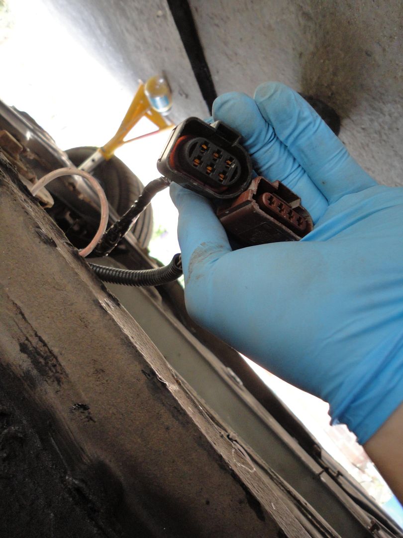

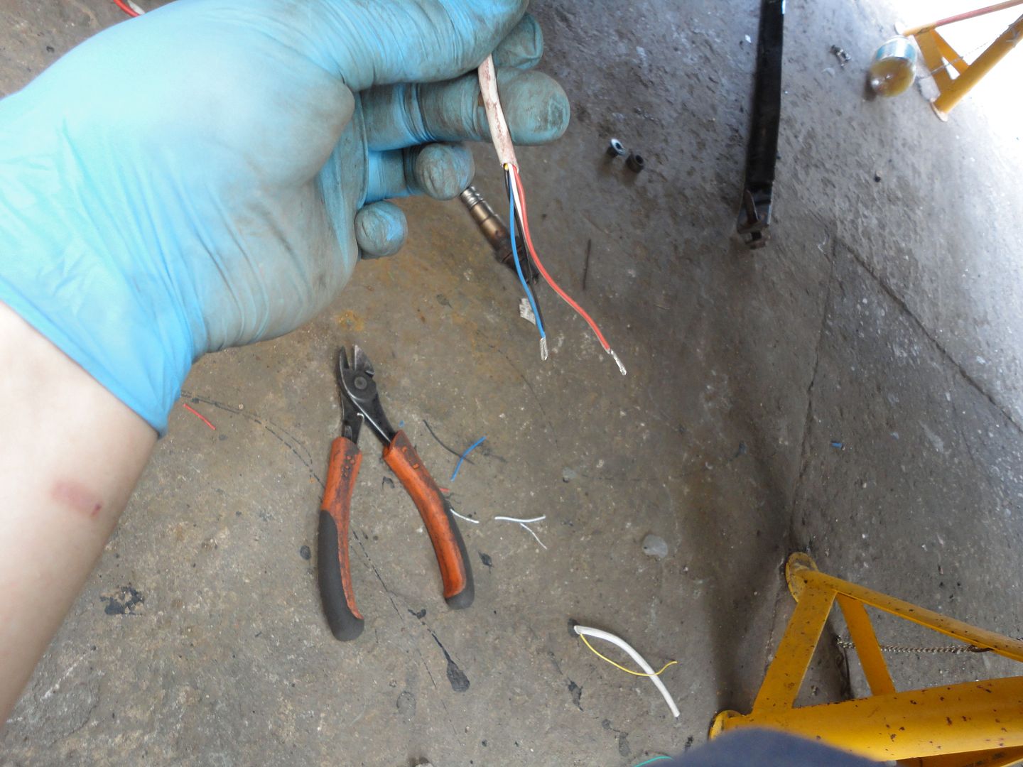

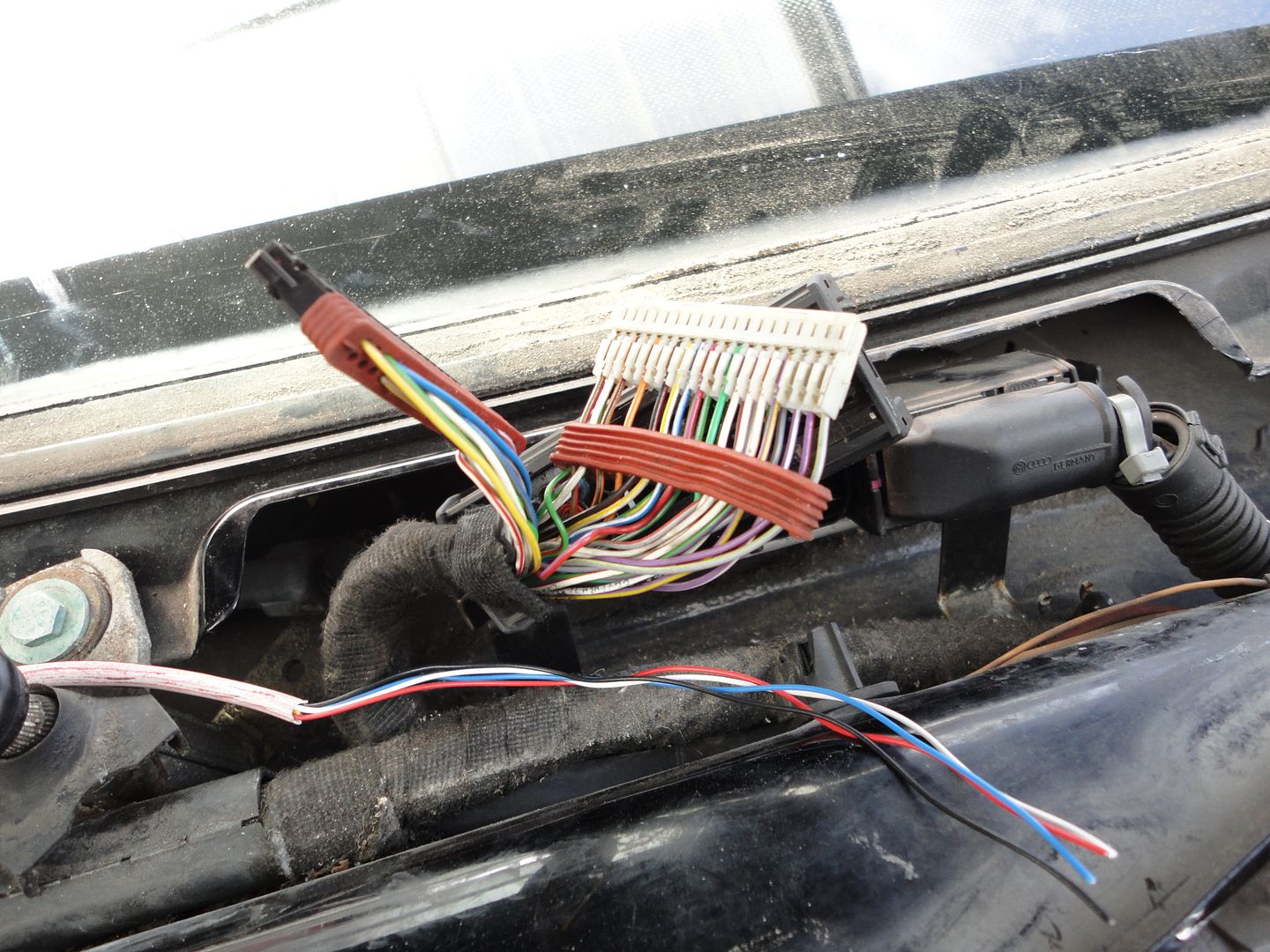

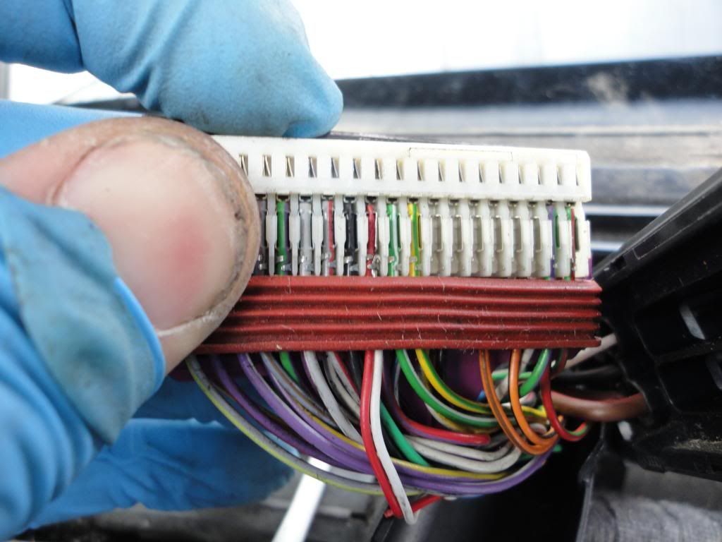

I then started looking at how i was going to convert the narrowband lambdas to wideband.
i found a guid but it had no pictures but managed to sort of sus it out  :grin:
Luckily i have the spare engine loom that came with the engine i bought so looked in the plug and found where the two extra wires goto in the plug and found the empty spaces on the arz plug so that may be tomorrows job

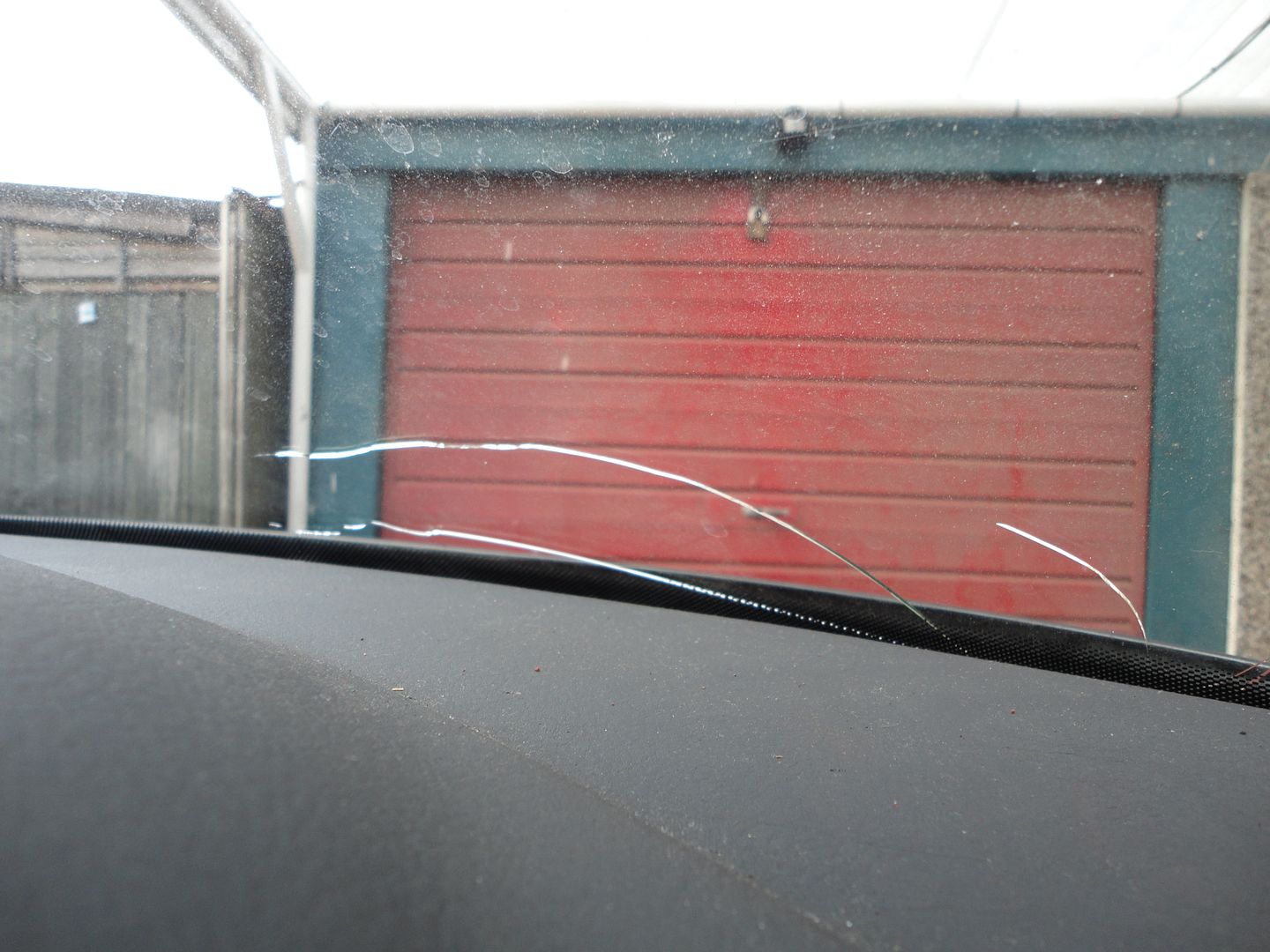

Also while trying to remove the wipers and scuttle panel to get to the ecu i managed to break the windscreen  :cry: :embarrassed:
An expense added to the list that i could do without but sh*t happens i guess
Also i order some new arch liners as i had melted mine  :whistle:
They arrived so i got them fitted rear wheels can now go on and that's the back end done  :cool:

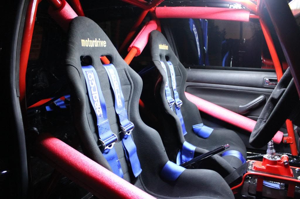

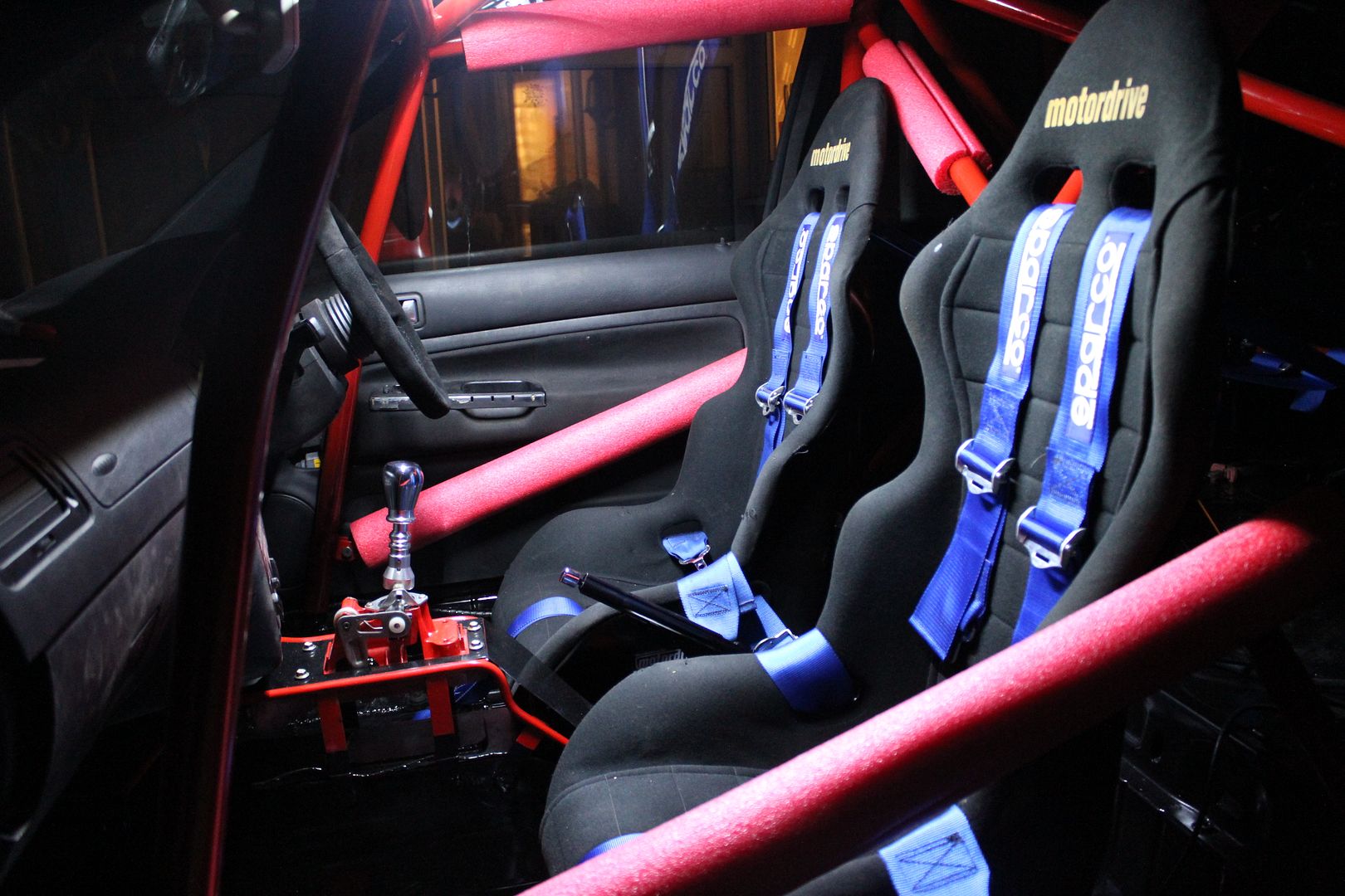

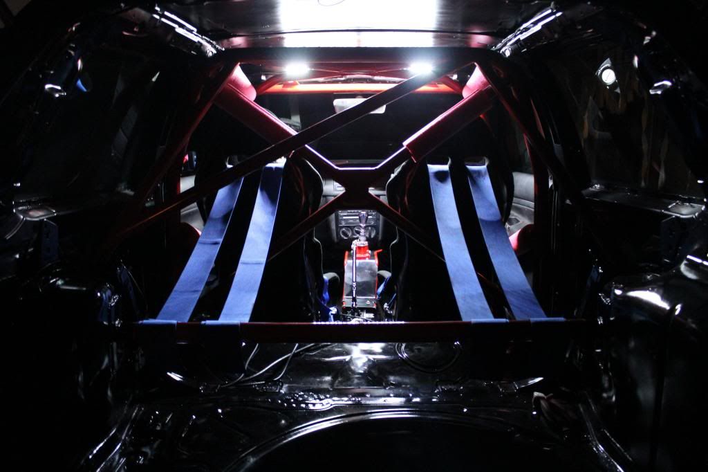

Couple of night shots with the interior led's :cool:
Offline Dave_IOW
  • Posts: 4,677
Looks the bollocks that mate :afro:

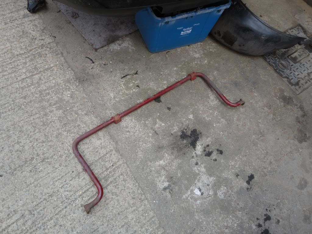

finished panting the wing on the current daily and finished putting it back together (bumper, driveshaft) and also removed the eibach RARB, we then towed it up the drive out of the way untill my ecus come back
The anti roll bar

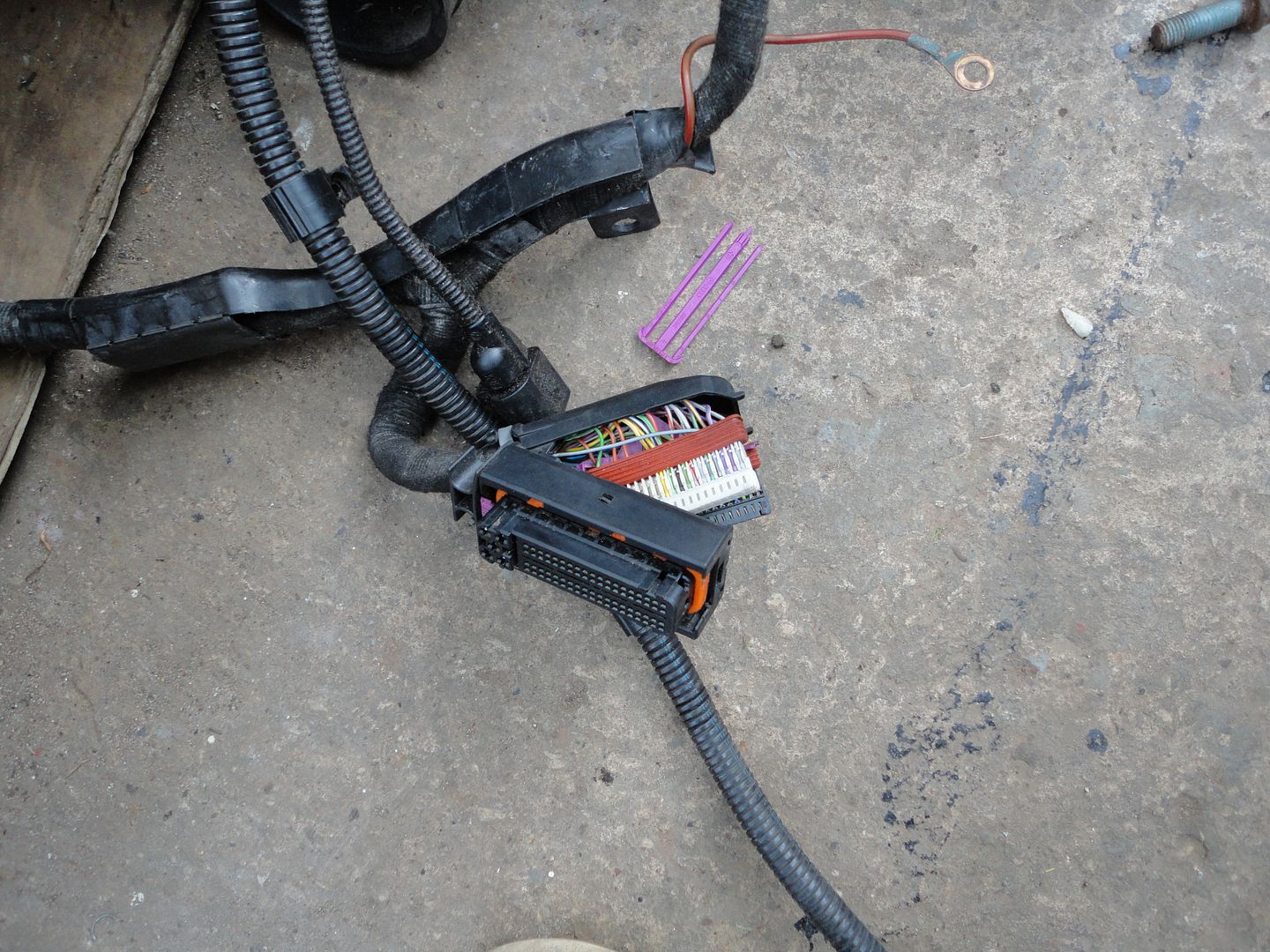

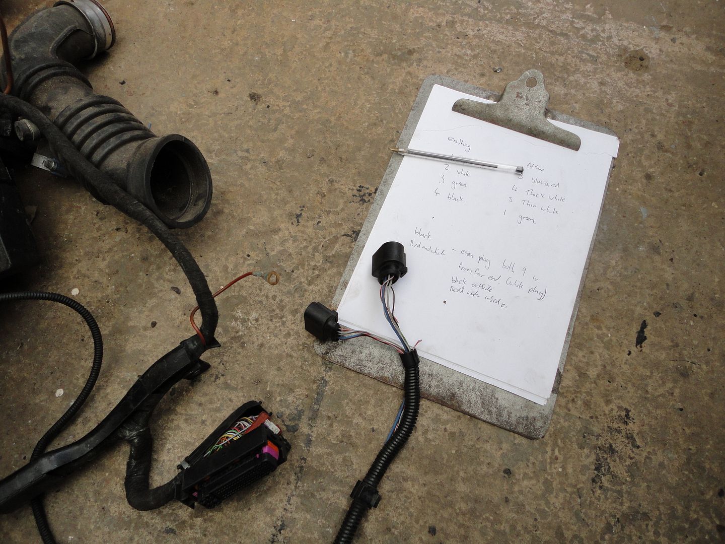

i decided to take a look at the adding the wiring for the wideband lambda.
its only temporary as after i have rebuilt the spare engine i am going to try cut down the spare engine loom i have to get rid of anything i dont need and then i will be swapping the whole loom.
but for now....
Trying to figure it all out
used some telephone cable to run the two extra wires to the ecu, not the perfect solution but as said it only temp
New plug all soldered on
Splitting the ecu plug
and after had installed the wires into the pins

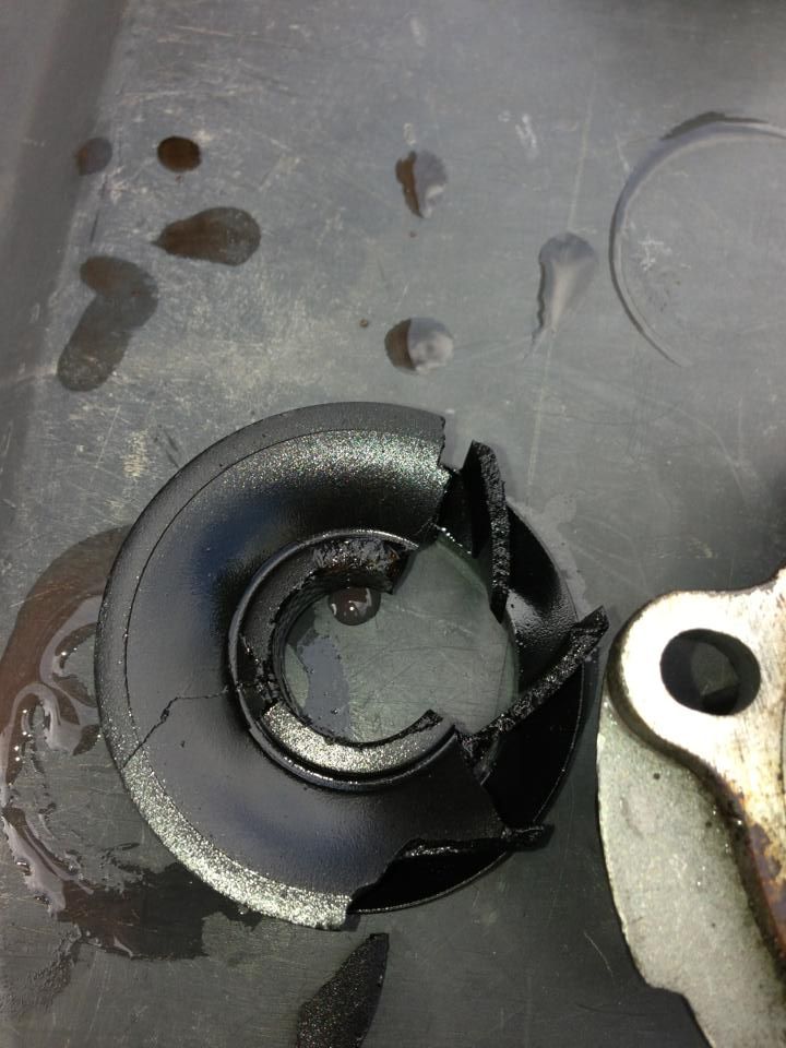

I then spent the rest of the day changing ryans cambelt and water pump as his water pump had decided to explode into
