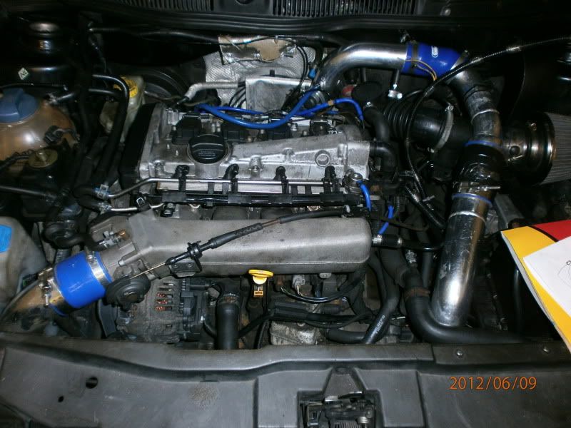

It will all be sorted very soon and yes I did lol. I think its got k04 why are youlot saying dif,just need to now were all the pipesshud b, refit a recirc valve unless no dv is ok and reinstate a n75 valves wich also red to no how it pipes. Up
I think members are saying it because out of concern they do not want for anyone to be conned.
The reason why they believe it is not a k04 is as follows:
1) You have a standard turbo intake pipe, which seems not least, strange given the expense and effort of going
2) It has a standard intake pipe - looks to be a k03 intake pipe which is different from a k04 intake pipe and the two are not exchangeable
3) An ebay front mount with a Forge on it would leave questions in my mind
4) You appear to be missing a recirculating diverter valve
5) Your wires to your n75 valve which is supposed to control your boost is cut
6) Just generally messy appearance of the plumbing and from what your suggesting something doesn't feel right
Although the plumbing for the n75 is the same on k04 and k03 variant engines, the placement of the n75 on the intake pipe is slightly different and needs to be said just to be clear so it's more simple for you to follow.

Can you not take some better pics of the engine bay? One from a little further away and a better pic of your pipework?

ok but cud do with putting it back on topic about gettin the car i just brought back to some sort of state.... the rest of the car is sound actually really nice. just these pipes are all messed. the ductape you may c is covering a slight rip..( ive ordered a new t piece for it) please help some one must be able to give a picture step by step of wat goes were... thanks all of you

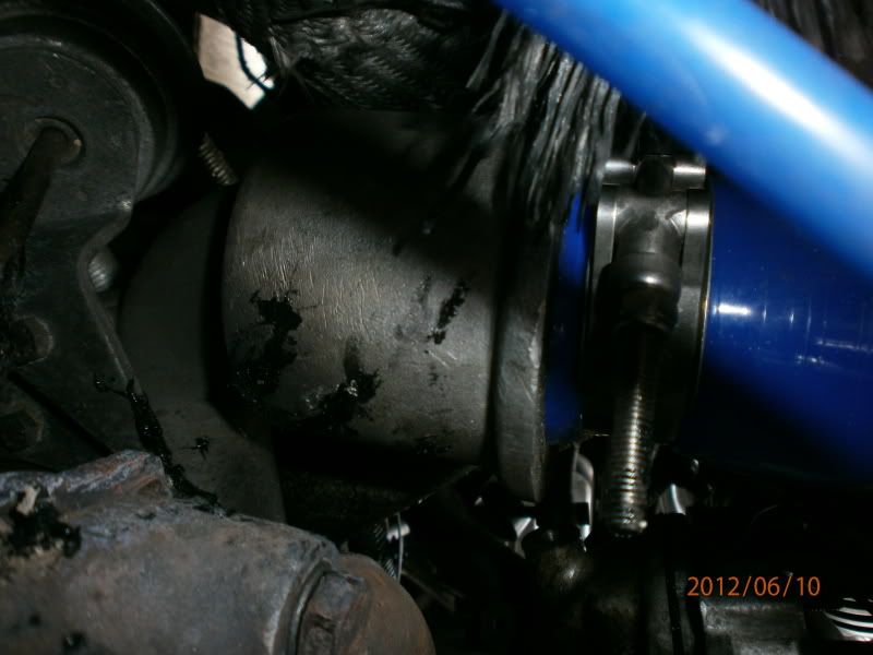

Can you take a picture down the back of the engine?
Offline rageraver
  • Posts: 60
Re: mk4 golf 1.8 k04 forged engine
« Reply #36 on: 10 June 2012, 18:03 »
air intake joins turbo
intercooler joins turbo
can we find out how all the pipes go now.. pleaseeee lol

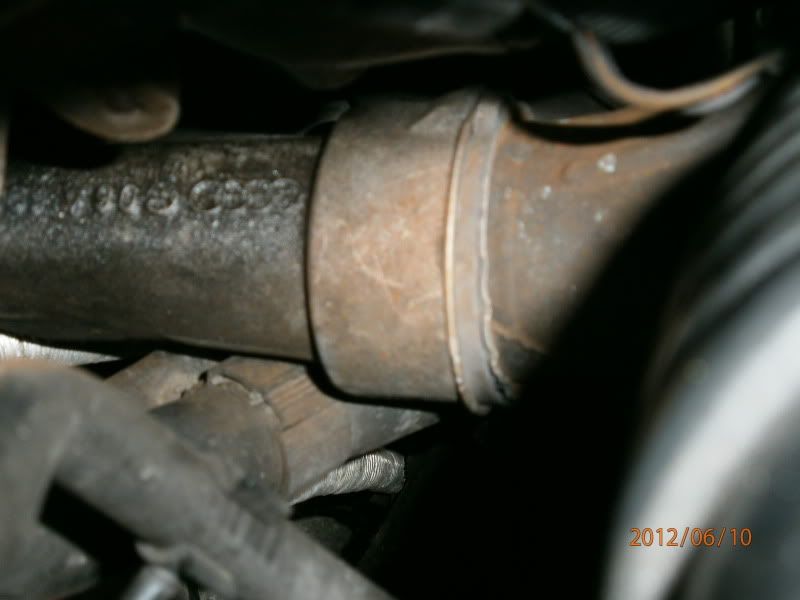

Is the start of the part number on the Turbo 06A?
Offline rageraver
  • Posts: 60
« Reply #38 on: 10 June 2012, 18:14 »
on th intake pipe i think so lookin at the epic

is that a  ko3s?  :huh:
that looks very shoddy! is there black gaffa tape round the intercooler pipework on the right?
