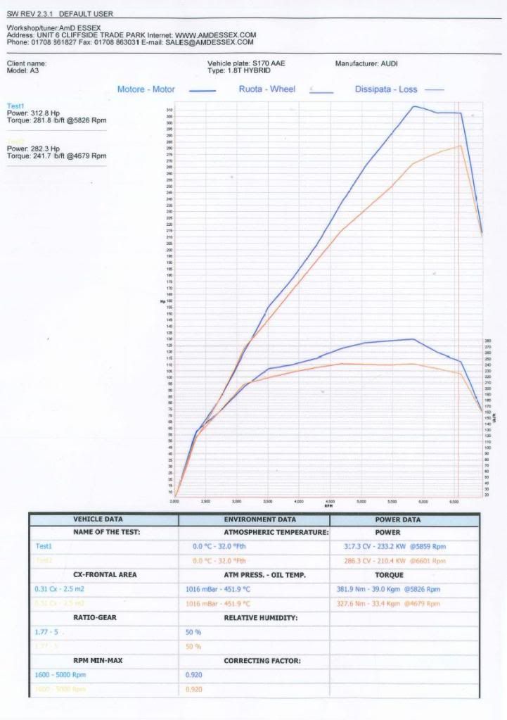

Nick, just because you post up facts and figures on the net you assume that your the only one who knows about engines? I'm not a person who will just blow smoke up someone's arse because you spout about AFR'S and advance.  :wink: Don't assume I know nothing, my goings on aren't on full display on the web. And by outside efficiency islands, I mean off the chart.
Yes you make a good arguement but.. It's your dyno. Do a proper comparison with an independent (not one of your mates) on something like a DD and we will see.
I like to see proper validation. Maybe comparing to standard cars with known factory outputs that will prove how accurate figures are.
It may look like I try to knock you back but I'm not naive and don't get sucked in by big numbers. Plus these are just a WOT plot. It says nothing about driveability.
This may flow enough for high outputs but for how many reliable miles? How many customers have had to have a turbo change a year or 2 down the line? We will never know.  :wink:

FFS........ the turbo is running less stress than a stage 2 map...  You clearly dont understand whats going on with the air flow here.   There is a point on the stock ko4 manifold where added boost makes no more power, just heat and egts.
Get a stage1 AUM and add a full turbo back exhaust on its own merits you will see 10-12bhp with out adding any more boost.
As for mates dyno the runs above where not mates dynos, B5 and AMD,   Even on JKMs DD rolling road my numbers are the same.
Can you explain what your issues are here you dont like to see some one doing well? You spending too much time on clubgti which is bias and I cannot/no other tuner cannot post in.
At the end of the day I DONT need to prove myself because over time on RR days ect the numbers will come to light.
At the end of the day on saturday Tobys feedback and grin will say it all...
