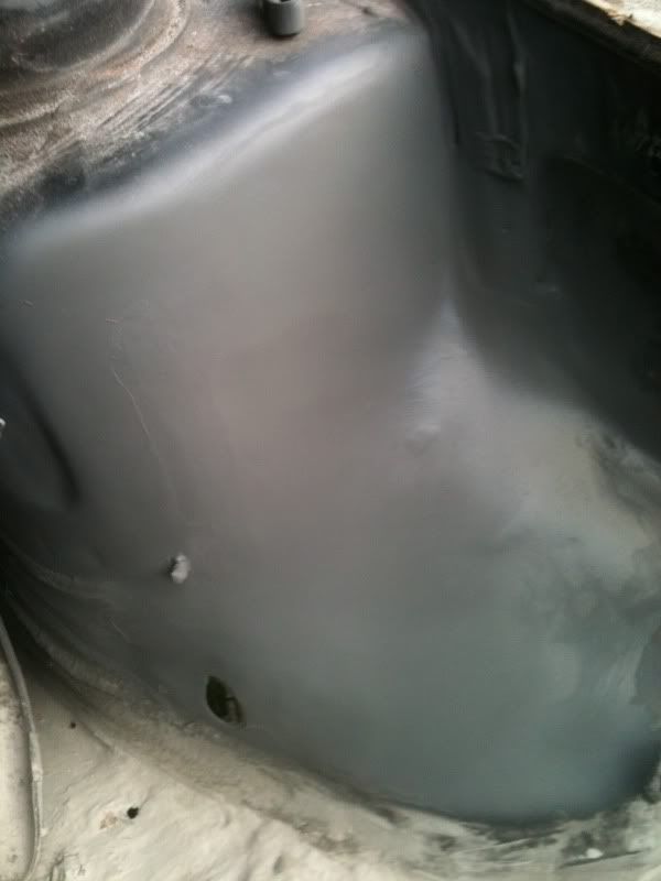

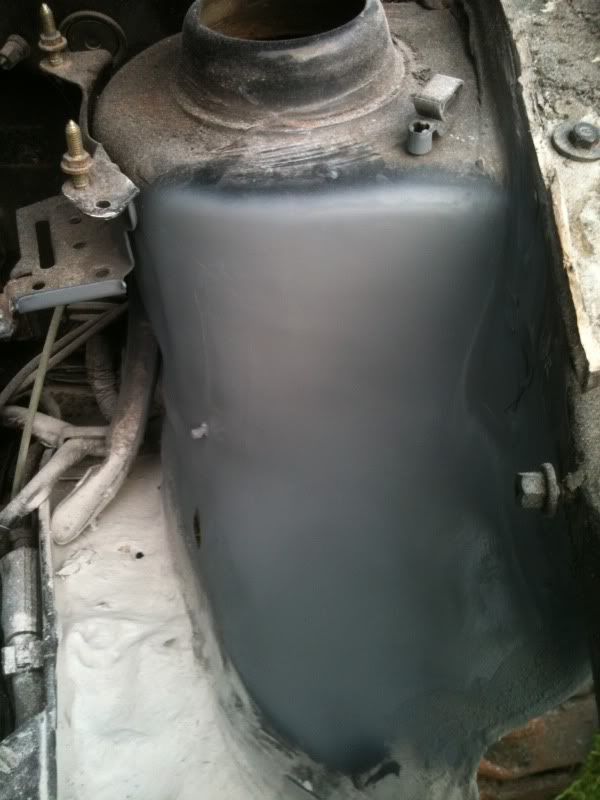

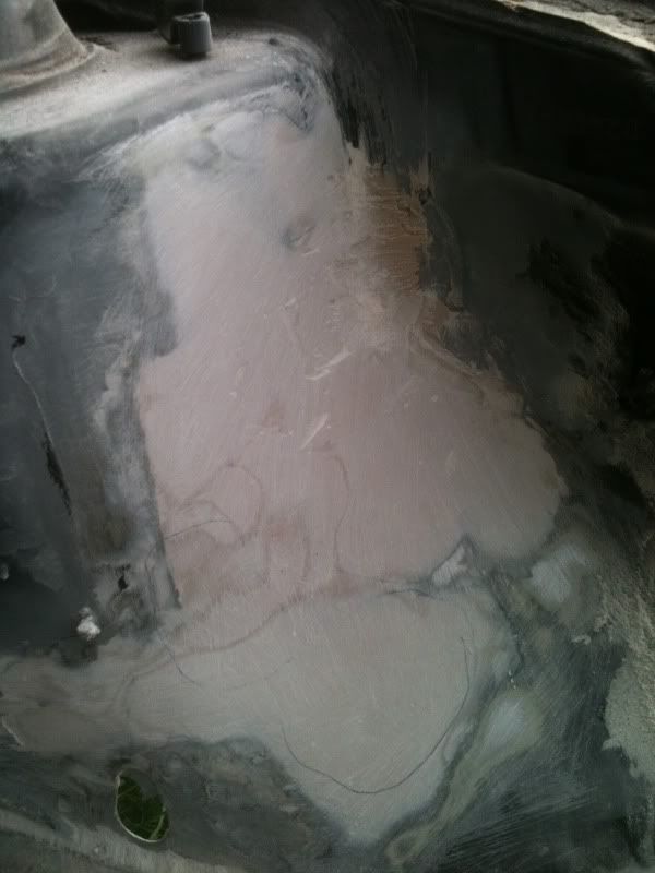

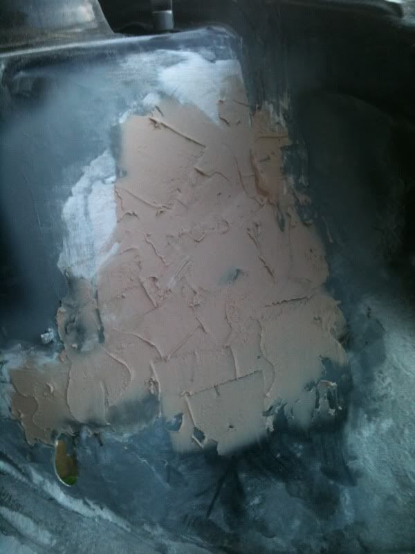

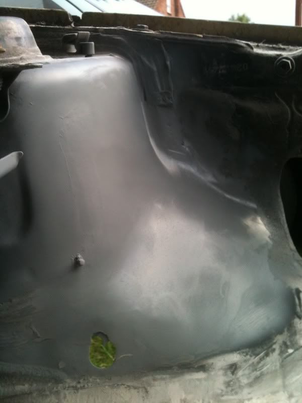

Ok so i have been busy with filler and sand paper the last two nights after work its not done yet but here are a few shots for you guys  :smiley:
Filler layed on in layers rather than one big blob really hard to layer it on smooth though
whilst rubbing the filler down
And not done but primed as im not sure when im going to have chance to work on it again
As iv said its not done but primer aslo helps to see where any dents dips and so on are, i will update again soon, really am looking into doing smoothed legs and towers after seeing how this looks i may have the other side to do soon  :grin:

Looking good! Little tip on the filler, try and get it as smooth as you can before it sets, then it will be a LOT easier to sand back
