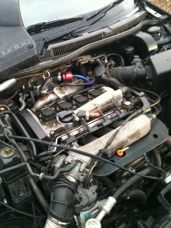

On saturday i went to see this...............

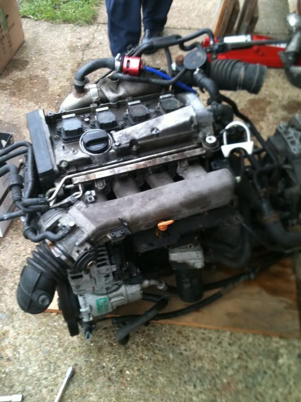

Saturday evening i then got a phone call from the guy saying him and his dad had removed the engine comeplete, ecu and loom would i wanna collect that night so last night i went and collected it in the back of my mums car, well this morning soon came and it was time for me and my dad to remove from the boot WITH NO ENGINE HAUST! my god it was heavy! aha
Out of the car
removed the gearbox, clutch, flywheel, alternator, starter motor well most of the bolt on bits to make it lighter, didnt get any photos of it after but will take some tomorrow.

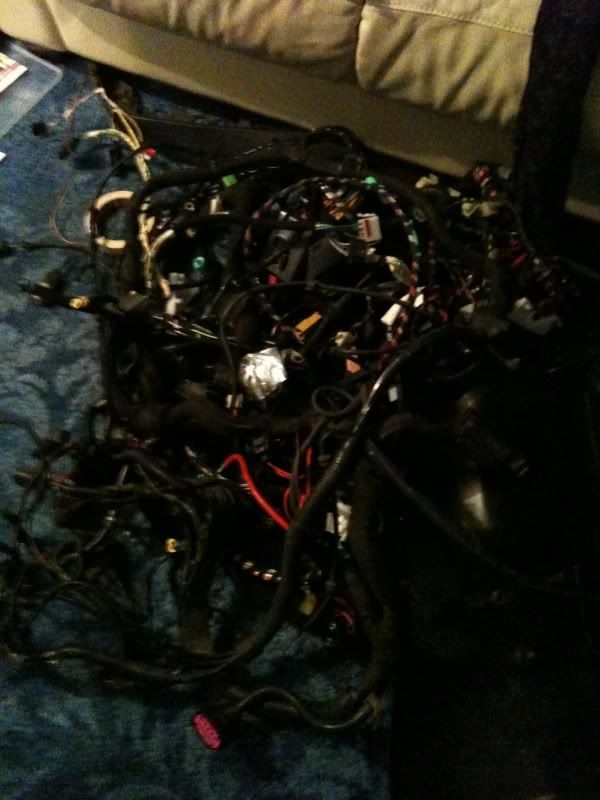

So also in with the engine i have this lot to play with................
Sorry about the bad photos all taken on my phone aha
also got the key and ecu also in this photo are some gauges i got hold of cheap

But i do have a couple of questions i know i need the gti gearbox, clutch, flywheel, starter motor, but does it have to be the 16v or can it be the 8v????
Also i know at the top of this photo is the alternator now what are the two below it does anyone know? i think its either oil pump, power steering pump or water pump? anyone know photo here.......

The 2 units under the alternator are a/c compresser and pas pump.
You would be wise to scrap the dump valve btw they do not like them.
Good luck with it. :smiley:

chances are if you are asking what those items below the alternator are your gonna struggle with this LOL
Remove that AC compressor and bin it, you will need a Aux belt thats for a car without AC, i have the part number in my files of the belt u will need

Right so the a/c compressor is no longer required but the bottom pump (pas pump) is required, if you do have the part number for that belt that would be great, if it cant be found could i not just leave the pump in place unconnected?  :smiley:
well the dump valve was chucked in, im not a massive fan of them anyway, what would be a better option to put in its place?

id remove it if its not needed mate....less weight etc  :wink:
u want the 007p diverter valve from awesome gti altho theres the 008 out i think now
Does yours have PAS if so then yes you should be able to adapt it to work with your rack, starting with a 1.4 does not make things easy as so much needs changing.
Forge 007p is the best choice.

As said above stick with a recirc valve over a dump valve :wink:

The PAS pump will work with the MK3 set up
i Used the S3 pump on my conversion
Get a 16v abf golf mate, will make your conversion much easier and less stuff to source
