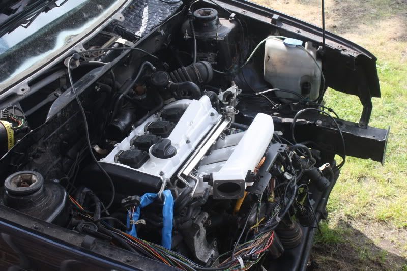

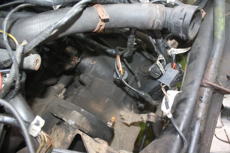

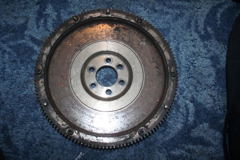

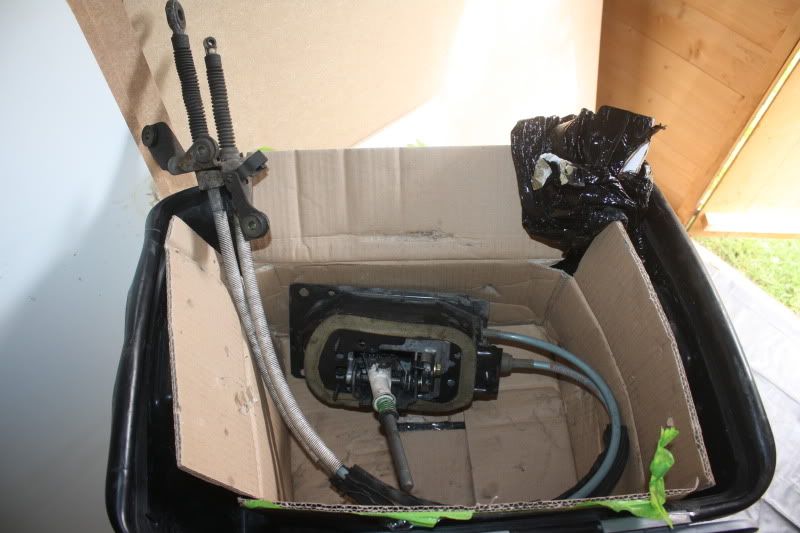

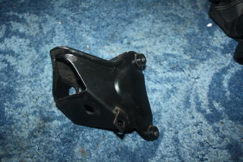

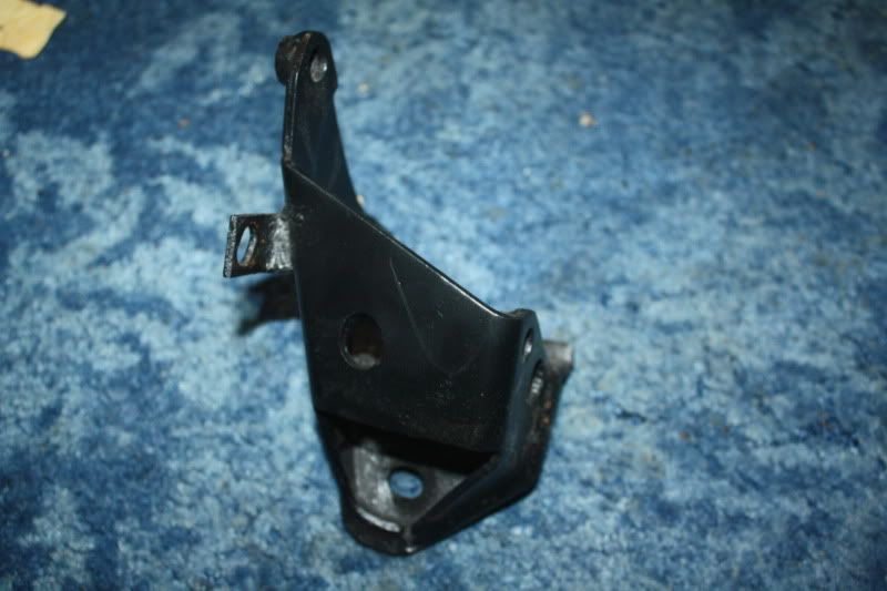

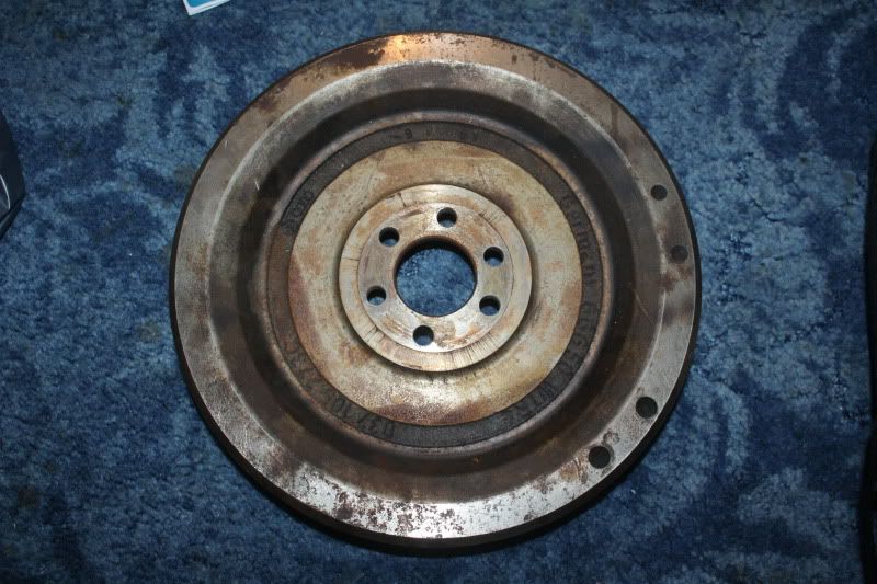

First some bits and bobs i have got hold of  :smiley:
g60 8v flywheel
MK3 cable change unit
Sprayed a front engine mount
Mk3 TDI 1.9 70k Gearbox
Not got very good pictures but you get the idea  :wink:

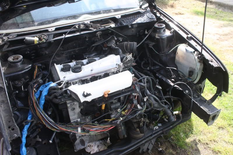

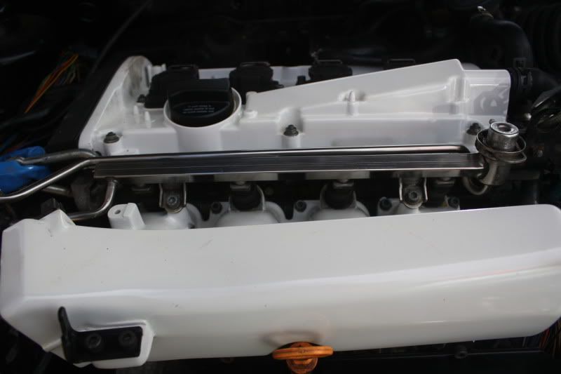

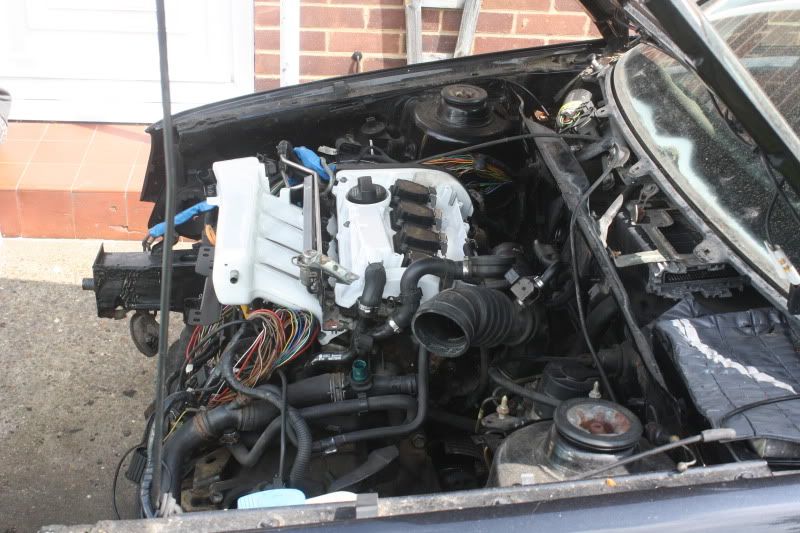

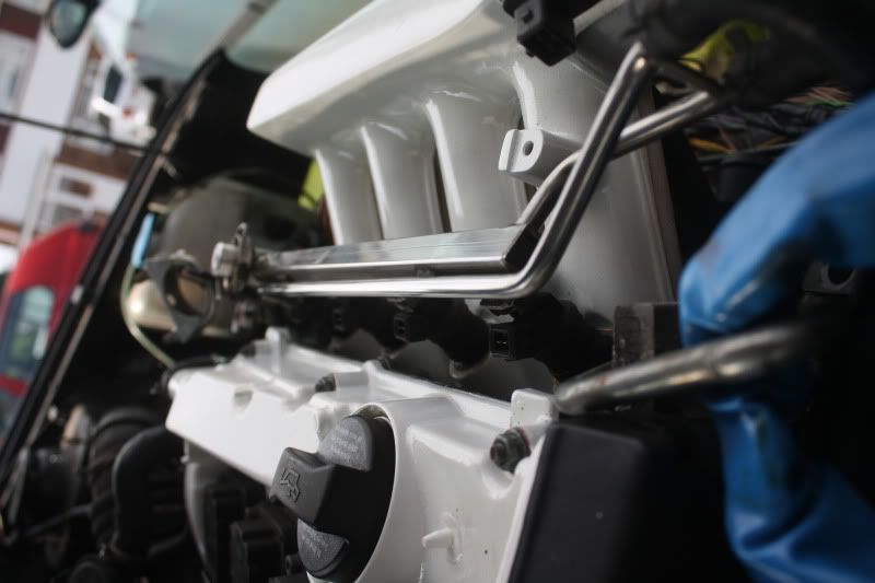

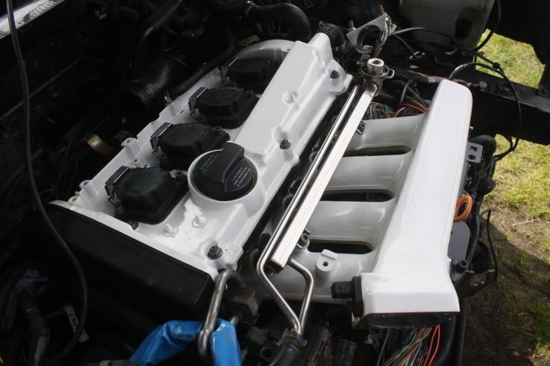

And as for progress i cant really remember where i got up to but this progress has made it more worth while here are a few shots for you all  :smiley:
Hope you enjoy guys hopefully more updates will be coming quicker let me know what you think  :smiley:

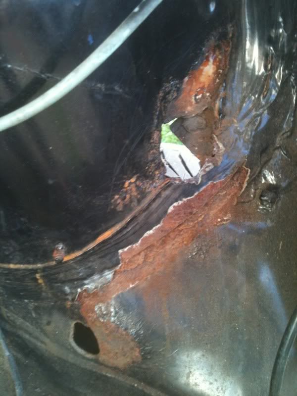

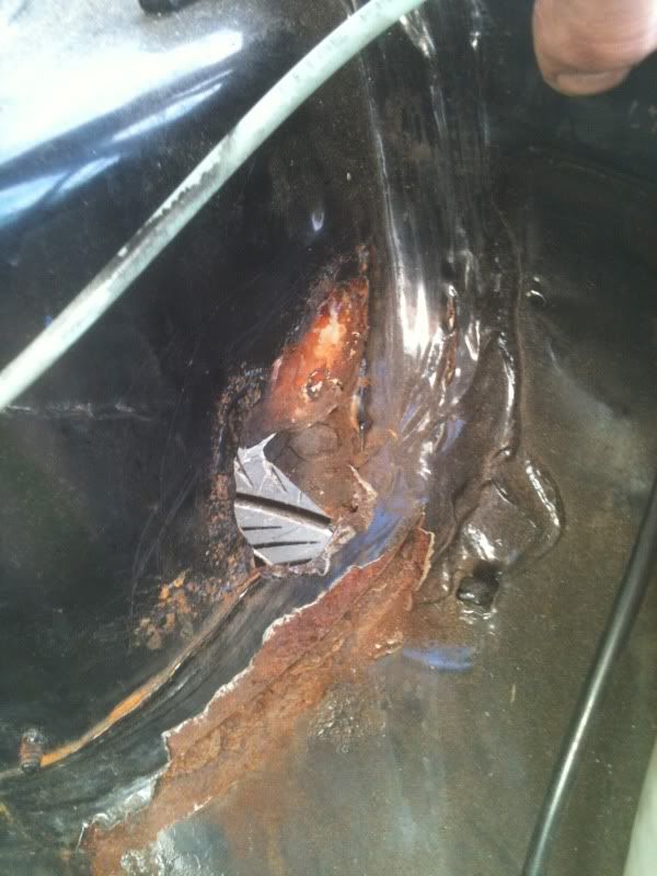

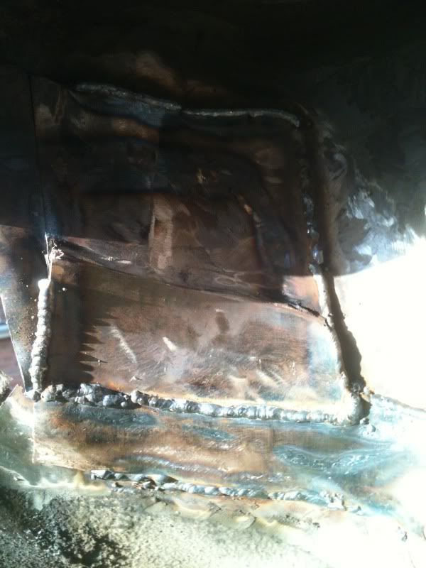

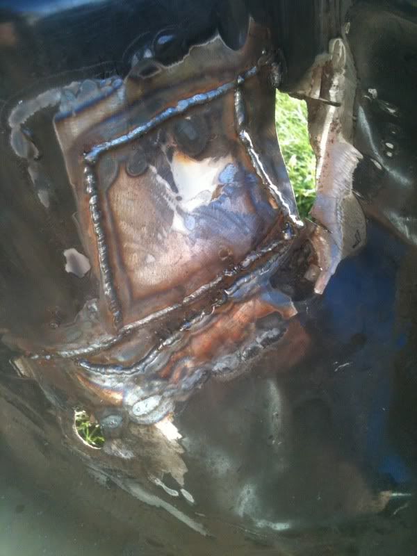

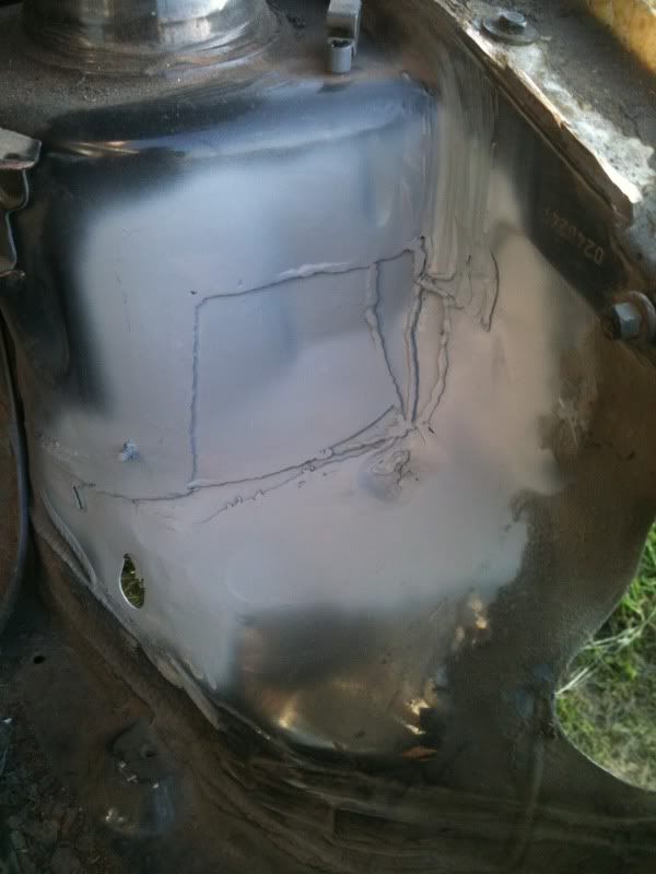

So now i had got some parts together i thought it was time to tidy up the bay, first problem i came across was a rusty hole so heres a few pics of the hole and how it looks now  :smiley:

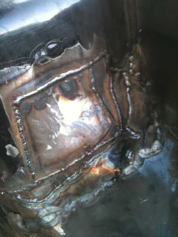

Started to weld the patches in, had to do 4 in the end due to the diffrent bends in the metal
Front
Back

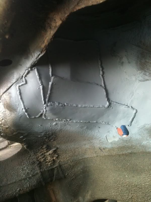

All filled in and primed  :smiley:
I have now got some filler on there but the rubbish weather has put me back i shall update soon  :smiley:

« Reply #153 on: 23 June 2012, 09:11 »
Looking good,
josh
Re: MK3 1.8T
« Reply #154 on: 23 June 2012, 09:13 »
Nice work with the plating, it sure was rusty :shocked:
Offline Ferdinor
  • Posts: 223
Re: MK3 1.8T
« Reply #155 on: 25 June 2012, 00:46 »
cheers guys we think that a battery may have gone on it at some point causing it to rust as bad as that because the rest of the car seems solid, i will post again tomorrow evening with more progress hopefully.
