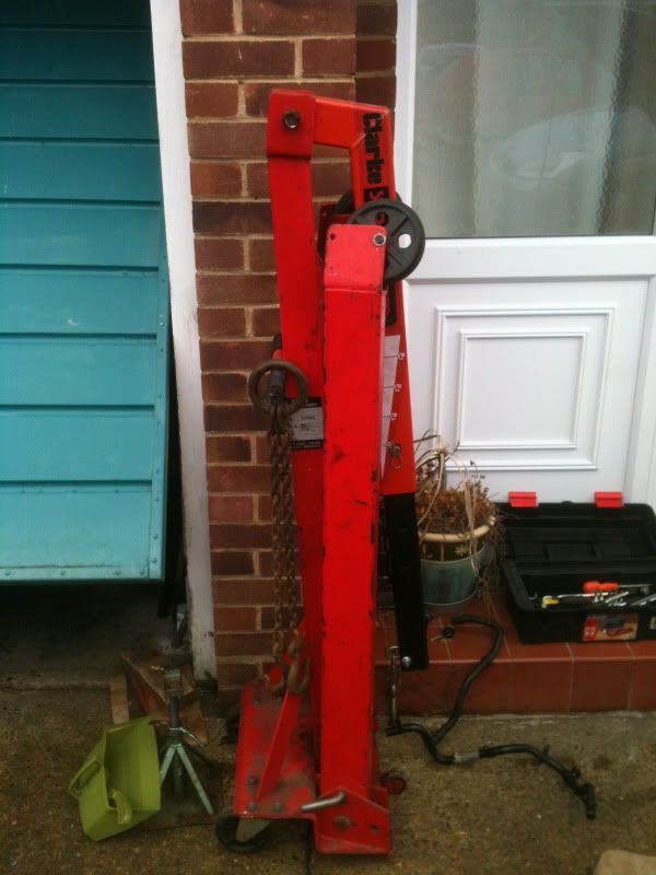

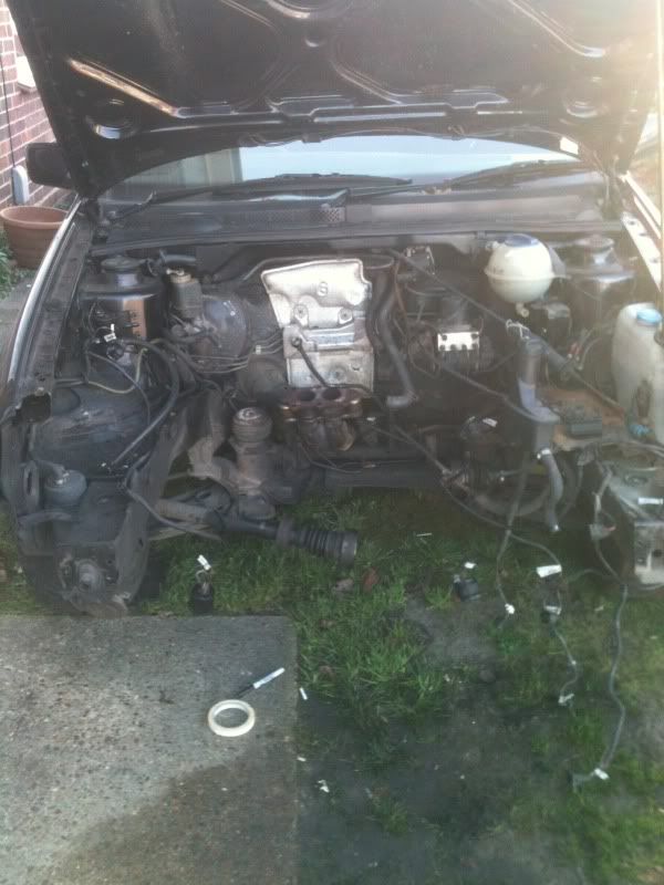

Well i had today of so i made a start on removing the wiring, didnt get to much done as it was so cold out but here are a few photos  :smiley:
Engine lift i have the use of whenever i need it  :smiley:
The engine out
I cant seem to upload the photos of how the bay looks now but when it lets me i shall update again  :smiley:

Yeah that engine crane helped so very much!  :smiley:
