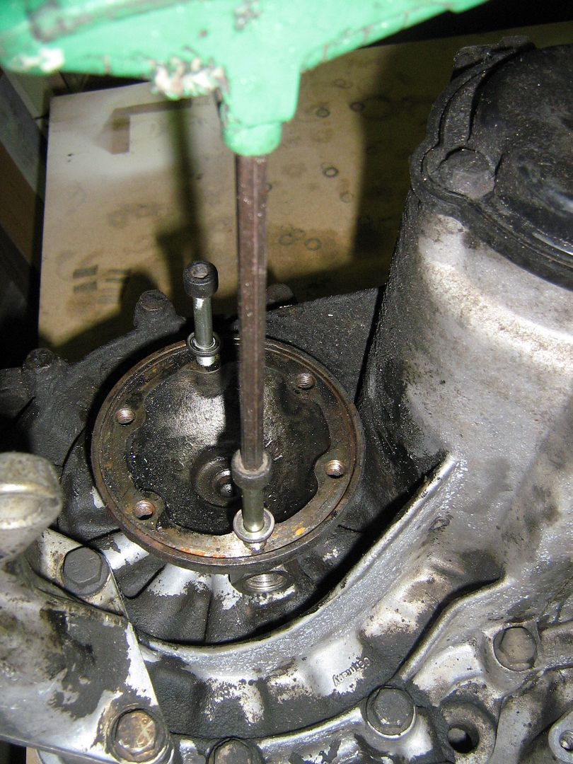

You dont need a gearbox. You only need the 100mm drive cups from an 02a
dont you mean 100mm drive cups for 02J?
And iv heard there not cheap and not very common?  :undecided:
Late 02a will bolt in too.

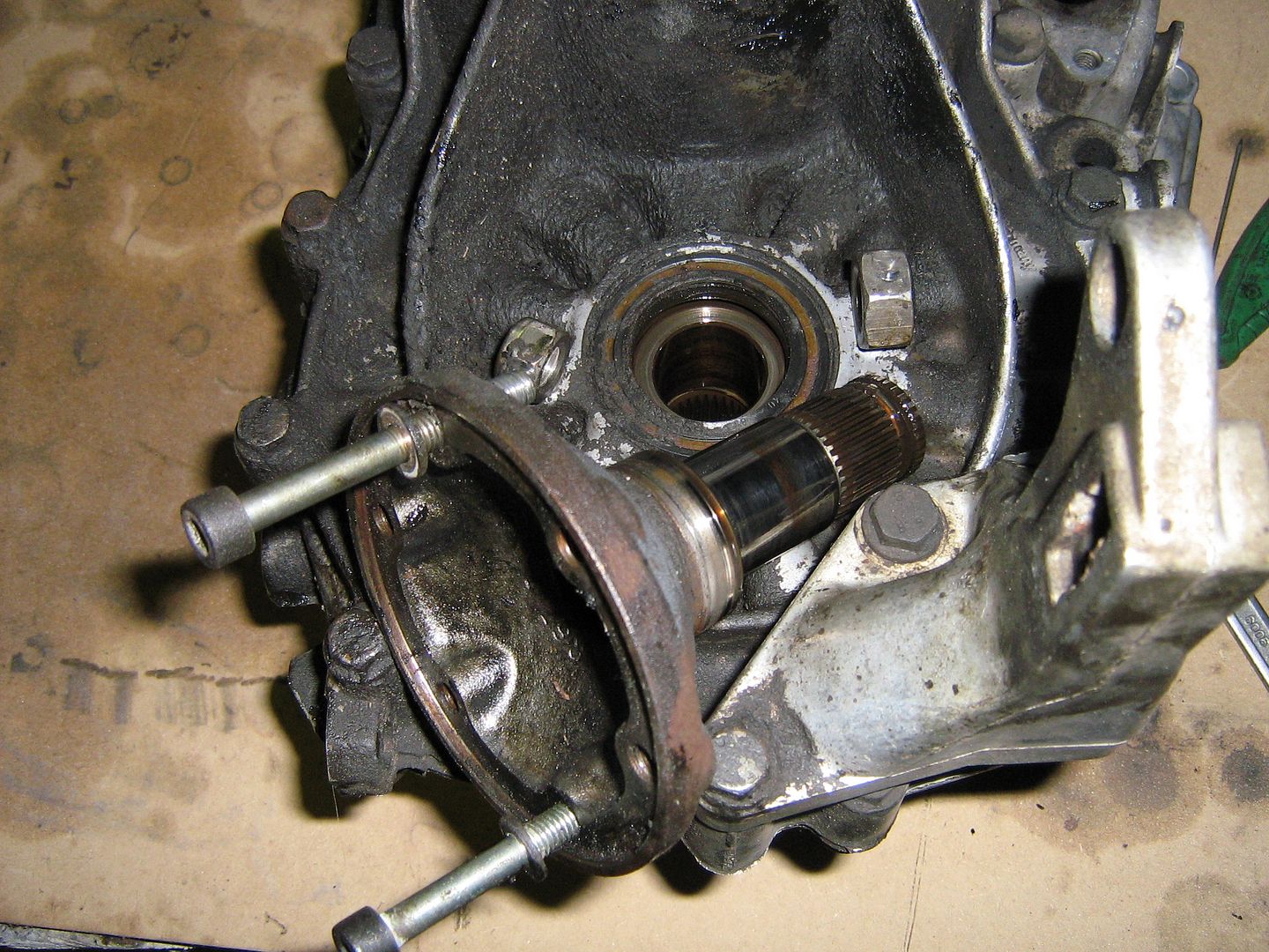

Late 4 cylinder cars (95-97) have bolt in drive cups like the 02j. They have a 6mm allen key in the centre under all the grease.
Taken from CGTI 02A stripdown This looks like an early box though.
Quote
Next, the drives have to come out, two M8 bolts threaded in against some nuts or spacers and out they pop,
Mk3 ABF 16VT Megasquirt V3

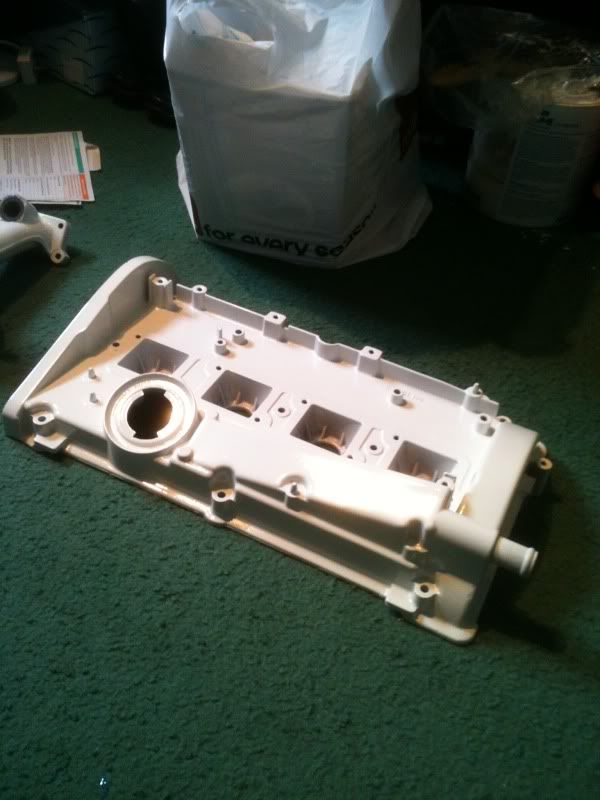

Ok been a while since i have updated this infact been a while since i have done anything, but here are some photos of the engine parts sprayed and finished, i shall be bolting them back on tomorrow  :smiley:
Manifold
Rocker Cover
Pretty happy with how they turned out  :smiley: Im hoping to get these back on tomorrow because i really want to know how they look on  :cool:

Nice man, white looks nice. Makes me want to take mine all off and spray them again lol.

Yeah i really like the colour and i think the black brackets and chrome piping should go well together just going to be a pain to clean  :grin:
Yeah do it man clean bays are always good  :wink:
