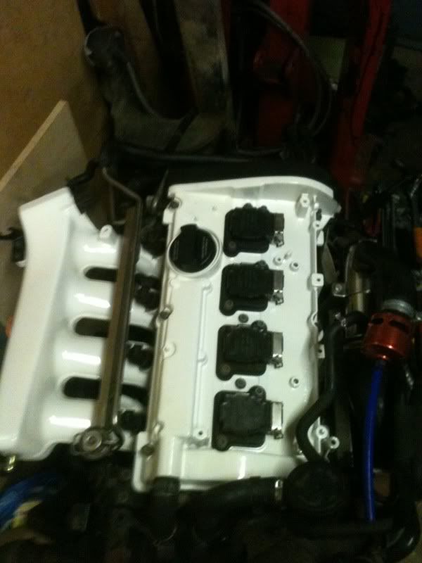

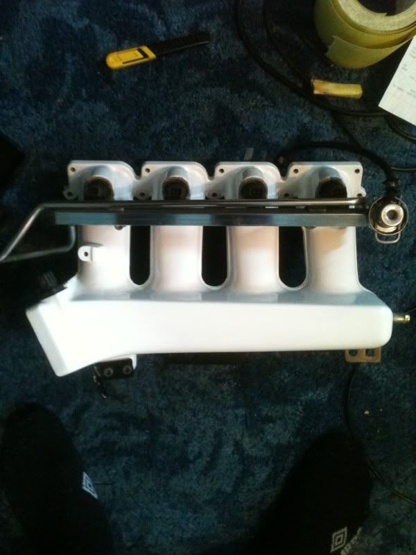

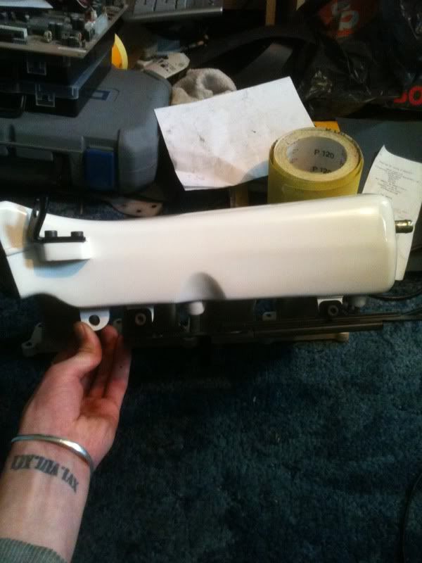

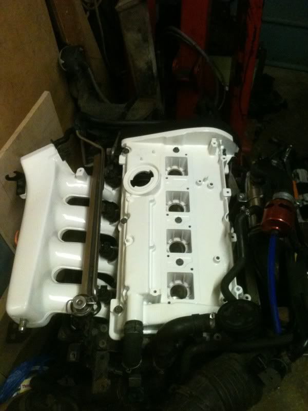

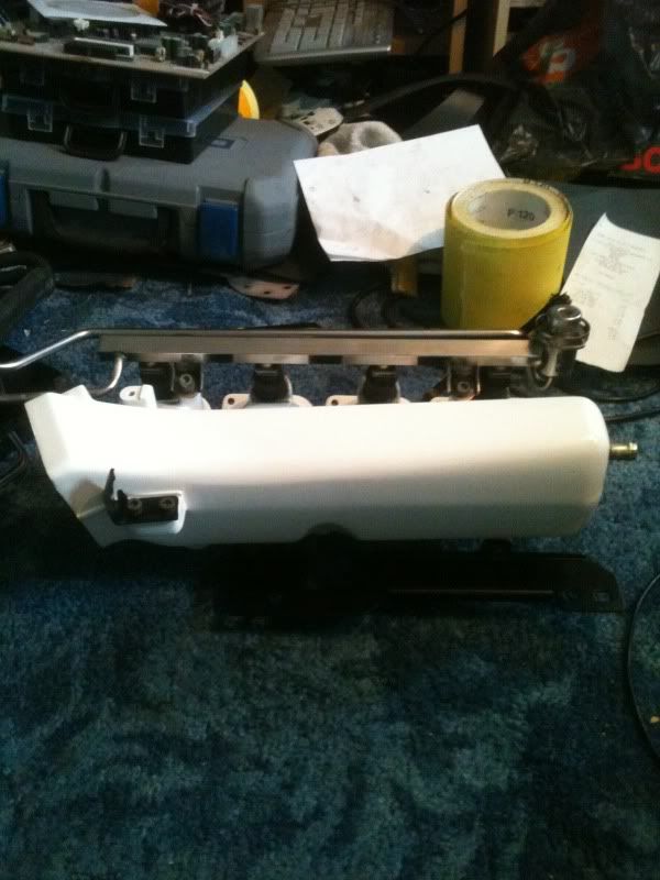

Well after finishing the manifold and rocker cover i decided to spray and brackets black so i did this and just placed them together to see how it would look, so here goes  :smiley:
Pretty happy with how it came out and i think polished chrome, black and white should mean a nice finished engine bay, just cant decide to spray the main bay white or black?  :smiley:

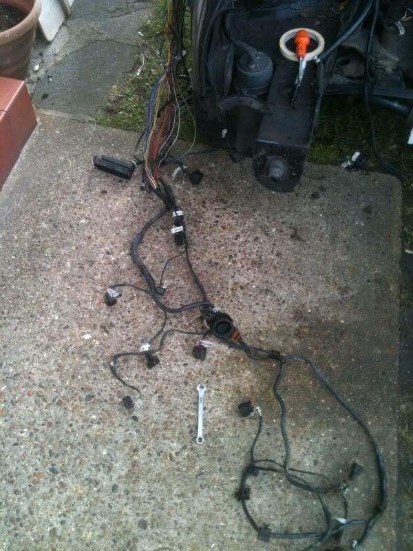

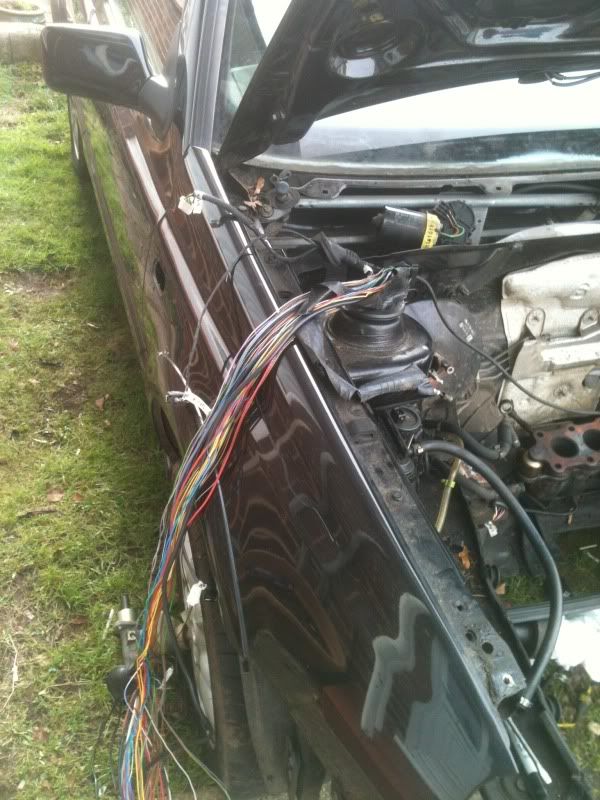

right well i have got the wiring to this point

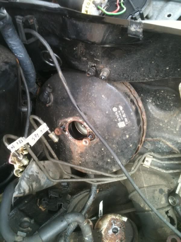

But im stuck as to how to get this round thing of, not sure on its real name? so any suggestions on what its called and how to get it of would be good????
Until i have got that of i cant get any more of the wiring out, and i cant seem to get the dash out either  :angry:

four 13 mills behind it near the pedals and fusebox. good work so far btw. white will look clean

Brake master cylinder. Ballache to get off apparently, cant say I've ever taken one off though. Not sure about white or black for the bay colour though. May be a bit too much with the detailing of engine.  :undecided:

Ahh brilliant cheers mate, i really need to get it of to get the rest of the wiring out  :smiley:
cheers i really hope it will look as good as it does out of the bay  :cool:
Ahhh well it needs to come of so i will give it a go  :tongue:

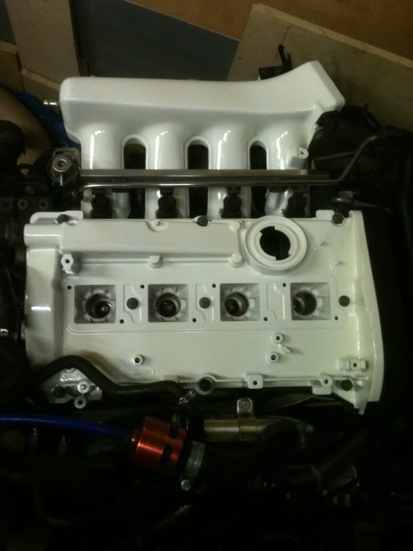

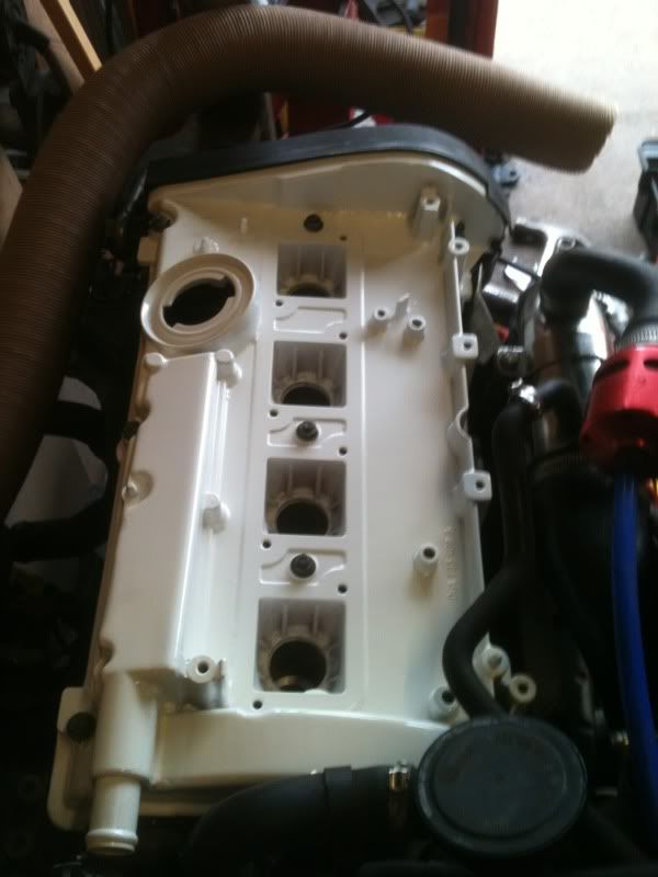

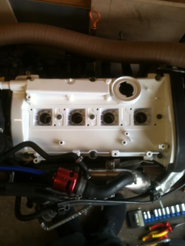

little update, got the engine parts pack on just now so heres a few photos for you :)
this is what it looked like before
And as everything went back on :)
Thats how it looks now, pretty pleased with how its come out :) I know its going to be a massive pain in the arse to clean though <_< aha

that round thing is the vacuum servo, the master cylinder bolts onto it

Regards the brake servo -
Stick your head in the footwell and directly behind the brake pedal there are 4, 13mm nuts, remove these nuts. The servo piston is held in the back of the brake pedal by a ball joint clip, pain in the arse to remove but once done, the servo will then pull out of the bay.
regards the dash -
There are 2 (possibly 3  :undecided: :huh:) 10mm nuts through the bulk head, under the scuttle/rain tray, there are 3 (possibly 4  :undecided: :huh:) bolts, along the underside of the dash, under the steering wheel,  there are 2/3 bolts behind the glovebox/passenger airbag and there are 2 (possibly 4  :undecided: :huh:) bolts behind the centre console cubby hole
Hope this helps  :cool:

Thank you mate  :smiley:
Ahhh i see i will have a go at this on my next day of, could do with getting rid of it to remove the rest of the loom aha  :laugh:
Yeah i found a step by step guide online but i still cant seem to do it? aha i will have another crack at it wednesday as i could really do with it of  :smiley:
