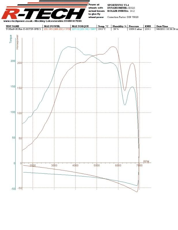

something not right about them graphs, why is the info chopped off on the far right????
dont agree with the figures either, seems all wrong to me
It seems you looking at it on an iPhone as I can only see half the graph, Scrub that I can only see half with my PC aswell.
this graph is not my graph it's an independant tuner who can actually write an me7.5 maps and fully understands the ecu.
The spec1 result is the exact same as I got on my dyno, which read the same as the jkm dd, (as Adam knows).
Can you explain to everyone why you don't agree?
If you click on the source of the graph you will find all the logs that go with the run, boost, lambda and air flow, then using mathematics ( not maf /.8) but air in lbs you will see they are correct.

The full graph link
http://www.seatcupra.net/forums/showthread.php?t=289160
I ran a Bora with an AMK S3 engine yesterday, we started to custom map it but soon ran in to hardware issues, The car is also running the exact same map with the badger5 tip.  I will post the graph up in 2 mins

From a AMK in a Bora with the Badger5 tip and same mapping as Dane's S3.  Not got a full run yet as the car is in for a full custom remap and after 5 mins hardware issues started to crop up which caused the throttle cut at the end of the run.

the AMK in bora, is that standard engine on oem management but with just a TIP and your custom map ?
did you run temp probe in the air intake when on the rollers ?
im a bit funny about all rolling road results now as they are too easy to fix, (im not saying you have or do this btw :smiley:).. i like to see a 3rd party temp gauge showing date,time, humidity and temp etc that matches up with any dyno results, date, time, humidity etc... :smiley:

I dont need to fudge numbers on a dyno... JKM rolling road days and other forum rr events have backed it up for me over the years, BS dyno numbers will always come back and bite the tuner in the backside.
The torque is low as its only a spec1 map peaking to 16psi, its not had no custom map tweaks yet as the PCV is causing issuse.
Who custom mapped your car and and are they me7.5 specialists?
What TIP are you running? Forge? as the only tips I have seen to flow well are the 3" ones?
What are your blocks 60 & 115 & 114 vs N75dc% reading (a good sign how will the actuator is running)  What condition did your tuner say the actuator was is going from the load logs? Is the peak load request being match and is the n75% running 78-88% top end or is it 95%?
What is your MAF reading vs and the fuel dump over 4000rpm?  (As this can easy kill the power by getting the lambda wrong, ie running stock protection maps on a stage2 with decats)  If you look at the logs you will see the fuel is perfect for best best performance
Post up your logs and I will tell you whats going on with your car why is not making 250bhp more?
If you want you can pop down for a free dyno run and a logging session and I will give you a full report on how your car is acting and why you cannot get over 250bhp.  I am 100% sure to shed some light on the matter so you can go sort the issues go back to your tuner and get more power, but with just the stock forge tip the limit I see is around 250bhp peak.
Lots of factors which only a good logging session will find out... a remap will only work upto the hardware limits of the car and no more.
