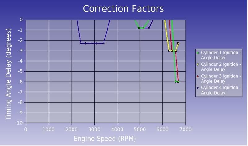

"These logs were taken back when I had EIP software, and I've seen pretty similar occurrences posted here from people running the original Revo tune. Only difference is the plugs (stock vs NGK bk7eix or whatever they are)
Correction factor logs only show where the ECU had to pull timing to prevent detonation. If colder plugs meant less timing pulled........well, it may or may not add up to 10hp, but you get the idea. "

Not all the detcans wired up to the engine yeaterday when I found a free slot, when to connect the device to the battery........ which we could not find..lol  In the boot. I had to put a spare battery on charge and put it in the footwell. I will be driving it to work this morning to do a cold log.  I dont think its the plugs as in not under peak cyliner pressures, but I will but mine in there of testing later.
Apart from that we are running 219-222g/s at the top of the rev range, its sooooo smooth and linear and the extra idle speed and torque request and made the clutch pick up loads better.   I just want to be 100% sure that no issues have been caused when the engine ended up side down, just the CF pull worries me at the moment, I will know in an hour or so if its phantom voltage pick up from engine harmonics, or is it an early flame front.  I think the 26th wil lbe fine to collect the car as it will give us chnage to do all the other work with the sterring.
