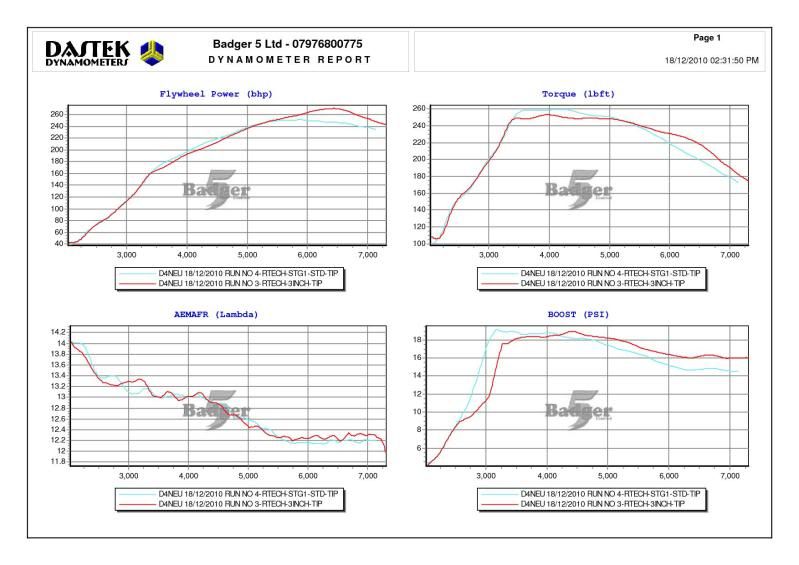

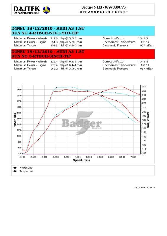

ahh i see, the car in question had nothing to do with yohan tho, i was just wonerin why the graphs were cut off, plus the barometric pressure is low, and this will help give high reading  ??  although im no expert so bare with me  :embarassed:
we didnt hit a brick wall, we just plain ran out of time as it was after6pm by this point. will see what happens on the 23rd  :smiley:
Makes sense now... :grin:
Did you look at the links and see the full graph, boost  & lambda logs?
The MAF logs = bolt on g/s gains of from an intil best 196.14g/s to 215.28g/s = gained 19.14g/s of airflow (which are about spot on to the Bora AMK logs)
I think the graphs might work this way:
and fuel and boost (which you can see how getting closer to 12.4:1 with a leaner burn can also make more power

5psi± less boost at 3,000rpm with the 3" TIP?
Yes I had put this down to the vortex effect of the narrow part of the smaller tip / oem tip which helps speed the air flow down low. The badger5 tip has a large alloy neck which slows the air at low intake speeds, but gives huge gains peak.  You need to remember the map above is only a stage1 map we did for Danes s3 over on Audi-sport.net . We had another s3 in with the same spec and we custom mapped it for the tip, which allowed us to compensate for the air speed losses, with a 1.4bar peak a little later in the rpm range we got 283lbft albeit 400rpm later up the rev range.   SFS have made a prototype 3" tip which by design should give the best of both worlds
