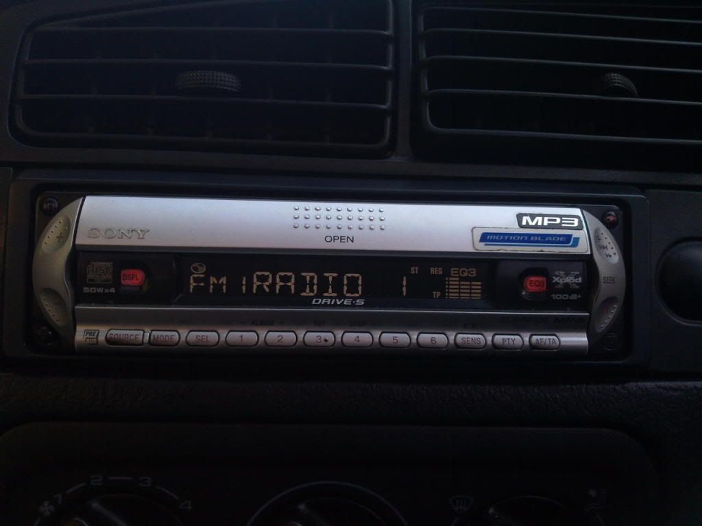

My right hand door speaker rattles'fizzes at certain volumes and on certain songs, and was wondering wha :grin: it could be... could it :grin: be a lose connection? or a split in the speaker?
would it be worthwhile upgrading all of the door speakers or whatever? how much difference would it make, considering I wouldn't really want to spend anymore than £100 really... as in would I actually notice any difference?
This is my current headunit which my dad gave me:
What would all you car audio experts reccomend I do, should i just replace the dodgy speaker/fix it or buy a new system :undecided: :undecided:, if so what should i get... baring in mind i know like nothing about car audio stuff...

The speaker is probably deteriorating accelerated by a more powerful headunit.  Replace the front speakers which will will make an improvement.
