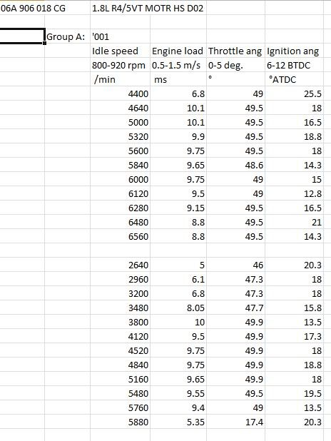

couldn't be arsed to do the drop links, the logs were much more important  :smiley:
any good?
