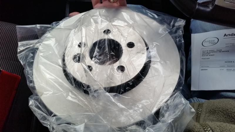

Hmmm, what could I be doing with these?

« Reply #754 on: 22 March 2015, 22:16 »
A nice little idea of what I got up to this weekend...
More bleeding is needed but I'm bedding them in at the mo so no hard braking anyways
