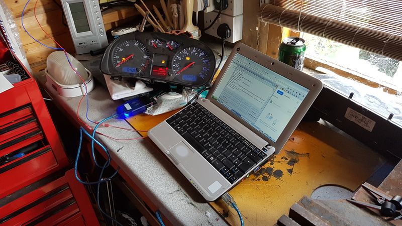

Bought some more clocks with a better MFA display and also the ability to add sweepy needles on startup
They needed the SMDs swapping over from blue to white/red which was fun

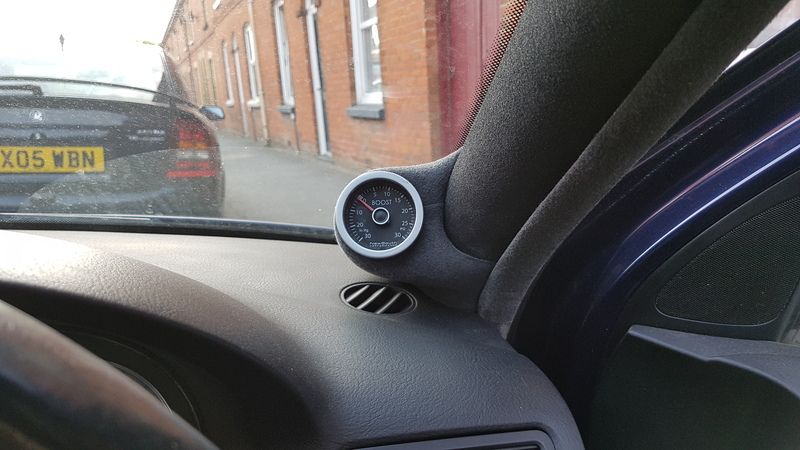

Finally found a 42Draft Designs pillar pod but in grey, so I dyed that too
