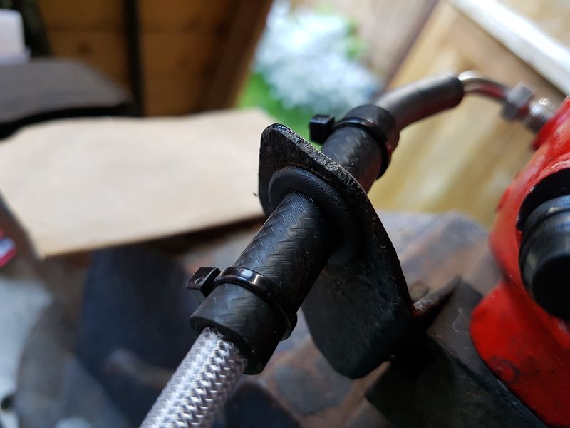

One of my calipers is complete, it's no surprise they were binding, the amount of crap I scraped out of the dust boot was crazy
New dust and main seals in, used red grease to lube them up
Braided lines attached, kept the original brackets on there and added some fuel pipe and a grommet to stop them rubbing through
Caliper now living on the bench, will strip the sticker off and touch up the paint; it's looking a bit sorry for itself due to my heavy handedness...
I also cleaned up the pad retainer and the pins

I bought some new caliper to adapter bolts but generic high tensile bolts rather than the proper Seat items, the genuine bolts are £15 EACH!
