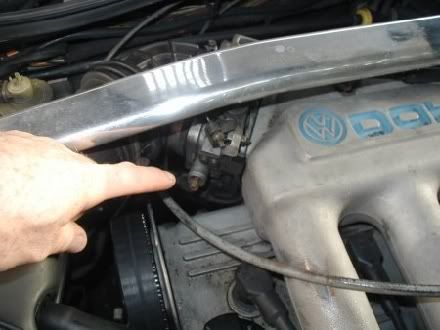

Take this little screw out...
...give it a clean, and job's a good 'un (hopefully)

Just took the screw out, i wiped off some dirt from it ( black oily). should it be dirtier than this to cause stalling when cold?

Remember how many turns it takes to get it out as you'll have probs if you don't put it back in right, would also recommend ISV cleaned with carb cleaner, dry it then refit. ISV is the cylindrical thing on the right hand side of the inlet manifold. Has an electrical connection and two pipes connected to it.
