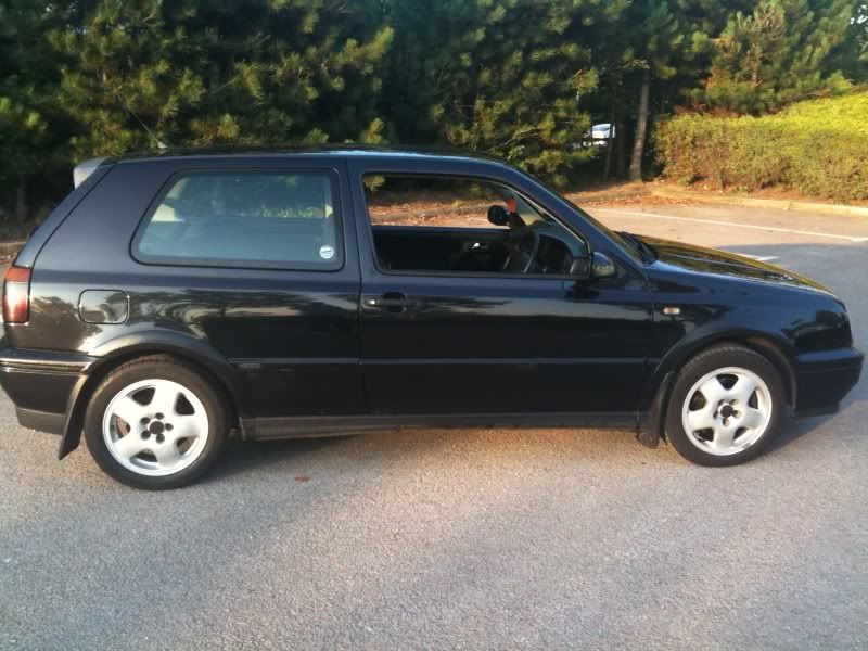

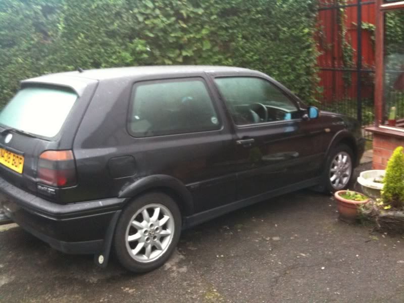

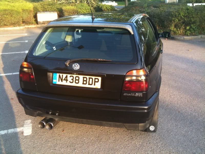

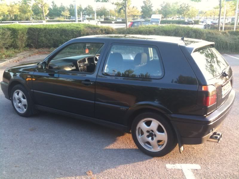

Early september 2009, needed a car and always fancied a MK3 GTI,  and saw this on the way to a party with my other (more sensible :) ) half, so stopped and had a look and all seemed well, so went back the day after with a friend who used to own MK2 gtisand we went out etc, and i parted with £825 for it, with history upto 108k and it showed 115k, the guy had spent a small fortune on it, and i had enough paper work to start a big a4 file, reciepts back to 1999.
These pics are the day after i got it
this pic shows where i was having a mess about with it,

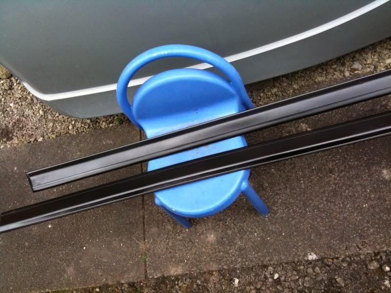

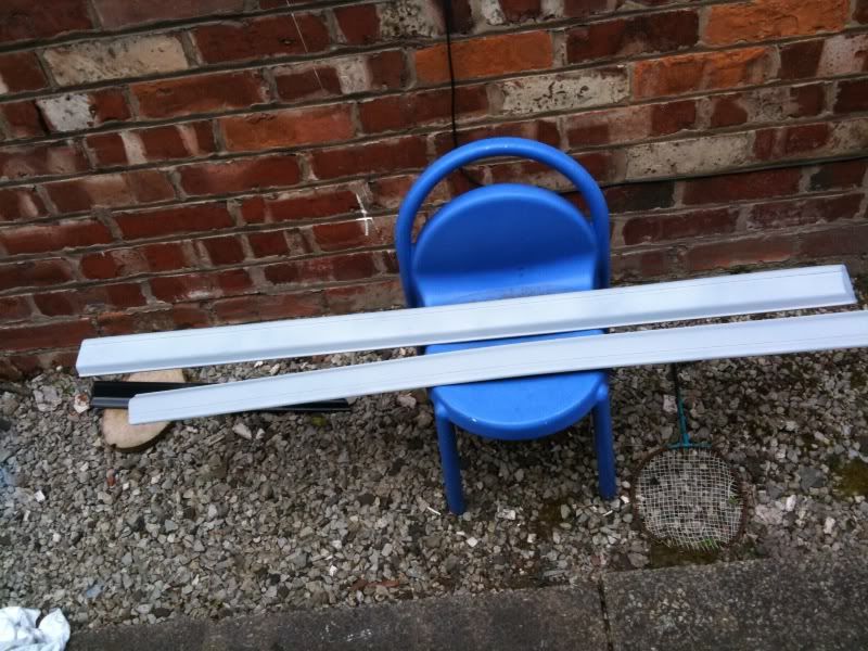

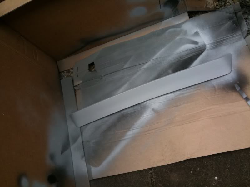

next was the rub strips down each side as previous owner had engraved quite badly the reg plate into them, so picked up another set cheap, funily enuff off the guy i got the car from, lol, off ebay,

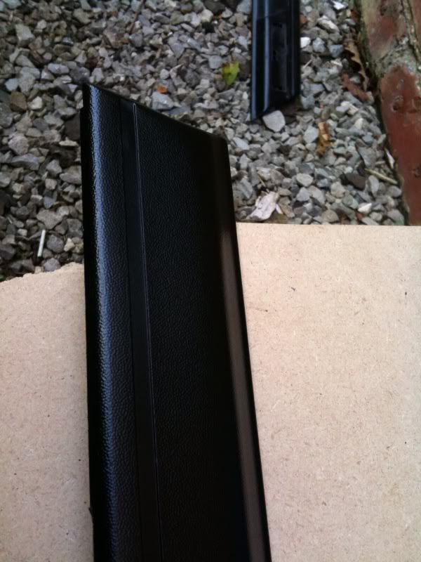

so sprayed them black with satin black plasticote from b and q, primered aswell, 2 coats of primer and then 2-3 coats of black.
the home spray booth, lol, i aint got a garage

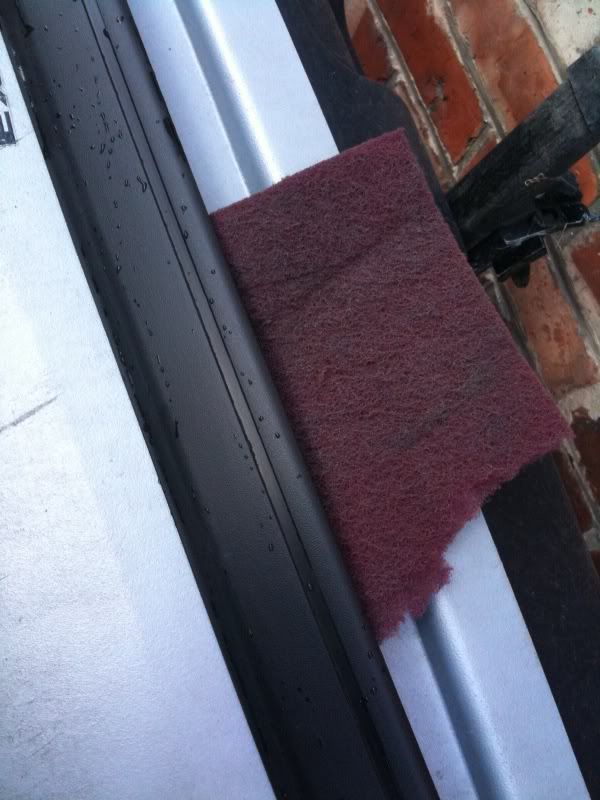

scotchbrited them so key the plastic lightly
1st coat of primer
2nd coat of primer

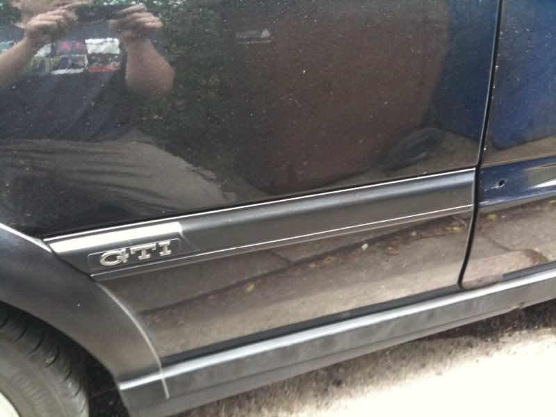

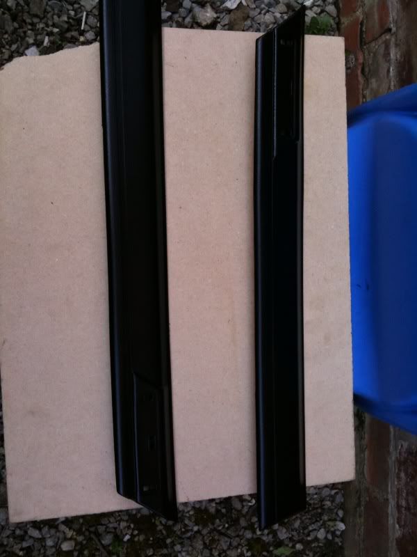

no mid shots of painting, dunno why, normally take pics of everything,  but here they are finished
doors
rear quarters
close up
rear qtr back on the car

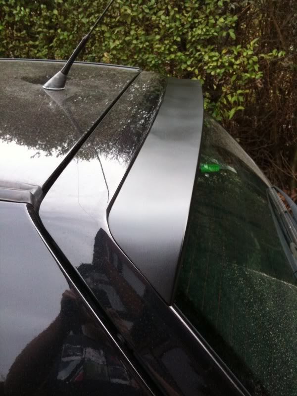

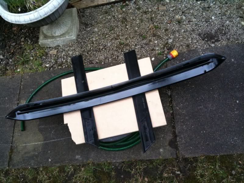

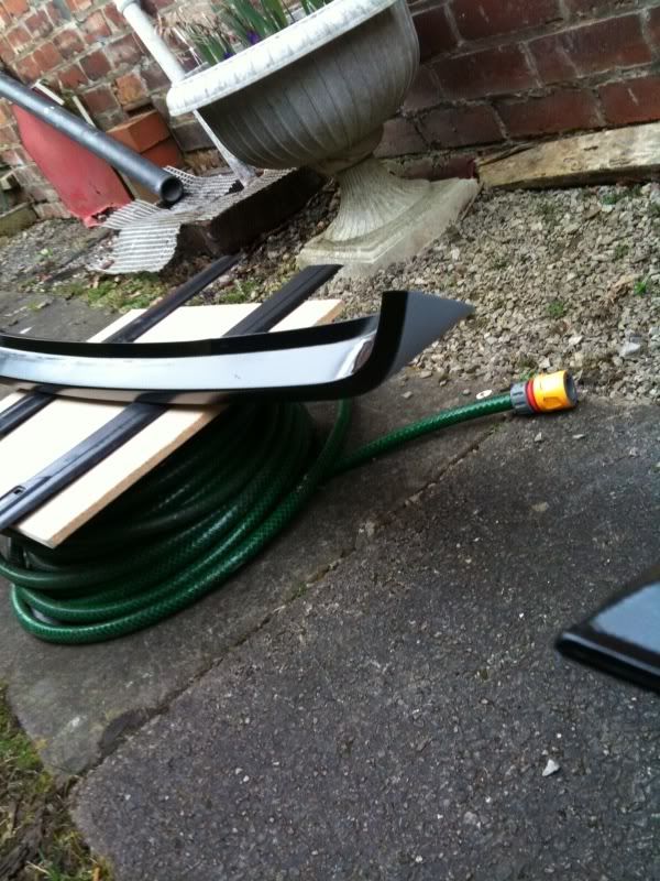

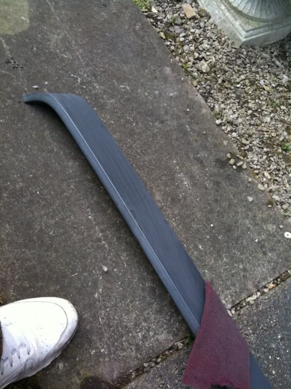

and the grey spolier has had a treatment
scotchbrited
primered
underside sprayed up 1st
and back on the car in black

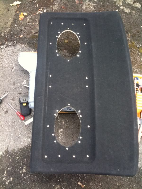

stealth shelf made, some time ago, but is part of the build so here it is
some shots

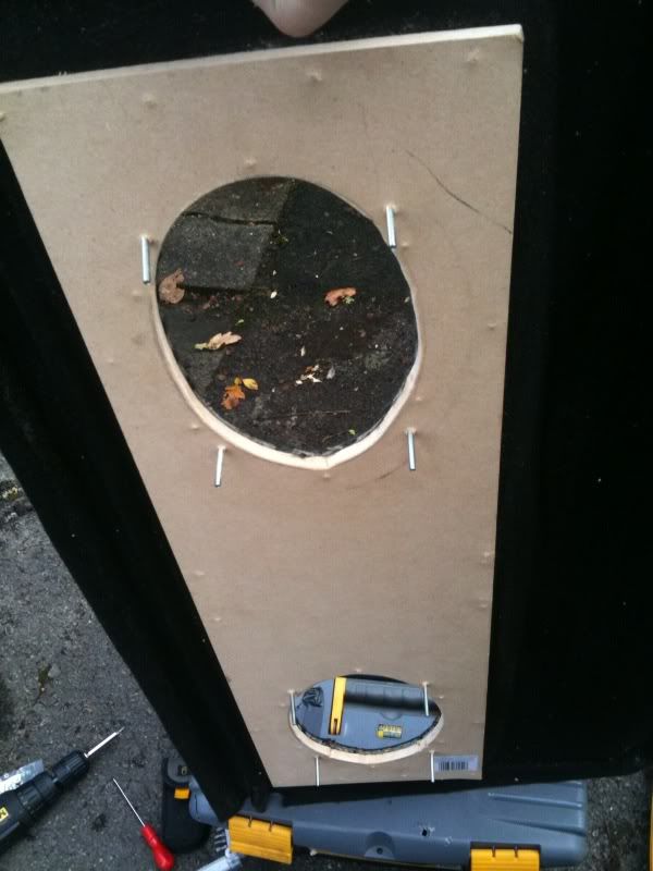

wood panel screwed to  bottom of shelf, and speaker bolts passed through
wood panel from the top

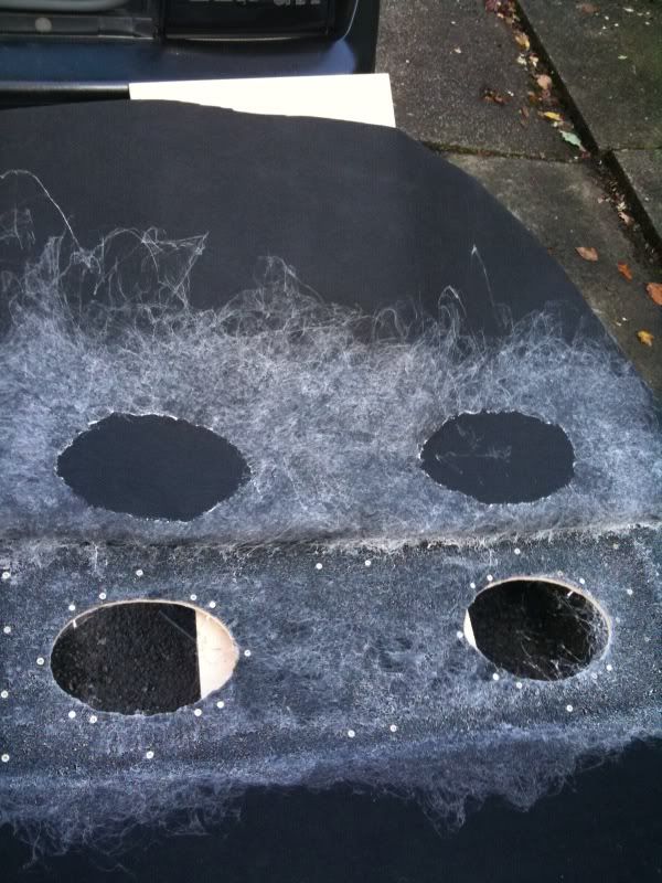

carpet going on
finished

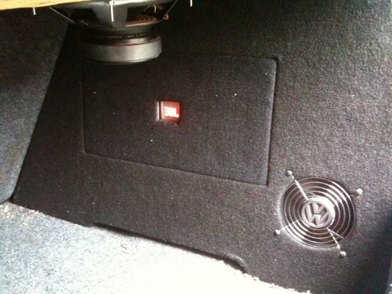

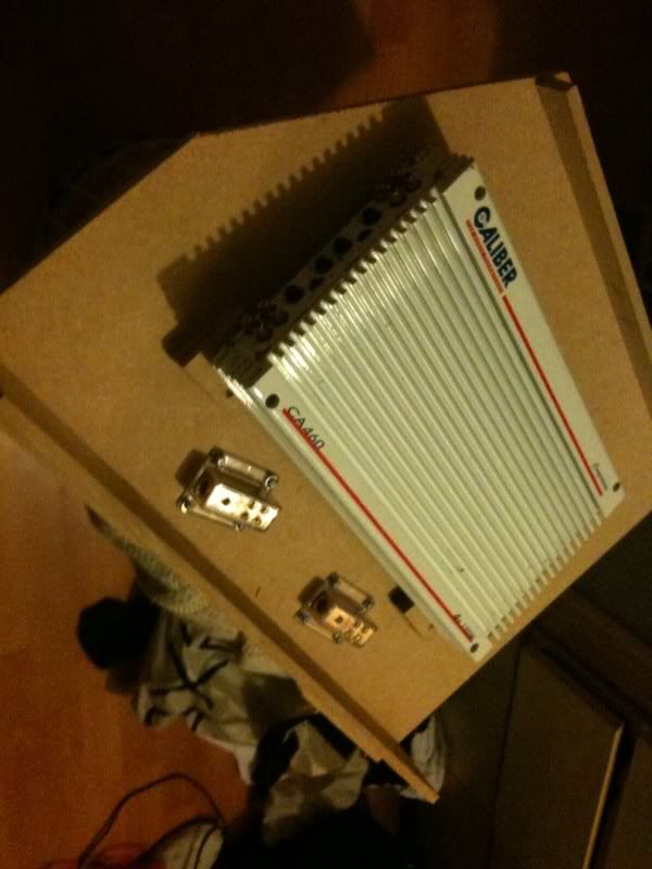

amp mount
shows a caliber amp, which i changed to a jbl half way through the build, lol

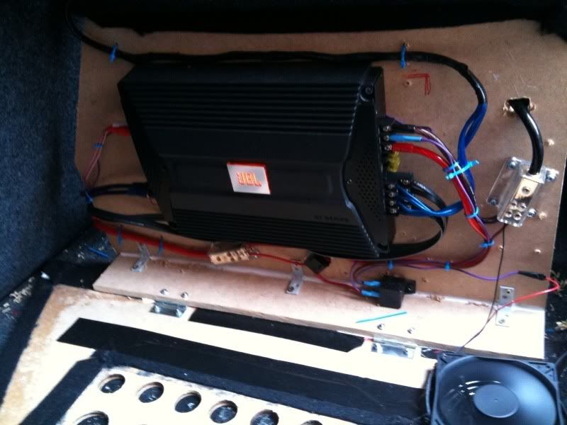

jbl fitted and wired up
note the panel on the front now which has holes in for cooling and is the shape of the original amp

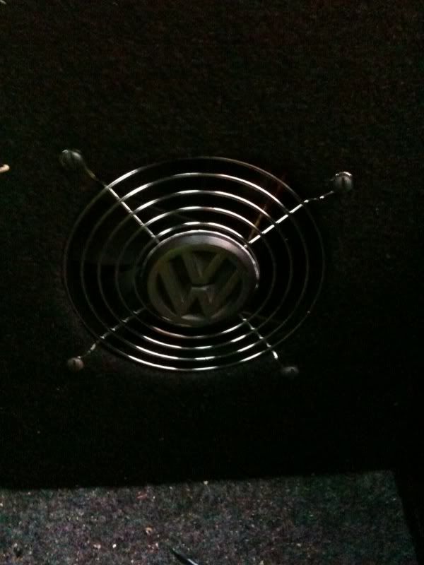

also a relay to control the amp on and also the fan, and eventully a coloured light :)
amp rack closed and note the vw badge on the fan
