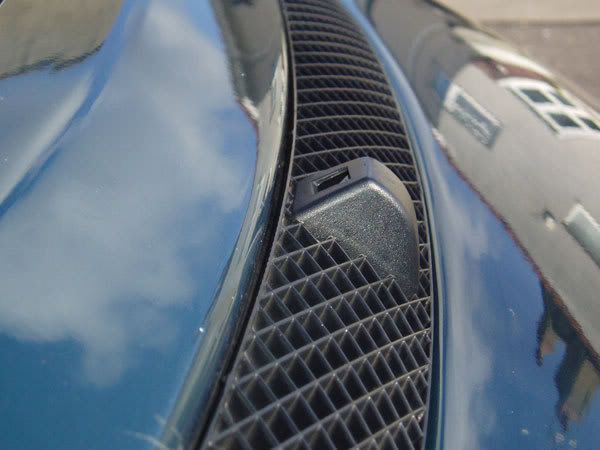

I put some extra jets on mine, they fit in the bonnet vents, with a little bit of silicone, and are thus easily removable if you ever change your mind. You just need to get two extra jets, and some extra splitters from the scrap yard.
http://www.golfgtiforum.co.uk/index.php?topic=32761.msg269930#msg269930
Can get some more info if you need it?

how did you make them heated chap?
Are mk2 jets heated allready?
how did you connect the 2 extra jets just with like T pieces? diddnt that make them have less spray power?
lol sorry chap, questions questions. :laugh:
They come heated as said from GTI's or MK3 golfs, in fact, not sure if oter models other than GTI's came with them probably GL's as well, someone will clarify..?
As for connecting them, they slot in the vent, with a little silicone (which can be removed if you change your mind) then you just get some extra hose and plug in the t-pieces

looks cool mate! think im gonna give it a try!
