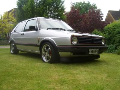

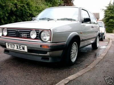

Here it is, the day I picked it up. Modifications included electric windows that fell down, non working door locks, three bent BBS rims, a gear change so baggy each gear selection was a random guess and various dents incl one in the roof :huh:

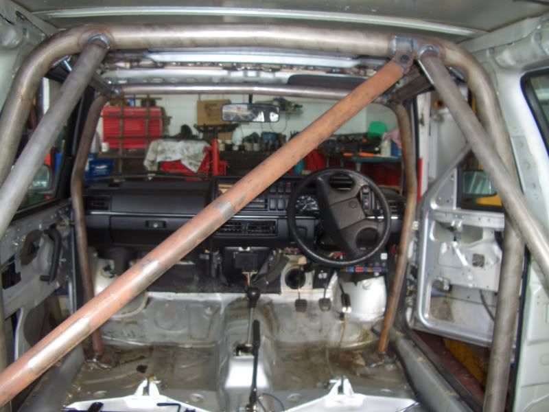

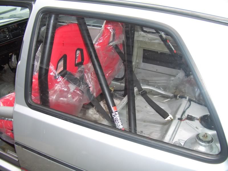

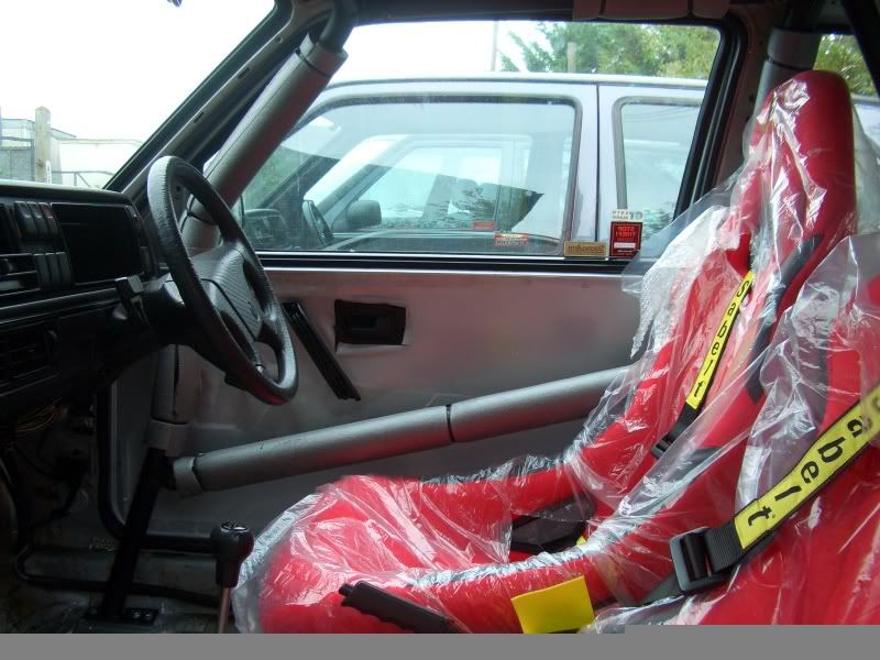

So I stripped the car out and we fitted an OMP six point cage
Then some cheap bucket seats
Some dodgy 5 spoke rims with 888's off ebay
And three pieces of perspex from another bloke on ebay

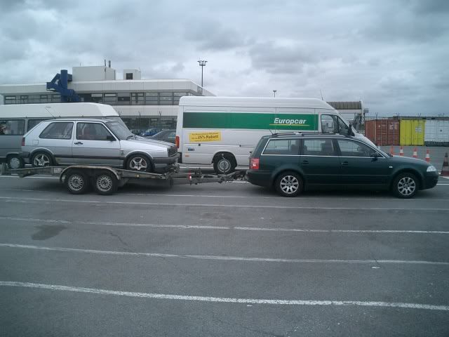

I picked the car up a month later and headed home.
With the R888's in the back the Golf handled rather badly, not helped by the rain and nearly bald nankang ditchfinders on my road wheels.
Just approaching the Belgium border and madman in an A4 came around the bend towards me, backwards! I skidded to avoid him, escaped down a side road, got on the verge and hit the armco. Bloody brilliant- 2.5 laps on the Ring and crash avoiding some bloke who never even stopped!
Damage wasnt too bad- a bet valance and dinked wing. The car still got me home!
Here it is, home at last after a month in Germany.

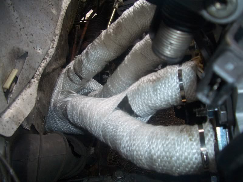

And a new 4-2-1 SS magnex manifold and system. Lovely :tongue:

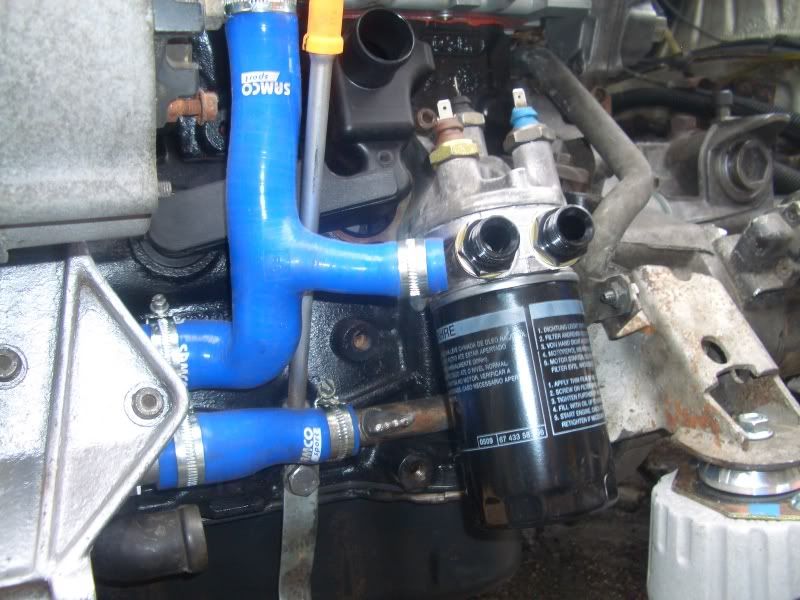

I baffled the sump, fitted silicone hoses and an oil cooler

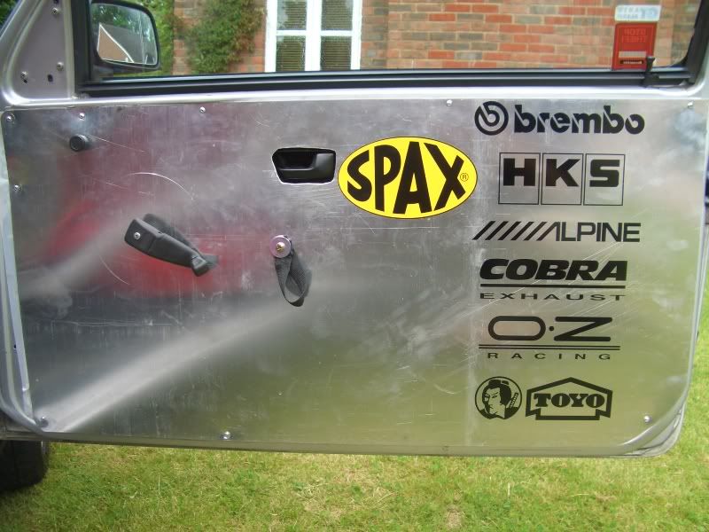

I made up some door cards from 0.6mm aluminium (and got carried away with the stickers)
stuck my private plate on it and a Ring forum sticker in the back window and it was ready!

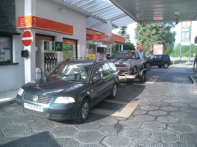

Yet again my car was put on a 160 euro low loader and taken to Ollie, the local garage.

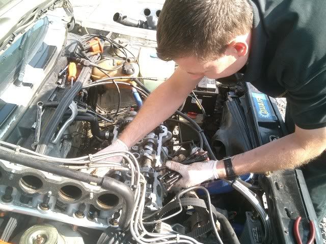

My good friend Gareth started lifting the head at his workshop

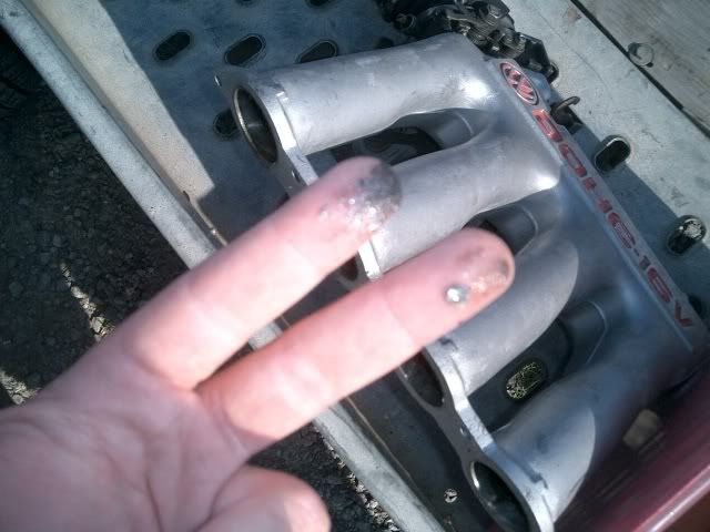

We found this in the inlet manifold :sick:
I held my breath as the head was removed

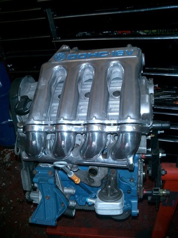

I decided to build another engine.
I sourced a 9A and the guy who built my first head sent me another FOC once they had seen what happened to the first one.

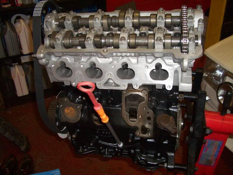

Same spec as the first, new oil pump, new water pump, new head gasket, bling bling 50mm inlets
Put it all together and then read an article in PVW about putting a 20VT in your car in a weekend. Hmmmmm :drool: sounds like a plan.
The 9A never made it into my car and sold on pistonheads for a grand. The hunt for a mk4 Golf 20VT AGU began.

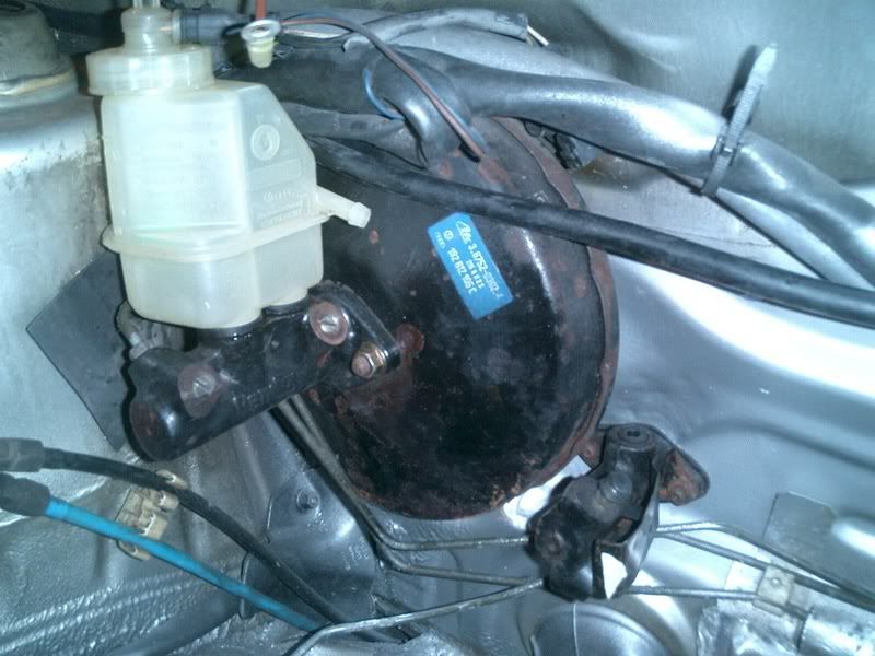

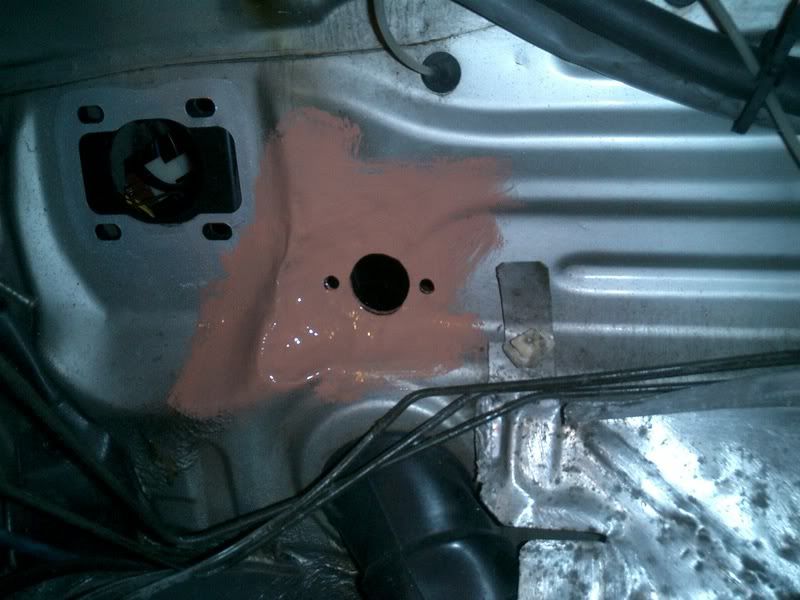

I stripped the engine bay
and the subframe

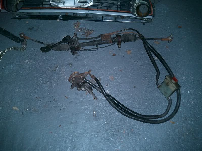

Out came the PAS- no need for that anymore, weighs too much!!

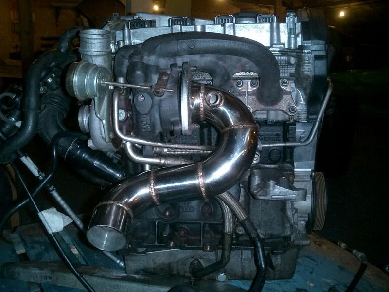

Why build a K03 200bhp car, when all I need to do is strap a K04 turbo on and I will have 270bhp???
How bloody naive was I??
So I bought a K04 from a APY S3, the injectors, manifold a few pipes.
The test fit was fine
Oil piped seemed to fit

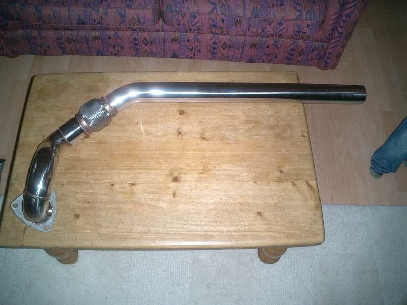

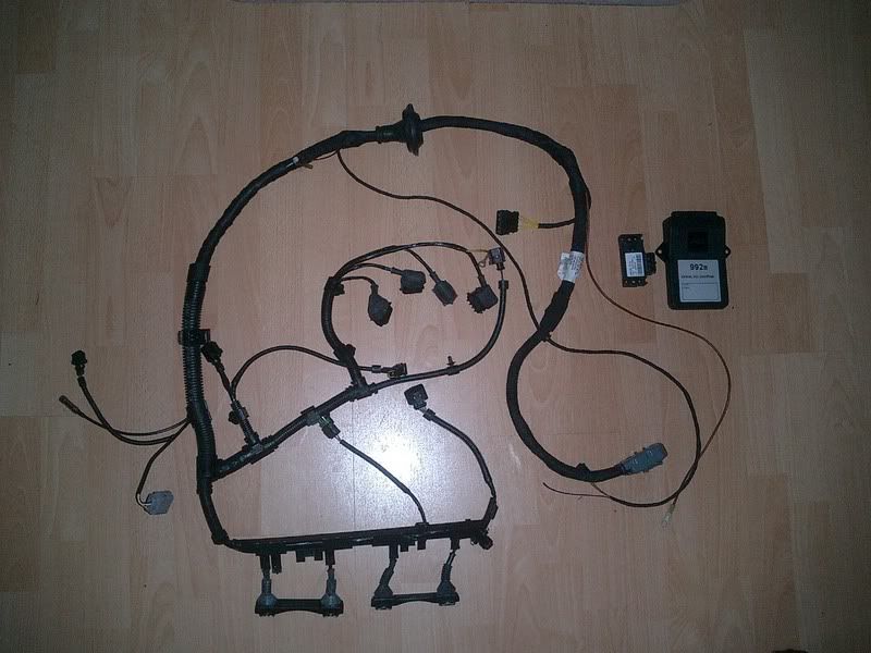

Then after Christmas, QPEng sent me a present
My ECU and downpipe had arrived :grin:
But my plan was still changing. Now my car would potentially be producing 300lbft of torque, the 02Y box was only rated to about 200lbft max, it would never be able to take it- I needed to uprate the gearbox before I could even think about fitting the engine.

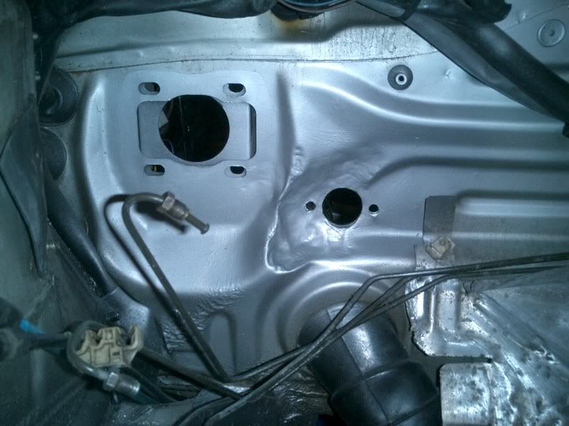

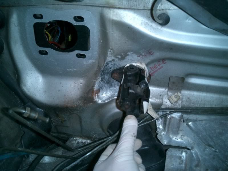

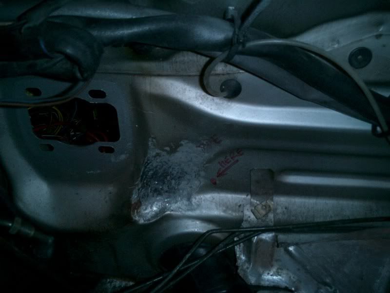

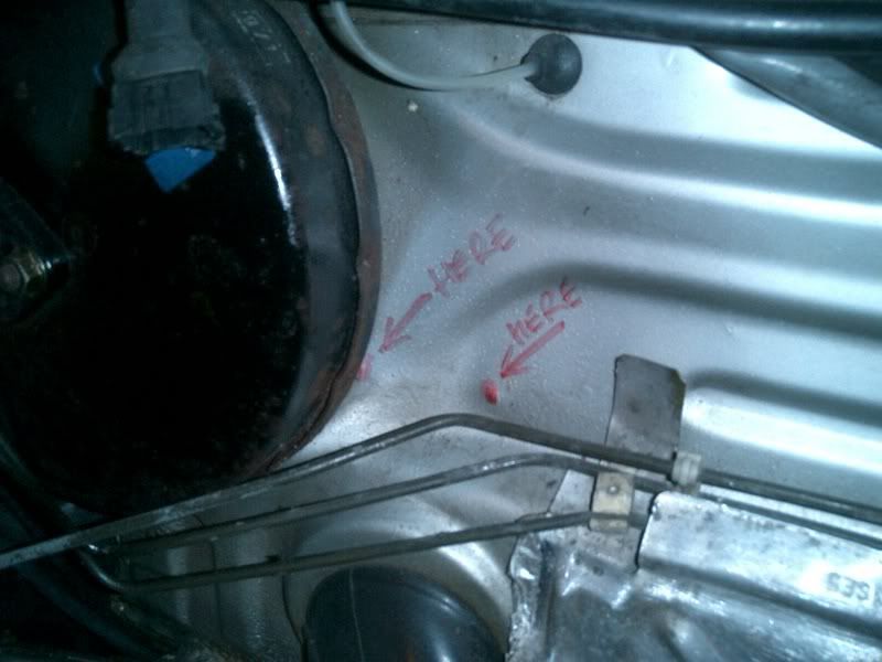

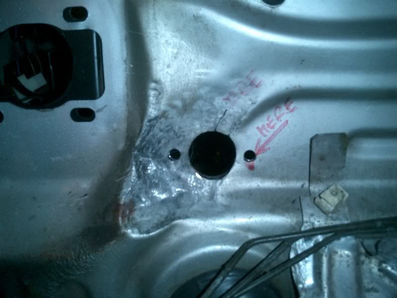

Bugger- this wasnt as easy as the article suggested.
I swapped some bits for an unknown 02A box from a 16V Corrado and set about working out the best way to adapt the hydraulic change to a cable mechanism.
I also needed to work out how to get the oil return pipe under the engine mount (attempt number one seen here)

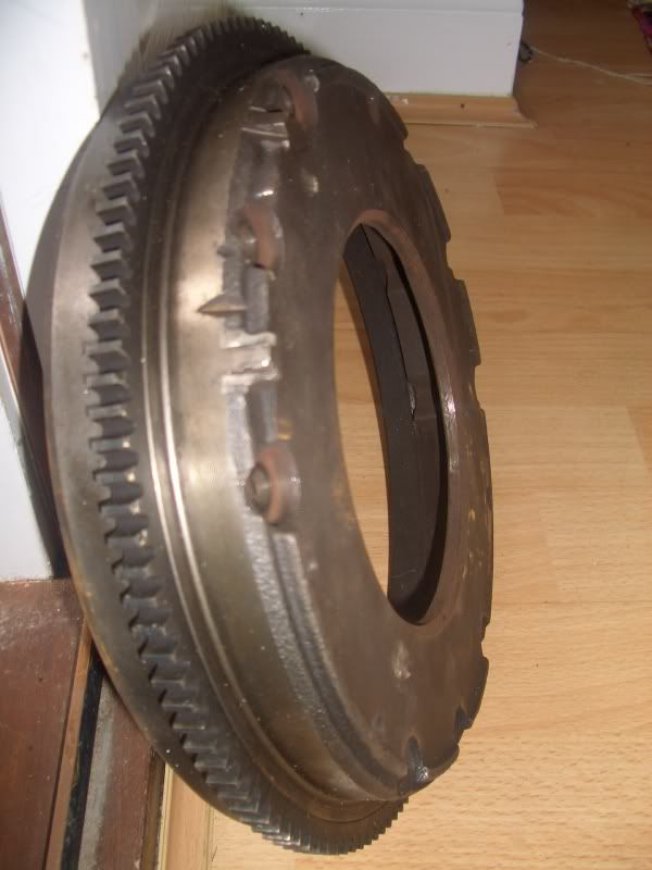

Get the new bigger flywheel lightened

And mock up the new pipe work for the K04
Still least the shiny bits looked good!
I decided to start with the easy stuff and vibratech engine mounts were fitted in each corner
Ben at QPEng adapted the throttle body to work with the 1.3 mk2 Golf throttle cable I had bought

So this is how you fit a hydraulic clutch to a a mk2- (this might make a useful sticky???)
Why do you need to do this?
If you want a stronger gearbox than the standard 02Y it is possible to fit the cable shift 02A box from the mk3 (cables, clutch choice and all that jazz is an entirely different thread).
I got an 02A from a 16v Corrado
originally the plan had been to convert this to a cable shift and forgoe the hydr operation, but I was advised against this as I am using a paddle clutch and it would be so heavy it would be undriveable.
So you need a few parts, the first of which is a Corrado 16v pedal box which has the bracket for the clutch master cylinder. Here we can see the original and the new side by side.
Using the pedal box as a template it is then necessary to mark the holes in the bulkhead for the clutch master cylinder
On the engine side it looks like this:
Next it is necessary to remove the brake servo
As you can see the bulkhead is not flat and it is necessary to fit the clutch mc between the two red dots. The m/c must be perfectly aligned for smooth action with the clutch pedal otherwise it may wear and result in failure. Which is bad.
Therefore- using sophisticated tooling, it is necessary to reshape the bulkhead. I chose a large hammer.
I smacked seven loads of pooh out of it until it looked like this:
Then I fitted the m/c against it and cut a template from the inside:
Amazingly the cluch m/c fitted perfectly
Trouble is that doesnt look too good and I figured probably wasnt the best job:
so I treated it to a little rustproofing
then painted it in a random silver colour that almost matched the car
