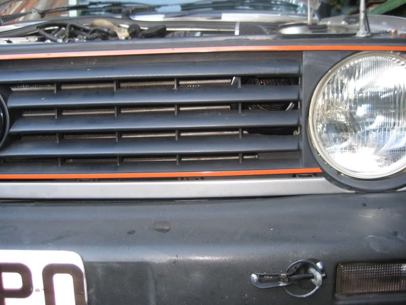

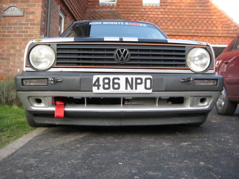

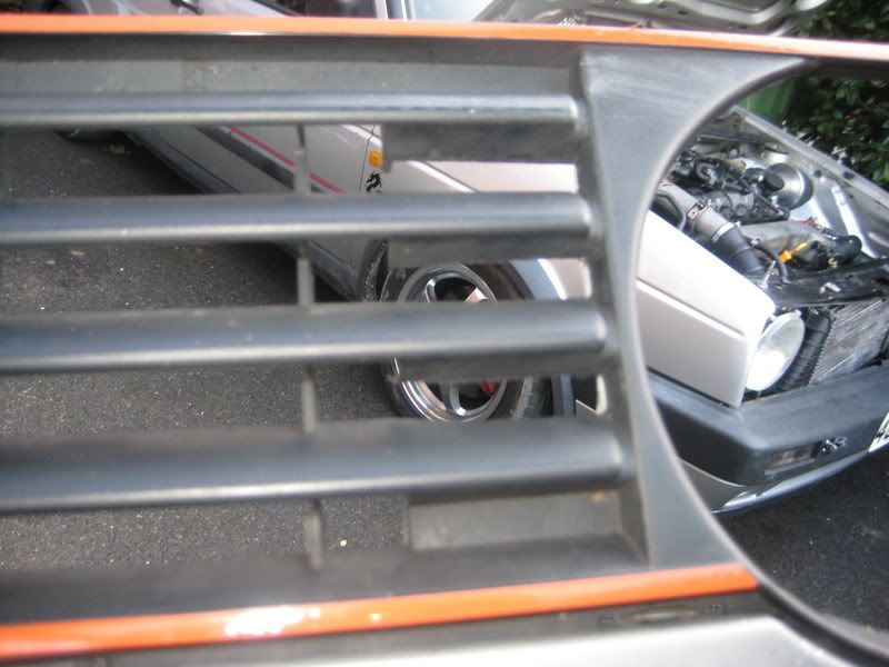

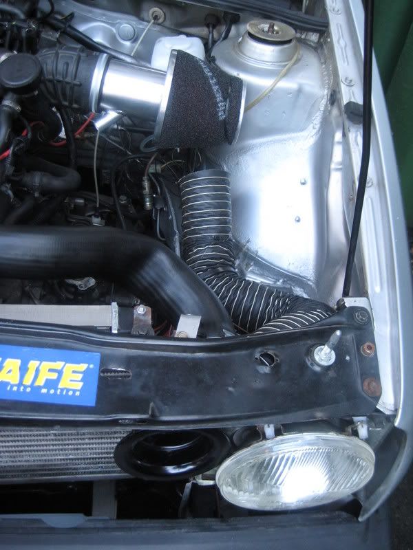

First was the fitting of the cold air duct for the air filter. Eventually the plan is to build a cold air box where the battery used to be, but for the time being this option should do the trick.
I was going to put the duct in the bumper, but frankly it looked sh!te, so Jason suggested mounting it behind the grill in front of the intercooler. This meant removing the slam plate and the radiator, but the end result is quite neat.
it did mean taking a hacksaw to the grill to remove some blocks
But the end result is quite pleasing and not in your face

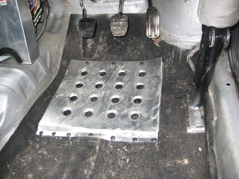

Next was fitting some evil grippy stuff to the floor. It is like sand paper and it really would take an idiot to try and rub it down with their fingers, after all it would obviously just take your skin off.
Ouch.  :rolleyes:
So this is how it was before:
And this is now:

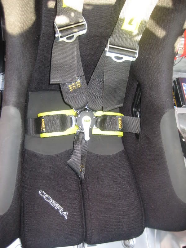

Next job was fit the crutch strap- not a tricky job when the seat was on a nice high frame, but finger-nipping tastic when its bolted to the floor. Even worse if you finger is sore cos you might have rubbed some sandpaper type matting for some reason.

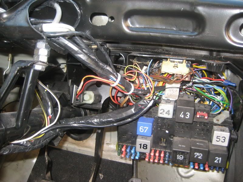

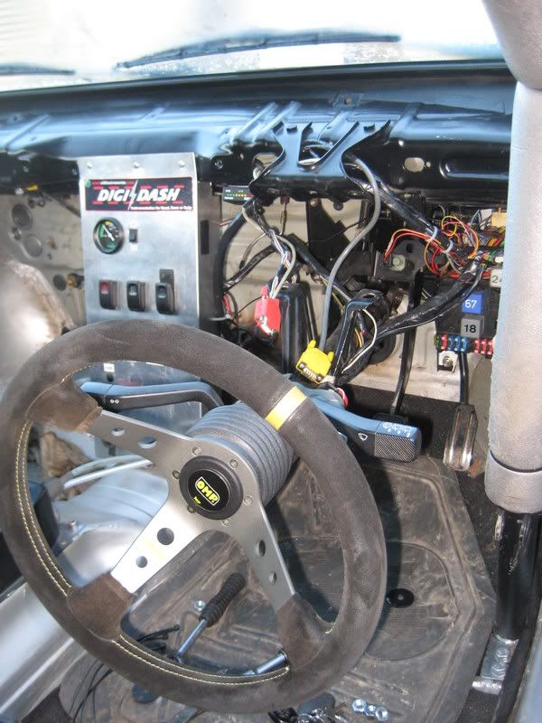

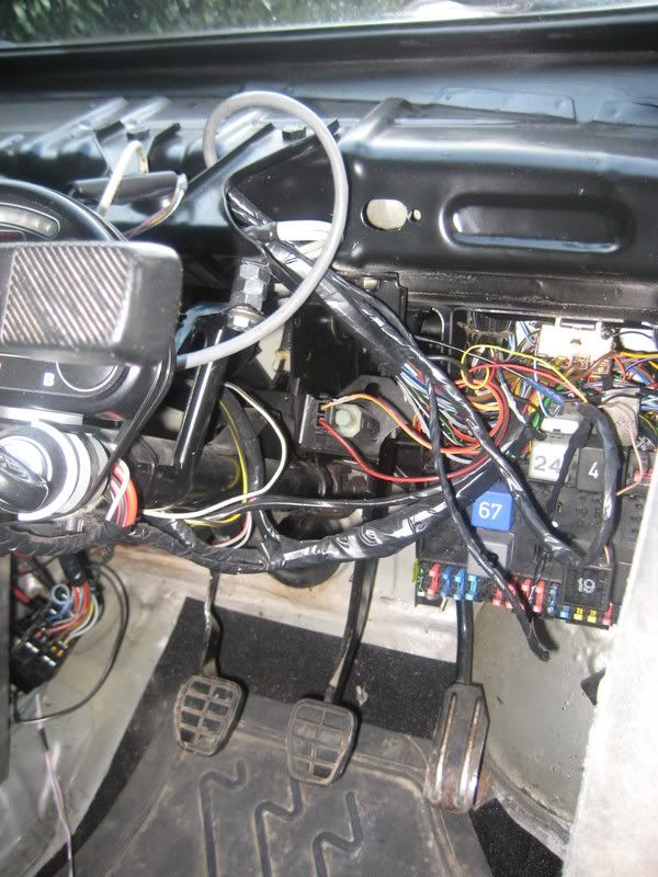

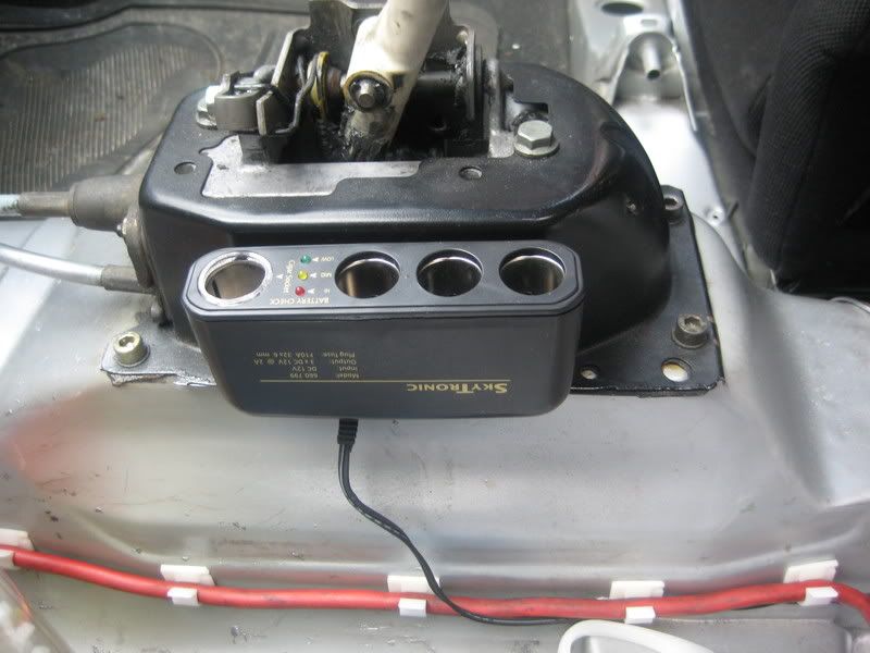

Next it was time to try and sort out the wiring- it is quite frankly a bloody mess, but most of this is the way it is in the car itself, its just hidden by the the dashboard.
I started with my hand crafted and loving cut out centre dash. I'd wired the boost gauge into the wrong light feed so everytime I used main beam it switched off. Also needed to change the feed to the AFR meter and get the switches earthed properly.

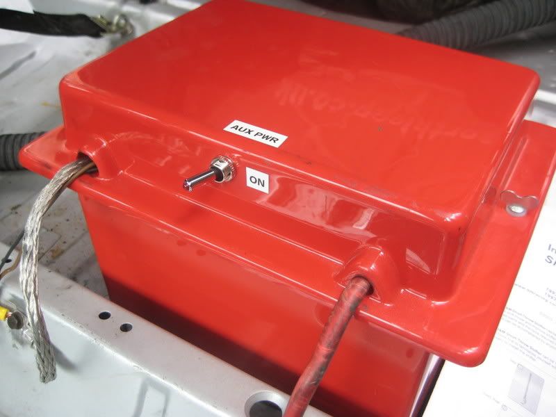

That done I needed to create some kind of feed for my V-box and GPS. The answer was a multi plug from eBay for a fiver, wired via a switch and fuse from the battery.
I love these LED tipped switches- this one glows a lovely red when its switched on!
Finally I spent an age tidying the fuse box wiring. When I'd finished it looked exactly the same!!

2x DB9's

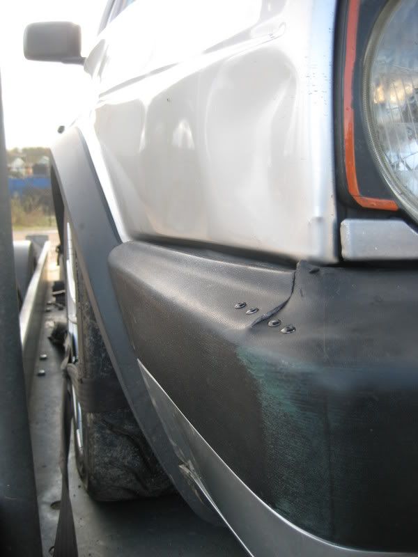

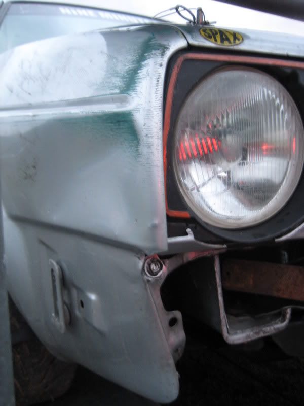

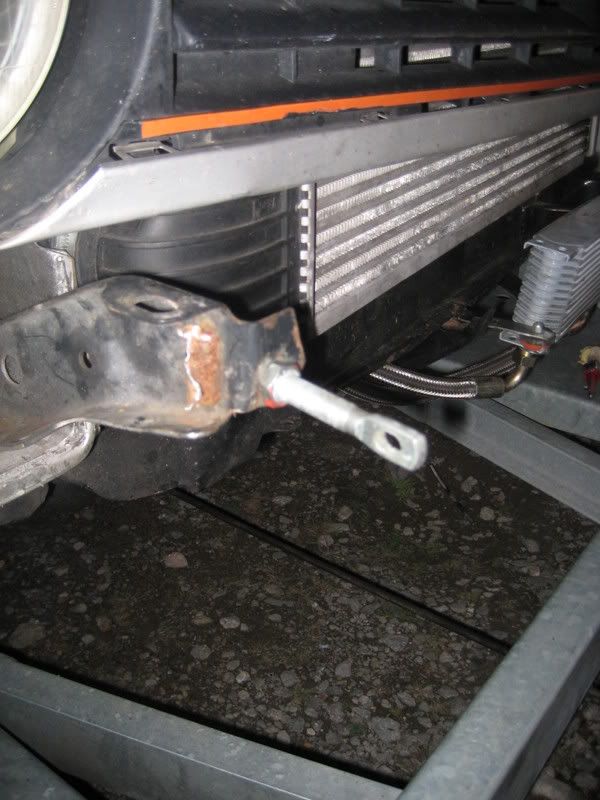

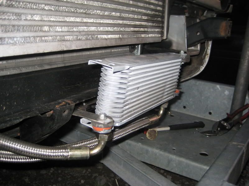

Using armco to stop seemed to be having an effect on the quality of my front wing, it also bent my bumper and oil cooler mount :blink:

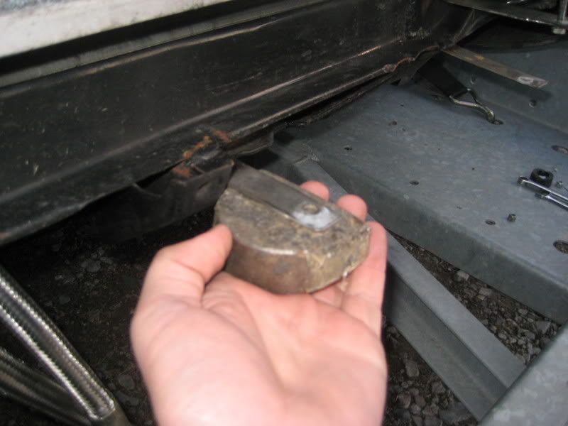

Luckily my mate Jimmy had a useful panel beating kit and I took the bent bits with gay abandon (calm down Weemna- this just means I attacked it with no idea what the hell I was doing)
Bit of hammering and soon the brackets were straight and the cooler refitted
My Gucci bumper pins had gotten bent too, so more hammer work soon fixed them- just got to add a splash of black to protect the uncovered metal
Damage post Cadwell:

3. bent wing

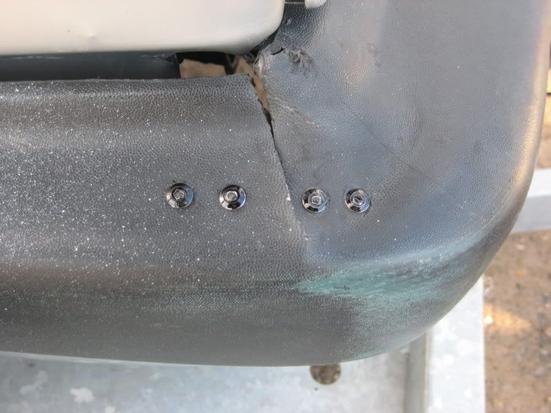

Then set about fixing the bumper. I should really just buy a new wing and bumper but it seems more "race" to try and repair, so I made up a small metal bracket and rivetted it in place.
A quick splash of Gareth's gothic nail varnish and you would never know. Ok well you would, but if you close your eyes a lot, you would never know.

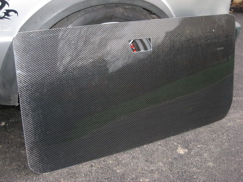

3. Fit new door cards

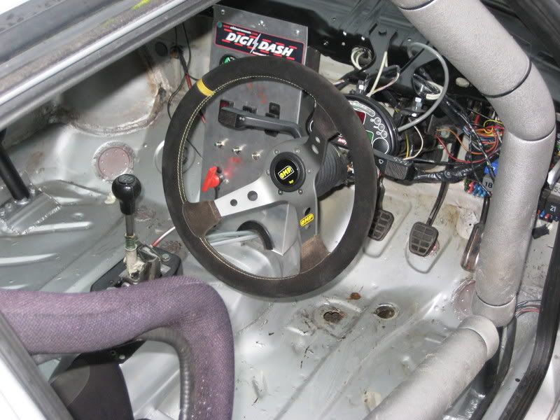

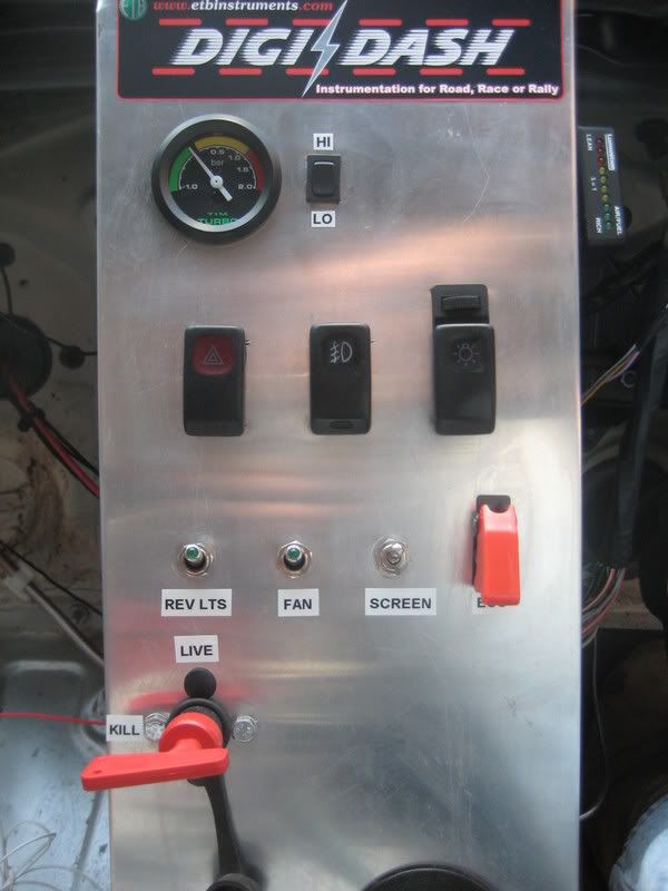

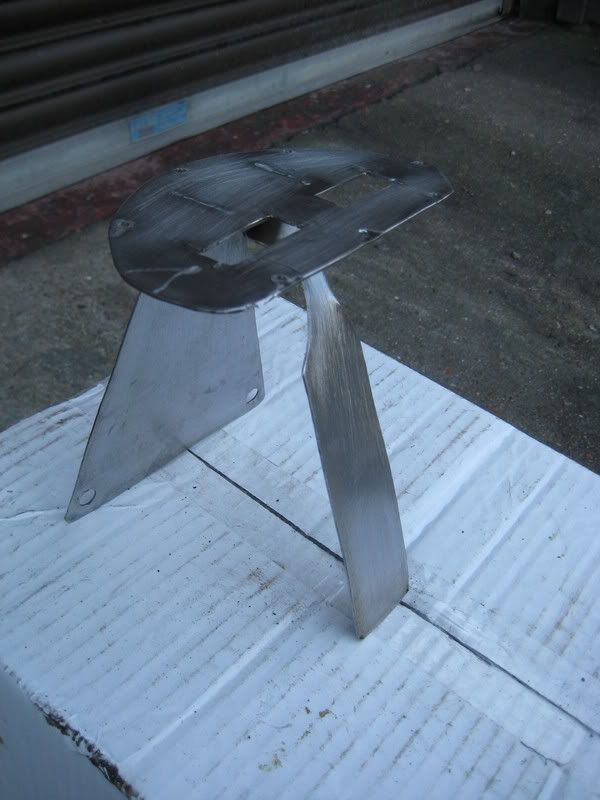

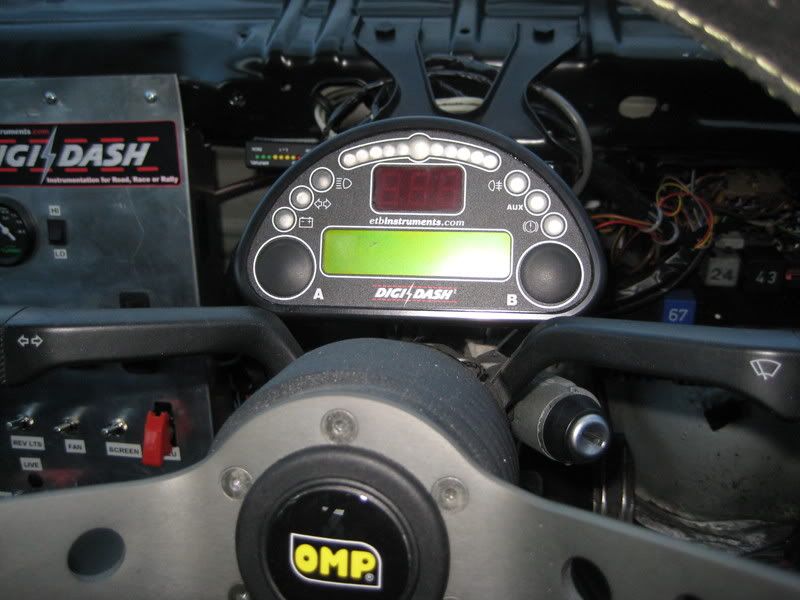

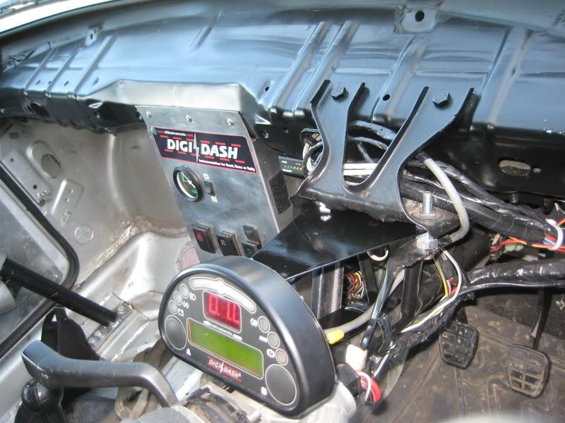

I built a bracket to mount the digidash on
Gareth was clearly impressed by my metal working skills!!  we both went to the same school and I think its fair to say our metal work teacher would not have been using my work as an example of perfection!
However after a splash of paint it looked ok- then it was just a case of undoing the steering column mount
Dash fitted and I'm really pleased- it appears to float above the centre of the wheel
And actually looks pretty tidy

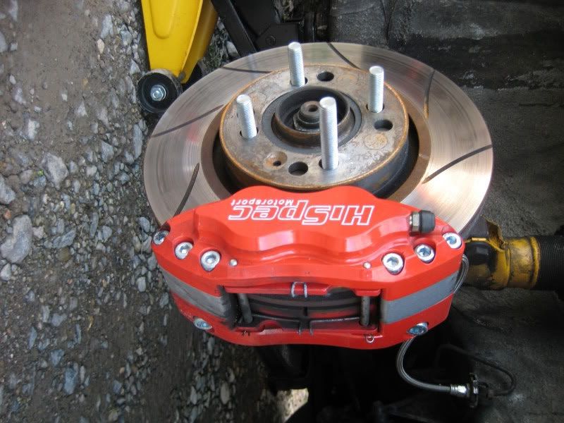

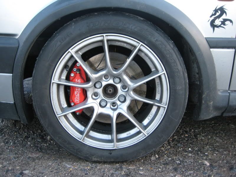

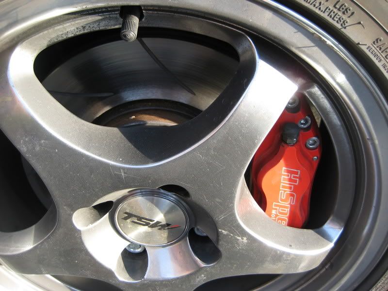

Then fitted some Hi-Spec 285mm 4pots

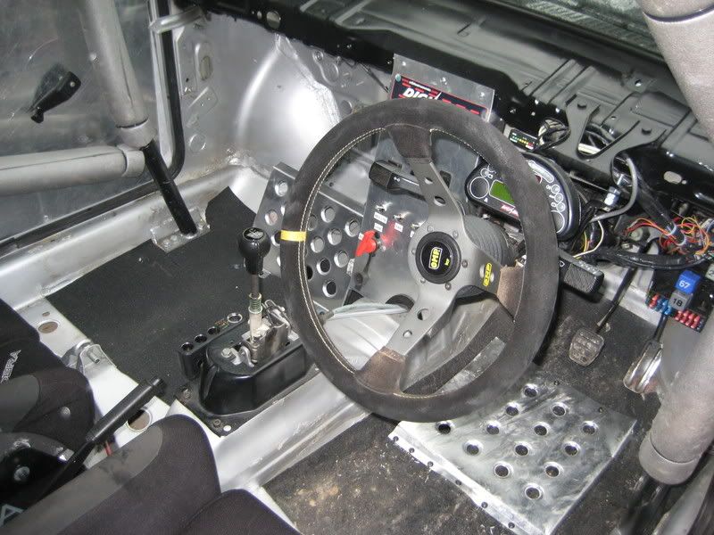

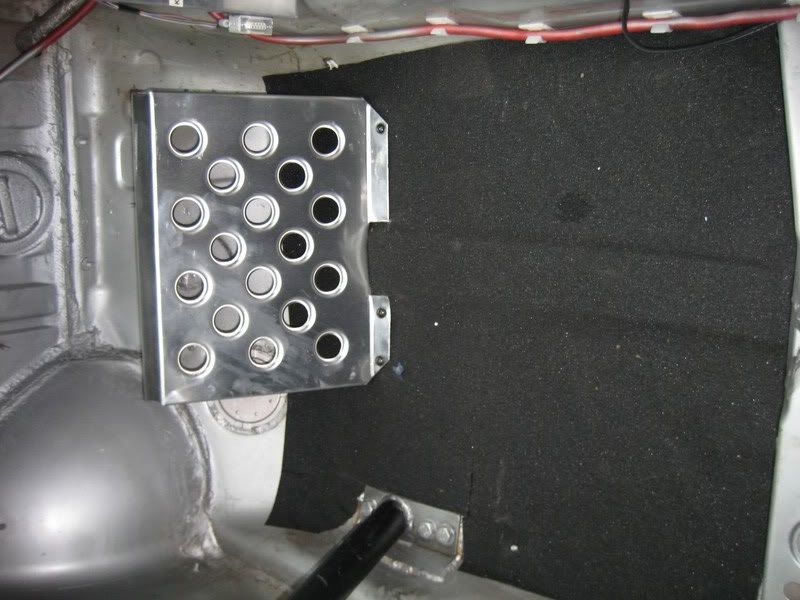

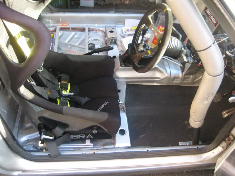

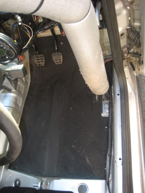

Needed somekind of flooring as the quality blagged grippy wore straight through at Cadwell.
Liked thes checker plate solution but I'm far too lazy to go cutting up bits of metal so I bought some from DT.
Really need to clean the floor:

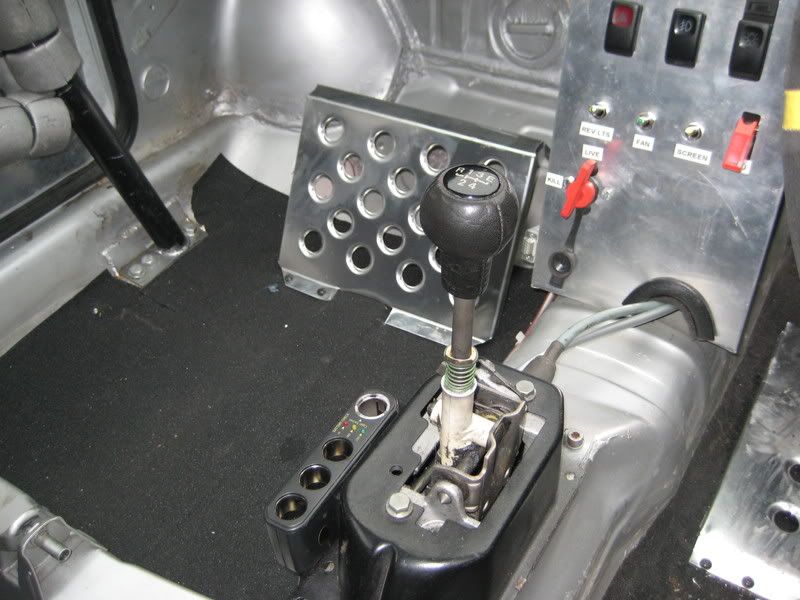

Also bought a passenger foot support
Next job is to bond/glue some suitable rubber matting I think on the heel part of the pax side to stop it wearing through.

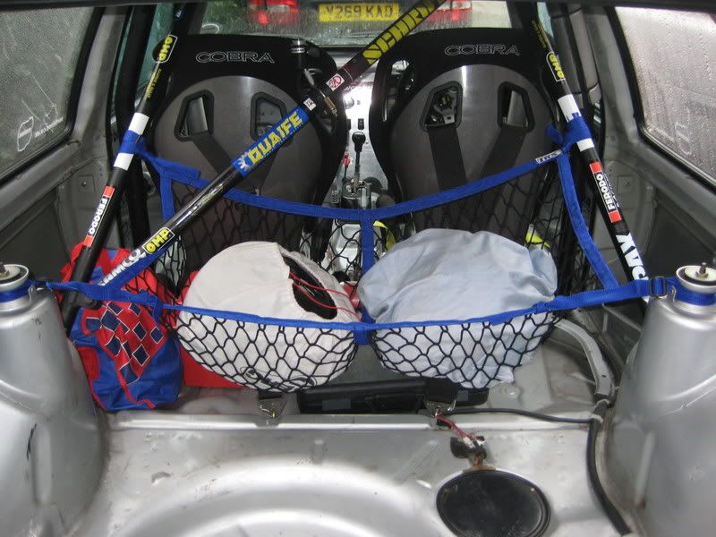

So this is my finished interior!! Hmmm comfy!
Then I fitted my helmet hammock and put my helmets to bed!

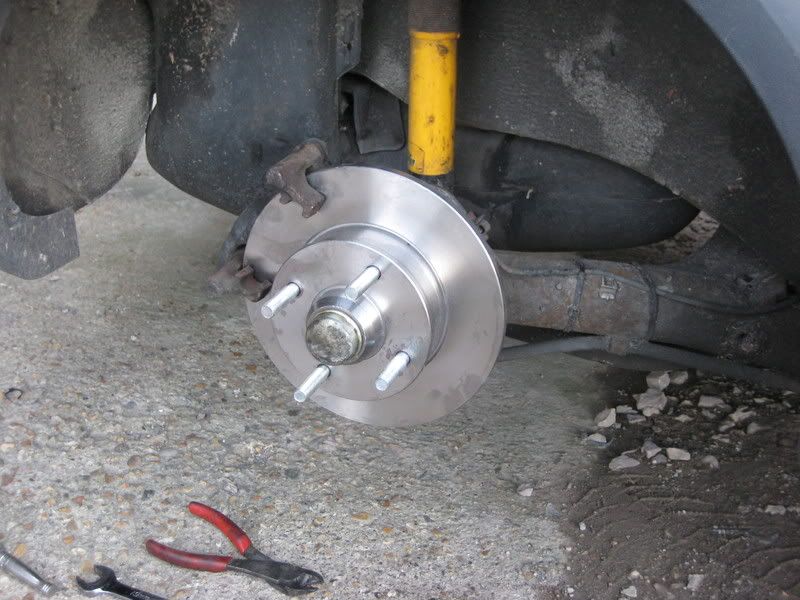

Fitted new rear discs and bearings
Couple of hours fiddling about and some guidance from Gareth saw the job done

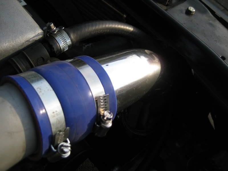

Fitted my boost pipe after the last one burst (still waiting for the silicone hoses to arrive :angry:)

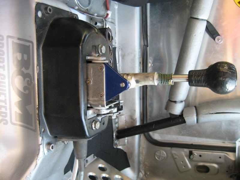

Finally fitted the short shift

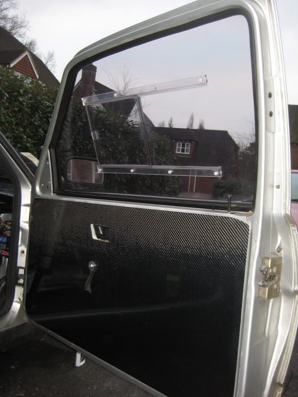

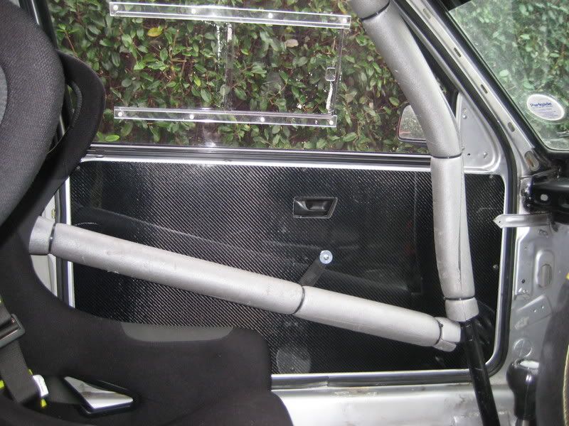

Didnt have a heap of time today but the plan was to remove the glass windows and fit plastic sliders, then replace my home bodged ali door cards with these new ones.
So it started like this
And ended up like this
fitted the pax side - very bling bling!

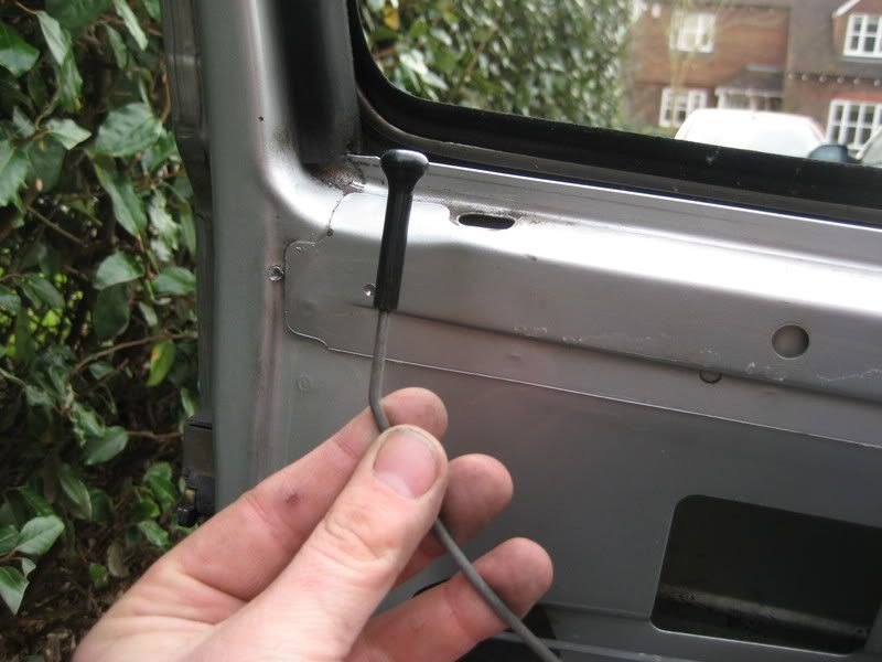

Also decided to remove the locking pins as anybody could reach through the window sliders and unlock the door otherwise :o

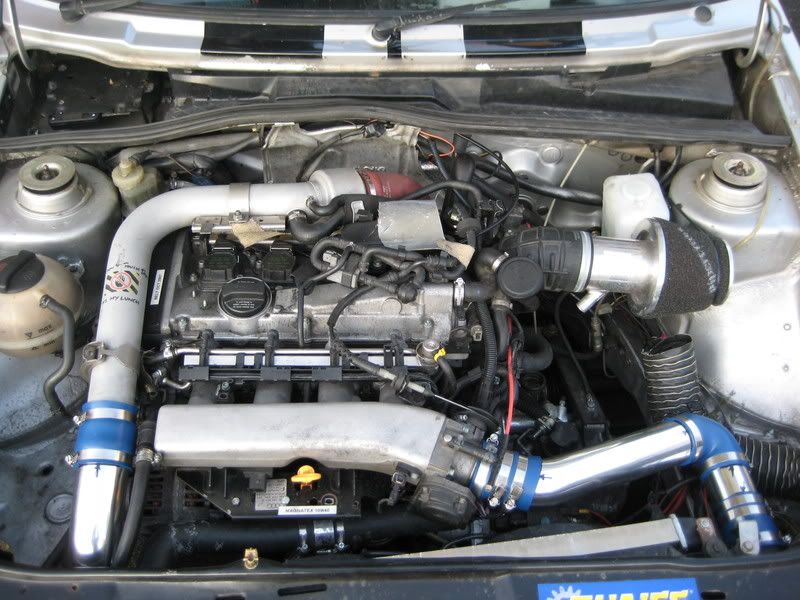

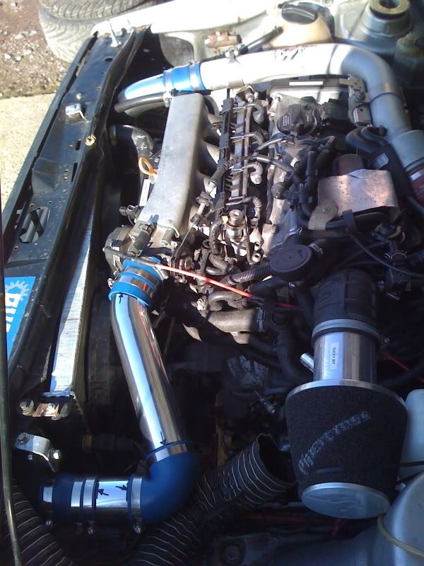

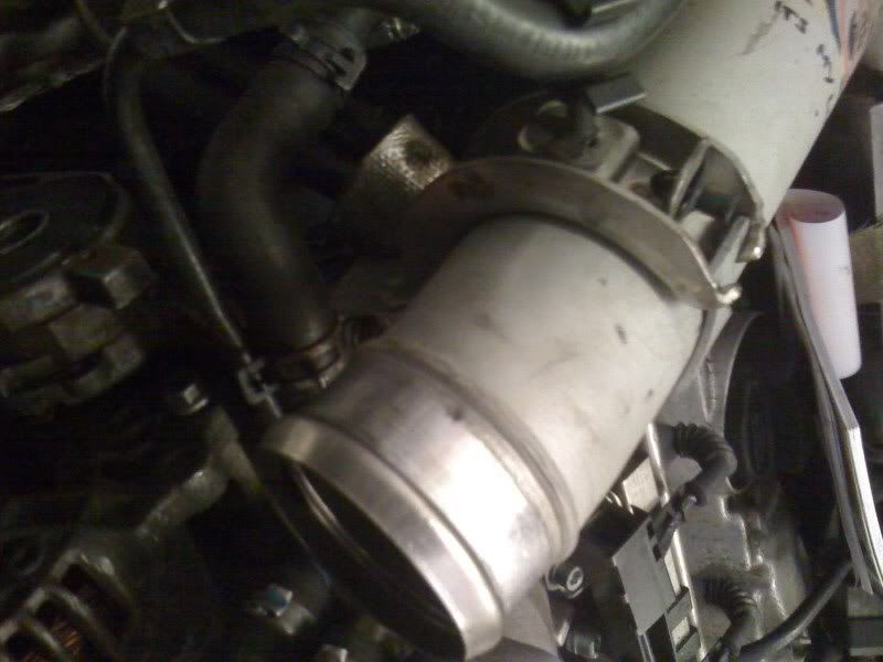

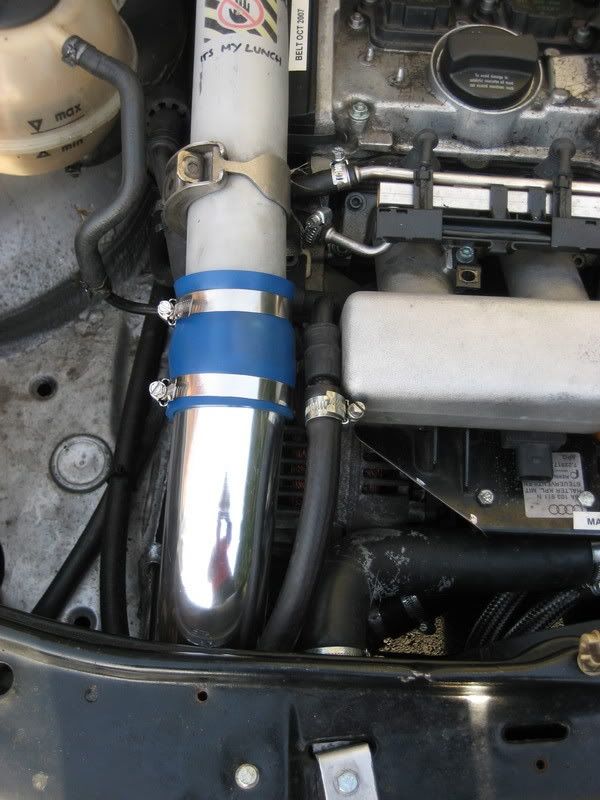

First thing to do was get rid of the old intercooler pipes and knock up something more permanent.
Still not happy with the end result, but they are way better than the half Mercedes half Audi hoses I had bodged together before. They can stay like for this til after the weekend and then I'll try and improve them further

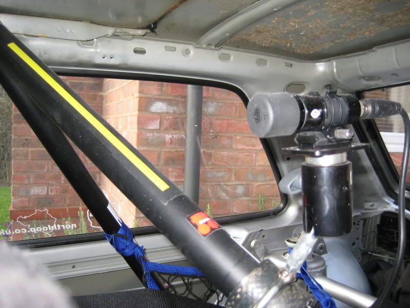

Next stage was to put together a decent camera mount- this was done using an old exhaust clamp, a camera tripod mount and POV.1 bullet cam

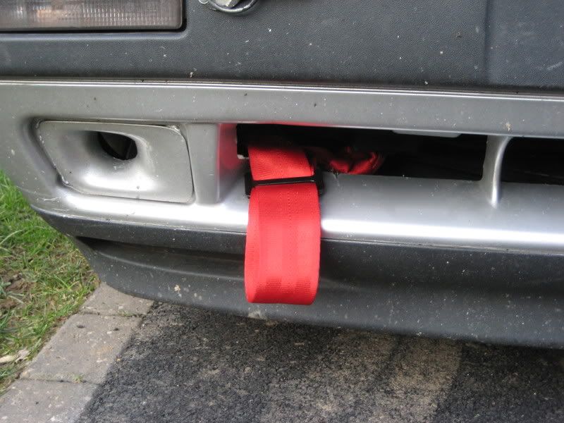

One of the rules of Bedford is that each car must have their towing eye attached. Errrrr- problem there, I cut mine off to fit the intercooler. Bugger! This schroth belt was the answer- £10, problem solved!!
of course the car now looks like its sticking its tongue out

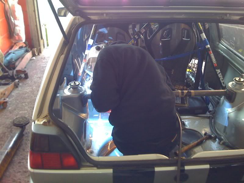

I've always been unhappy about attaching my harness to the seatbelt mount in the fllor under the rear seats, so I bought a bar of CDS, a mate rolled some endplates for me, I profiled it using a die grinder and my mate Gareth welded it in between the rear struts.
The end result looked like this

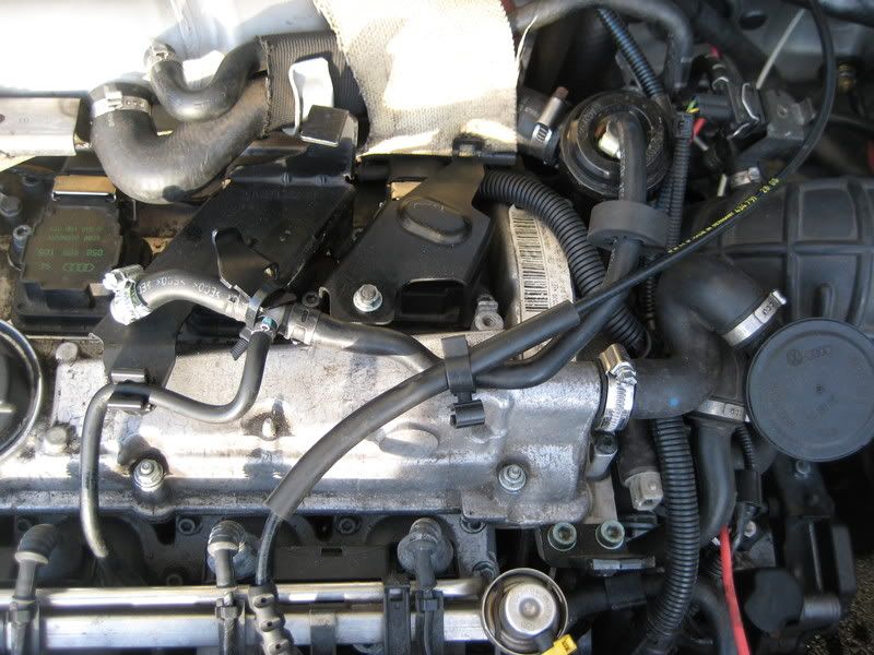

Earlier in the morning I had suffered an almighty clunk going round one of the many fast left handers. Popping the bonnet up over luch revealed the first problem- the intercooler hot pipe (upwind of the intercooler) had thrown the bracket. God knows where- probably into somebody elses path!
I tried a temp fix with wire before giving in and hoping if I used lots and lots of cable ties it wouldn't melt through.

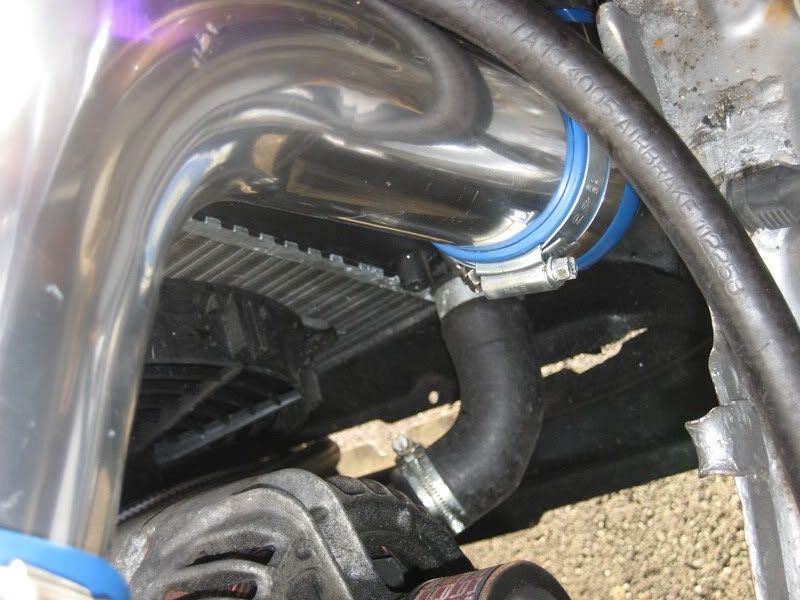

Can you see the fix?
before:
after:
see also how the rubber hose I used (silicon one was sat in the back of my Volvo still) melted and deformed.

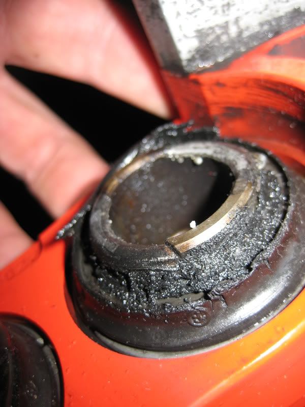

Suddenly there was a huge cloud of smoke and fearing I had blown the car up I dived off the road and yanked on the handbrake to stop me.
The smoke was coming from the front wheel and the disc was covered in fluid. The calipers had burst a seal. I was fuming, so angry that faulty goods had nearly killed me.

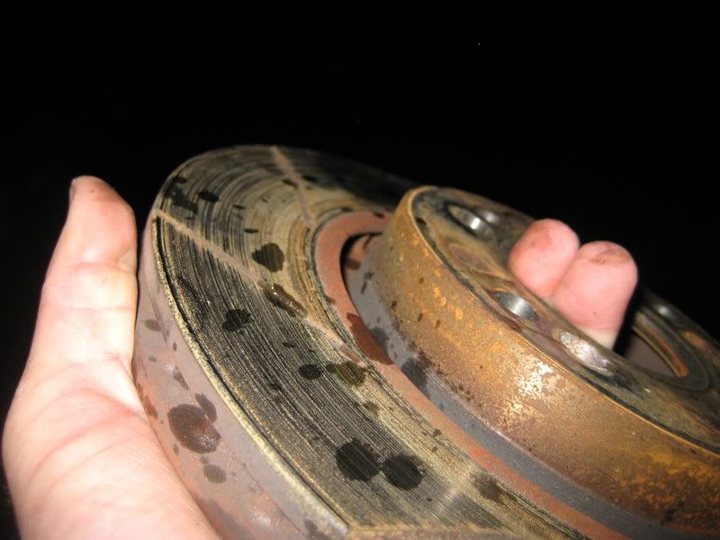

However, it seems Bedford GT circuit is hard on brakes!

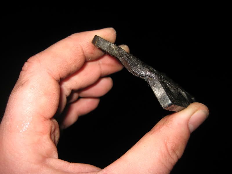

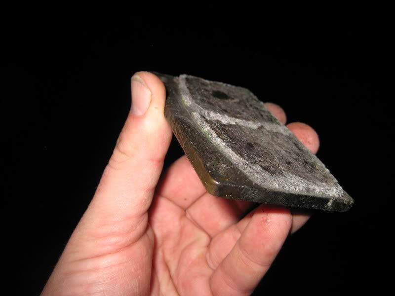

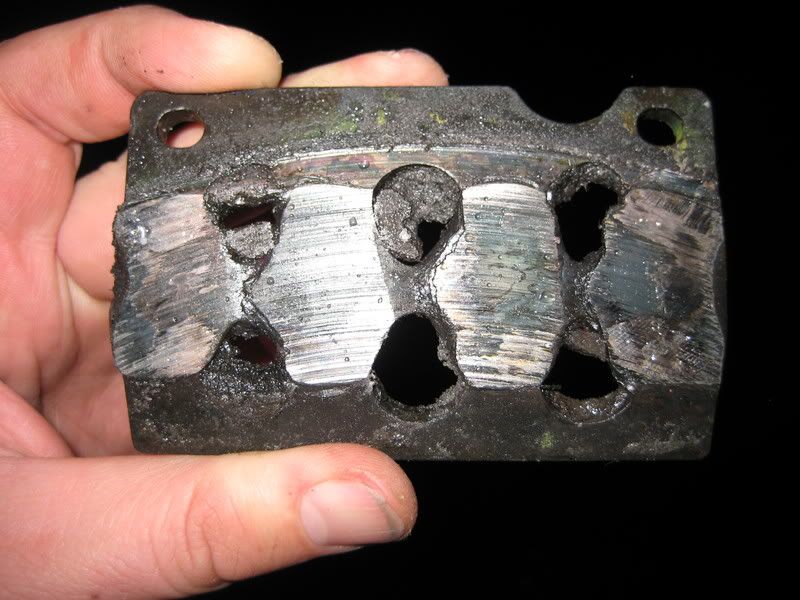

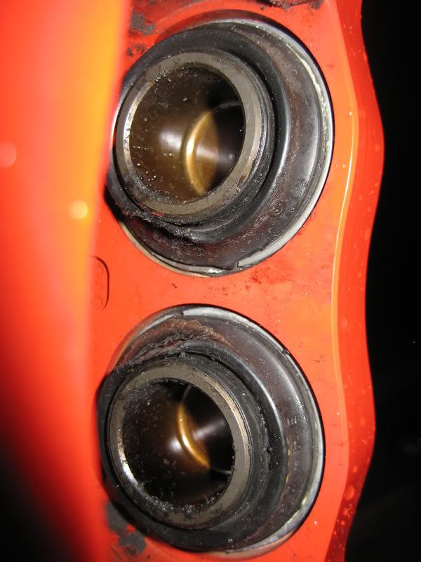

This is the best pad I had left:
This is the worst:

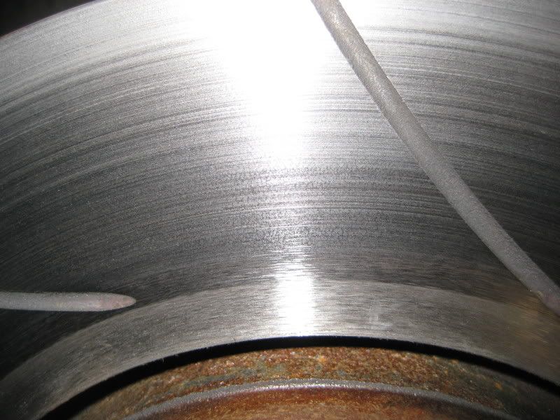

it got so hot it warped
did this to the disc
and this to the caliper pistons
here's what the other side looks like, note the non burnt dust seals as well as the normal shaped pistons
A long chat with Hi_
coming to some armco near you soon.....

A long chat with Hi-Spec suggests the Red Stuff pads were a very VERY bad recommendation.
They recommend carbone-lorraine D6's for my type of (ab)use.
However they have been incredibly helpful and have offered to rebuild the calipers on Monday whilst I wait, they will also skim the discs to get them back in shape. Guess we'll see what happens then.

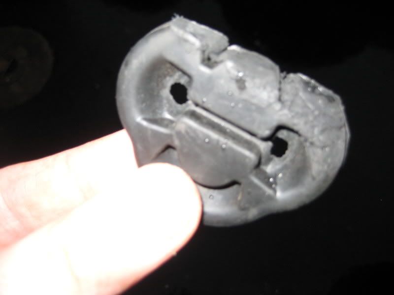

A post track day analysis shows:
Centre exhaust hanger melted through (luckily we fitted two just in case)

OMG I got up horribly early this morning, in order to get my buggered calipers up to Hi-Spec in Dartford.
Spoke to Jeff there (looks like he spends a lot of time indoors!) he was full of top advice "when it starts making a grumbling noise they are buggered"
Actually, he was really helpful and 90 mins later my calipers were refurbished with all new seals, two new pistons and the discs freshly skimmed. He also recommended the carbone -loraine 5 pads.
So lunchtime today the rebuilt brakes were refitted and bled.
the new skimmed discs from this
to this
Fitted the silicon hoses
and finished the afternoon by getting rid of the recirc valve electrical gubbins as it turns out the way I had the recirc set up, it wasnt doing anything and potentially stalling the turbo. Arse.
Finally I refitted the number plates and gave it a road test
The brakes are fooking amazing:
From cold they are ok, they work which I wasn't expecting, but when they are hot, well OMG, the biggest problem was moderating them sufficiently to stop my eyes popping out and white van man from marking his sun covered dashboard in my boot.
Next test is North Weald on 13th March. Will keep you all posted.
