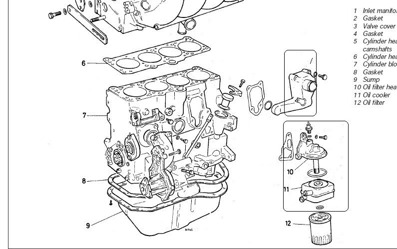

Have got a qeuestion on the oil cooler. Toyotec in the below thread says: remove  "oil cooler but not oil cooler housing" ( its about a 1/4 of the way down page one in between the pics)
http://www.edition38.com/forums/index.php?showtopic=97434
which part is it in the pic?
also is it worth removing the part that isnt numbered i put a rectangular box round it, i think its a breather & cleaning it?
cheers
