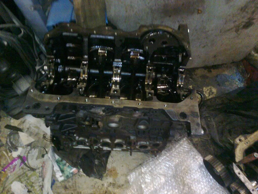

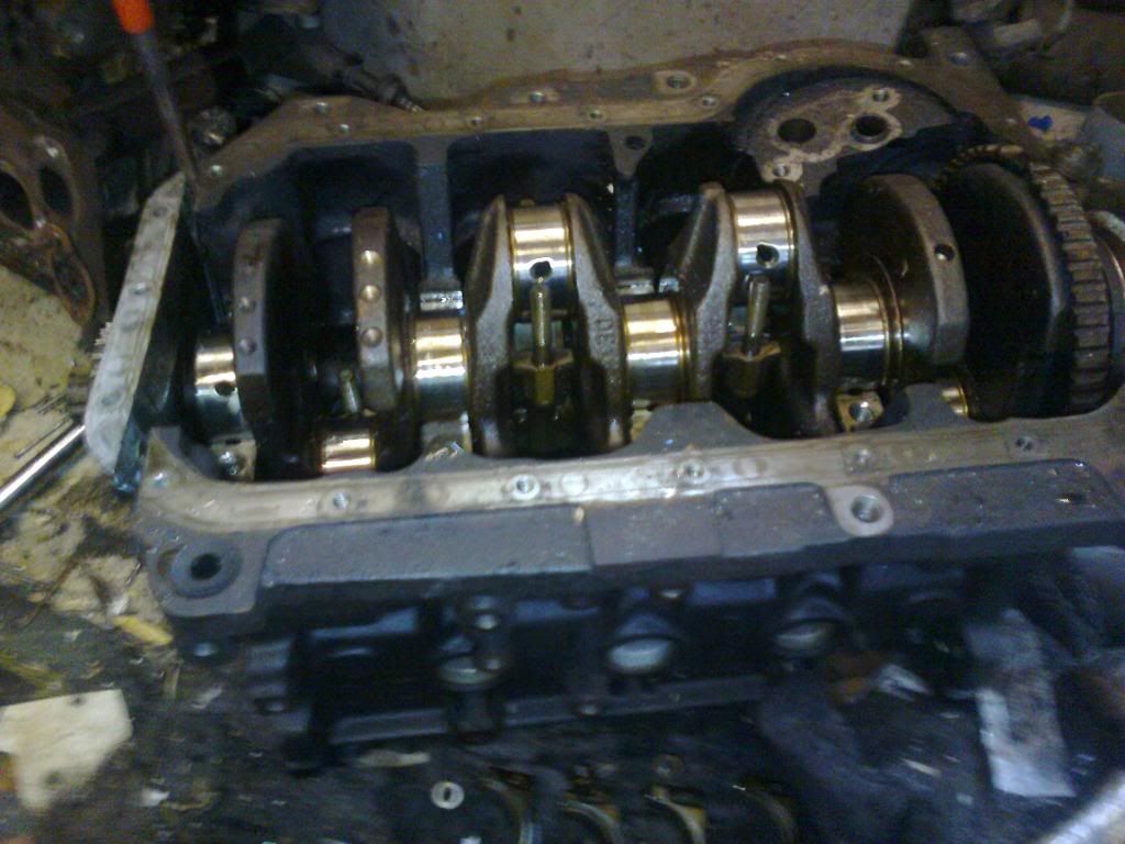

Just to prove I have been doing something!
The diesel engine with the crank taken out!
The spare abf engine with the crank nearly out!
Will finish that tomorrow

Going to check fit the diesel crank to see if there are any clearance issues.
Then strip down the abf engine completely ready for the rebore.
