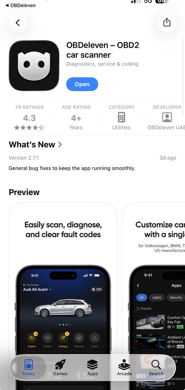

Hmmm, there was a VAG app as well, but I went for the other standard app. Which one do you use?
It is puzzling me I’ll be honest!
Offline JoeGTI
  • Posts: 2,473
Re: OBD11 Information
« Reply #5 on: 17 July 2026, 21:14 »
This one.

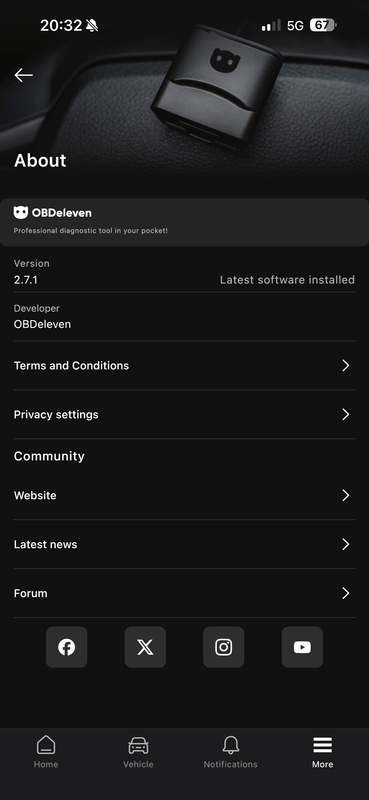

« Reply #6 on: 17 July 2026, 21:17 »
Yeah that’s the one I’m using. I’ll try it again tomorrow and see if it behaves any differently. Appreciate the assist. I wonder if VW have released an update to prevent the OBD control of these settings.
